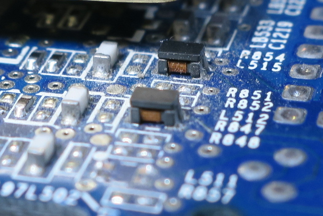

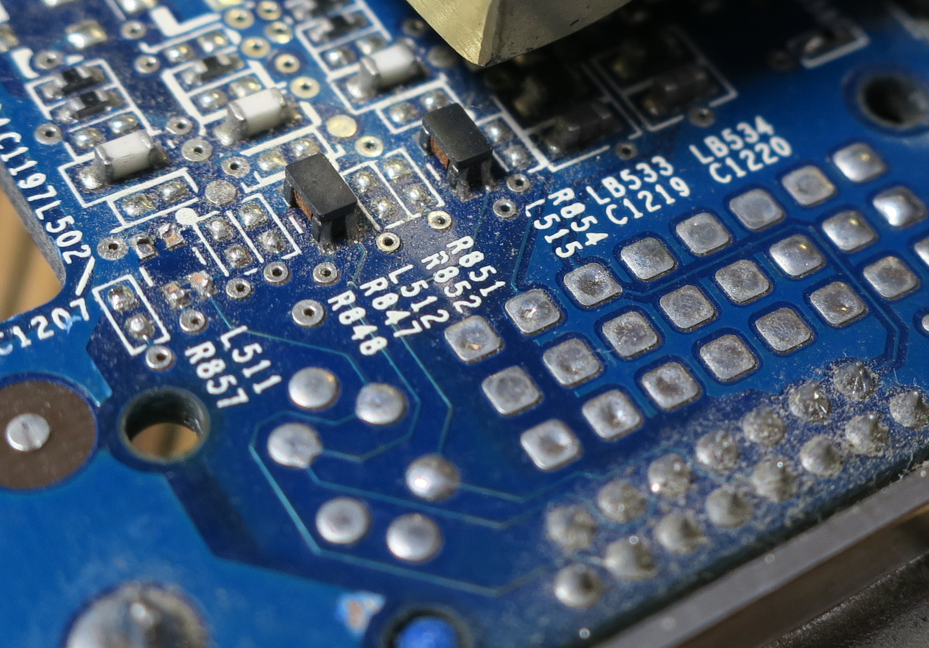

    I have a Geforce 6800gt that is not outputting any red signal to the analog VGA connector, and everything is a shade of cyan. The card otherwise works fine, and I'm pretty sure the problem is caused by a torn off inductor next to the VGA connector. In the photos I uploaded there are two inductors L512 and L515, but L511 is missing.
    Anyone know what inductor I can use to replace the missing one? The two remaining ones are about 2.1mm long, 1.2mm wide and 1.2mm tall. They seem to have two connectors on each end. What would be a suitable replacement that I can buy?

    It might be one of these https://www.digikey.ca/products/en/f...=1&pageSize=25
    If its on the vga output I doubt the value is that critical, anything around that size seems to be about 1µH

        If bad comes to worse, you can just solder a piece of jumper wire across the inductor. It will work fine. I've done it before many times. Just might affect signal clarity at very high analog resolutions.
        Note about your missing inductor above: it is a dual-inductor / common mode inductor. But really only one of the lanes (sides) caries the red output. So you only need to jumper that side - if using a jumper, that is.

                  Well, that's what I did on my first card with that issue (a Radeon HD2400 XT). But then I found out that this "for testing purposes only" "temporary repair" was good enough for the analog resolutions I wanted to run (no ghosting or noise whatsoever). So I started "fixing" every card with this issue in this way... unless of course I had an exact replacement component from another card (which I do quite often, as I keep a good stash of dead GPUs.)

                      I recommend replacing all three as a set for best performance - these inductors are typically used for electromagnetic compatibility.
