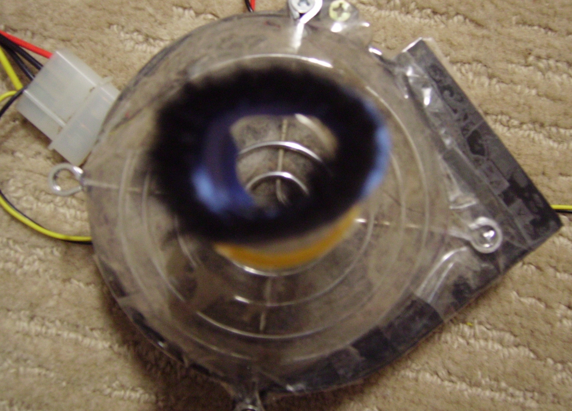

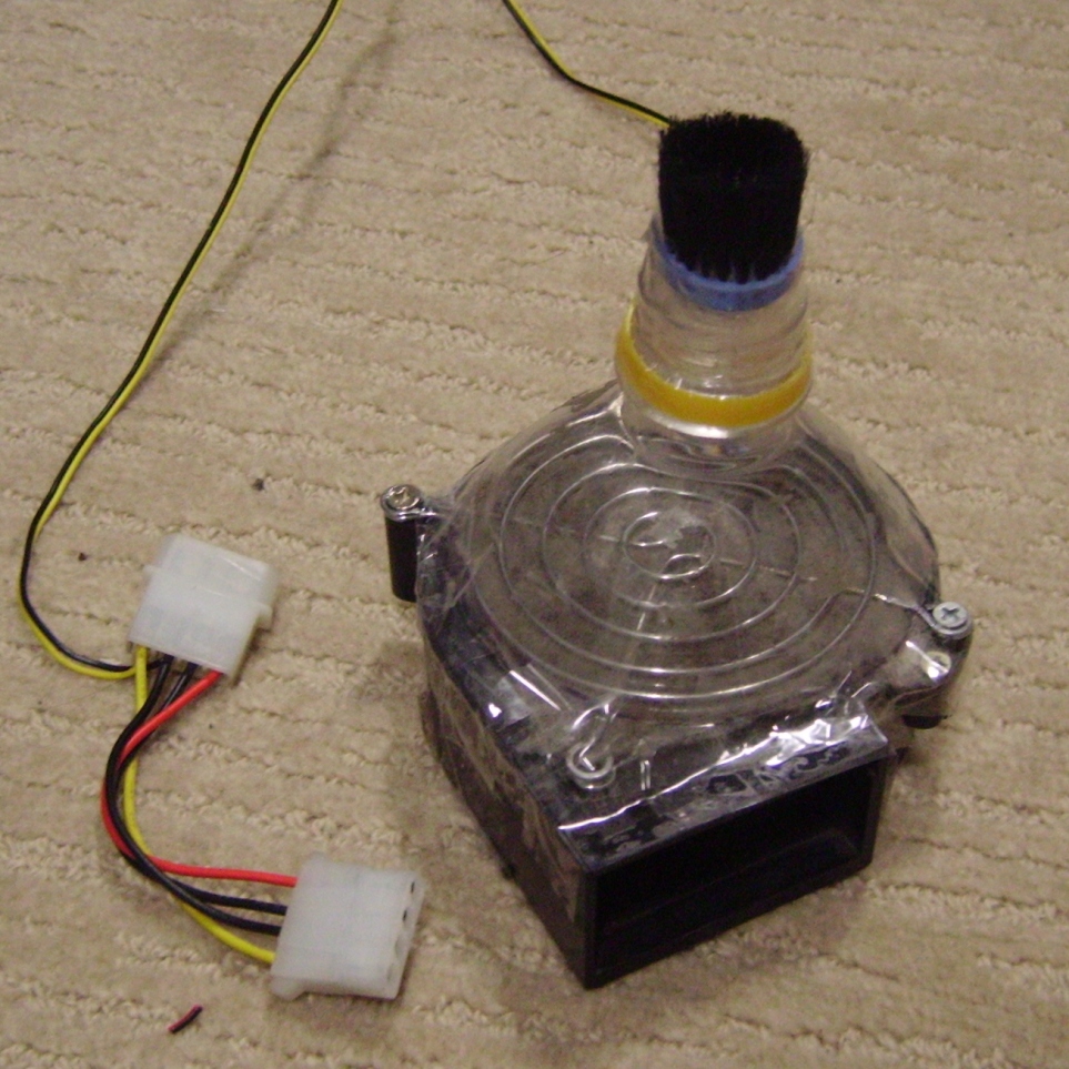

      Hi Everyone! I made this for cleaning dust out of computers after almost choking on a few when trying to fix overheating problems caused by dust-sealed CPU coolers. It consists of the following:
      - A very high RPM fan (in this case a blower removed from a Dell GX270's CPU cooler)
      - The neck from a lemonade bottle
      - Two fan grills with a layer of foam sandwitched between them
      - The bristles from a small brush
      - The molex connector from a siezed case fan
      - Lots of tape
      So far, it has been fairly effective. To clean, I just put the hose from a bigger vacuum cleaner over the top and nearly all of the dust gets sucked out.
              - Lots of tape
              dude home made portable vaccum.... damn, im gonna try it one day, nice work!!
