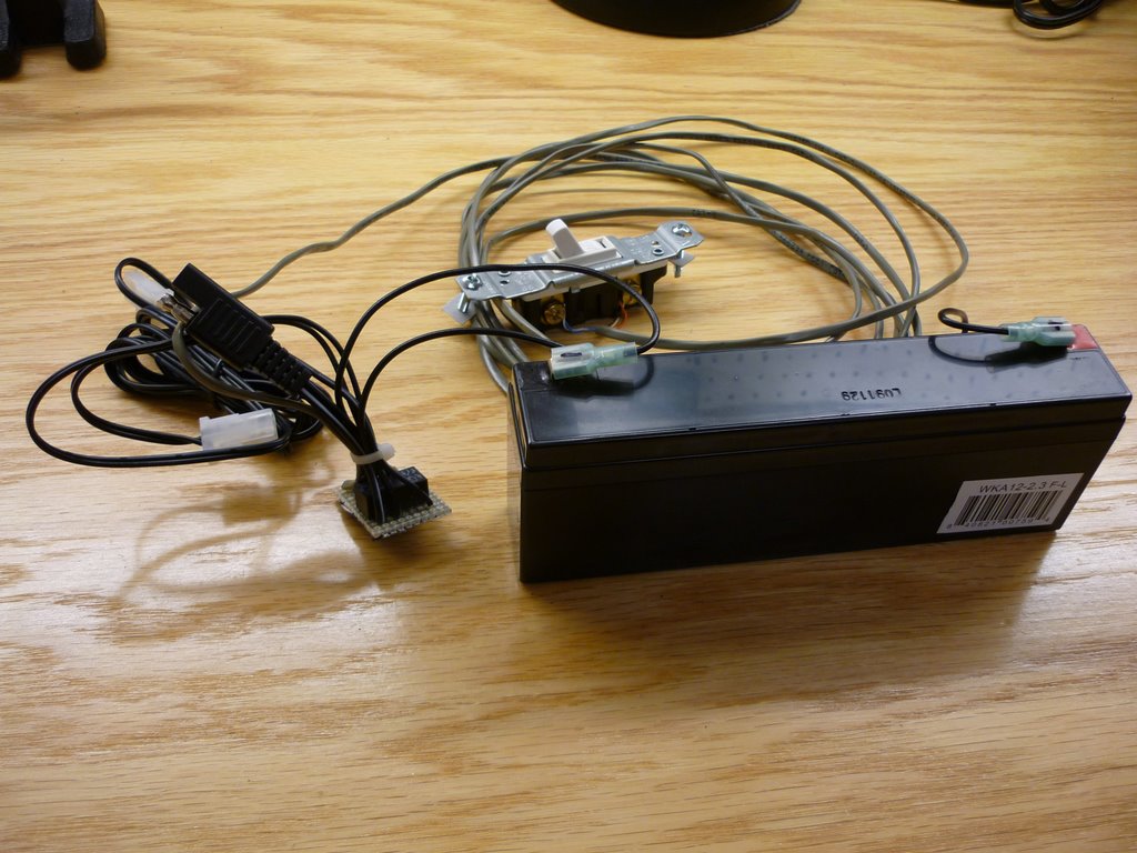

custom/home made gadgets, etc.
  • dumpystig
    replied
    Re: custom/home made gadgets, etc.
    I'm always modding/adapting/customising stuff.
    Not a tool or gadget, but my young son is chuffed with his slightly modded WALL-E truck. I just love doing stuff for him. Nice bright headlights (2x 5mm LED white) and rear alternate flashing warning lights (2x 3mm LED red). I've also uprated his PowerWheels Quad by ditching the 2x 6volt/7Ah batteries, rewiring it, and dropping in a 12volt/32Ah battery - twice the speed and tons more run time although it's a bastard lifting it in and out of the car
    Last edited by dumpystig; 10-24-2011, 10:57 PM.
    Leave a comment:
  • lti
    replied
    Re: custom/home made gadgets, etc.
    I just added a line-level input to my computer. The line-in pins on the audio chip were capacitor coupled to ground, so I removed the caps, soldered wires to the solder points where the caps were installed, and ran the wires to a small circuit board. The board has a four-pin connector and the coupling caps I removed from the motherboard on it. A CD audio cable runs from this board to another board on the back panel, which has a 3.5mm stereo jack soldered to it. I haven't assembled the back panel board yet because I do not have another connector or a board-mounted jack.
    I also built a fan controller using a Microchip TC648B IC. The circuit matches the application circuit in the chip's datasheet and uses an IRF510 MOSFET to power the fan and a PNP transistor connected to the fault pin of the IC to power a buzzer.
    Last edited by lti; 10-23-2011, 03:51 PM.
    Leave a comment:
  • ThePCDoctor
    replied
    Re: custom/home made gadgets, etc.
    For years, I designed and built electronic devices for my employers, of which I have very few pictures. But I also built a lot of devices, power supplies and gadgets for myself.
    A high gain antenna for my Netbook computer.
    I rigged this two-fan cooler, with 1/4" spacers, to drasticly improve the cooling of all my hard drives. The spacers, eliminate the "Air-Dam" effect between the fans and HD, when the fans are screwed down right onto the HD.
    Variable current (constant current) Ni-Cat battery charger:
    General purpose, low current voltage regulator.
    Variable, AC to DC power supply, with current limiting and short circuit protection.
    There are a lot more things, but no pictures. Sorry!
    The Doctor
    Leave a comment:
  • inuyasha.rules
    replied
    Re: custom/home made gadgets, etc.
    The short list of "afro engineering" aka "a presidential salute"
    Since 10-100base-t ethernet only uses 4 of the 8 wires I spliced the unused ones to a wall wart on one end and a barrel conector on the other. Instant POE cable to run my wifi router so I could pick up the hotspots from in the basement.
    Bought a laptop for $1 at a police auction with no power supply. Bought a dell laptop power supply for $1 at a yard sale. Plugs didn't fit so I spliced a heavy duty RCA plug to the power supply and a RCA jack to the laptops mobo and removed the IR port to mount it. Hey if its good enough for steve its good enough for me!
    Put a molex connector under my dash with a 5v regulator so I can run computer neon lights in the car with minimal cable mutilation. Also spliced into the 5v to run my phone charger and xm radio.
    And finally the best/worst thing I have ever made myself. LINUX! Tho os for people who want a porche and build it themselves!
    Leave a comment:
  • bluto
    replied
    Re: custom/home made gadgets, etc.
    To install the light bars in the shed, I used hanger bolts (wood thread on one side, machine thread on the other) to bolt the light bars to the metal rafters in the shed. The rafters are 'U' shaped, so they made a nice place to tuck the battery away in. The solar panel is held up to the shed sky-light with some safety wire. A length of phone wire connects the relay module to the light switch that is installed in a shallow plastic work box screwed to the shed wall. As you can see, the lights provide more than adequate illumination for finding things in the shed at night.
    Thanks to the folks at the orange store for ordering too many flashlights at christmas. Without their $1 flashlights, this project may have never materialized.
    Leave a comment:
  • bluto
    replied
    Bluto's shed lights
    I put in a plastic storage shed last summer and have been trying to customize it to my tastes. One thing that I thought would be cool was to add some lighting. I eventually came up with the idea of using LEDs and a SLA battery to power them. But how to make them look nice? That would soon come to me...
    In early January, the orange store was clearing out all of their christmas stocking stuffer gift crap. I ran across their LED flashlights that were marked down to $1 each and I knew I had found my light source. I bought 8 Aluminum LED flashlights [6 LEDs in each flashlight - batteries included!]. I also got a 12v 2.3AH SLA battery and a 12v solar car battery maintainer (meant to sit on the dash and plug into the cig lighter to keep a car battery charged when it sits for long periods).
    I started by cutting 2 strips of 5/8" MDF and then drilling 4x 1" holes equally spaced into each of them. I also made a shallow 1/4" dado cut centered along the length of the back of the strip.
    I then cut all the flashlights right behind the LED assembly and began wiring them to the board. I experimented with 7805 5v regulators to lower the 12v battery down to 4.5v for the flashlight head. I used 2 regulators (4 lights per regulator). They got really hot even with a heatsink, so I figured that this heat was wasting lots of battery power.
    In the end I settled on using 2x16ohm (32 ohm total) 5 watt resistors running two light heads in series. So each of the 4 pairs of light heads has its own resistors lowering the battery voltage down to the proper level. I used a small relay controlled by a regular house light switch to turn the lights on and off (to try and avoid some line loss of power between the switch and the battery).
    The next reply in the thread shows the lights installed in the shed.
    Leave a comment:
  • Th3_uN1Qu3
    replied
    Re: custom/home made gadgets, etc.
    Well, since you got me started, let's talk about how much it'll cost. For a basic tester with no fancy crap, i would say it'll cost you $100 to $150. The most expensive parts are going to be the mosfets ($30 to $60 total for 20 of them, depending where you buy them) and the heatsink. For extra cooling i think four 80mm computer fans will do.
    As extras you will need a few amp meter movements (yes the kind with a needle and scale), i'd say 30A for the 5v and 3.3v rails and 50A for the 12v rail(s). The -12v, -5v (where available) and 5vsb are less critical, and you can probably just use resistors to load these, and the LED thing i mentioned earlier to see if they are in spec and that's gonna be all. The movements are going to cost about $3-$10 each depending on your source, around here they seem to be more around the $10 mark. Of course you can make your own scales and calibrate the movements to work with them, so grab whatever movements you find.
    Next, you are going to need shunts for the meters to get their measurements from, you can simply make them out of a piece of thick wire, then another few opamps will turn the very low voltage from the shunts into something that can drive the meter movements. Here you'll not necessarily need fast opamps, but they have to be ultra low noise. You'll also need to borrow, steal, or beg for an expensive amp meter so you can calibrate yours against it.
    To keep it cheap i wouldn't add voltmeters but simply another few of those LED things i mentioned earlier. A latch circuit before the LED will ensure that the corresponding LED remains lit if the power supply has gotten out of spec even once. And that's about it. Oh and you're also going to need a bunch of automotive fuses, to protect the load tester in case things go very wrong with the PSU under test. The way i see it, the tester itself will not have a power supply, but instead all the metering circuitry will be powered by the supply under test. Some of you may not agree with that, but i think that the 12v rail is enough headroom to derive low ripple power supplies for the tester's internals. I will use 5v for all the opamps and meters, and 9v for the gate drive, so that no matter what FET you use, it can be driven to its lowest resistance state.
    Heh. If i bothered to type all this... i think i'll be building one of my own. Expect some schematics designed and tested soon.
    Leave a comment:
  • Th3_uN1Qu3
    replied
    Re: custom/home made gadgets, etc.
    Okay, i just rigged up a quick and dirty power tester, just to see how it works. I have long wanted to build me one of those, but i don't repair enough computer PSUs to warrant building it. The idea however, has been in my head for a long long while.
    So i just used two IRF740 'fets that i had lying around and put them on an ATX PSU heatsink. They have 0.55 ohm RDS(on) each. In parallel that makes a minimum resistance of 0.275 ohms which would be 91 watts at 5 volts and 524 watts at 12 volts. PSU under test was my old trusty 200W Seasonic, rated 20A @ 5v and 8A @ 12v. You do the power math. As expected, no problem at 5 volts for the PSU, however, even with a computer fan blowing onto the heatsink where the 'fets are installed, it quickly got very, very, very hot and i needed to stop testing as to not blow them. This is with just 90W, one could imagine what would happen if those two 'fets would have to dissipate 500W.
    Actually their maximum dissipation IF you can keep the case temperature at 25C is 125W each, so it is physically impossible to eat 500W with just two. Also, at 100C case temp (a more practical value), they are rated for only 6.3A continuous current. So, let's do some math. 2x 6.3A = 12.6A. 12x 12.6 = 151.2W. So you could load 150W on the 12v rail with two of them. But there is another little thing that is called power derating... In the case of the IRF740, this is 1W/degree C. So with the case at 100C, you would be left with just 25W dissipation capability in each MOSFET, or 50W total!!!
    This is why you will need a lot of them. Assuming your cooling sucks and they will sit at 100C case temp, for a 500W load you are going to need 20 of those. With proper cooling you could get away with 10 or 12.
    And of course, there's more... Like any resistor, the MOSFET's internal RDS increases with increasing temperature. If you want a "set it and forget it" solution that doesn't have to be monitored all the time while it's testing the power supply, you'll want a feedback loop that adjusts the drive to the MOSFETs to keep power consumption constant. This sounds like a job for a microcontroller already. And honestly, i don't know a bit about micros, i'd just do something with an opamp. But for a truly automatic tester, where you input the desired loads via a keypad and get results on a nice LCD screen, you will definitely need a micro.
    Leave a comment:
  • Th3_uN1Qu3
    replied
    Re: custom/home made gadgets, etc.
    Yes, you can use resistors too, but unless you have a lot of different value power resistors (which are also expensive), there is no way of varying the load. With an active circuit such as the one i described you can vary the load from essentialy zero to short circuit. Oh yeah and you'll need a heavy-duty amp meter as well. The cheapo ones won't cut it because their shunts have quite high resistance, and will burn up if you use them continuously.
    For the mosfets all you care about is that they should be able to dissipate as much power as possible, and that they have medium to high Rds(on). You're looking in the range of 0.5 - 2ohm Rds(on). With a very low Rds(on) device such as a motherboard mosfet, the gate voltage difference between what looks like a low load to the PSU and what looks like a short circuit would be very small, thus it'll be difficult to control.
    Heatsinks... Ever opened up a BIG power amplifier? Like, a professional unit with 1kW power or more? That's about the size of heatsinks you will need. If you use fans, you can get away with smaller heatsinks.
    You control the load by applying a variable voltage between gate and source. A simple trimpot is enough to control the voltage, a high current driver is not necessary in linear mode. The necessary voltage source can be derived from the 12v rail of the PSU under test.
    Leave a comment:
  • shovenose
    replied
    Re: custom/home made gadgets, etc.
    Ok. But i thought i had to use resistors? Ok well how big do my heatsinks have to be? What kind of mosfet do i need? How do i control the load? How many watts load would it be? Are mosfets expensive? Would i need a cooling fsn?
    Leave a comment:
  • kc8adu
    replied
    Re: custom/home made gadgets, etc.
    this would be a great project.
    Leave a comment:
  • Th3_uN1Qu3
    replied
    Re: custom/home made gadgets, etc.
    A PSU load you say. Easy enough. Big ass MOSFETs, big ass heatsink. You operate the transistors in linear mode, by applying fixed voltage to the gate. The more voltage you apply, the more the gate opens, and the more load is placed onto the PSU. Do use a lot of FETs however (i'd say 10 at the very minimum), coz it's gonna get real hot, real quick.
    So that you can check whether the power supply is still operating properly with that load, you're also going to need a multimeter and an oscilloscope. Using some opamps configured the right way you can set up a few LEDs to show the ripple level on each rail so you don't need to constantly move the 'scope probe around to check ripple on the various rails, but you will still need to have an oscilloscope for initial calibration of the LED meter.
    Hint: The opamps will need to be quite fast, you need at least 20x gain at up to 1MHz. Basically what you do is wire the opamp inputs to the power supply rail with coupling capacitors in between, so that only ripple gets thru. Then the ripple is amplified by the opamps, and the resulting signal should have enough level to light up an LED if ripple is higher than allowed by the ATX specs. For extra style make a bargraph type of thing, with more LEDs for each rail, so you not only know that the power supply is in spec, but also know how good it is. But this is a bit more complicated than just getting one single LED to light up, so try doing that first.
    Last edited by Th3_uN1Qu3; 09-16-2010, 06:01 AM.
    Leave a comment:
  • c_hegge
    replied
    Re: custom/home made gadgets, etc.
    I'm thinking of diong a similar thing myself.
    Leave a comment:
  • shovenose
    replied
    Re: custom/home made gadgets, etc.
    So lets work on a version 2! Yay
    Leave a comment:
  • shovenose
    replied
    Re: custom/home made gadgets, etc.
    Hello! So i was going to make a psu loader, lets call it version 1. I posted tomshardware.com(where i am a forum member). But thwt idea never happened. And im not going to spend several thousand $ on one of those sunmoon things thwt jonnyguru.com uses. I need to build it myself. Help please...tyvm!!!
    Leave a comment:
  • dood
    replied
    Re: custom/home made gadgets, etc.
    So sad that KeriJane is gone... some of the best homebrewed test equipment there...
    Leave a comment:
  • kc8adu
    replied
    Re: custom/home made gadgets, etc.
    digging in the pole barn loft i found one of my homebrew radar jammers.gotta bring it home and take pics.x,k,and ka and you dial your own speed.
    Leave a comment:
  • shovenose
    replied
    Re: custom/home made gadgets, etc.
    to start, this is a modified 20 to 20+4 atx adapter. i added an on/off swiche between green and ground, making it so you can test ps voltages/fans/other devices without a motherboard.
    obviously, it works with 20+4, but also regular 20 (line up green wires)
    did exact smae thing but with duct tape
    Leave a comment:
  • RJARRRPCGP
    replied
    Re: custom/home made gadgets, etc.
    Originally posted by KeriJane
    Pins of Pain
    That immediately reminded me of the socket 775 push-pins. Those were a pain when I first built a socket 775 system in September, 2008.
    Leave a comment:
  • 93daytona
    replied
    Re: custom/home made gadgets, etc.
    Since it seems like this isn't being limited to computer related gadgets, here is the cyclone dust separator I built last summer. A shopvac hose attaches to the top port, and the side port (that enters the cylinder tangentially) the collection hose attaches to.
    I'll be making a second revision of it this summer that will be a stand alone unit (no shopvac needed) and will actually use some computer parts
    After sucking up some MDF dust:
    and this is all the dust that made it through to the shop-vac:
    Leave a comment:
    MEDION AKOYA P15645 + MS Office Home&Student 2019 Notebook Specification for Upgrade or Repair
    This specification for the MEDION AKOYA P15645 + MS Office Home&Student 2019 Notebook can be useful for upgrading or repairing a laptop that is not working. As a community we are working through our specifications to add valuable data like the P15645 + MS Office Home&Student 2019 boardview and P15645 + MS Office Home&Student 2019 schematic. Our users have donated over 1 million documents which are being added to the site. This page will be updated soon with additional information. Alternatively you can request additional help from our users directly on the relevant badcaps forum. Please...
    09-06-2024, 05:00 PM
    ASUS ZenBook UX3410UF-GV180T + MS Office Home & Student 2019 Notebook Specification for Upgrade or Repair
    This specification for the ASUS ZenBook UX3410UF-GV180T + MS Office Home & Student 2019 Notebook can be useful for upgrading or repairing a laptop that is not working. As a community we are working through our specifications to add valuable data like the UX3410UF-GV180T + MS Office Home & Student 2019 boardview and UX3410UF-GV180T + MS Office Home & Student 2019 schematic. Our users have donated over 1 million documents which are being added to the site. This page will be updated soon with additional information. Alternatively you can request additional help from our users directly...
    09-06-2024, 03:21 PM
    ASUS VivoBook S406UA-BM013T + MS Office Home & Student 2019 Notebook S14 Specification for Upgrade or Repair
    This specification for the ASUS VivoBook S406UA-BM013T + MS Office Home & Student 2019 Notebook can be useful for upgrading or repairing a laptop that is not working. As a community we are working through our specifications to add valuable data like the S406UA-BM013T + MS Office Home & Student 2019 boardview and S406UA-BM013T + MS Office Home & Student 2019 schematic. Our users have donated over 1 million documents which are being added to the site. This page will be updated soon with additional information. Alternatively you can request additional help from our users directly on the...
    09-06-2024, 03:21 PM
    ASUS VivoBook S330UA-EY033T + MS Office Home & Student 2019 Notebook S13 Specification for Upgrade or Repair
    This specification for the ASUS VivoBook S330UA-EY033T + MS Office Home & Student 2019 Notebook can be useful for upgrading or repairing a laptop that is not working. As a community we are working through our specifications to add valuable data like the S330UA-EY033T + MS Office Home & Student 2019 boardview and S330UA-EY033T + MS Office Home & Student 2019 schematic. Our users have donated over 1 million documents which are being added to the site. This page will be updated soon with additional information. Alternatively you can request additional help from our users directly on the...
    09-06-2024, 03:21 PM
  • ivtec
    Home made audio amp help
    by ivtec
    Hi folks i need some help from the electronics pros on a small audio amp for my old lcd tv that sound is too low on the speakers despite to be on the max volume, i know the issue is on the main board , the only solution is to buy a new board but i don't want to shell out 50 bucks for a board . I have seen in Utube some home made audio amps but i'm weary about those projects, i 've seen a audio buit with an STK audio amp ,. I don't have STK4142, i have STK4273, my question if this is not fake and works can i do it with STK4273 instead of STK4142? thanks https://www.youtube.com/watch?v=BcTZS5Y...
    02-04-2024, 10:42 AM
