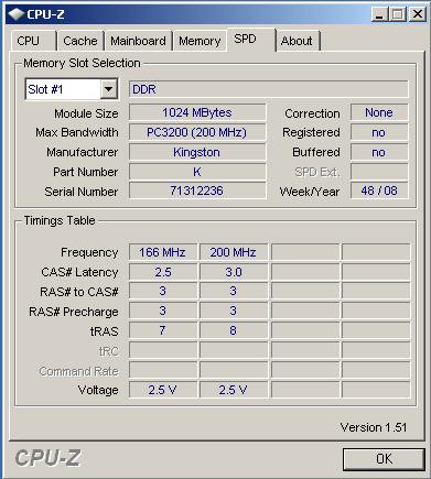

        I guess my memory of my memory is slightly different than some peoples...
                  I'm not sure where CPU-Z is getting that voltage info from.
                  I'm pretty sure there's nothing in the SPD for DDR1 that says anything about a module's "intended" operating voltage. The motherboard just has to assume JEDEC values.
                  They might have added that with DDR2 though, haven't looked at that spec.

                          Re: High Failure Rates for DDR2
                          Whenever I OC, I try to keep the memory at stock speeds/voltages. Only thing I've gotten is data corruption and instability from overclocking memory. My ddr runs at 208mhz and I'd rather it run stock but the math doesn't work out.
                          and my memory shows 2.5v in CPUz as well. Both kingston and samsung.
