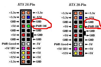

                              • 370forlife
                                Large Marge
                                • Aug 2008
                                • 3112
                                Re: Compaq hard drive down for the count
                                Originally posted by everell
                                I put the leads to the 5vsb and the negative next to it, and it read 4.11V.
                                I didn't quite understand "the negative next to it". Are you measuring on the power supply pc board, the atx connector that plugs into the mobo, or somewhere else? For the negative side, I usually use an unused power connector, one that can plug into hard drive or CDROM, just plug the meter probe into one of the center black wires. That is the ground for 5vsb. Then can pick up 5vsb measurement off the violet wire on the ATX connector plugged into the mobo. Try measuring it that way and see if it makes any difference.
                                The attached picture shows the two pins I was using to measure. As you can see there is a ground right next to it, that's what I meant by the negative next to it.
                                • Wizard
                                  • Mar 2008
                                  • 2296
                                  Power_on is shorted to ground to turn ATX PSU on.
                                  There is no such as negative ground. All voltage measurements is referenced to the ground. There are two wires that usually have -5V and -12V measured to ground. Your DMM will say - voltage when measuring negative voltage or your probes reversed by mistake while measuring positive voltage.
                                  Standby voltage is what you should also measure against ground. The power_on pin is a signal not a voltage, it has bit of voltage via a pull up resistor to 5V internally in the PSU and mainboard pulls it low near ground via a transistor on the mainboard itself.
                                  Remember, in other non-PC applications there is some PSU designs that has isolated winding that does not have a ground connection and is still a DC due to diode and a capacitor network, usually for audio or other special application where double isolation is needed for extra safety.
                                  Cheers, Wizard
                                  • 370forlife
                                    Large Marge
                                    • Aug 2008
                                    • 3112
                                    am I retarded or what
                                    Hmmm, this is no good, its reading 5.90V. How did this ati chipset not fry yet? Good thing I got it out of there now.
                                    Last edited by 370forlife; 06-14-2009, 12:16 PM. Reason: thats no good thats no good thats no good thats no good....
                                    • Wizard
                                      • Mar 2008
                                      • 2296
                                      Good that you got this caught. Go retail Seasonic!
                                      Keep us updated.
                                      Cheers, Wizard
                                      • everell
                                        • Jan 2009
                                        • 1514
                                        If 5vsb measures 5.90 volts, it is only going to get worse, not better. This sounds more like the Bestec ATX-250 12E rather than the 12Z, unless they are playing games with the labels. Definitely time to change power supply to something like has been recommended.
