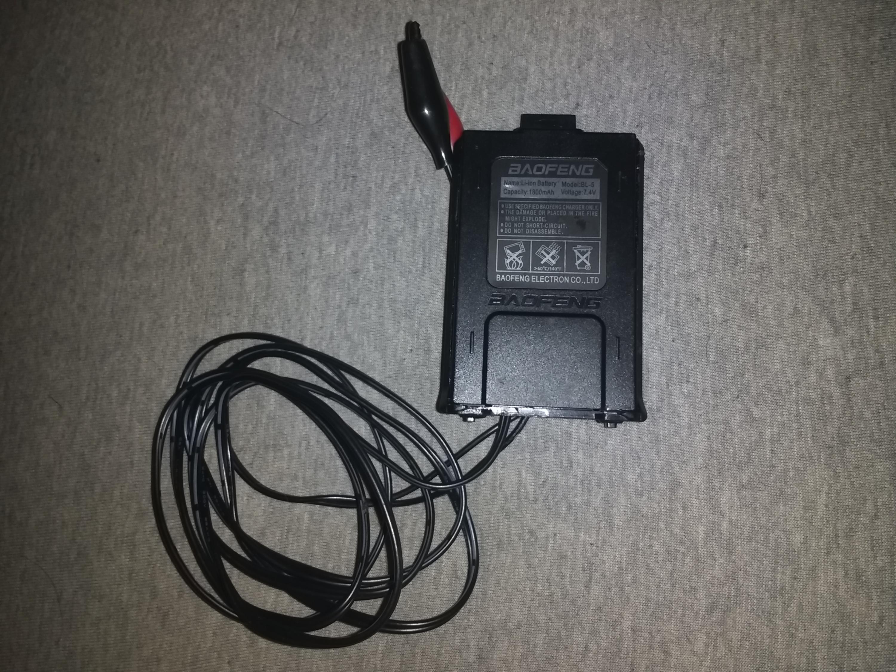

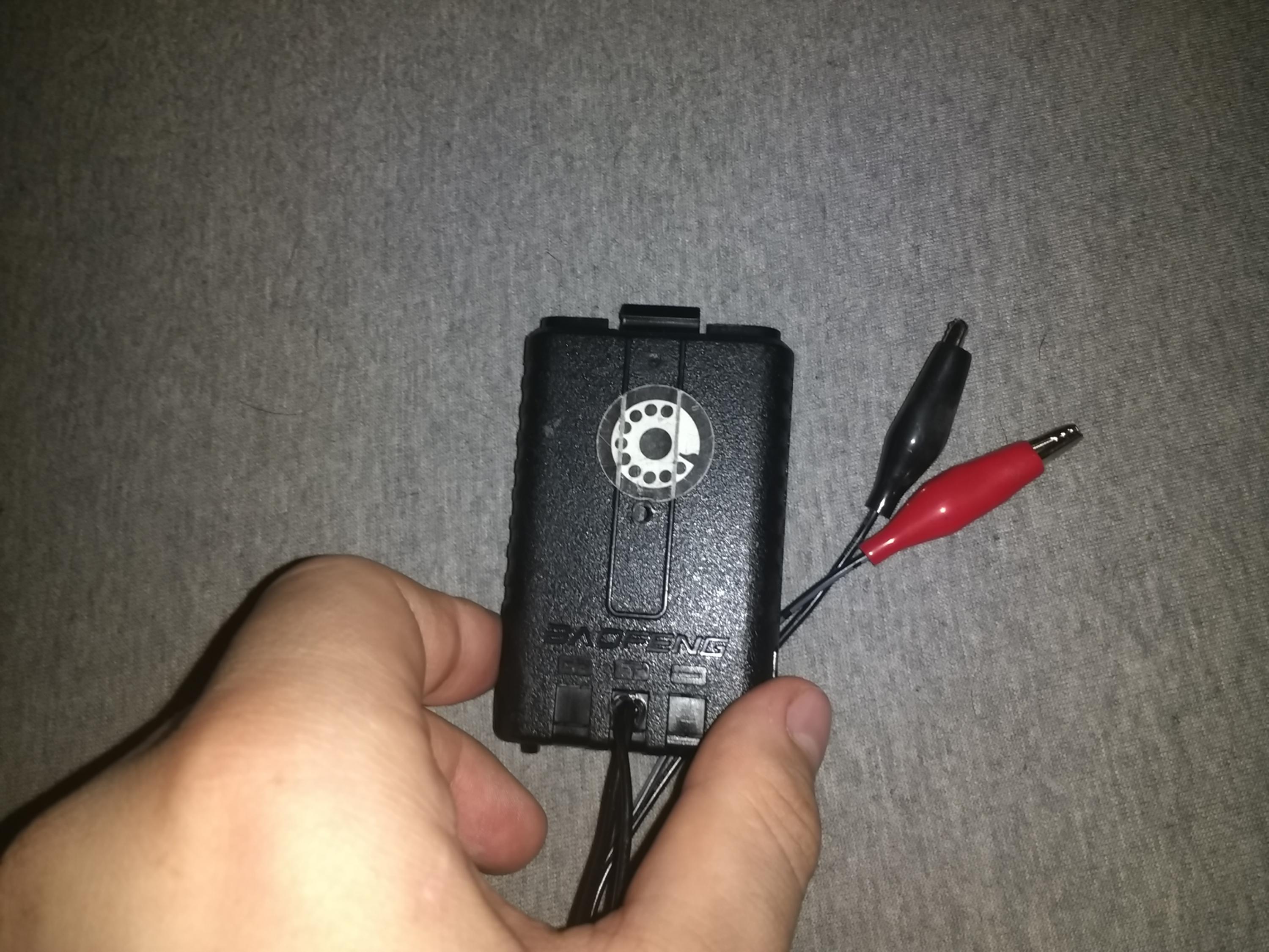

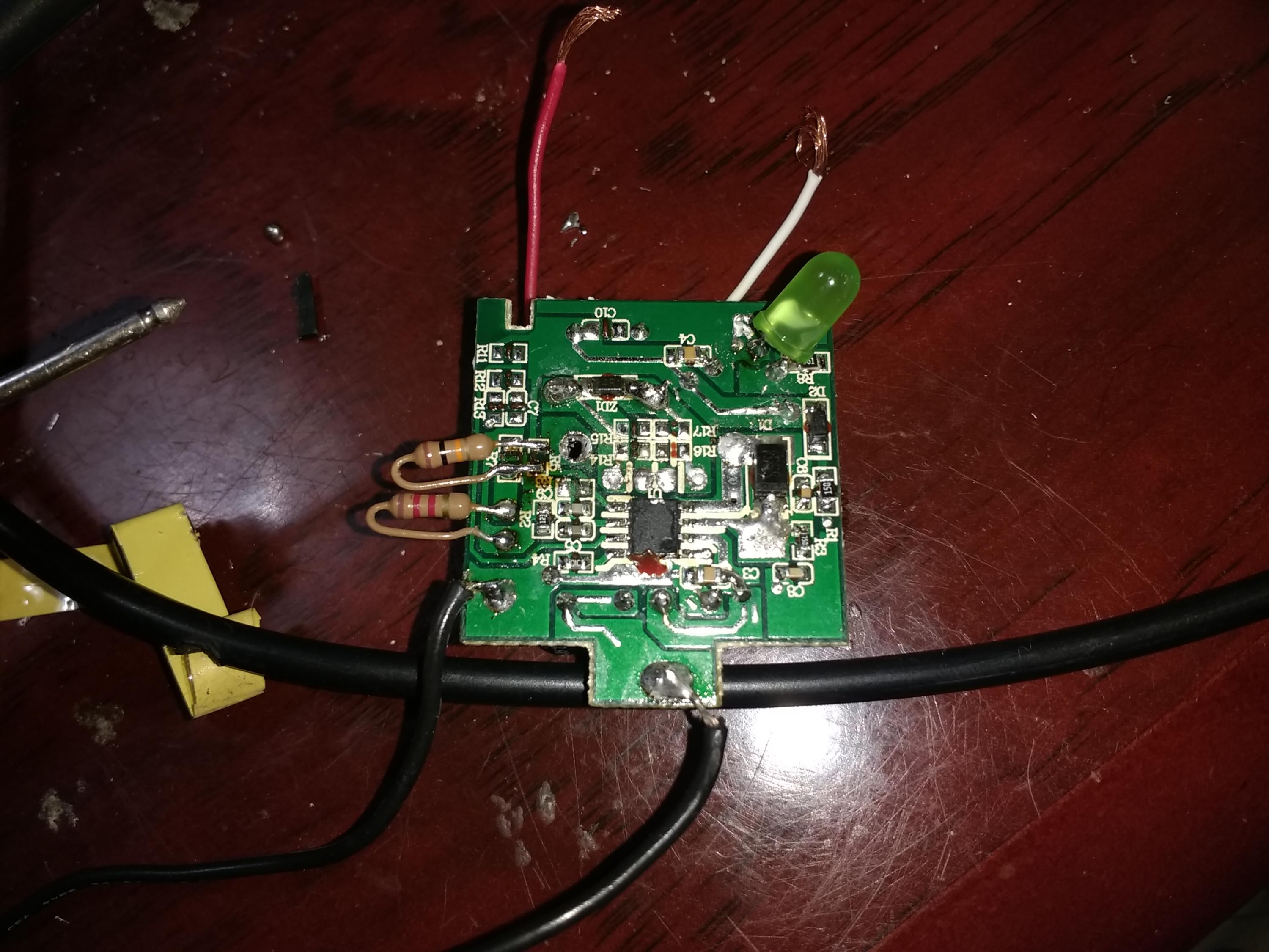

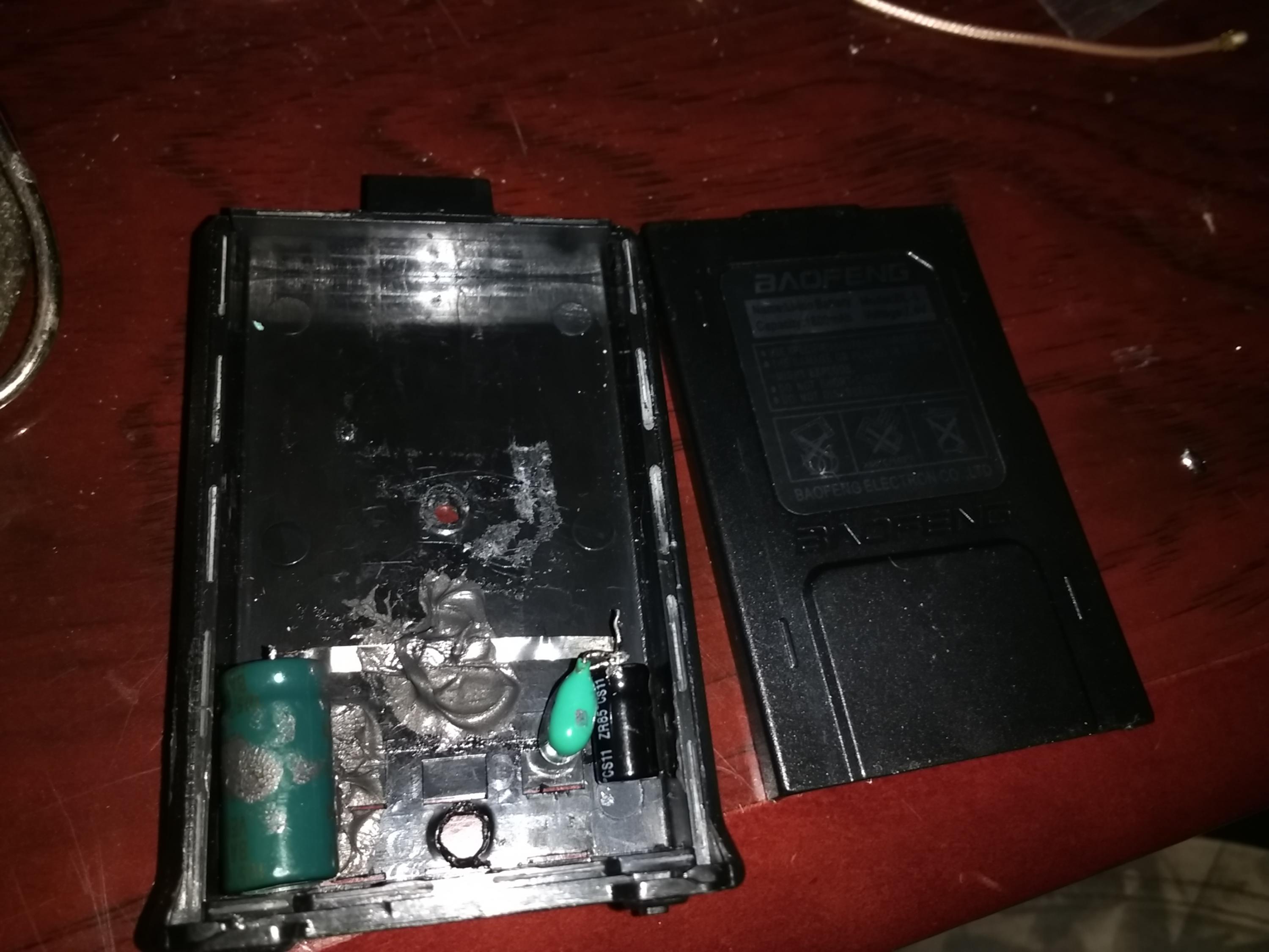

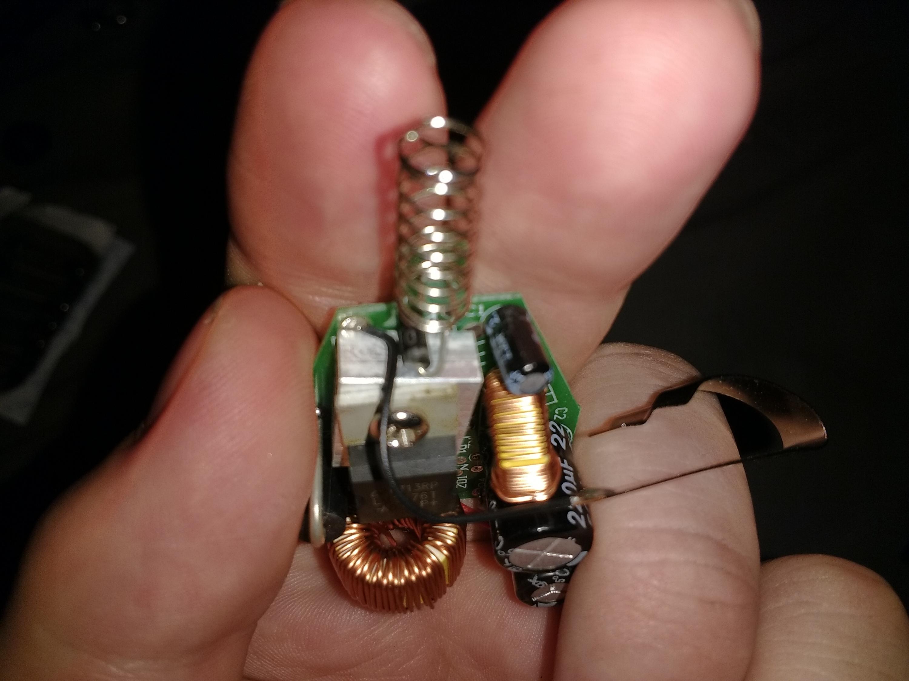

    So, the battery from my old dual band radio finally quit. I decided to build a battery eliminator.
    The case is about 1 1/2" x 3" x 1/2" OD, so space is a bit tight, but not horrible.
    Here's what it looks like gutted and my first attempt at a ground bus installed. (Hint, tin coated steel doesn't stick to silicone very well.)

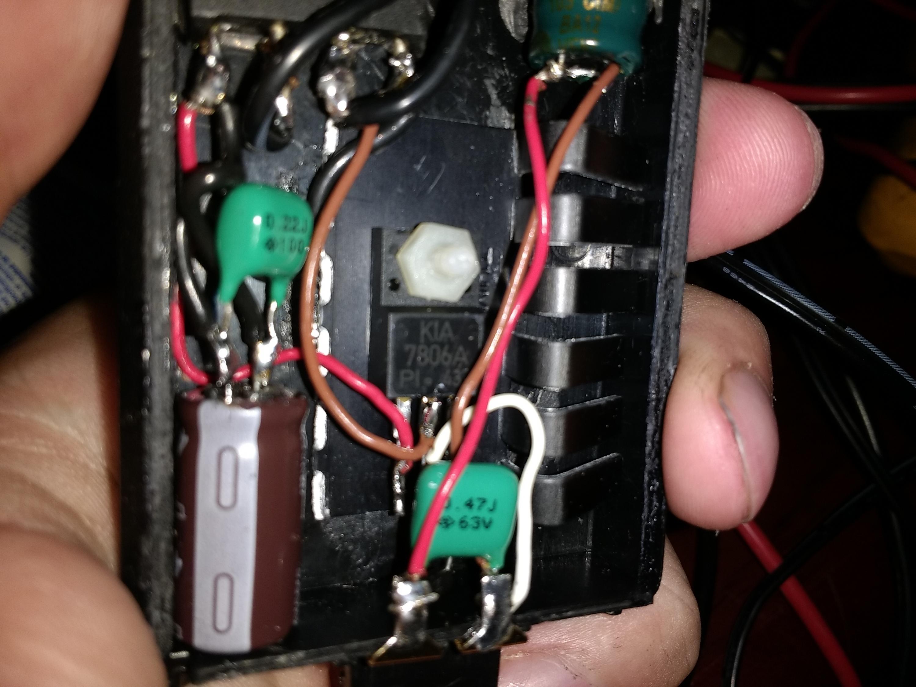

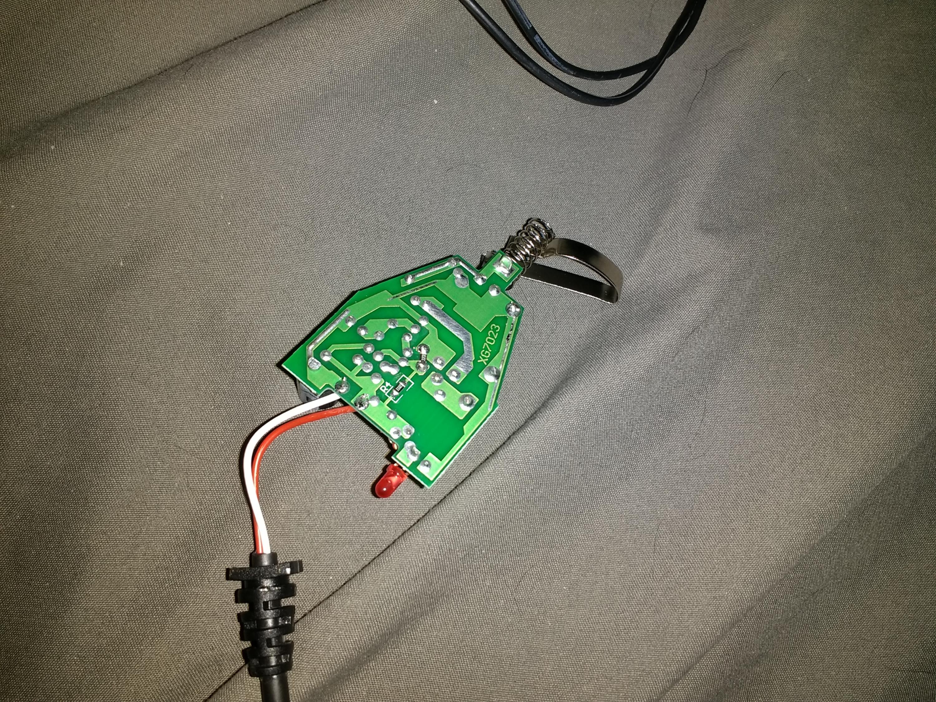

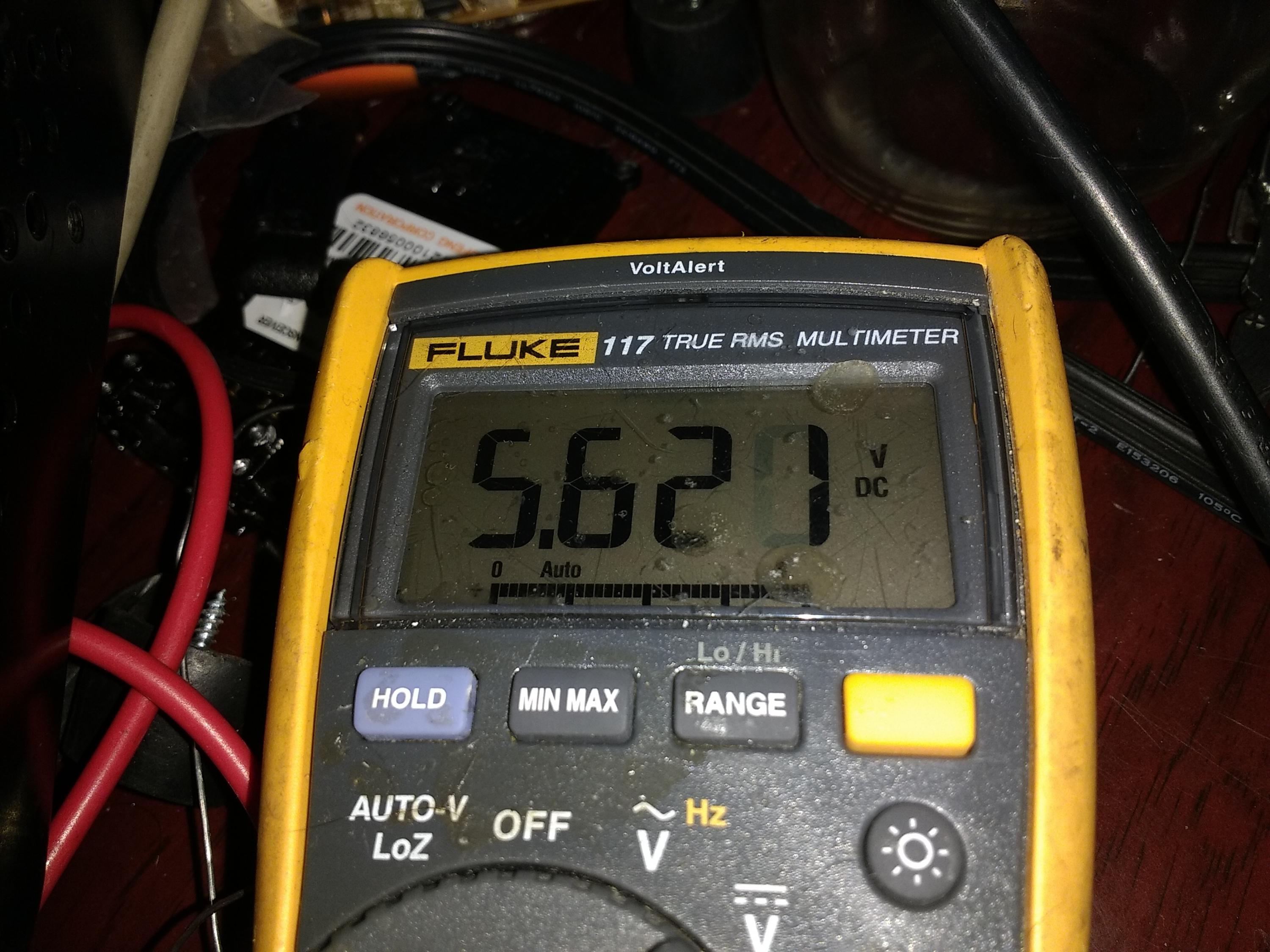

    Next, the picture of my first (Failed) attempt.
    Why it no work? battery dead? 5.5v? WTF

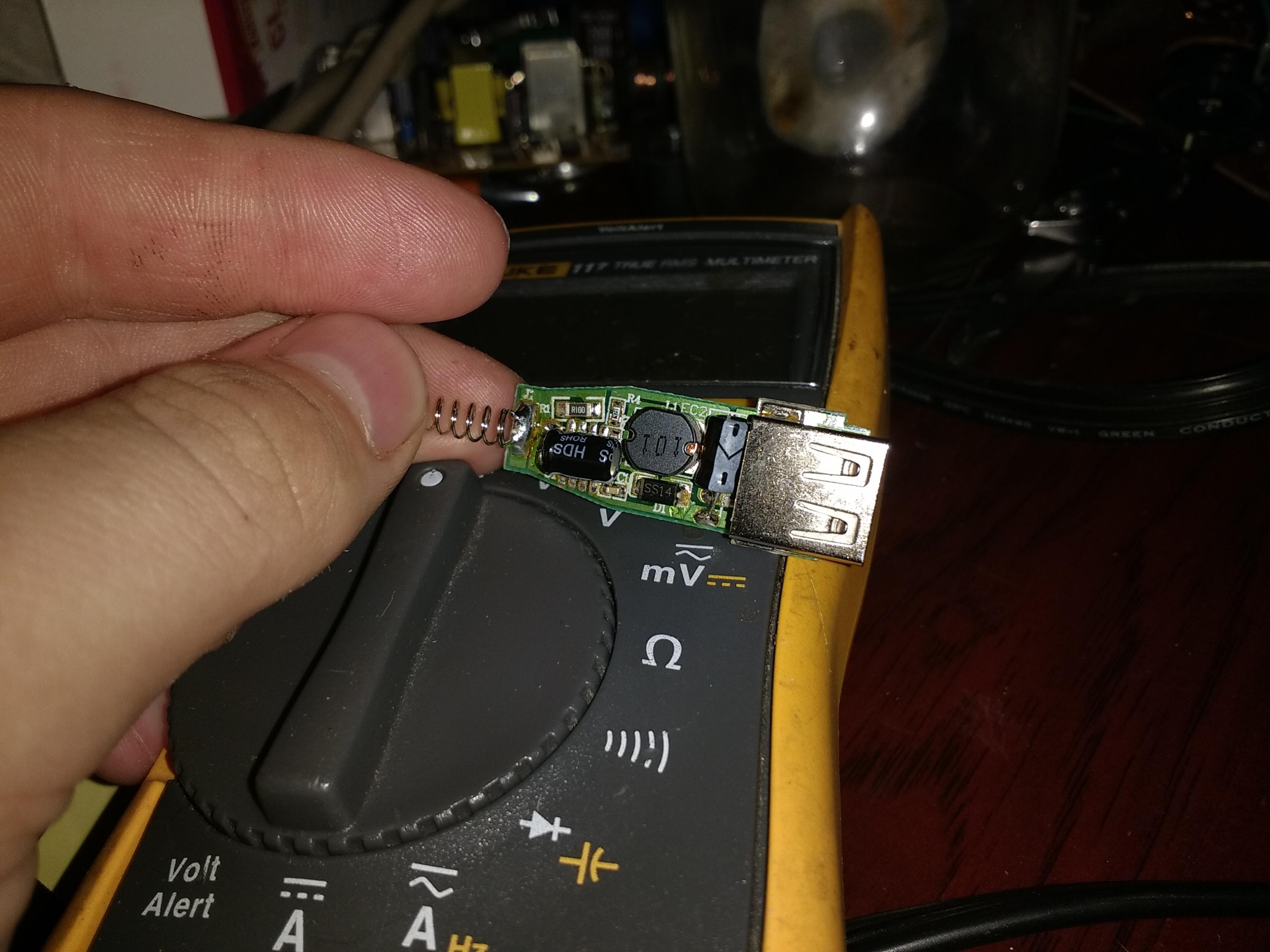

    Doh! I that read wrong. Thats a 6v regulator, not 8v
    Well, lets try switchmode then!

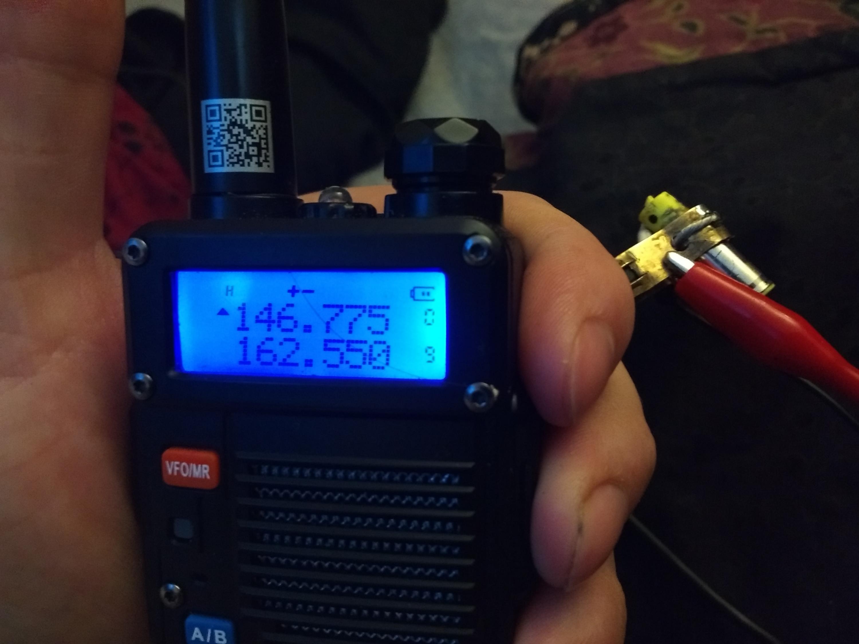

    It Verks! *pop* ...are you shitting me? It committed suicide. LED is out.

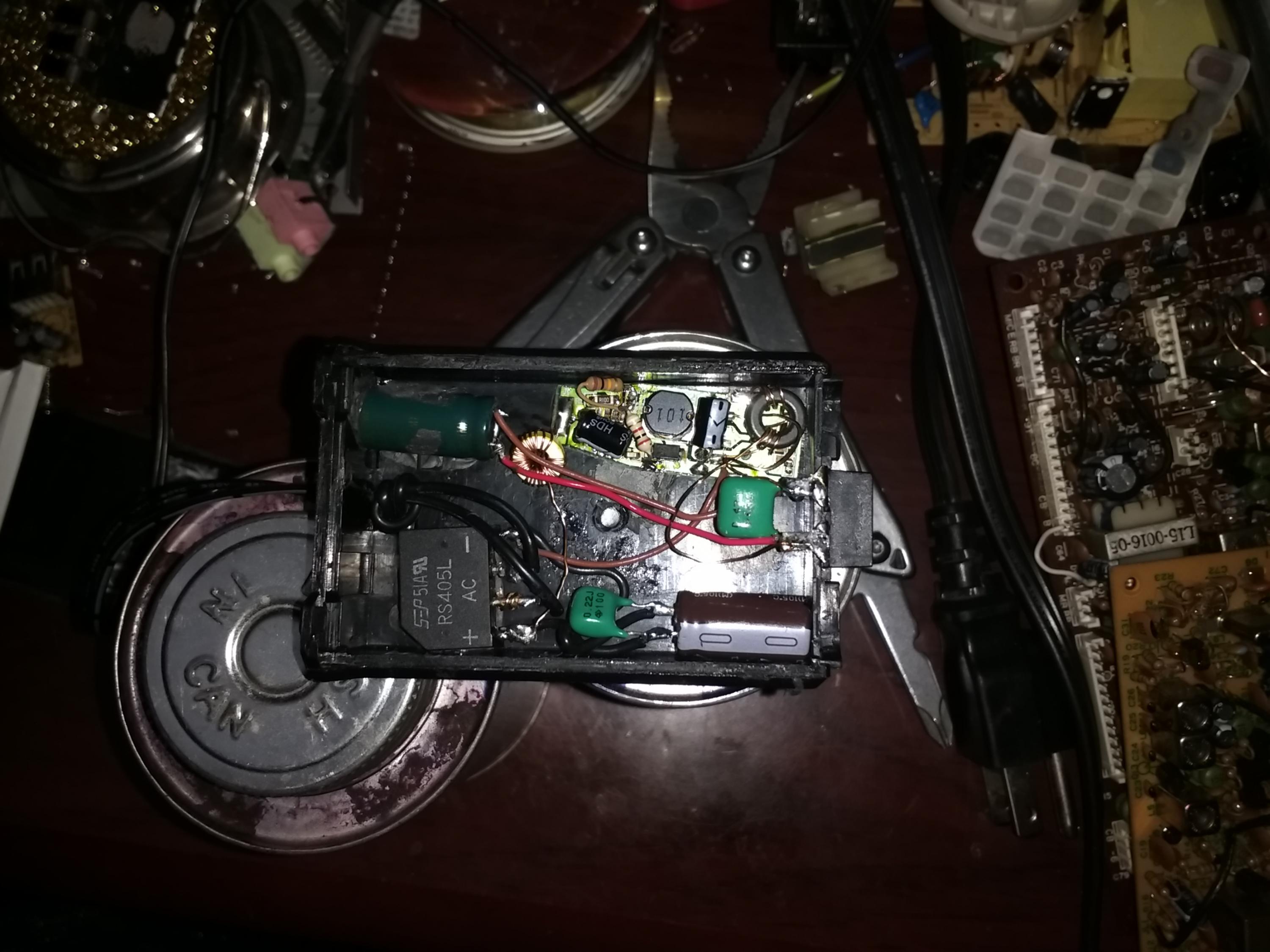

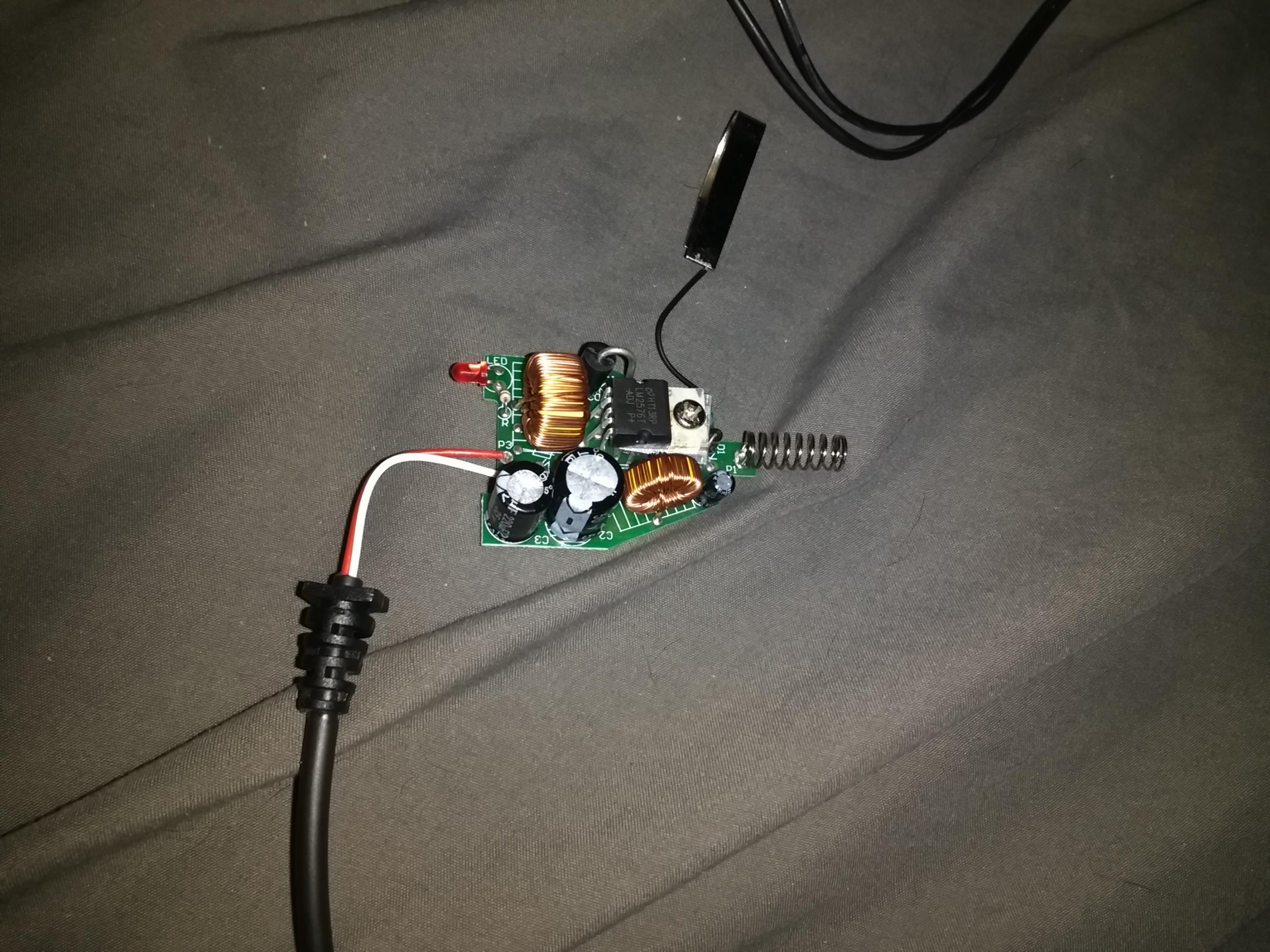

    Round 2?
    Round 2 Verks!
    Into the case it goes. I had the whole assembly process photographed, but oops.
    Still Verks!
    Well, glamour (shame?) shots then.
    I forgot the nylon nut and bolt.... Crap. I may fix that one day.

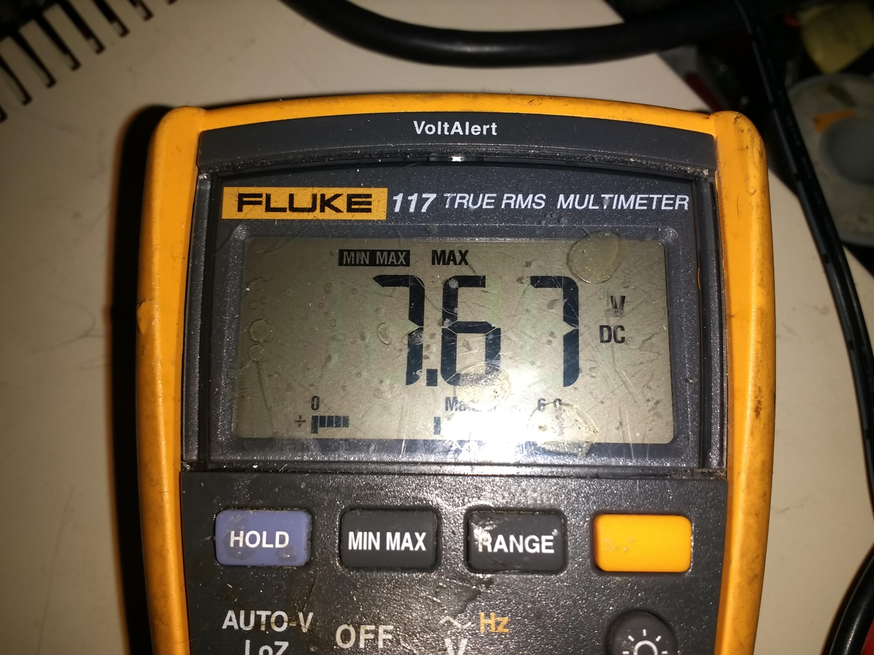

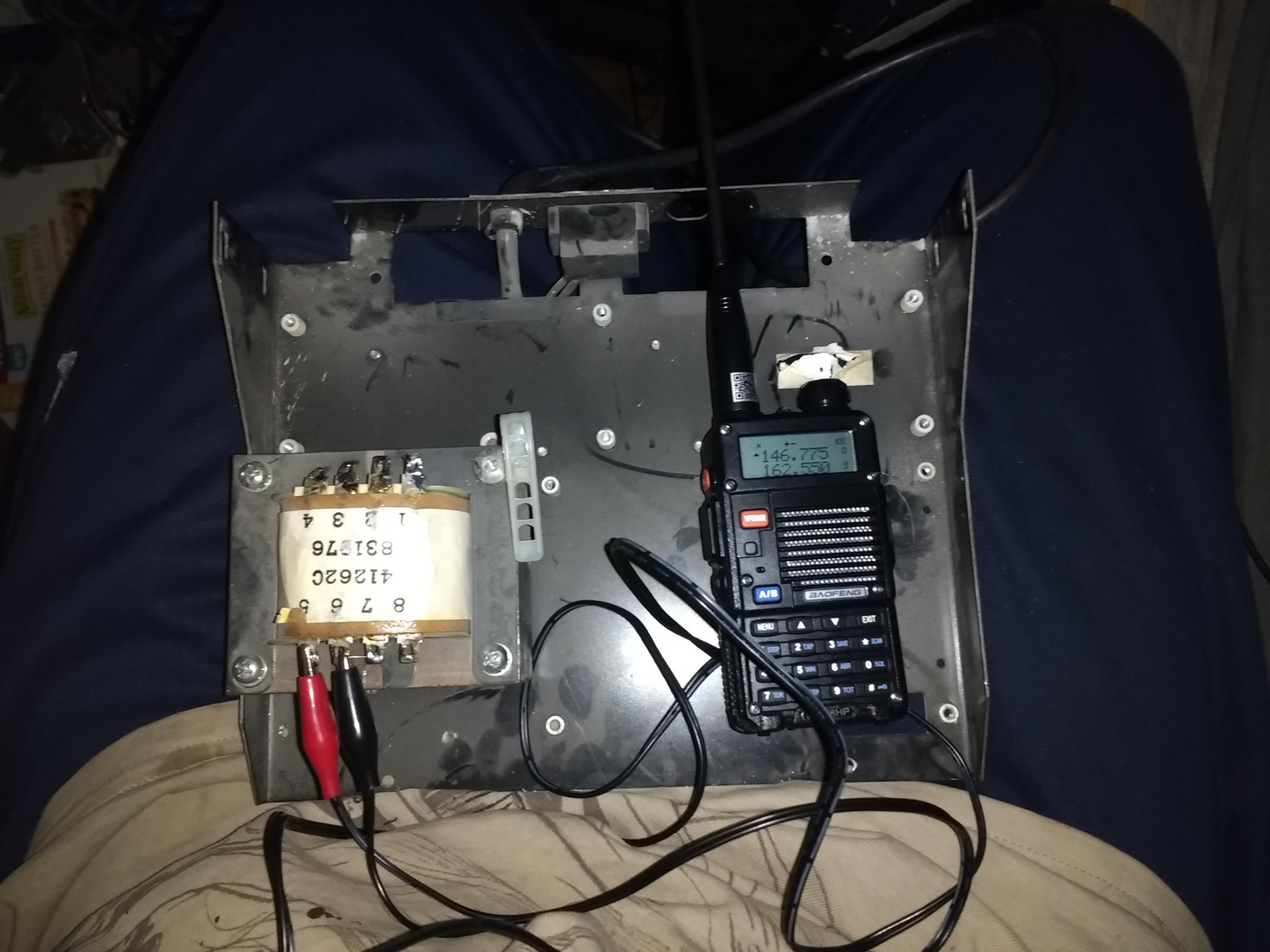

    DC 20v test. Looks good.
    AC 20v test. Also good.
    Let me shoehorn in some firmware fuckery proof here.
    IN: AC ~9v-30v/DC +/-10v-35v OUT:7.6vDC
    Not a bad little eliminator.

    Re: 2m/70c Radio battery eliminator build
    nice - a UV5R, (or is it the 8W model??)
    that is a bad idea - the regulator will cook when you transmit 5W.
    i would put the regulation at the other end of the cable with a heatsink on it.
    then use the battery shell for extra filtering - inductors,caps etc.

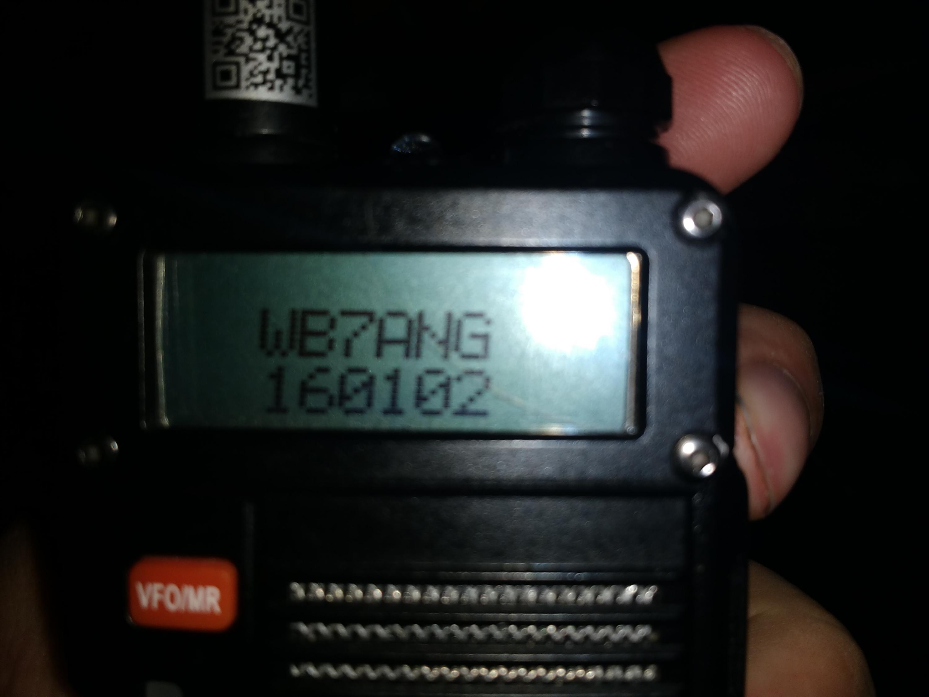

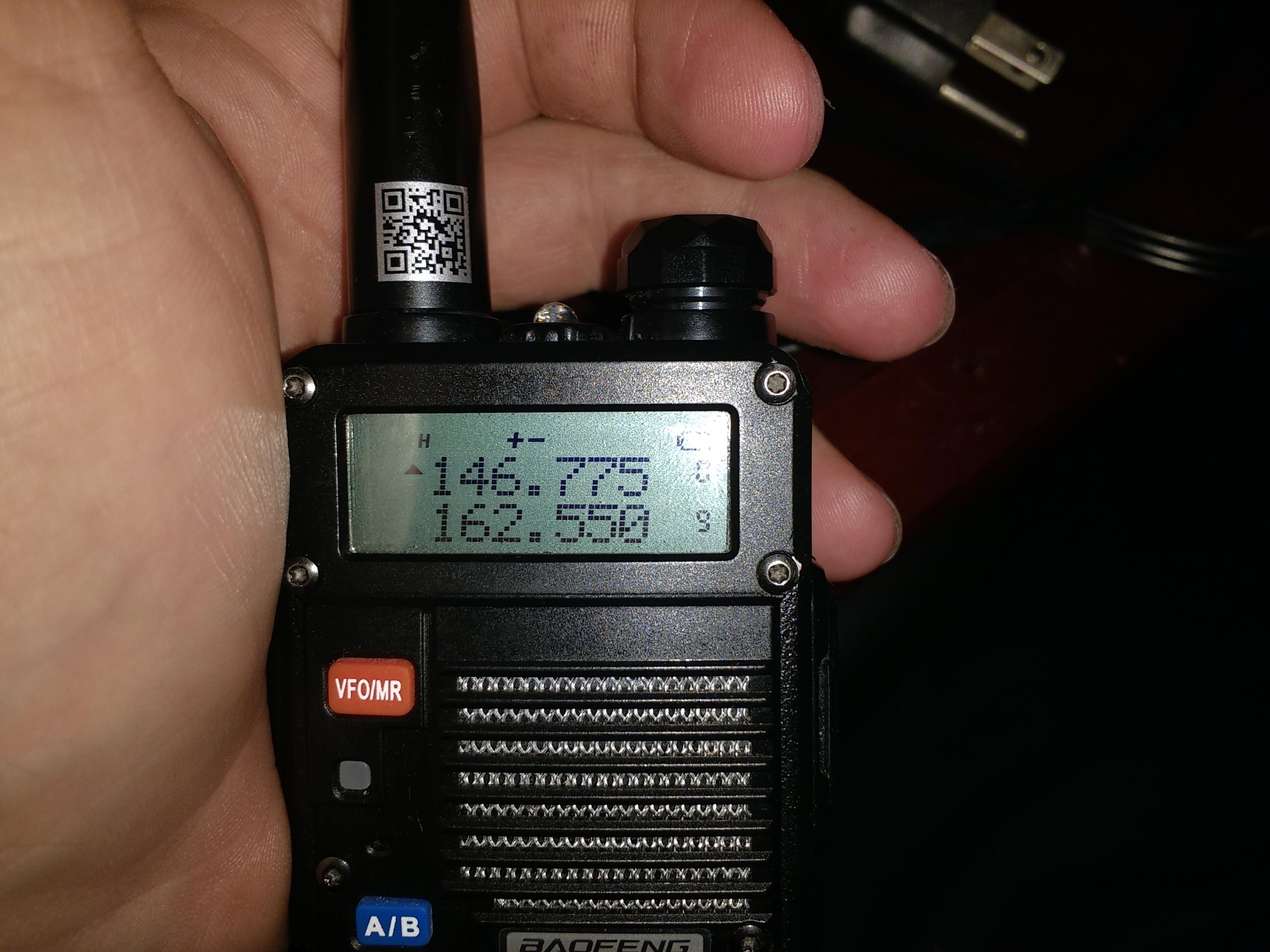

      Its the BF-F8HP. Ive been stress-testing it all day QSLing with the KC7SNO and WU7G/R (2m,70c respectively) repeaters and managed to catch some skip from Denver. My filtering is good enough it seems, and being a 3 amp regulator she gets a bit toasty, but nothing extreme.
        162.55 is the nat. wether sev. As I remember 144 . Mhz is 2 meter ham .
        • goontron
          5000!
          • Dec 2011
          • 4108
          • US
          ^ Yep. It can receive down into those bands. xmit, no. I was using it as a recive test. Interesting thing about the 775, its sponsored partly by the NWS, and they run nets on it.
          The daily weather net is at 6:45 am (local) on the 146.775 repeater.

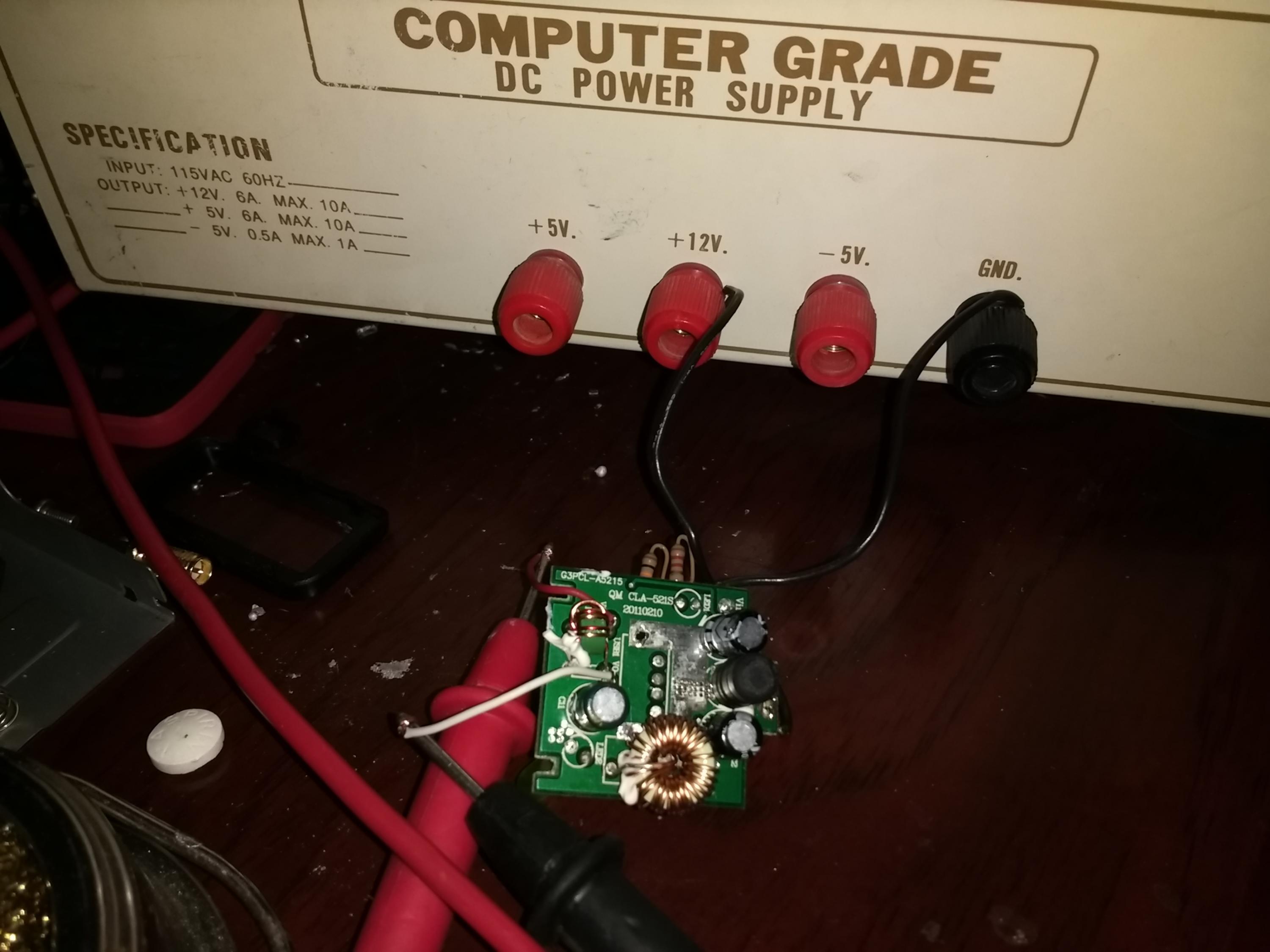

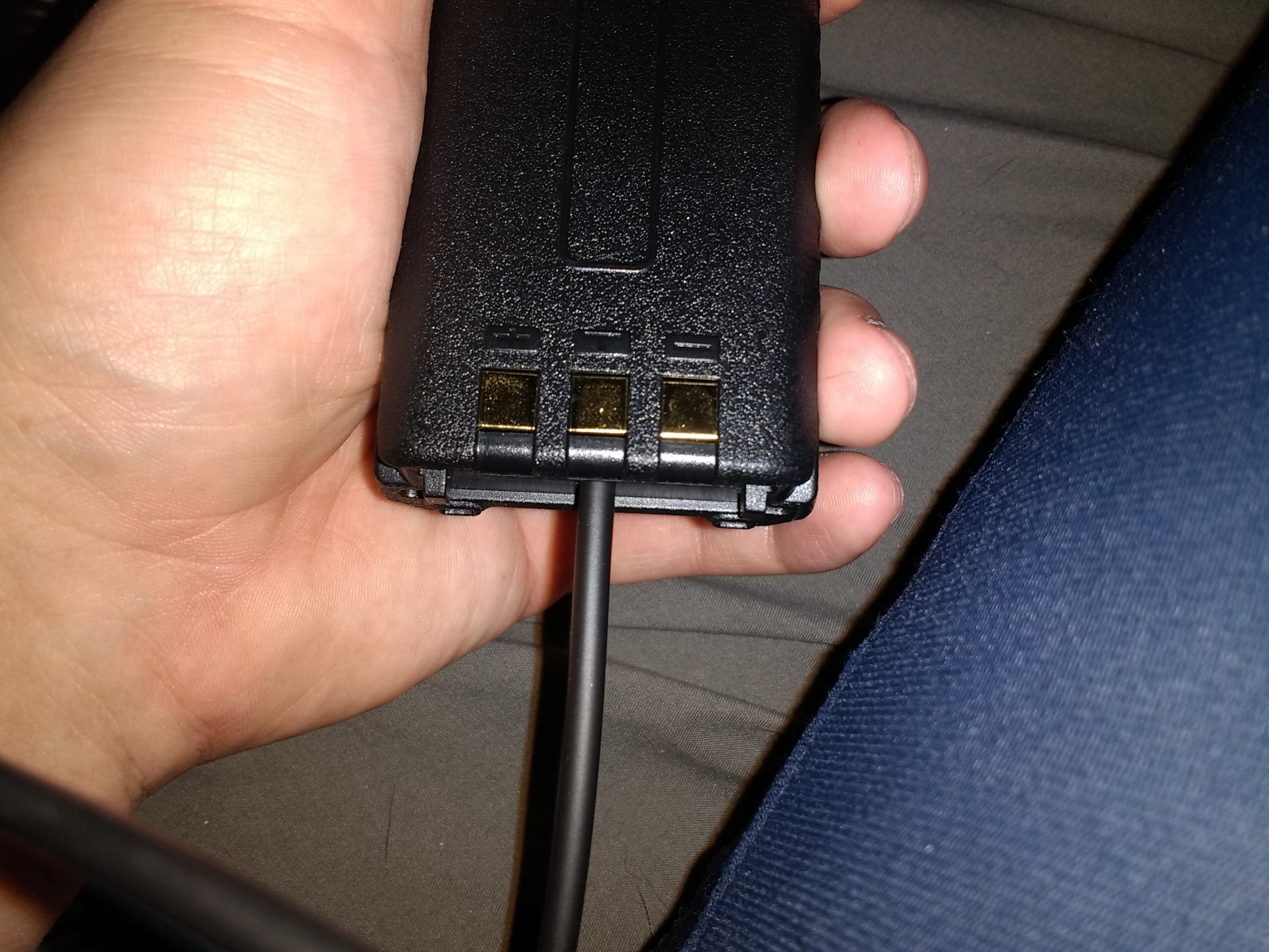

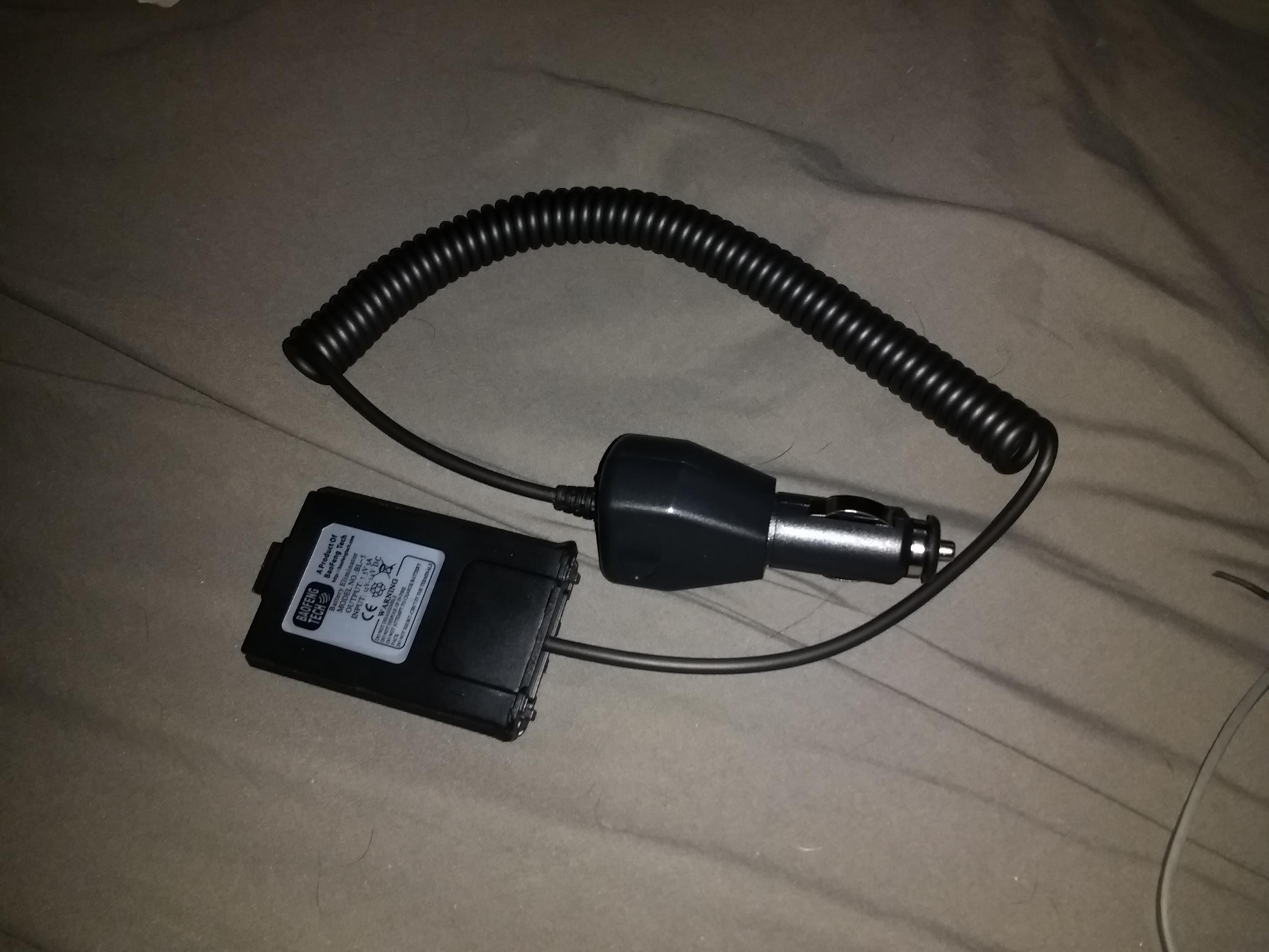

              So, i just wanted to post an update. I got the MFG's battery eliminator, and surprise surprise, it's an older design, same spec, with less filtering and no AC bridge. And a fuse.
              Glory shot
              Houston we have a problem. Why is the cord coming out the bottom? Well that won't sit in a cup holder!
              Houston, another problem. Dead short on the input! Diode pushed into the heatsink. Easy fix. Also, Focus you FAK!

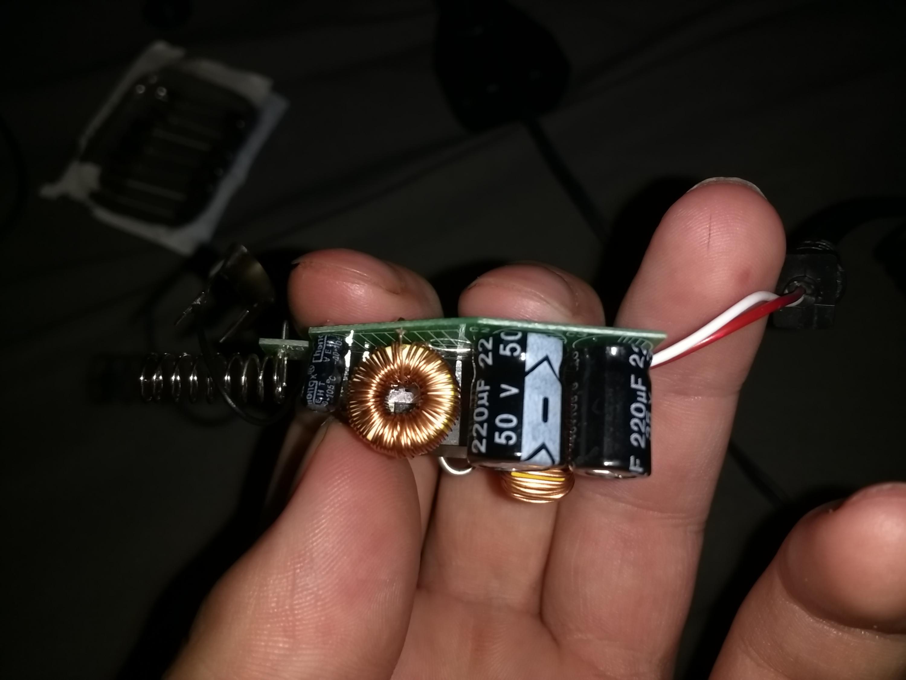

              ChengX caps. This is actually probably one of the better applications for these caps....
              Board overview. These is why i say old design. Single layer board, that chip was designed to be a simple retrofit with minimal redesign of the board from a linear regulator according to the datasheet, and it switches at a paltry 52Khz, compared to the 1Mhz in the one i built.
              The underside shows much room for improvement...
              Now for the reason i got this. It looks a hell of a lot better than a lighter plug to banana plugs, then a set of roach clips hooked onto them.
              I personally don't care, but my boss very well might while im opertaing a company truck. Though, with how the inverter is wired in......
              So, thats my excuse for getting it. Being able to see how close my design was compared to one built by the maker of the radio, was just a nice extra.
