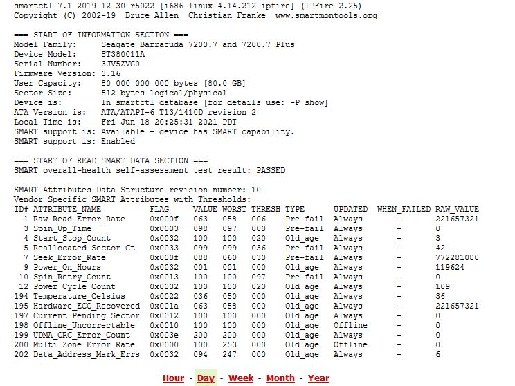

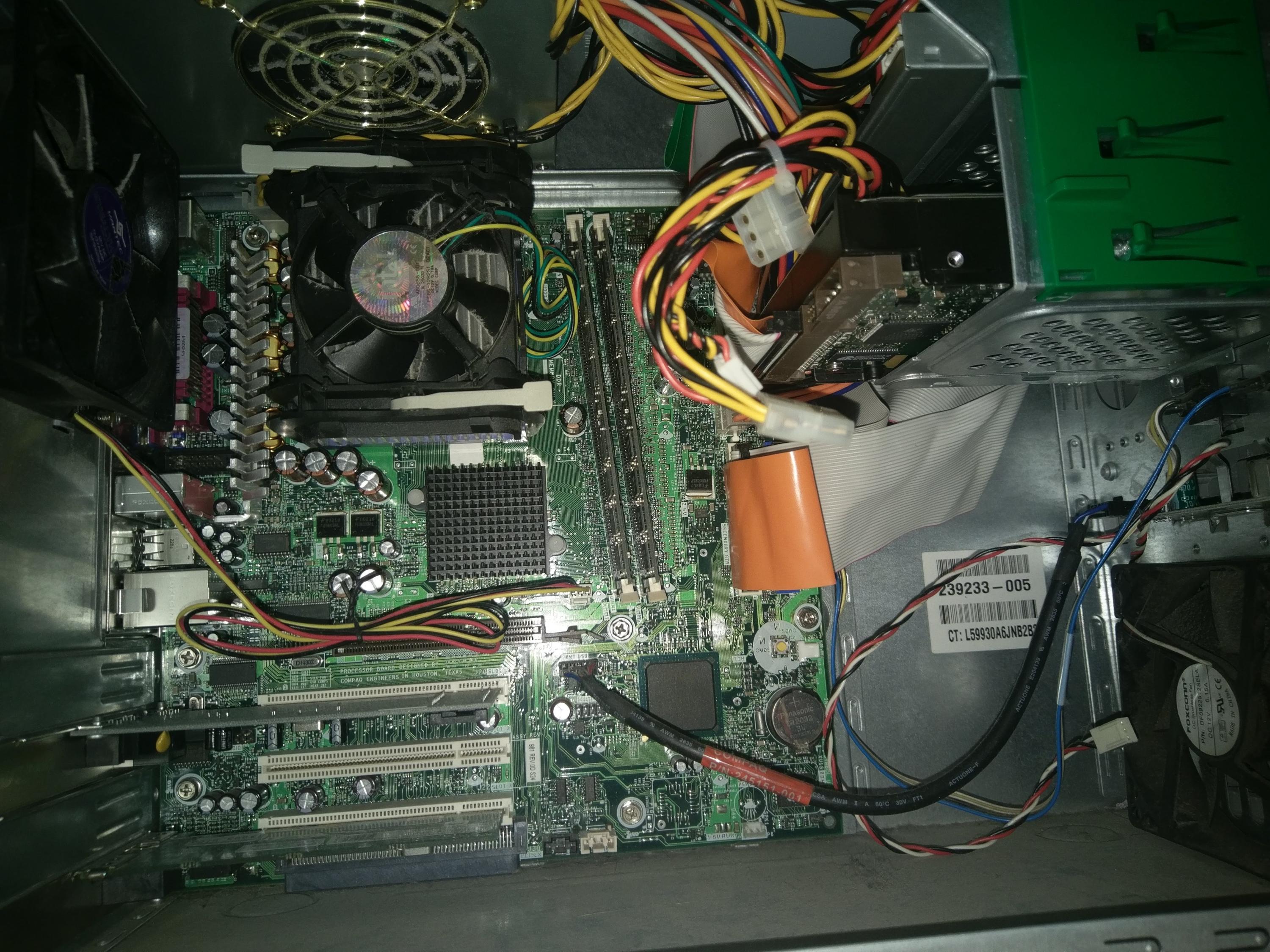

                            Here's the highest hours I've seen so far. This hard drive is badass. It had 90,000 hours when I got it. It was in a, wait for it.... SFF case with a Pentium D! Ouch! And the fan PSU failed, but it kept chugging along with bulged caps for who knows how long. So I put it in my IPFire box even though it had reallocated sectors. From the 90k point to this picture (June 18, 2021), it only gained 6 more reallocated sectors. It's currently retired since IPFire is dropping x86 support. That P4 box moved over ~63TB of network traffic while in service.
                            Here's a picture of the computer it was in. Was only temporarily unplugged lol. Most of those caps were acquired from Badcaps here and installed back in the day. Those alone have given that motherboard at least another 35,000 hours of life! The original 02 date code HNs failed at ~18,000 hours.
