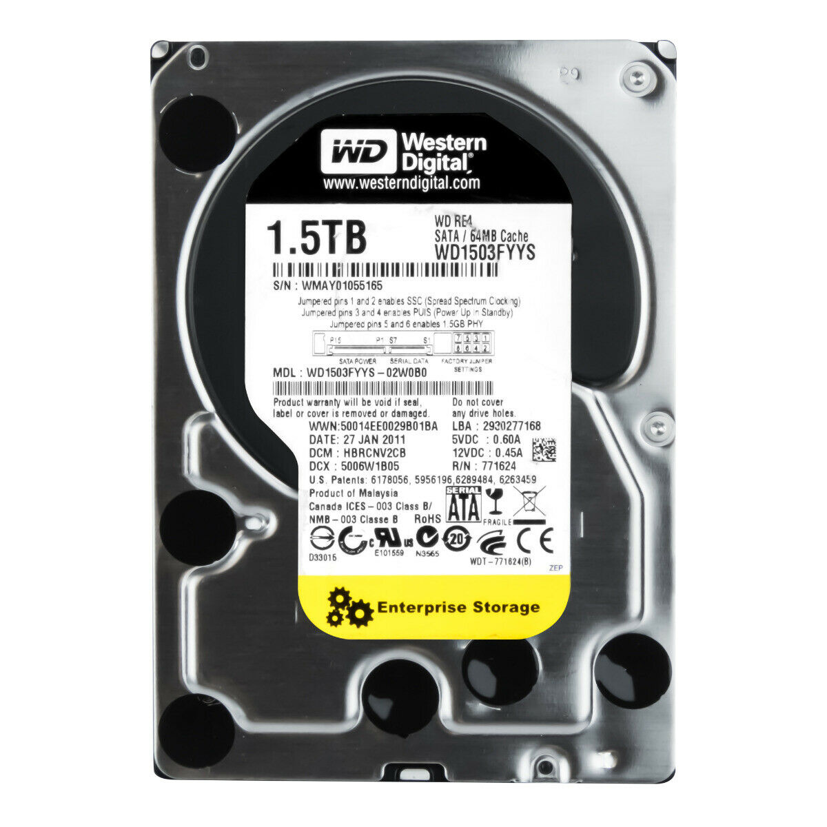

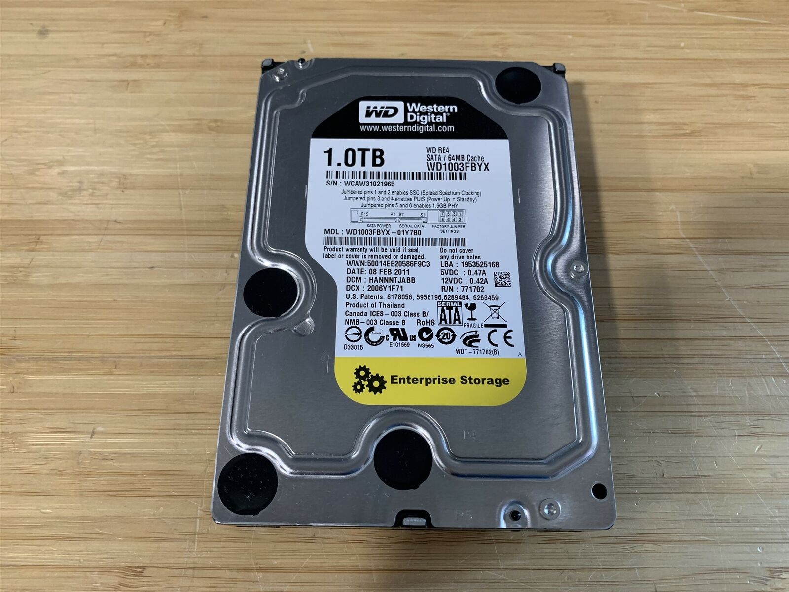

                                      BTW what's the "standardized" number of sectors for a 1.5TB and 1TB disk? I've noticed most 2TB disks were standardized across models and brands to 3907029168 sectors or something...

                                        #99
                                        Re: Hard drive reliability
                                        Here we go...
                                        Made a 1.4TB partition (supposedly good), a 250GB partition (bad stuff), and the remainder (about 300GB, supposedly good). Merged the first and third partitions with volume management... and now we'll see how this ~1.7TB volume goes...
                                          see the attached pics. some images off junkbay to help u.
                                          i noticed that the standardized number of sectors all seem to like ending with 168 for some reason. for 500gb hard disks, its 976,773,168 lba sectors. even the ssds seem to follow this convention! i recently bought a cheapo transcend qlc 500gb ssd and even that has the exact same number of sectors as a 500gb wd scorpio black hard disk i had in my laptop. needless to say, when i found out the sector count matched exactly, i migrated the hard disk to the ssd instead!
