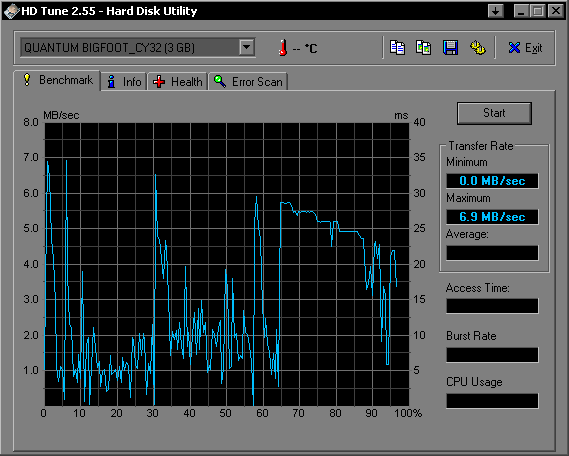

                      #50
                      Re: Hard drive reliability
                      Originally posted by Pentium4
                      Upload more!
                      Alright.
                      Ask, and you shall receive!
                      ... well, I'm going to upload the sound for only one hard drive today. But, I figure the details I put into this post should make it more worthwhile, as I think this HDD should be quite interesting to listen / read about. Mr. Goontron may want to pay special attention here .
                      What is it?
                      - A Quantum Bigfoot CY 3240A (3.2 GB) 5.25" hard drive that I found many many years ago back in high school out of a discarded socket 7 Compaq PC (from which I still have the mobo and PSU).
                      While this hard drive still works, it's not without some issues. And it seems those issues were present since day one when I got it (more on that below, in the history of the HDD). As such, this HDD has not seen much use in my hands - maybe 10 hours total in the last 15 years, if even that much. But I will let the SMART log speak for itself:
                      https://www.badcaps.net/forum/attach...1&d=1521783361
                      For those who do not wish to login to view it, let me give you a summary: the HDD has only 223 total running hours up to date, but with 1018 power (On/Off) cycles. I'm not sure why this HDD has so many power cycles, but I can assure you they are not from me (I don't think I am responsible for even 1/3 of those).
                      The worst part is not the power cycles, though. It's the bad sector count, currently at over 183 (HDD found a few more after saving the SMART log last week). And moreover, I haven't even attempted to do a full sector scan with HDTune. I did only a quick one, and that revealed a bunch at the end of the drive. When I tried starting the full scan in HDTune, the HDD was finding bad sectors almost every 5-10 seconds, so I stopped the scan (it was late at night, and I didn't want to wait for it).
                      That said, I did get some very interesting sound recordings out of this Bigfoot HDD. Here is the first one after the HDD sat idle on my shelf without power for possibly more than 4-5 years:
                      When I heard the first part of this sound recording, I thought the HDD has sure finally gone to e-Heaven. For those confused what I am talking about or just plain curious what they are hearing in this clip, here's a timeline of the sound above:
                      @ 3 to about 9 seconds into the clip, HDD spins up to speed (3600 RPM, hence the loud 60 Hz "rumble").
                      @ approx. 10.5 to 11.5 seconds, the HDD makes a clicking noise, inditacting that headstack calibration is about to begin. But soon afterwards, a hollow metallic "bong" sound is heard with the heads retracting back into parking position due to a an error in calibration
                      @ approx. 13.5 to 14 seconds, the HDD attempts another calibration cycle. Here, you can hear the HDD head click several times before the hollow metallic "bong" sound is heard again, indicating that the heads have retracted and calibration failed once more.
                      @ between 16 and 17 seconds, as well as 17.5 and 18.5 seconds, the HDD attempts two more head calibration cycles like above. After the last failed one at approx. 18.5 seconds, the HDD gives up and spins down automatically.
                      @ approx. 29 seconds, I cycle power to the HDD to try another attempt at making it work.
                      @ approx. 36.3 to 36.75 seconds, there's another short failed head calibration attempt.
                      @ approx. 39.1 to 41.1 seconds, the HDD finally does a proper full head calibration and appears to work normally.
                      @ approx. 50.6, I disconnect power to the HDD, and it automatically parks its head (that same metallic "bong" sound) and spins down.
                      After this whole scene, I decided to record another boot up sound, thinking I might get a more clear recording. But as you can hear on the following recording, there are some weird stray bearing sounds - it seems that this HDD is also either starting to develop bad bearings or perhaps they were of poor quality to begin with.
                      With the this Bigfoot HDD finally able to spin-up without issues, I decided to connect it to a computer and run some benchmarks, as well as look at the SMART log (that I posted above). While the SMART log didn't surprise me much with the bad sectors, the HDTune benchmark did a little bit. Here it is:
                      ... yup, 6.9 MB/s is the maximum transfer speed I attained with this drive. Sure makes me appreciate the speed of modern drives - even on not so modern ones, like the 80 GB Spinpoint that's in the computer I'm typing this from right now.
                      But as you can see from that graph, the HDD is indeed quite sick. During many times in the benchmark, this Bigfoot HDD made the same hollow metallic "bong" sound multiple times, indicating the HDD has hit a bad block/sector - and hence the 0.0 MB/s minimum transfer speed. You can also see the benchmark did not fully complete. This is because near 97-98% of the way, the HDD found too many bad sectors and thus making HDTune drop the benchmark. After this, I attempted two more benchmark tests, but they both failed much earlier.
                      After this, I ran a quick surface scan, and got more interesting sound recordings. Here you can hear how this Quantum Bigfoot HDD sounds when it finds a bad sector and attempts to reallocate/correct it:
                      The HDD finds the bad sectors around 8.5 to 9 seconds into the sound clip above and finishes correcting them at around 16 to 18 seconds. (You may also hear a slightly different background font. This is due to the HDD being installed in another computer - an HP Pavilion 8756c with a loud IBM Deskstar DTLA-305030 and rumbling CPU fan running at 5V for more "silence").
                      Now for a little history about the HDD:
                      I found it around 2004 or possibly early 2005, I believe. At that time, big flash drives (256-512 MB or more) were rather expensive, so I started using the Bigfoot above as my first "portable" HDD to move files between my main PC and another offline PC I had at my uncle's house. Before that, I used to burn CDs like crazy, as it was the only way I could move big files around (DVDs were out of the question, as DVD writers were still expensive at the time... at least to me). I used the Bigfoot a few times for about a year or so. Unfortunately, it didn't turn out to be too reliable of an HDD, despite its looks. In fact, I remember back when I first formatted it, the format took several tries and a very long time (almost 30 minutes, if not more). The HDD made strange noises on the first attempt as well. But after it formatted, it appeared to work normal, so that's why I continued to use it (NOTE: I was a complete PC noob at the time). Anyways, on the 3rd time I tried to use the HDD to move files to my offline PC, the HDD hung on a few files that I really needed. Since then, I retired the hard drive. I did still use it for a few test PCs a few years later, but not much at all by any means. By that time, I already had a 512 MB flash drive, as well as a 30 GB Quantum Fireball LCT 10 HDD that I scored on eBay for relatively cheap at the time.
                      In any case, that Quantum Bigfoot HDD was never reliable to me. Despite that, I elected to keep it simply because it looked and sounded too cool. So here it is many years later awoken to be heard once again. I hope you all enjoyed.

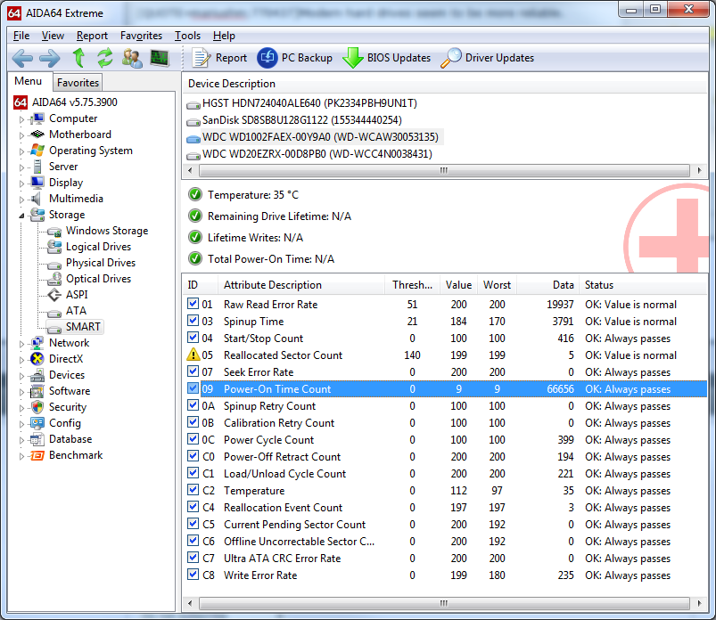

                                  Modern hard drives seem to be more reliable.
                                  Anyway... time to buy another 4 TB drive to replace the 1 TB drive....
                                  The Seagate 2 TB drive died on me maybe 2-3 months ago... i expected it to die before my WD drive, still sad I didn't manage to backup some of the movies i had on it (nothing i can't download again but not easy)
                                  The black WD 1 TB still is the champ with 66k+ hours:
