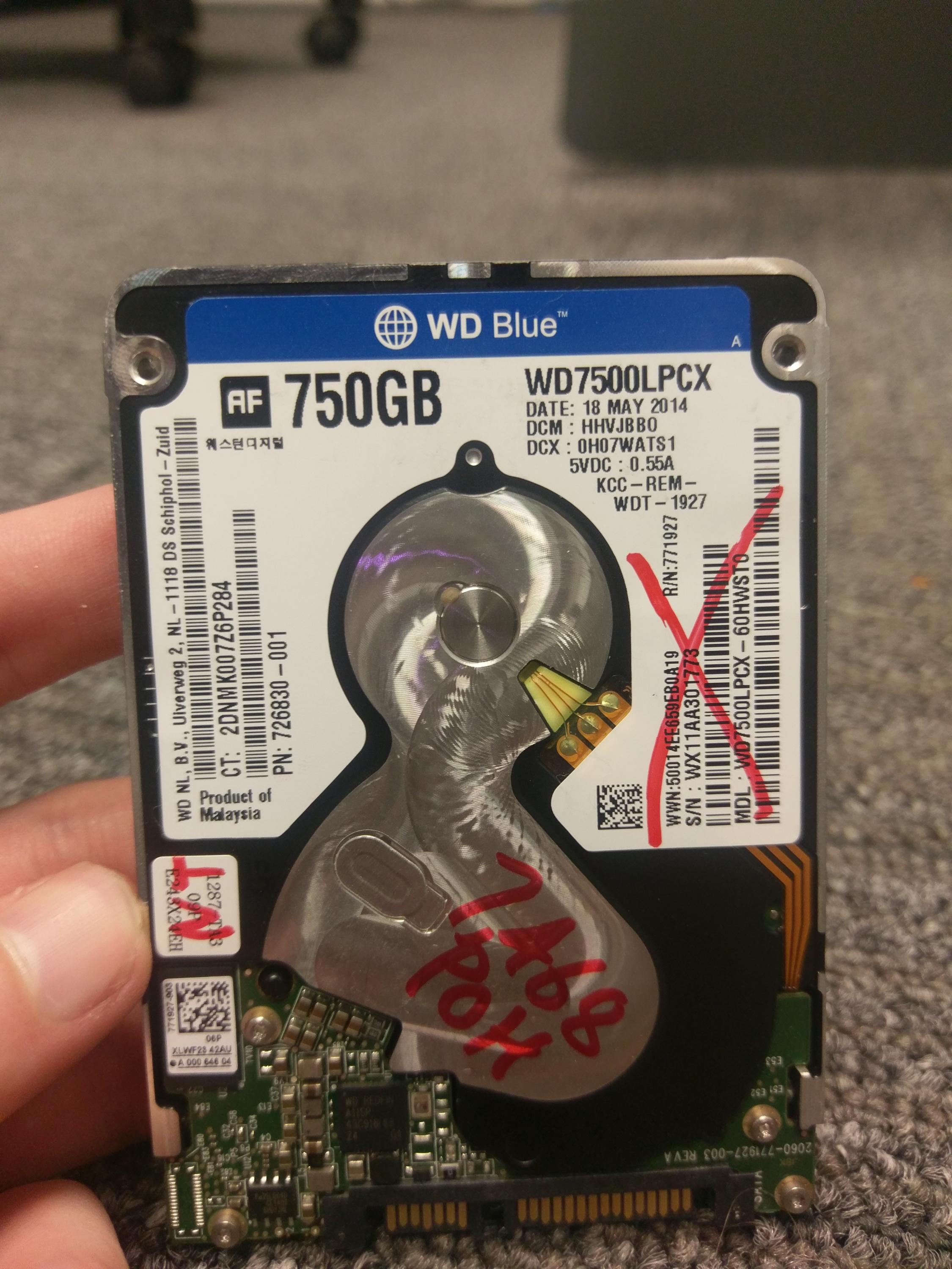

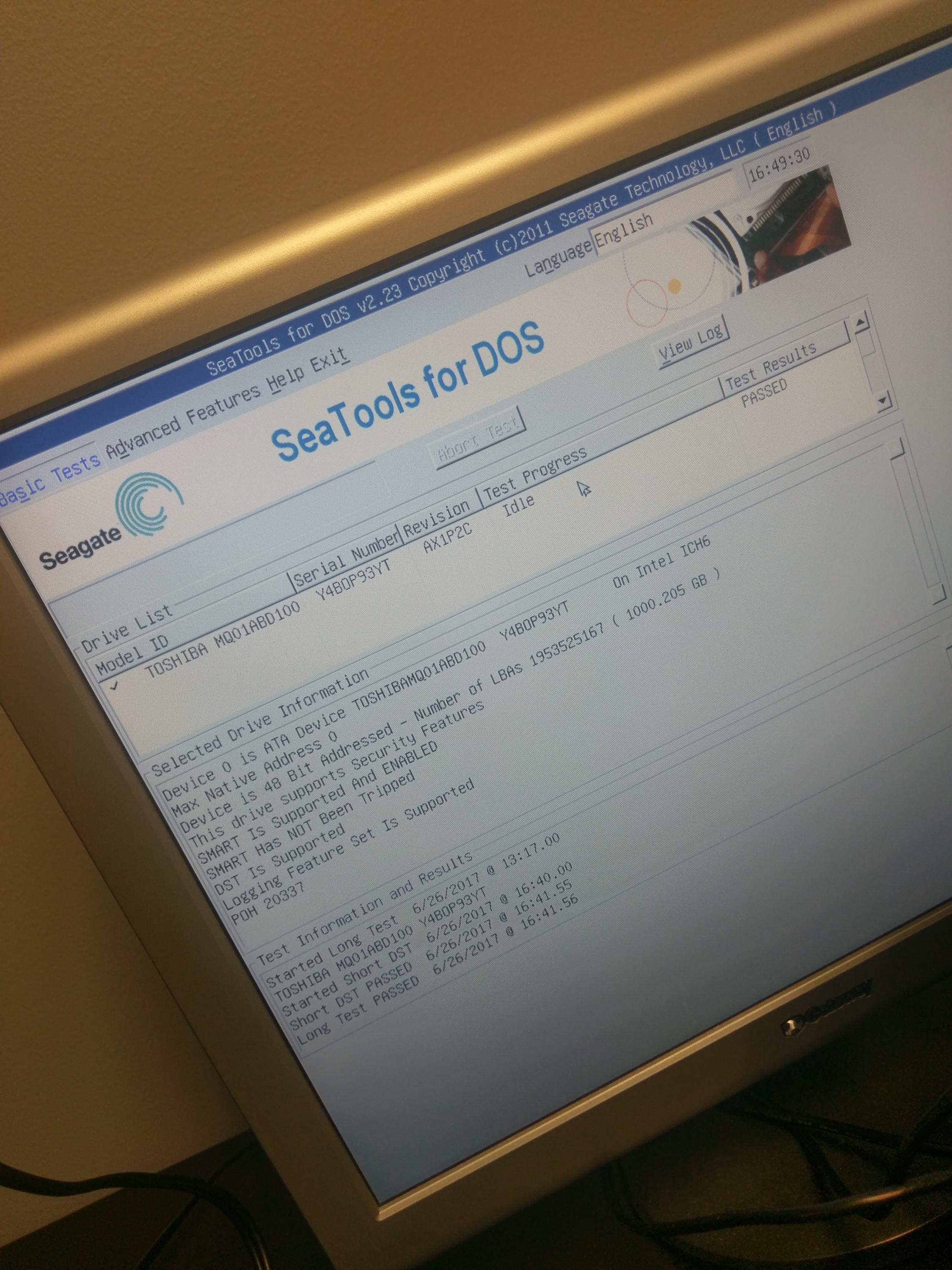

    2013 1TB 2.5" Toshiba drive made it over 20,000. Being used as a backup drive for my brother now.

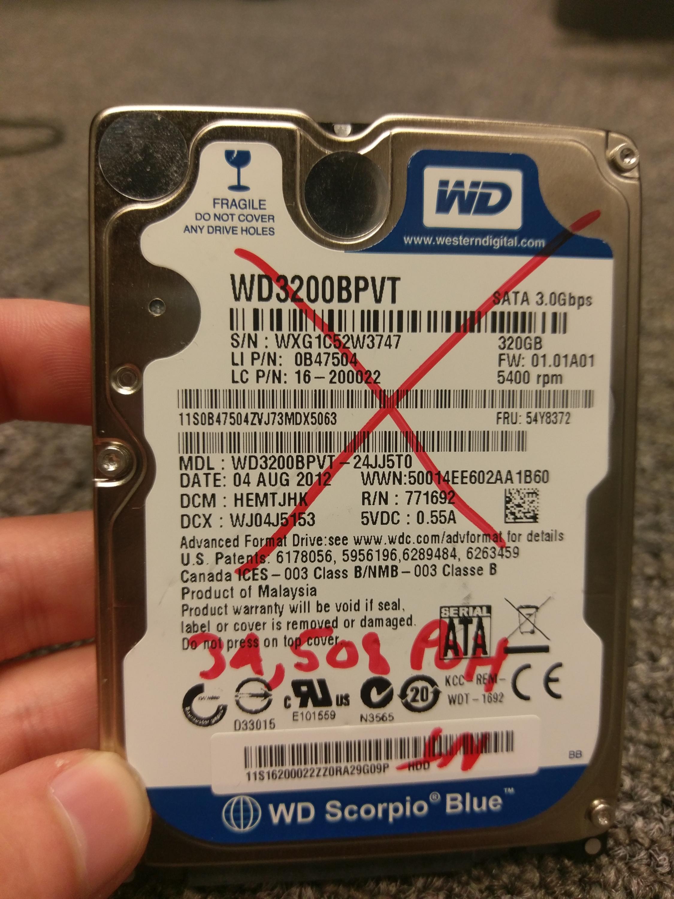

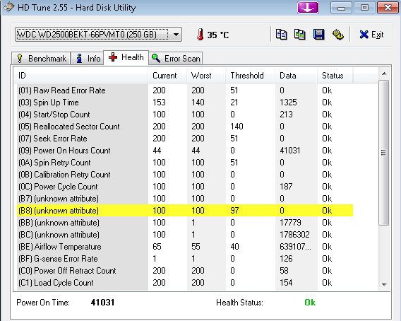

    This 320GB 2.5" WD drive did pretty good. It was in a laptop and had over 4,000 power cycles. Most of the drive was good. It only had 7 bad sectors and my HDD Regenerator program could not fix them. It was bad enough that it would freeze the OS that was on the drive. Overall I'd say it did its job, considering most people are stupid with laptops and have no sense of treating things with care.

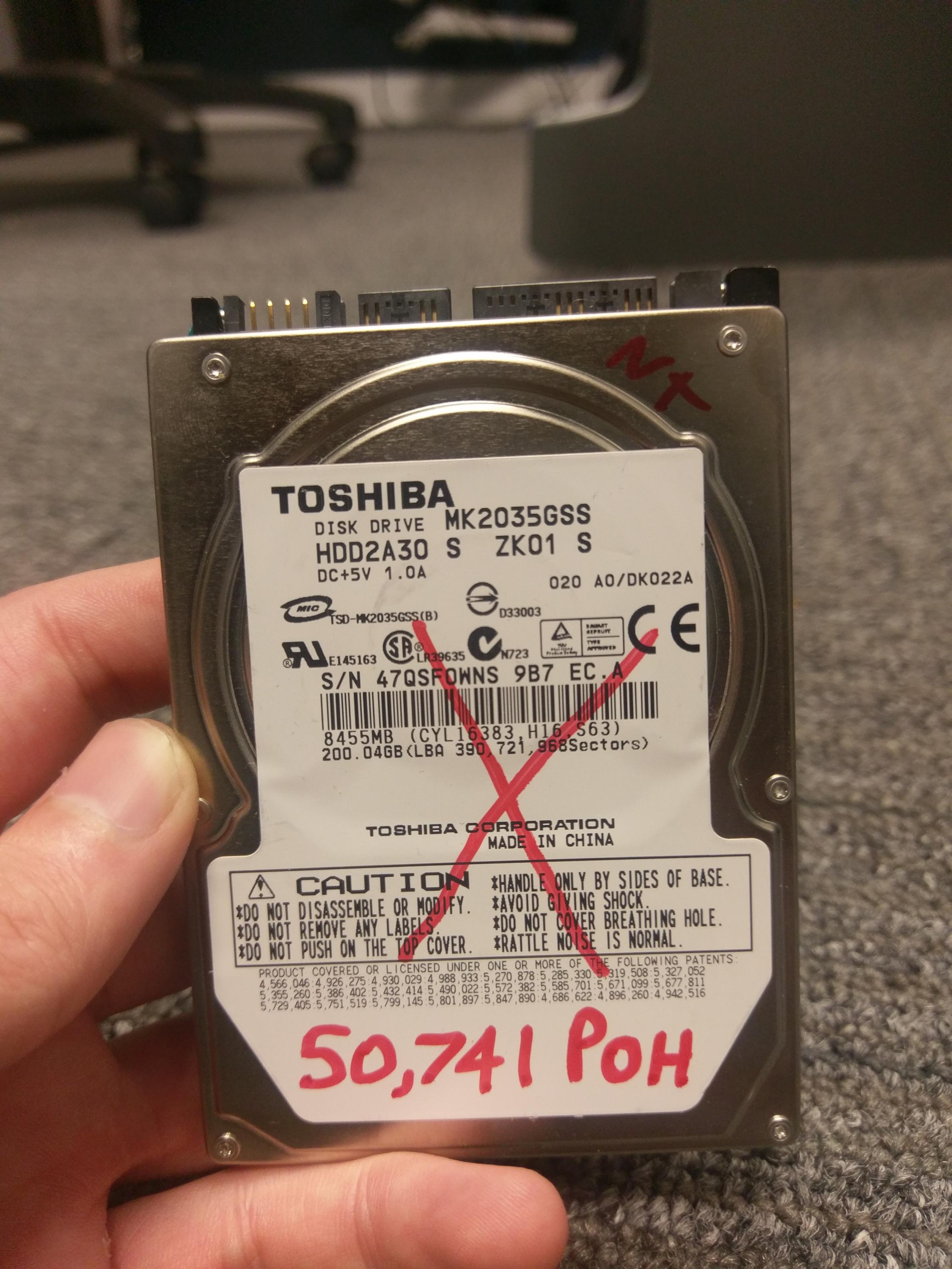

    I've never had good experiences with Toshiba drives but this one showed me they're capable of making a decent drive. This was in a laptop made in early 2010 and it surely had a useful life span. It had bad sectors at 7% into a drive scan, but upon trying to repair them, I heard it fail completely! I heard some really loud clicks and the drive spun down never to spin up again. I gave it a pat on the back and told it that it did a good job
    This thing just sucks....Didn't even make it to 8,000 hours. Was even in a laptop being used as a workstation so it was almost never moved. When trying to repair the disk, it would freeze the computer. Awful...

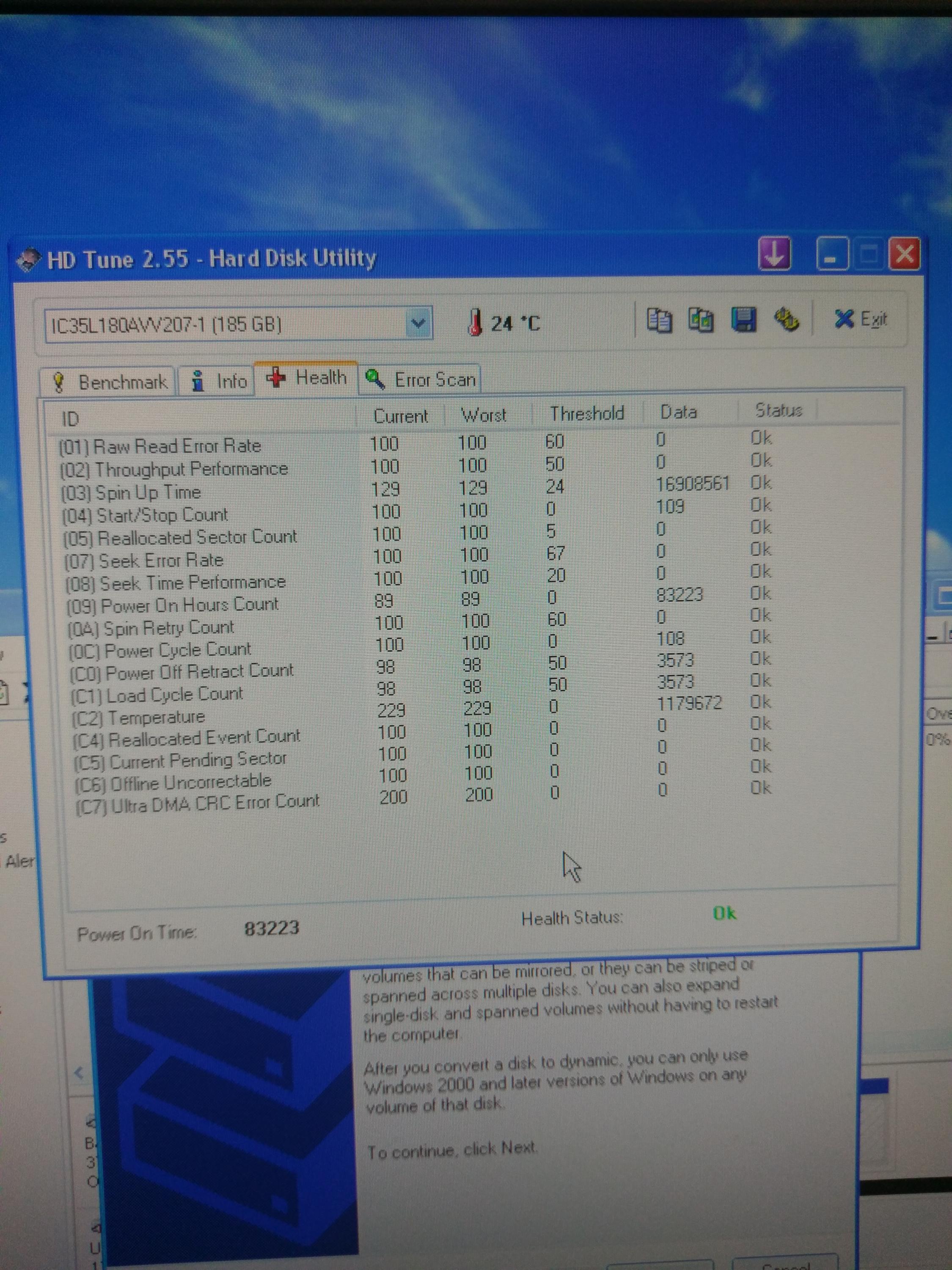

    This thing was in a server deployed in early 2003. It ran about 24/7 into mid/late 2012. It's a 182GB IBM IDE drive. I plugged it into a Socket 423 system that I built in my office just to host files/tools that I use. I took that picture on 3/30/17 and actually hasn't been power cycled since, so it's almost at 87,000 POH now!

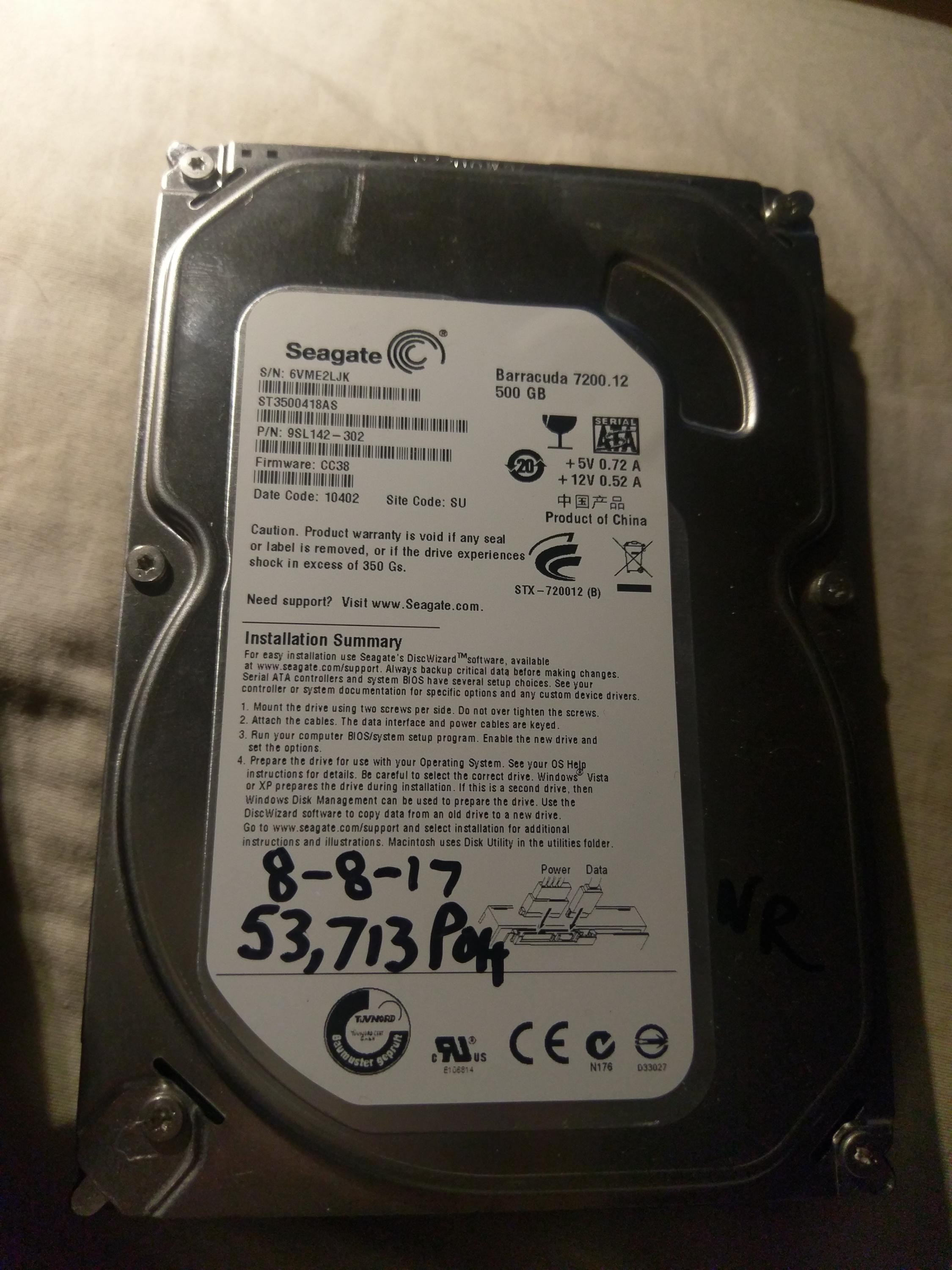

    Here's a Seagate drive that's lasted a while.

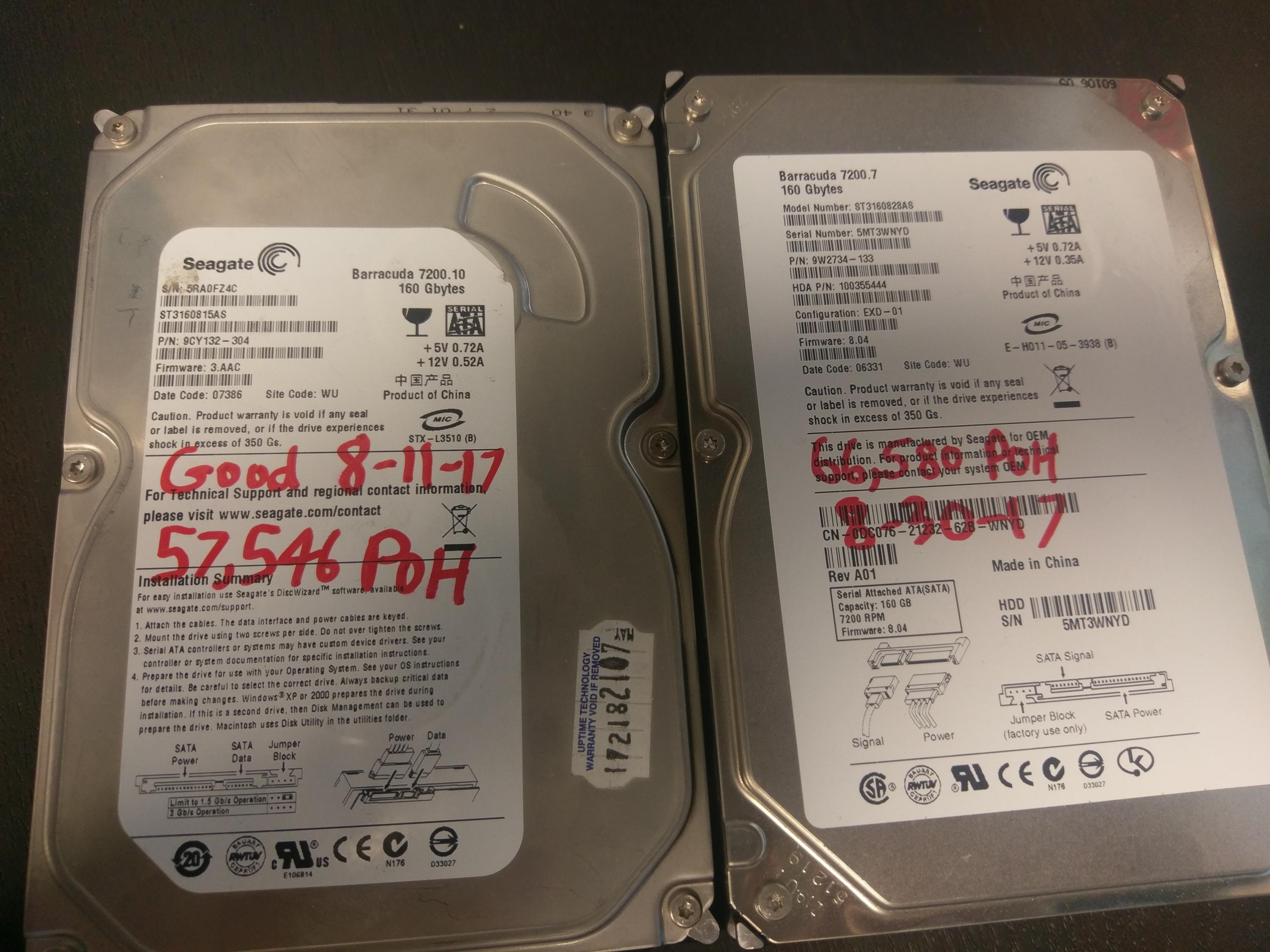

          Some more reliable drives.
                                  It retains very well those units , for me they are the best, they will not be manufactured units like these again.
                                  By the way, I also love to check the POH in the units hahaha.
                                  If you do not mind, I can share my units so you can see how they are .
                                  I agree, the Seagate 7200.7, 7200.9 and 7200.10 series are the most reliable.
                                  I have several of the 7200.10 and none shows problems, and have passed the 30,000h of the average, something that surprised me a lot, they are all IDE.
                                  And I have a Maxtor IDE from Seagate's 7200.10 series of 160GB, it's 55,000H if I remember correctly (I've had it disconnected for a long time)
                                  And laptop disk, the longest I've ever seen, was a hitachi of 2.5 of 160GB with 46,000h and had no flaw .
                                  That yes, the HP notebook broke the plastic to clusters, although it worked very well for the hours it had, including the screen had a lot of brightness.
                                  I withdraw this Seagate in May, just when I reached 100,000H began to relocate sectors, poor: '(.
