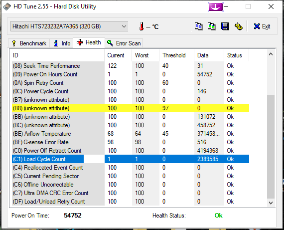

          How the hell is this thing still alive???
          It's a 2.5" drive made in August 2012. I'm currently beating it up with torrents, so I don't believe it'll last much longer lol.
              https://www.badcaps.net/forum/attach...1&d=1645075632
              Maybe it's counting the minutes and not hours?
              In that case, 2 389 585 comes out to about 39.8k hours.
              I have a few old Hitachi/IBM and Maxtors that count in minutes and not hours.
              Just keep HDTune open and see if the "POH" increments by "1" every minute or so. If yes, you have an HDD that counts "POH" in minutes. As for why or who thought this was a good idea... I haven't a clue.
                  The POH counter there is accurate, I watched it I was referring to the Load Cycle Count. Aren't drives usually rated for 300-600k? 2.3 million load cycles is insane, I'm just surprised that the head hasn't worn out. I hate power saving features. It hasn't gone up one since changing the power settings.

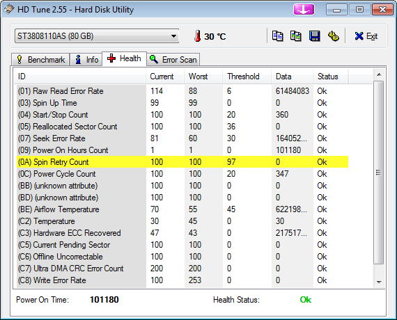

                    This is the most POH I've accumulated on a SATA drive. This was a few years ago. I believe it was around 109,000 last time I checked. In perfect health! It's been with the same Pentium 4 the whole time. What an amazing system.
