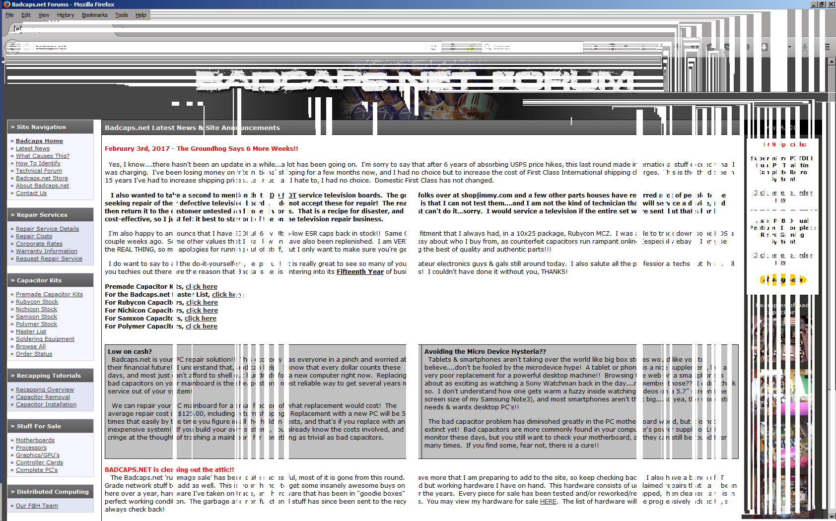

    hard locks grapics corruption CPU,RAM,Other
    So far switched GPU same issue.
    Switched Ram Same issue.
    Hard locks are random.
    System configuration is.
    MB. Gigabyte 990FXA-UD7 V3.0
    CPU. AMD FX-9590
    RAM. two of KINGSTON KHX1600C9D3/8GX
    PSU. corsair AX1200I
    Setting cpu at lowest possible speed helps a lot but still Causes render corruption.
    In this example dragging notepad over firefox.
    Does not affect all programs from what i have noticed but is a symptom I Think.
    here is a example of corruption.

    buggy drivers, or a psu issue are the next suspects.

      Sometimes if you switch GPU's the system way have several drivers installed and in older versions of Windows this could cause allot of problems.
      I used to use a software called "Driver Cleaner .NET" (paid for software).
      It was good for this but of course nowdays if you Google for it it's been replaced by something which will probably do more harm than good... (so don't download it).
      But the question still stands: what OS do you have this problem on and have you tried a clean install?

        Joshnz, i had a similar problem with a pc some months back, customer reported that any time he tried a Render in SolidWorks or tried a screen refresh the pc would crash on a corrupted screen, initially suspected SolidWorks but eliminated that as it still happened on Screen refresh, i carried out a full service on the PC including Driver updates all to no avail, tried changing Ram & Graphics Adapter with no luck, the unlikely culprit turned out to be the PSU, changing this resolved the problem completely, inspection of the original PSU showed a large amount of bulging Caps, bin job as it was old and only rated at 350W, also 'ACE' brand which is the cheapest of the cheap, replacement was an 'Enlight' rated at 750W. its a slightly different issue to what you're having but i wouldn't discount the PSU, worth checking out.

          Only one gpu the systems whole life until I swapped gpu with mine to see if problem of windows frame buffer issue changed.
          But I was 99% sure GPU was not the cause of that corruption as it is in screen shots meaning the bad data is in ram but had to try.
          I am running the beast gpu in my system for now to see if I get a hard lock.
          Ii am thinking firefox issue for the corruption issue will have to ask my friend if these fragments of other apps get stuck on the wallpaper.
          system is running Windows 7 x64.
          it is a multiboot i'll get him to try firefox in one of those systems and dragg notepad over it. that is how I got the example.

              He just informed me system hard locked earlier so he can have his gpu back.
              guess PSU swap next.

                      Try another monitor. Had a similar issue and usually my monitor would go black but would scramble sometime. New monitor fixed it.

                        Three monitors happens on all three and is captuered by print screen so it is what windows is sending.

                          If they are hooked up or active in CCC at the same time then one will kick them all. Try disabling or unhooking all but one at a time and test them. Was a hanns-g that was doing it for me. Now use it on another box running linux and it still goes black but hasn't crashed it.
                          Only other thing I can think of is hardware acceleration but doubt it.
