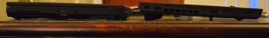

            Before you bash "new(ish) computer build quality" it's a ThinkPad T430, very well built, but I get a fast processor, 1600x900 screen, USB 3.0, SATA III, all that modern stuff

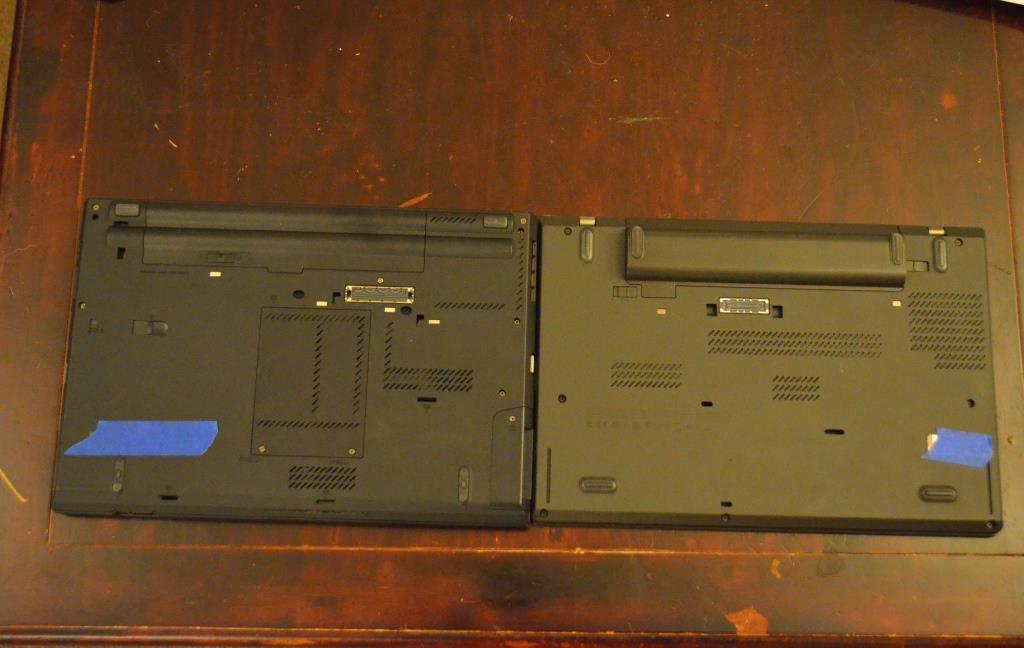

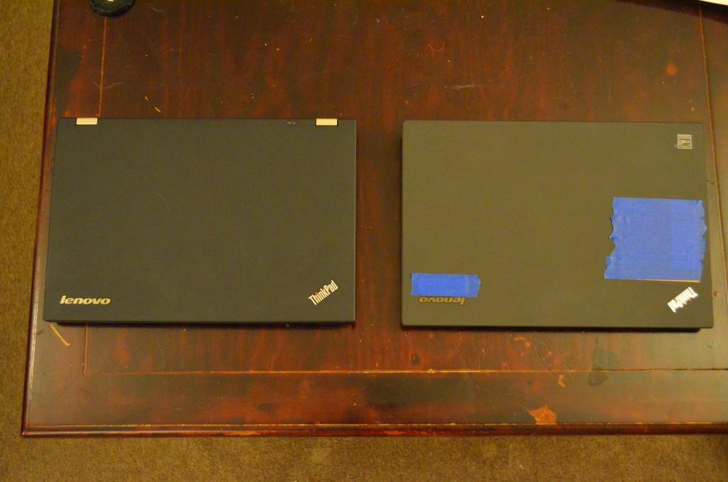

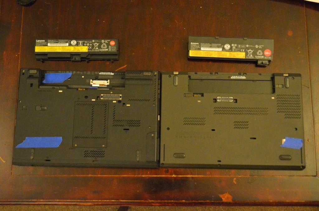

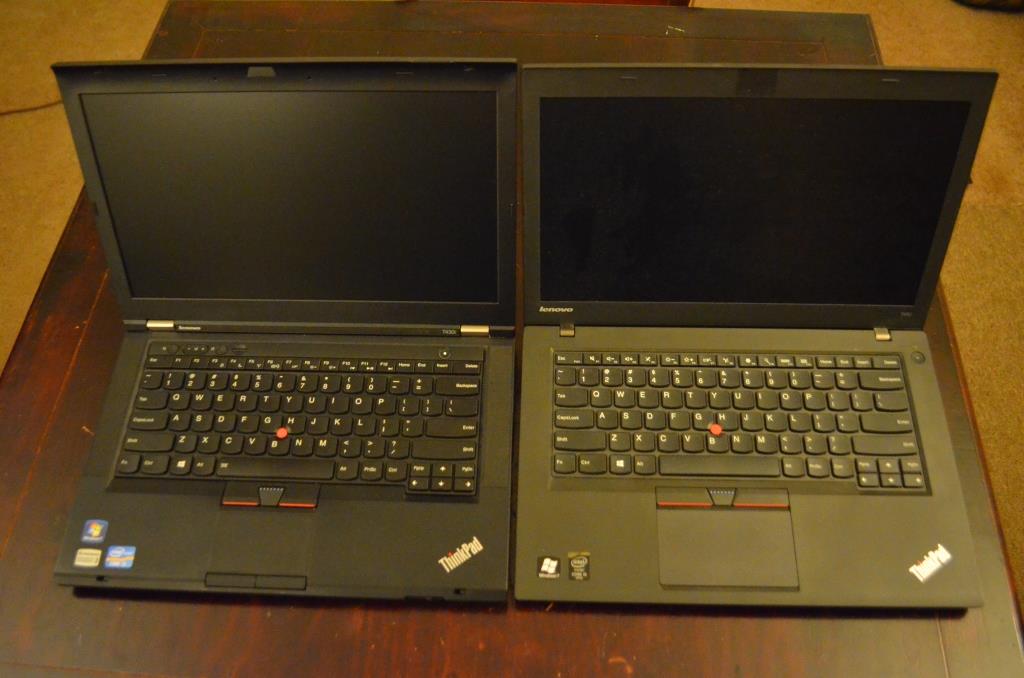

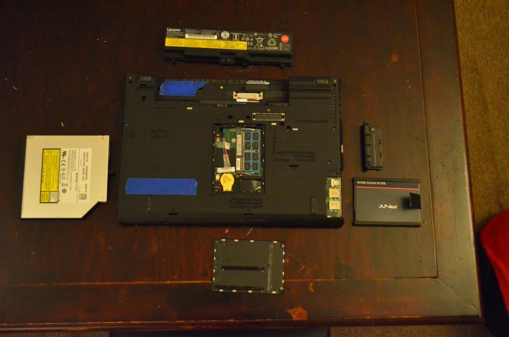

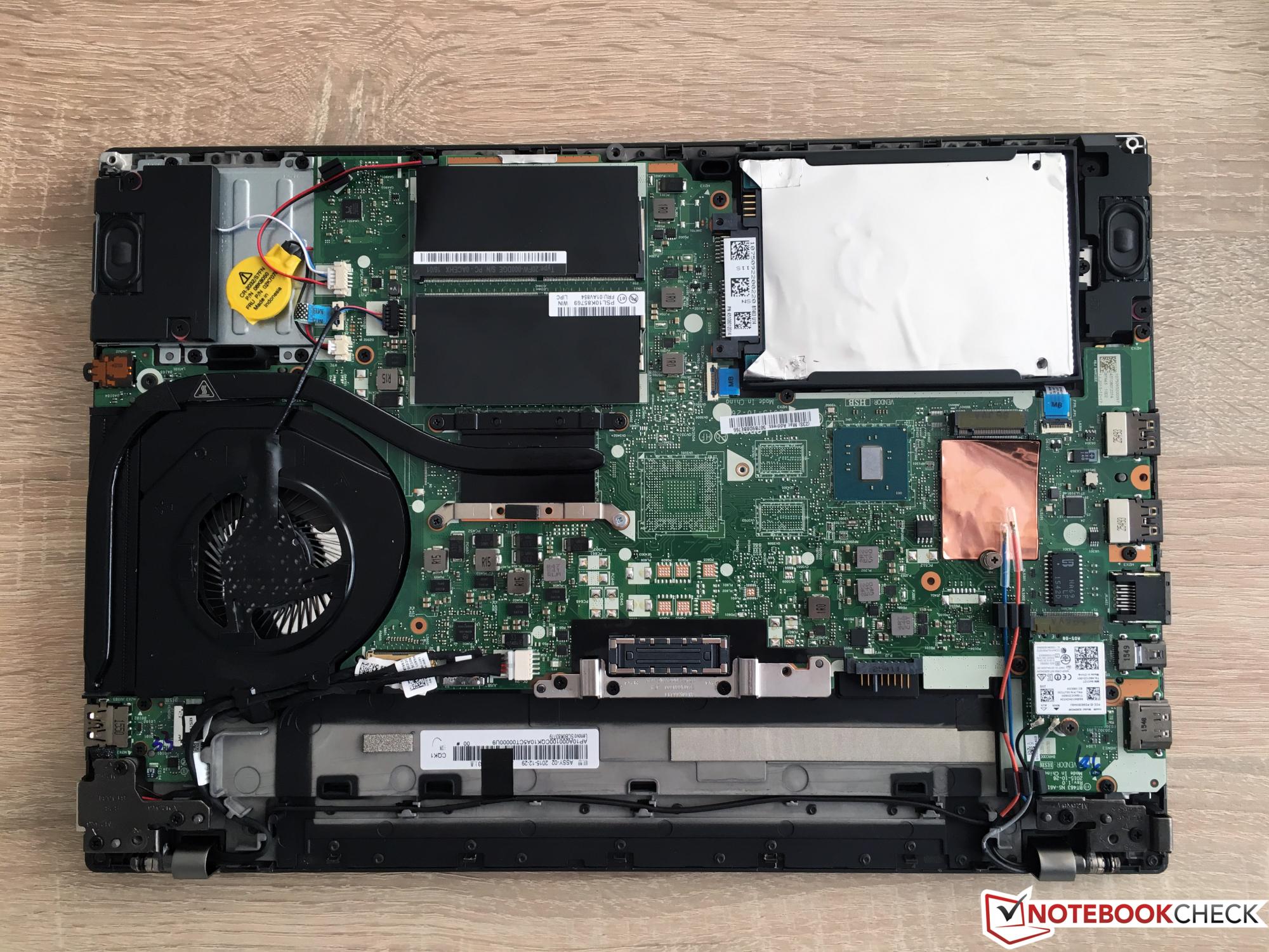

            Sadly the T430 was the "end of an era" and T series think-pads turned into "ultrabooks" and dropped in build quality/servicibility afterwards (still better than most, but not as good as they once were), ironically while the T450 itself is much thinner it isn't once you put the 6-cell (18650) battery on it (there is an optional 4-cell LiPO battery if you're willing to sacrifice battery life for thinness).
            Below is a side by side comparison between a T430 that I uses as my "travel laptop" (purchased for $38 on eBay minus battery and HDD, have about $125 in it after new battery and SSD) and my work T450. (note the blue tape is to cover corporate logos [in the case of the work PC], OS keys, etc., the t450 inside shoot is a stock photo as I'm not going to take my work laptop apart for obvious reasons):
            Side by side (T430 on left, T450 on right):
            T430 Internal:
            T450 Internal (no access panels the whole bottom of the case has to come off):
