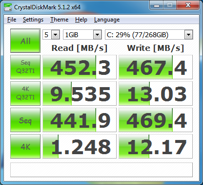

            Back from work trip, cable arrived.
            Working on pics, for now, a benchmark:
            One thing I did notice is that they were tossing smart errors at first, likely due to overheating. The apartment was hot and the side cover off (no air flow), and they roasted. With the apartment at a cooler (more reasonable) temp and the cover installed they run reasonably cool.

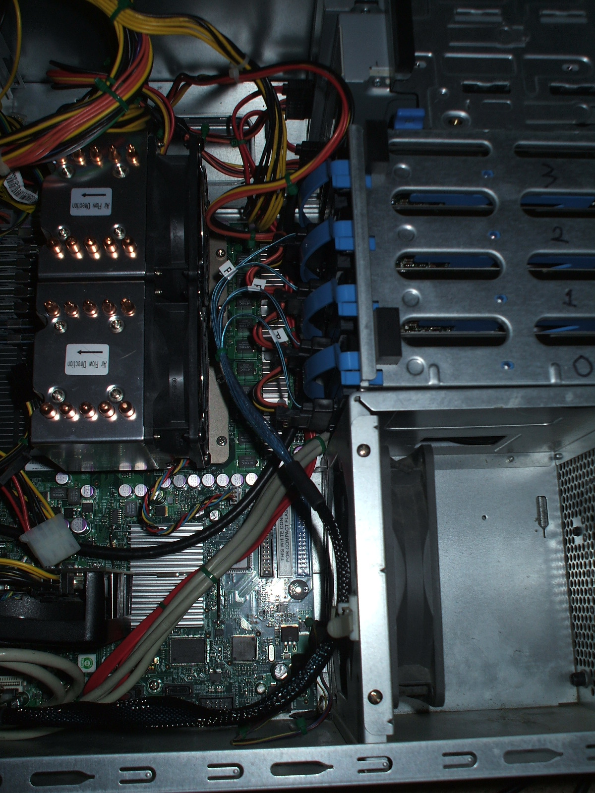

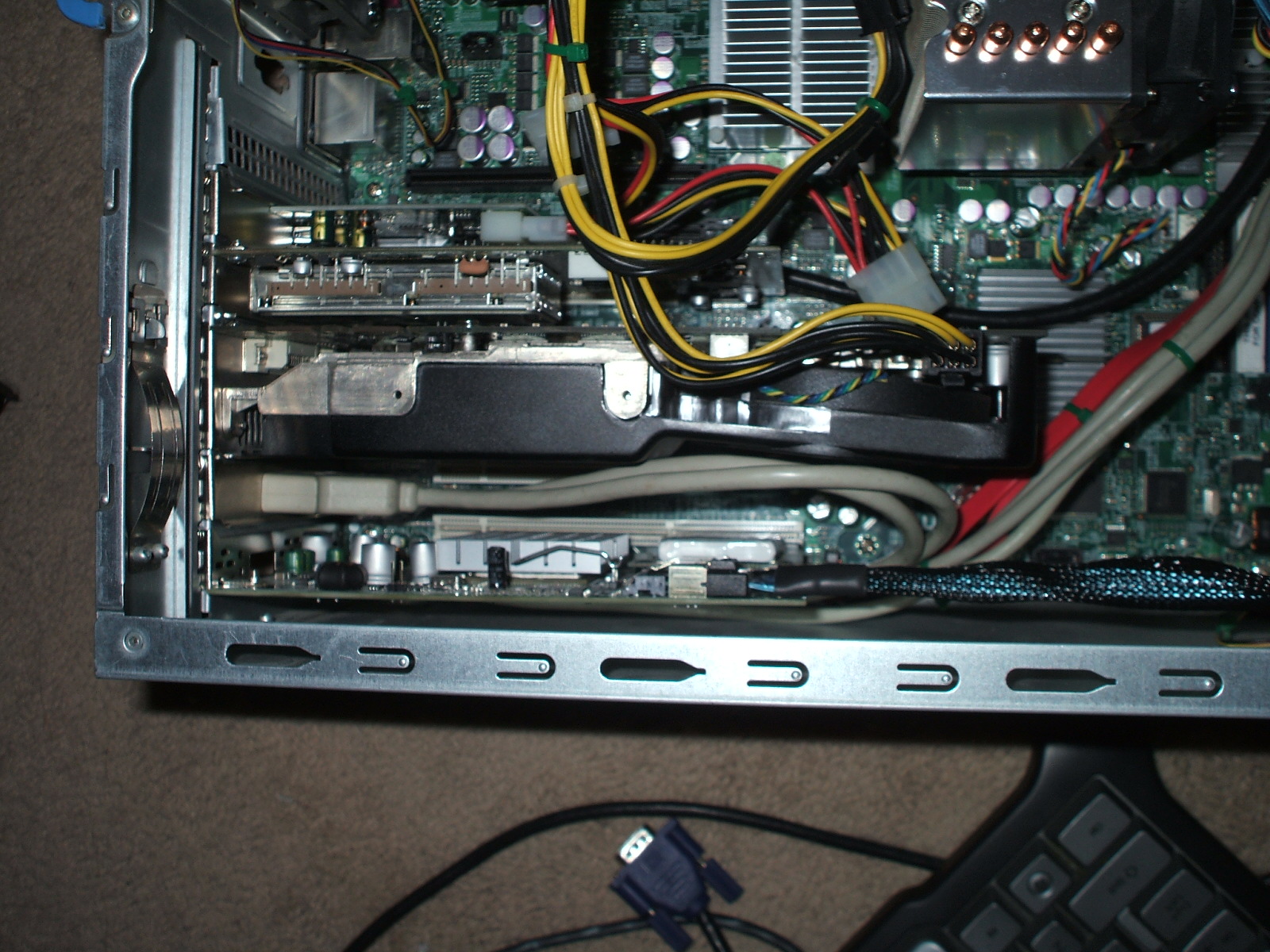

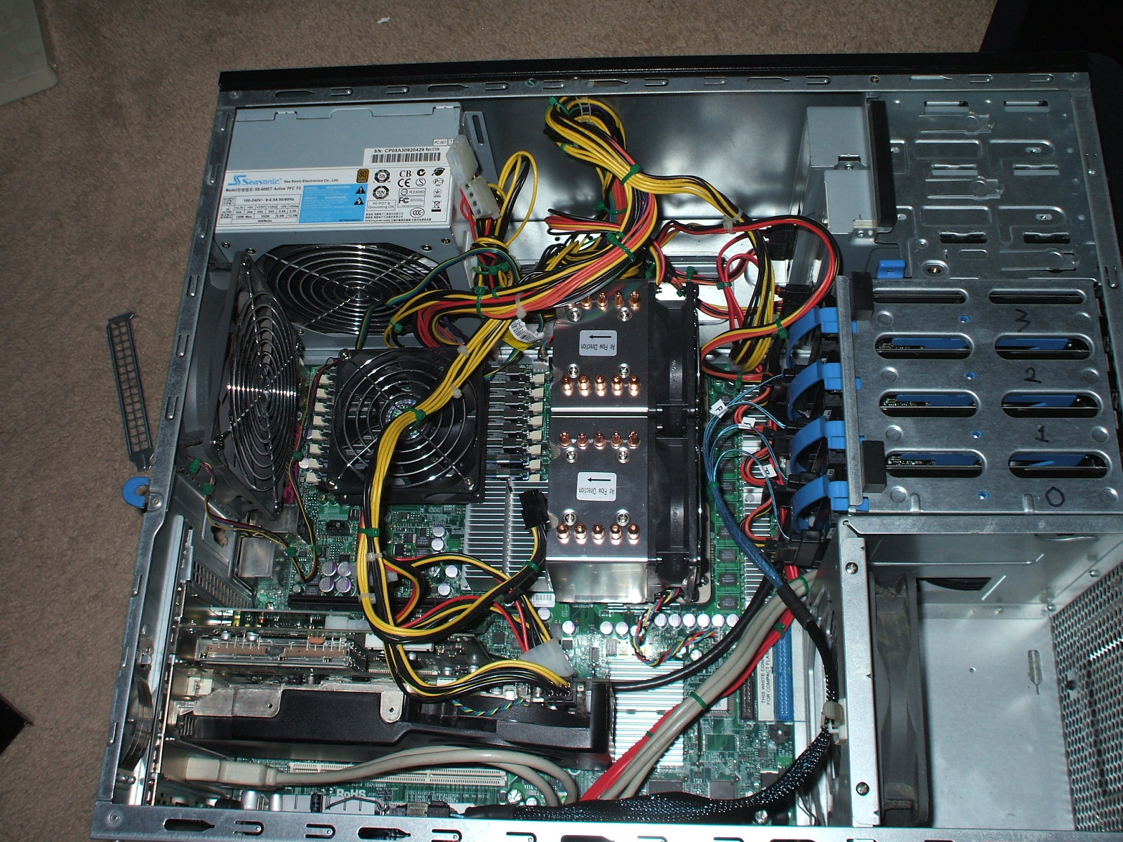

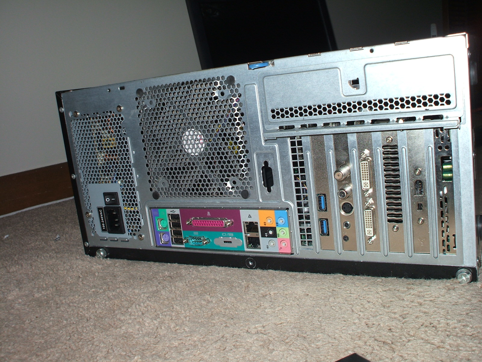

                Picture time!
                While doing some testing on V4.1 I had this out of service, which was the chance I needed to take pictures and make some more changes.
                First, an overview of the guts:
                Those HDD numbers aren't accurate as to make the breakout cable happier I reversed the numbering.
                I added a Hauppage 1600 QAM card so I could watch the Indy 500. I also added a dual 1394 header to tap into the firewire chip on the board:
                Not that I use either of those a lot... but they come in handy when I do.
                The new SAS drives and cable:
                Only one zip tie required... this cable assembly is a perfect fit and well worth the two weeks it took to come in from china. Every other cable I saw was too long, wrong power plugs (molex instead of SATA), or used pigtails AND cost $30+ (startech.com I'm looking at you, too long too).
                Finally, the plethora of connections in the back:
                Yes I did find and replace that missing thumbscrew.
                Look good? It certainly performs well (minus the RAID card bootup time, but I'll forgive that).
                sigpic
                (Insert witty quote here)
