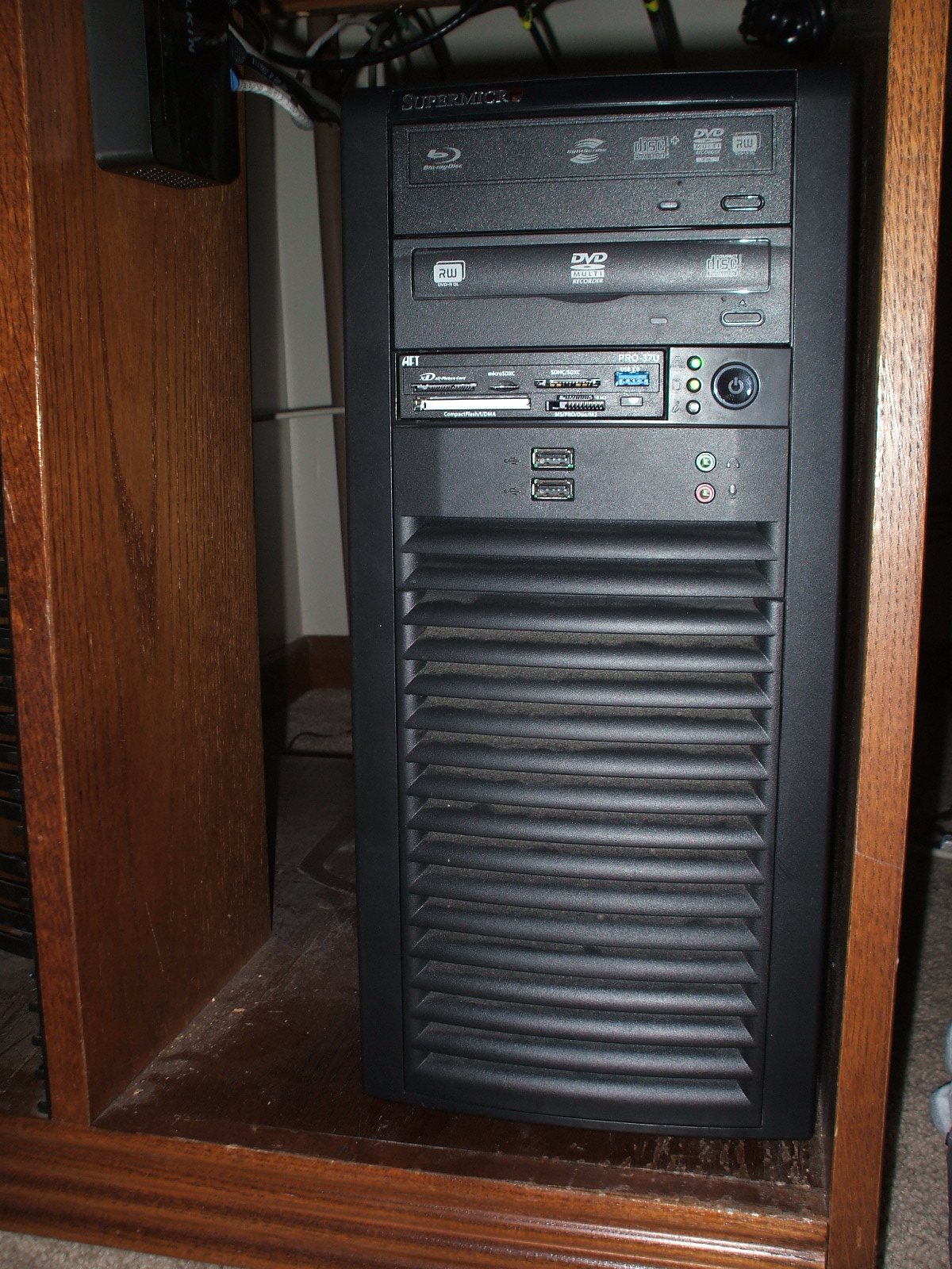

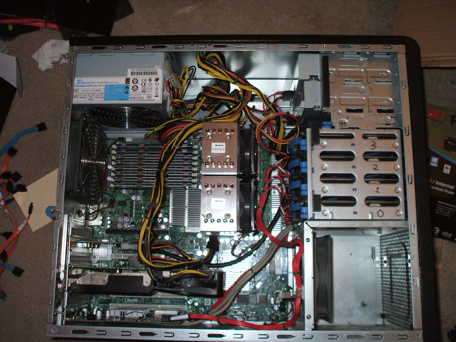

      I found some standoffs yesterday so I went ahead and built it up.
      Some pictures and specs:
      Front (with new card reader):
      The guts (just doing an overview due to free time... I wanted to get it running!):
      -Supermicro X7DWA-N motherboard (I won't say where it came from, that's Topcat's story to tell)
      -Twin Intel Xeon E5472 (3.0GHZ, 1600FSB, quad core)
      -32GB DDR2 Fully Buffered
      -Supermicro Socket 771 coolers
      -Supermicro SAS RAID card (Adaptec based). Array is RAID 0.
      -USB 3.0 Card + AFT Pro-37U USB 3.0 Card reader
      While it can't do SLI, its in pretty much every other way a massive upgrade compared to the old (and now dead) Tyan K8WE. Once I get a better GPU (and beefier PSU if necessary), it will really fly.
      I'll novabench it and post the results.

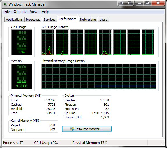

      Question: Windows 7 says only 24GB of my 32GB of ram is usable... and I'm on Ultimate x64. The other day it said 28... Supposedly 7 Ultimate x64 can do up to 192GB?

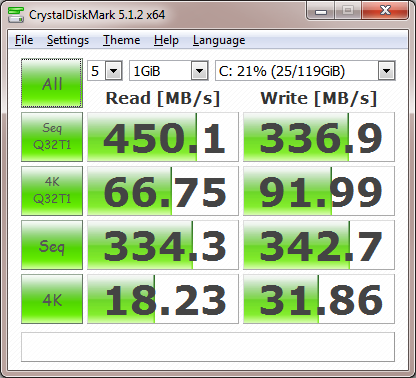

        Have you done a benchmark on those drives ?
        It's 192GB for all versions of Windows 7 except Home which is 16GB
        • ratdude747
          Black Sheep
          • Nov 2008
          • 17136
          #44
          Re: Ratdude's main rig V5.0
          Which drives? HDD? Card reader?

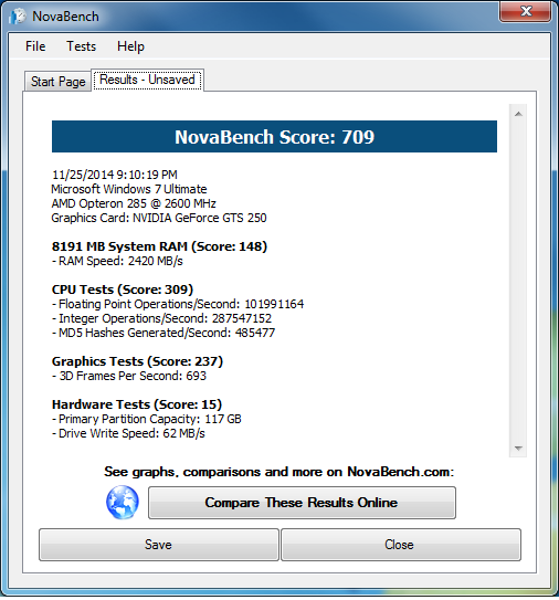

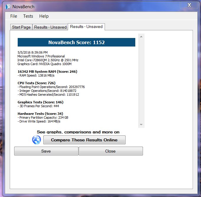

          I do have some benchmarks: (old setup is to the right)
          Not too bad

            I was more interested in the hard drive speeds with that RAID setup, i thought they'd be faster than that.
            • ratdude747
              Black Sheep
              • Nov 2008
              • 17136
              #46
              They're somewhat old WD 740GDs. 10K, but SATAI.
              sigpic
              (Insert witty quote here)
              • diif
                • Feb 2014
                • 6978
                • England
                #47
                That explains it, a single 250GB Seagate is faster at 151MB/s but that's Sata 3.
                  Reseat all the RAM sticks.

                    No, all 32GB is shown, it's just not usuble.

                      I heard that a RAM malfunction may cause Windows Vista and later to falsely report the RAM being "reserved".

                        Run memtest on it.

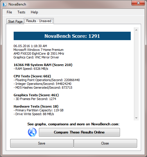

                            Not too bad
                            Definitely an upgrade, not bad performance for ~8 year old hardware.. Here's a comparison with some more "modern" hardware (my main rig, Details Here):
                            Looks like the GPU is definitely your system's biggest bottleneck (though I imagine you already know that), something like a Radeon R9-380 or GeForce GTX960 would be a massive improvement for less than $200 or an R7-370 or GTX950 for around $150 and with about the same power consumption as that old GTS 250 space heater.

                              Strange about the memory....IDENTICAL setup in my office running S2K8 R2, which is win7. All memory shows up and is usable.
                              It was fine when it was here.....I'd memtest it for sure, after re-seating everything.

                                The benchmark software is crap, simple as that.
                                Here's what's reporting on my pc :
                                It seems to only use 2-3 cores/threads when doing CPU measurements, only the MD5 hasher seems to go up to around 5 threads.. still overall only 29% cpu usage.
                                It's not even smart enough to report the main video card, not RealVNC's virtual driver as a video card... and I have a SSD capable of about 300 MB/s write speeds but yet the software's only able to measure 88 MB/s
                                And memory only 6 GB/s...
                                Aida64 on my hardware reports 22345 MB/s reads, 15429 MB/s writes, 20337MB/s copy and 75.2ns latency.

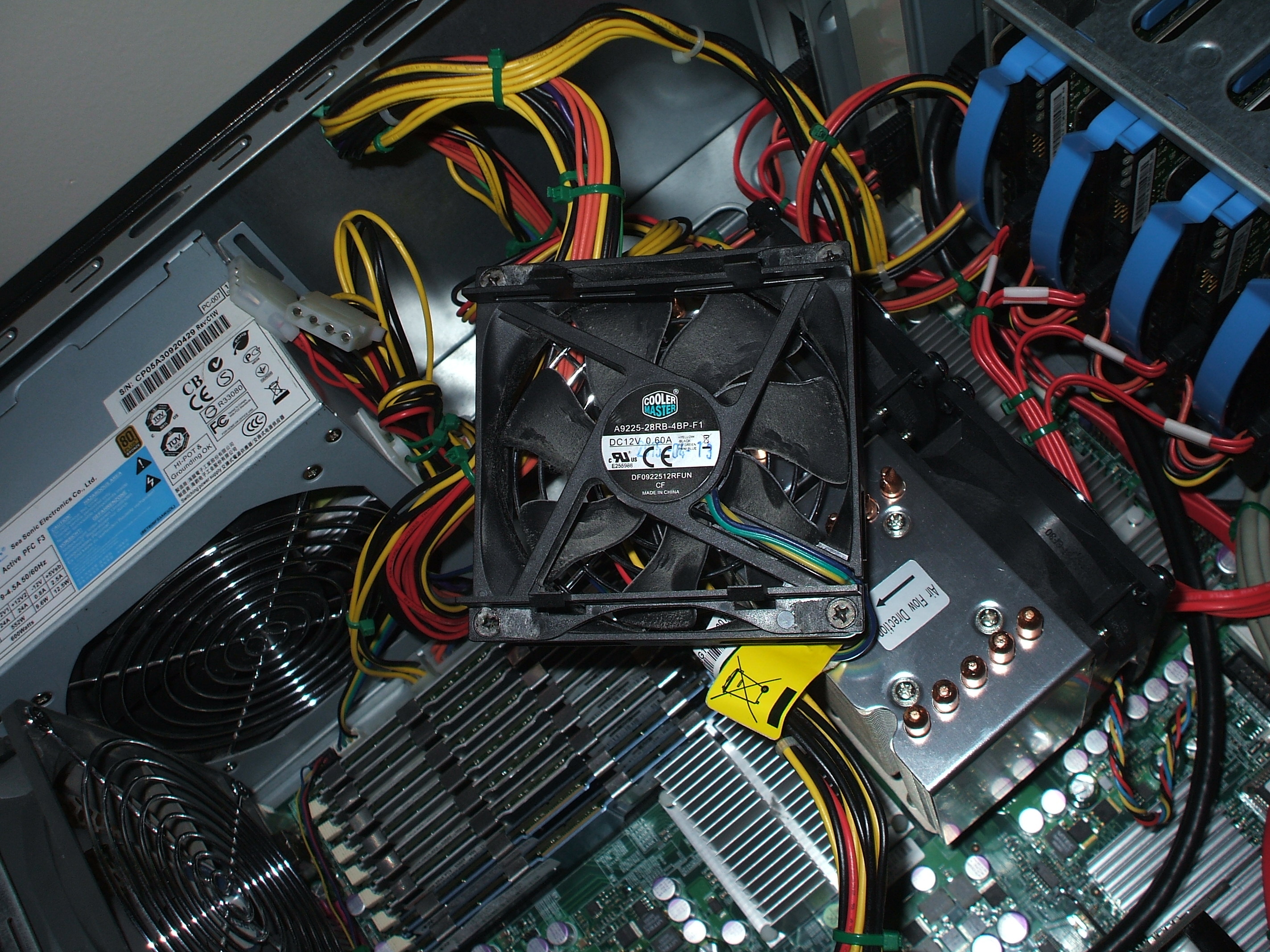

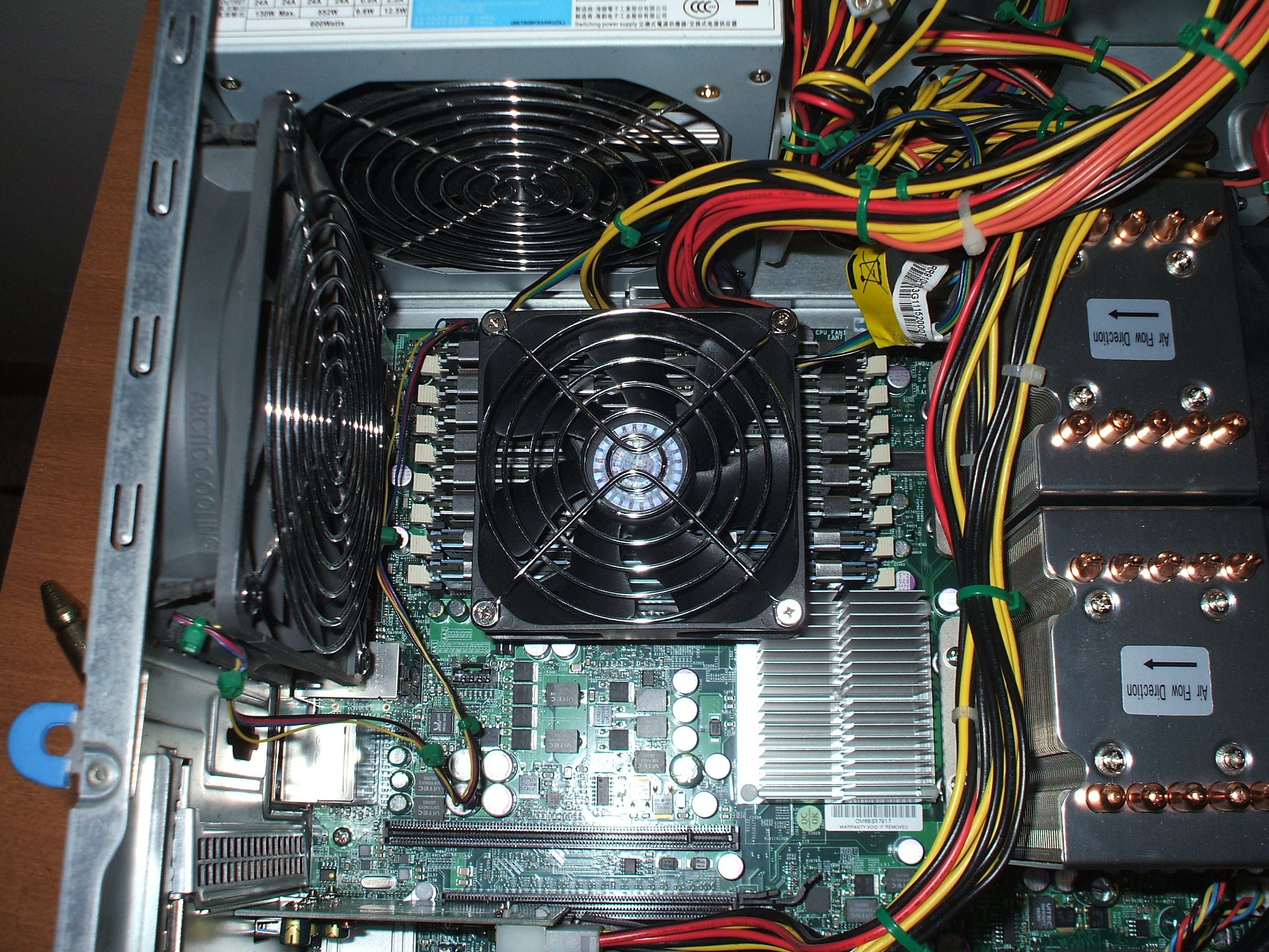

                                      Found the issue... Lack of cooling!
                                      Apparently one does indeed have to actively cool the RAM... I wasn't and noticed HW montor reporting RAM temps over 100C! eek!
                                      I bodged a 80mm fan from a dumpster find for now... LOUD but effective, all 32GB showing. I may try using one of the 92MM cooler master fans from the 3.5 coolers as it's PWM and will be quieter hopefully.
                                      sigpic
                                      • ratdude747
                                        Black Sheep
                                        • Nov 2008
                                        • 17136
                                        #59
                                        I found a better solution. I flipped the clips one one the TX3 fans:
                                        ..which fits nicely (and with just enough tension) between the upper two FBDIMMs:
                                        Some modules are cooling better than others but I have yet to see anything reach or pass 80C (but one is getting kinda close). I may bump up the fan speed a bit just to be safe. The hackier fix cooled better but that was by virtue of a jet engine level of noise.
                                        Finally, a butt shot I didn't take last time:
                                        edit- Bumping the speed from "quiet" to "workstation" seems to be doing the trick Sadly it's not nearly silent like the last build... but whatever. Stupid easy bake FBDIMMs. I may try flipping the fan I added...

                                          I can see why those sticks are running hot. Good ghetto mod. If it was mine I would experiment with turning the fan 90 degrees up from its present position and adding a 4 sided deflector so the air flows more evenly across all the sticks and exits from the ends of the rows.
