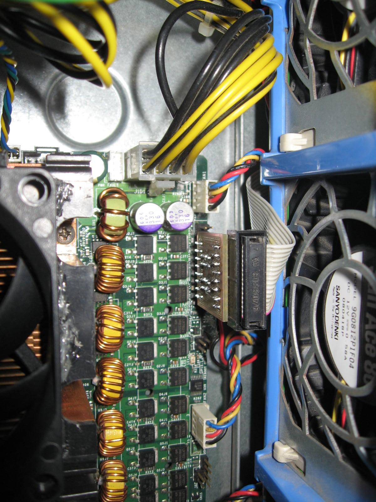

    First, Main rig V3.5 died (VRM cooked, see post #196 of it's thread) and I more or less have a hollow shell of a kickass workstation sitting.

    -SM makes their cases so if you use their boards (like in a barebones), you can plug the ribbon cable for the lights and switches right in. Which is no good for RAID cards. Once upon a time I fixed that issue on another rig:
    However, that board was the only one of it's batch to turn out as anything decent. Not to mention it was made as a PCB mill test and one can get PCBs made super cheap these days. So, I took a night to redesign that a bit:
    https://oshpark.com/shared_projects/zszsAHZa
    It's a board that allows one to at the flip of a switch redirect the HDD and NIC2 lights to something other than the motherboard.
    I have the parts already but the boards have yet to come in, so no actual pictures.

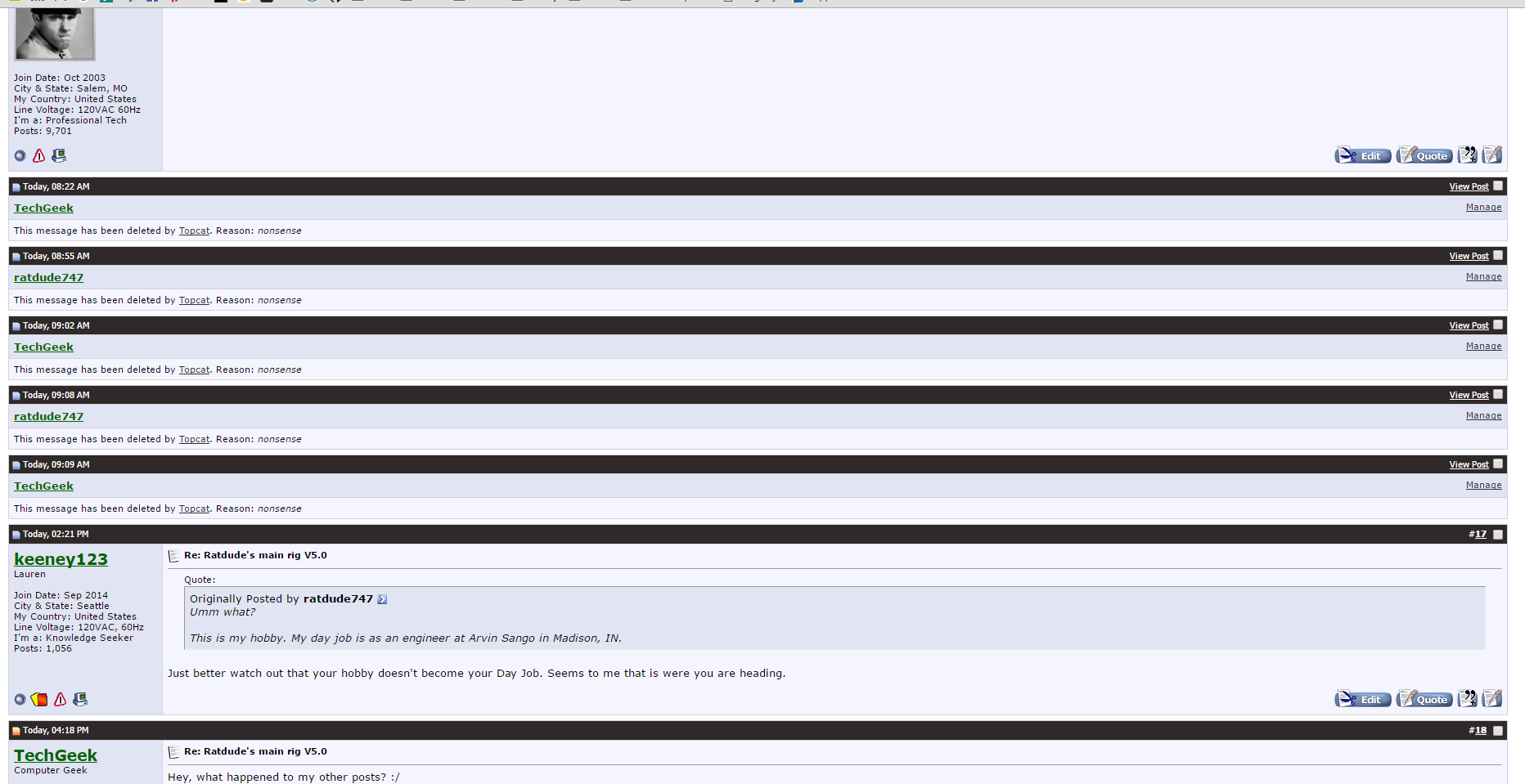

                                    Re: Ratdude's main rig V5.0
                                    Hey, what happened to my other posts? :/
                                    Permanently Retired Systems:
                                    Kooky and Kool Systems
                                    sigpic
                                      They were useless, I removed them.
