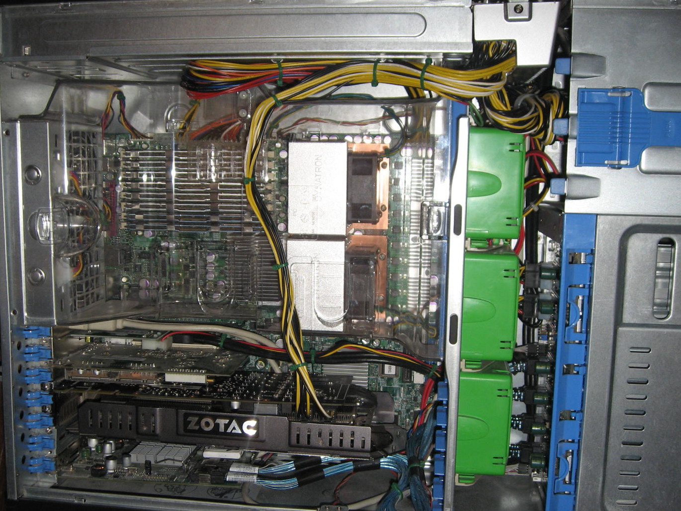

          Card came in:
          There is a caveat (and a "trap for young players"): the card actually consumes 3 slots (or 2.5 at least). To make it fit, I had to rearrange my cards a bit:
          Don't worry, there is plenty of fan clearance:
          The system seems to like the card. However, this comes at an unexpected (and unrelated?) loss; it seems that my GLAN controller fried during the install as ever since, even with all the cards removed and CMOS cleared, my LAN is dead. No lights, no detection in windows. As a temporary (or permanent?) fix, I've obtained a USB 3.0 GLAN adapter to mitigate the issue. Not a perfect fix, but last I checked these boards cost a pretty penny ($269 shipped from china right now) and if I'm going to drop that kind of cash (not in the cards, truck blew a fuel pump ) I might consider going newer later.
          Thoughts or comments? When I have time I'll try to get some sort of a benchmark run.

            I highly doubt the NIC fried....I'd think more along the lines of some kind of hardware/addressing conflict.

              I agree with the above, more likely it's some resource conflict, some pci-e slot may be disabled when other slots are populated or something like that
              Other than that.. my thoughts would be the same .. lots of heat and wasted power and noise for little performance just because it's "server hardware".

                ^ I see the soldering issue... Hopefully the (presumably) overkill cooling makes up for that.
                No comment on the other part of your post, we both know my thoughts on that.
                That was my suspicion, until I tried it with no GPU installed and all the NIC lights (front panel and at the RJ45 connectors) were still dead. Normally they light up when it's in standby and a cable connected to either port. Nothing, absolutely dead. Even if it was a resource conflict, one would think that you'd at least get the connection speed lights in the rear, and especially with all cards (minus the RAID card) pulled. Even powered it on with the cards pulled (and cable connected), nothing.

                        Yes. That sux!! Just pressing the card down into the PCI-E slot or pulling the other one out of the PCI-E slot and it went dead?

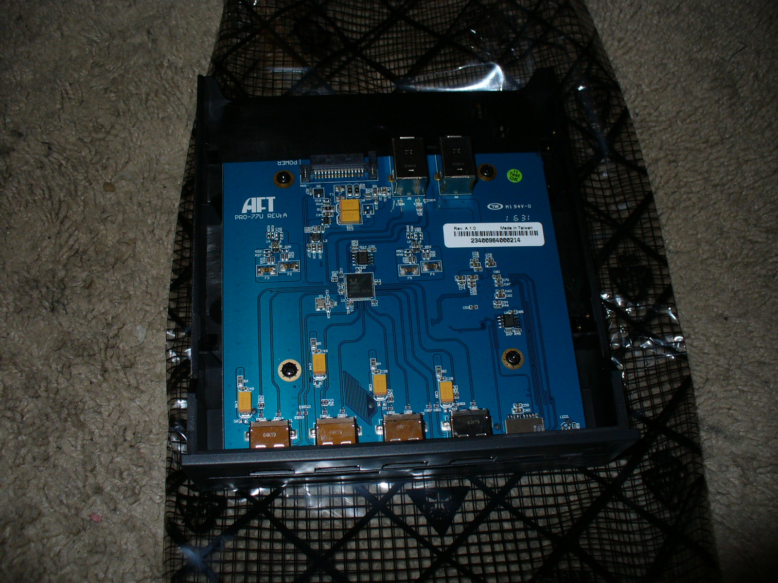

                          This side is the USB Hub. The card reader is on the bottom; I did pull the board (should have taken a pic) and confirmed that the reader does use 3.0 as per the advertisments. Oddly, both chips are Realtek yet the hub shows up as Renesis in device manager
                          Also, note that the hub is one one cable (powered off of the SATA power port alone), while the card reader is on a separate USB 3.0 cable (powered from USB 3.0 bus).
