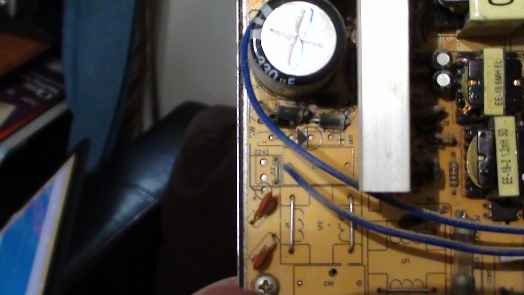

        Re: Changing voltages.

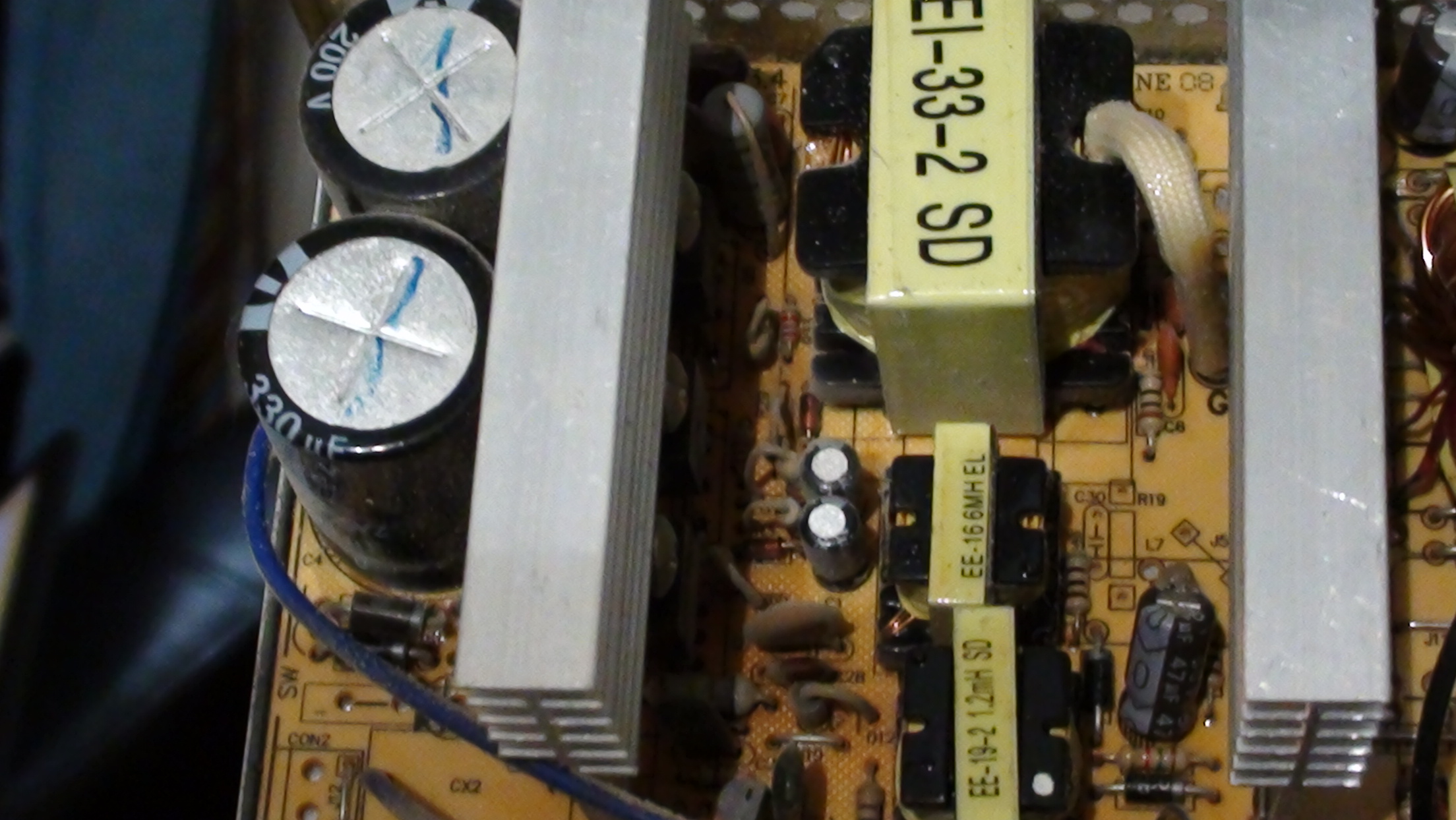

        I took the PSU apart. The caps physically look good. It's gonna be a pain to get to the board so I can remove them to test them. At first, I thought it had some Rubicon caps. But at closer examination, they're Micon. It's weird because the font on them is very similar to a Rubicon.
        The PSU is made by a company I've never heard of, Okia. It's 450 watt.

              uh oh, junk/unknown brand caps in a junk/unknown brand psu? will have to assume the psu is faulty by default due to that reason. replace with a known good working japcap psu or post photos of the psu like stj said to see if its worth recapping the psu. caps can go bad without bloating especially junk/unknown brand caps! so dont assume the caps are fine unless that can be proven with an esr meter.

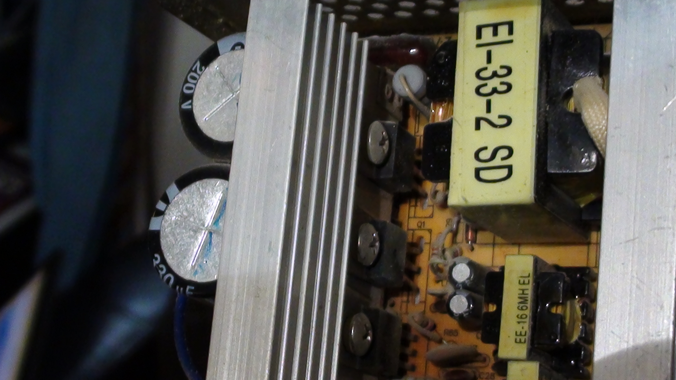

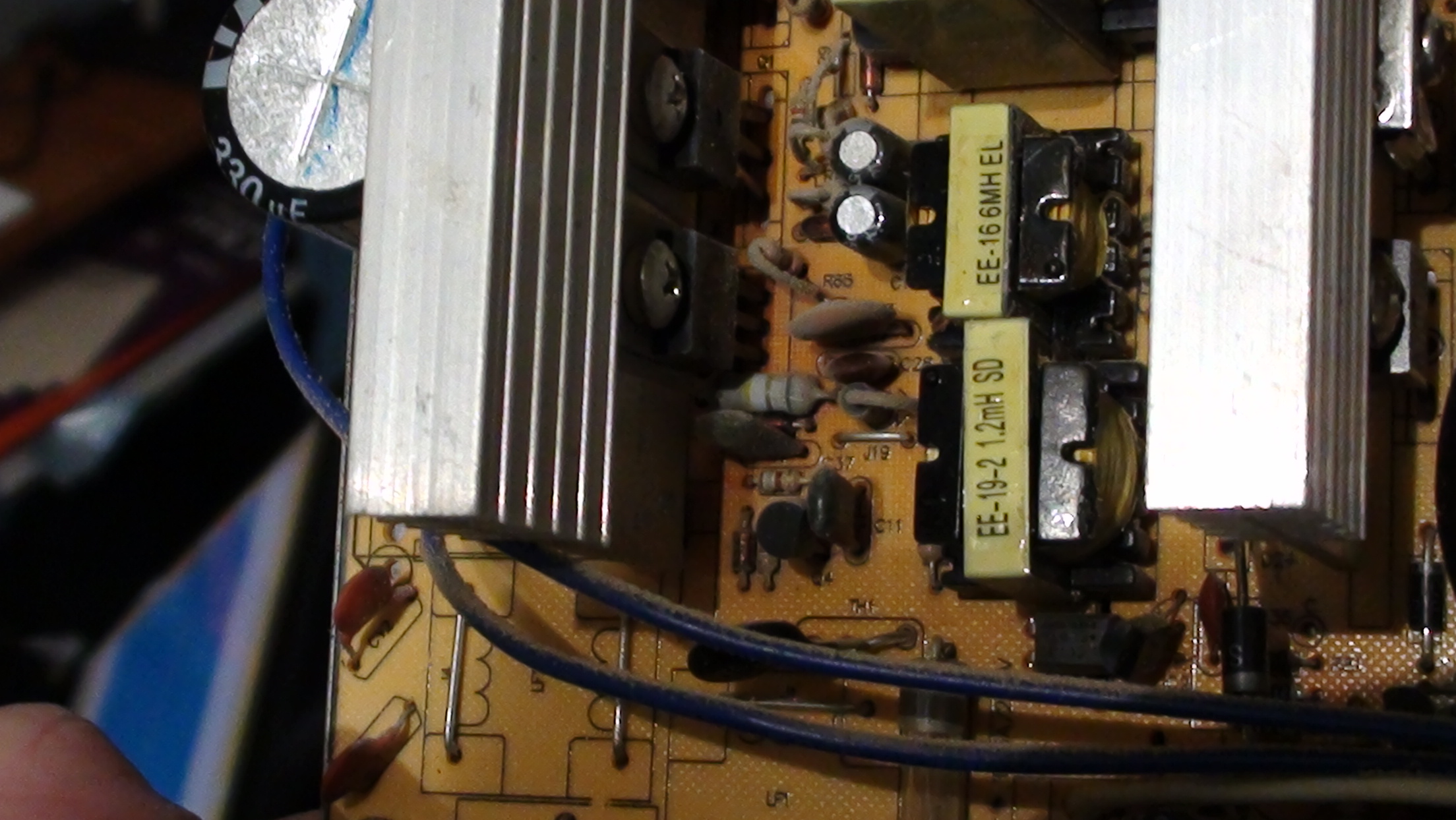

                    #29

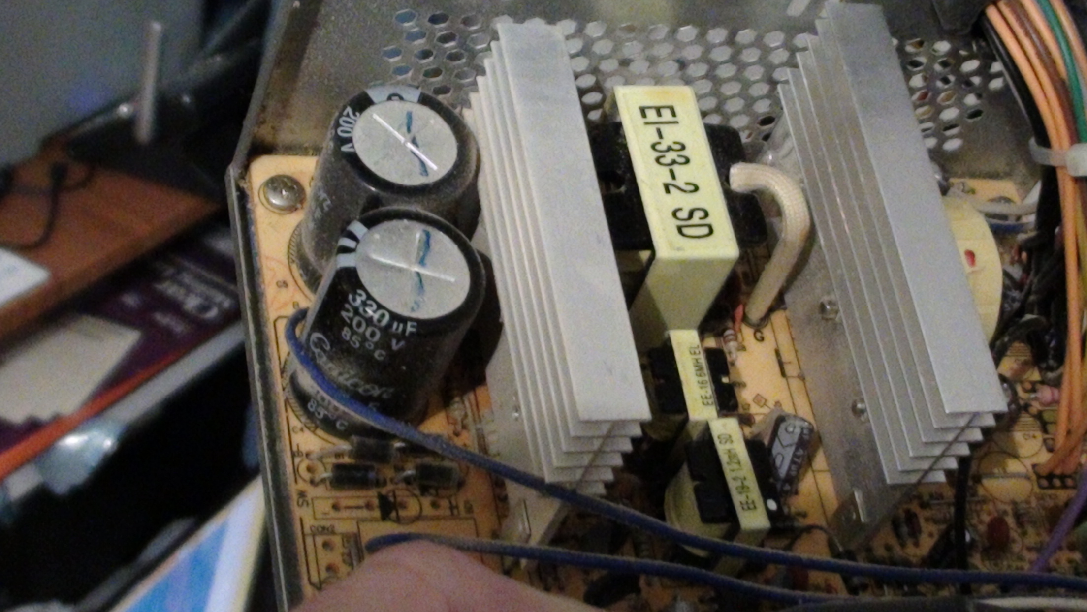

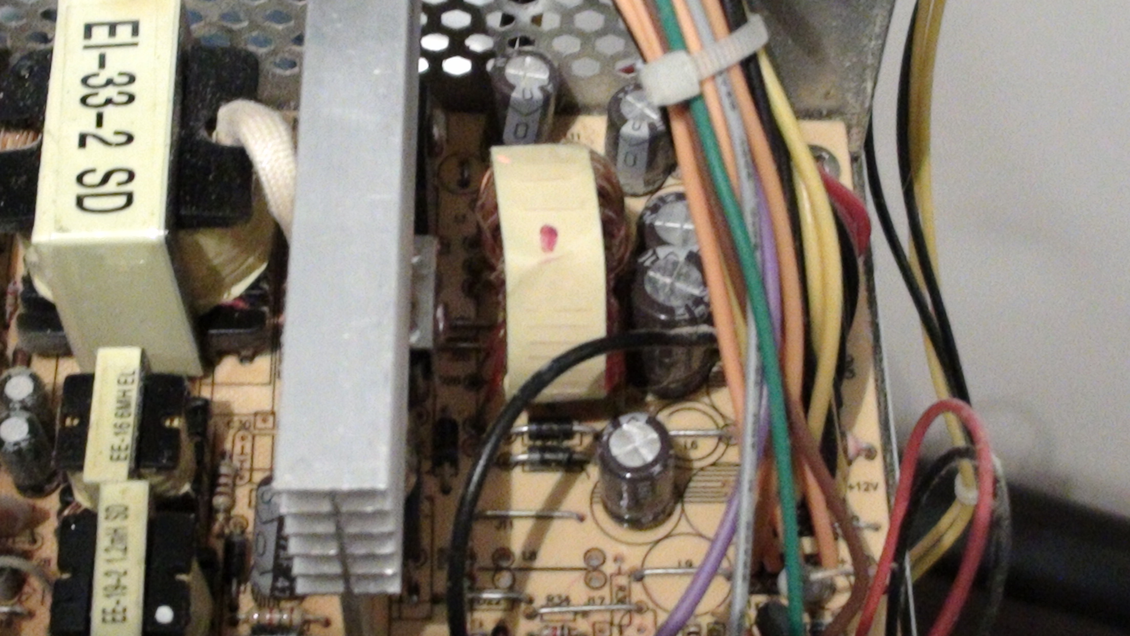

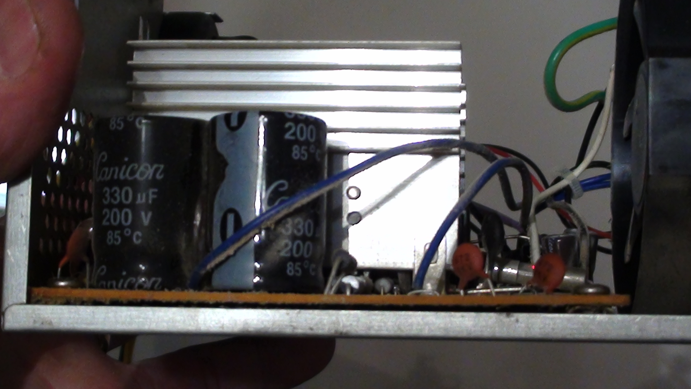

                    A lot of *con caps I guess! The big ones are Canicon! The little ones, Micon. Both seem to use a font similar to Rubicon. I guess people like having the word con in their capacitors name!

                      #30

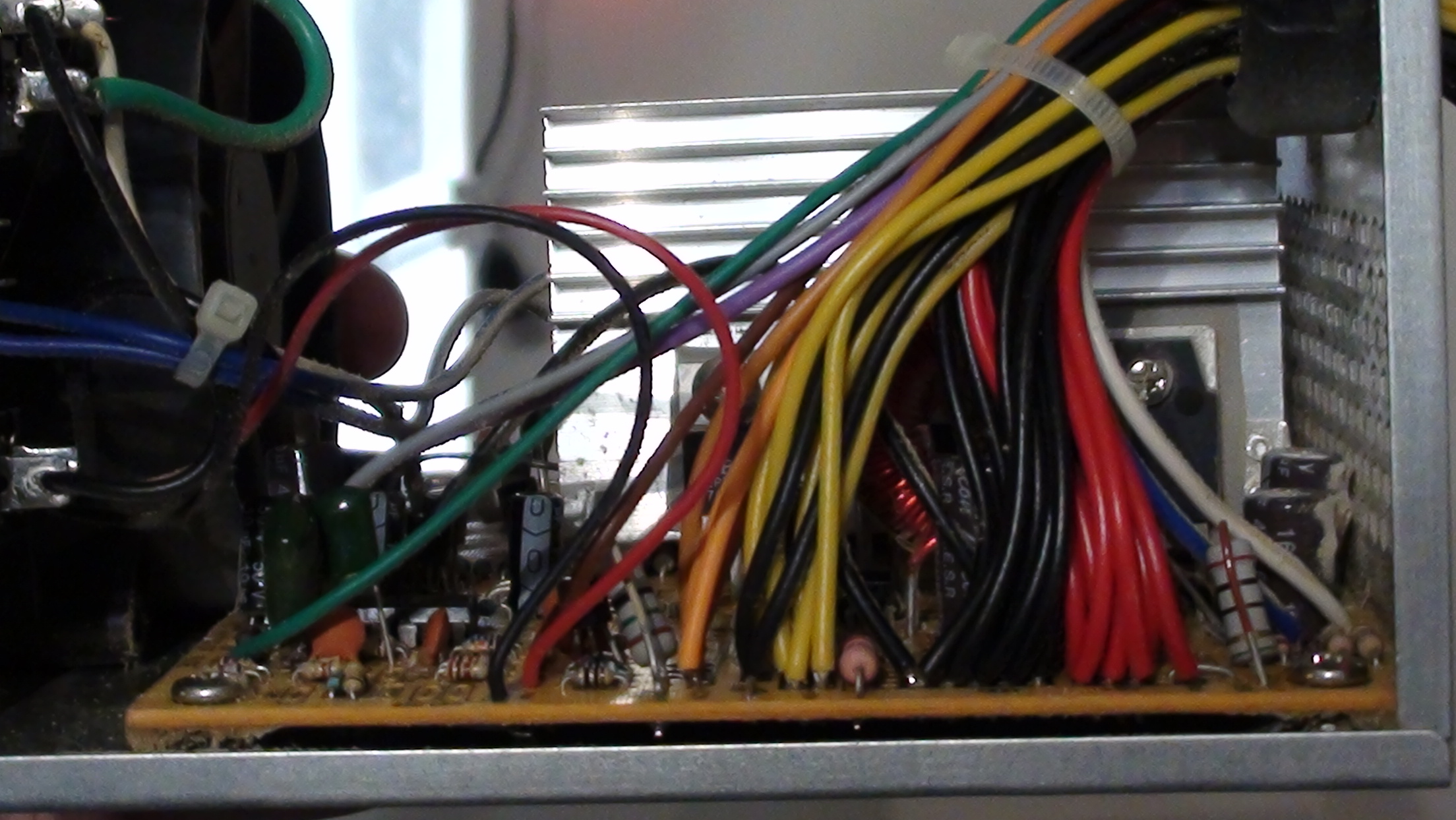

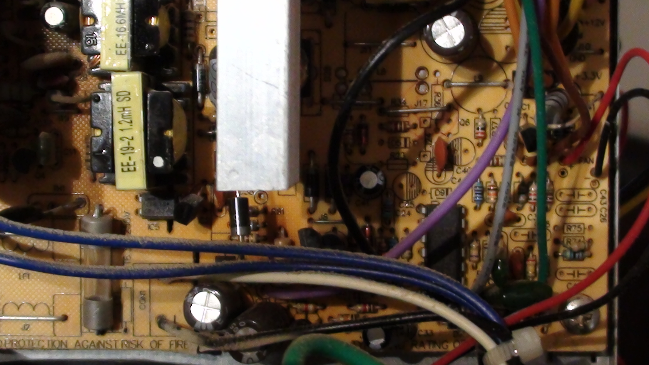

                      One of the ceramics look a little toasty. It's between the heatsink / a 1/4 resistor (or some other big type resistor) and some of those little transformers. It's dark in colour.

                        • 31204
                        #31
                        that's a POS, i doubt it could out more than 250w safely!
                        if vcore is jumping, you need to turn to the caps on the mobo around the cpu next.

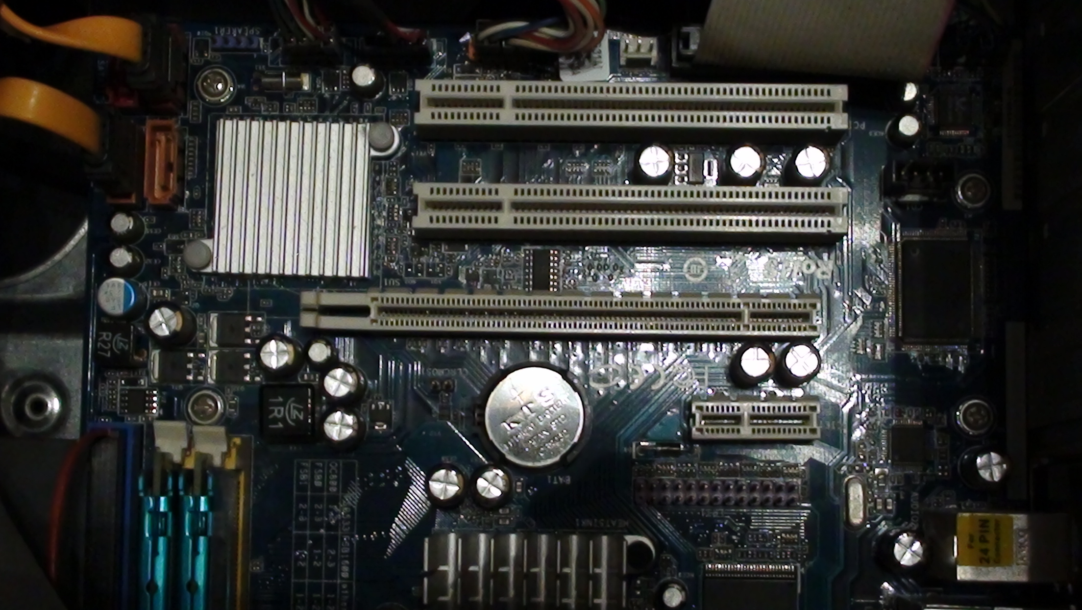

                                    i want to see the type and placement of the caps on the board

                                      Okay, I will post pictures later today.
                                      I want to make sure I understand all of this now. The hardware monitor shows the vCore voltage, the 3.3v, 5v and 12v. Because the power supply supplies the 3.3v, 5v and 12v, the hardware monitor is reporting what the power supply is supplying, right?
                                      The vCore voltage changes on what CPU is being used so motherboards use a voltage regulator circuit to change the voltage for the CPU, the RAM, etc. Right?
                                      The voltage regulator circuit gets it's power from the PSU though. Is there a chance that once I get a _good_ power supply in there, the vCore will straighten out? If the voltage regulator circuit isn't getting stable voltages, I would think that would affect the various voltages it produces (ie, vCore).

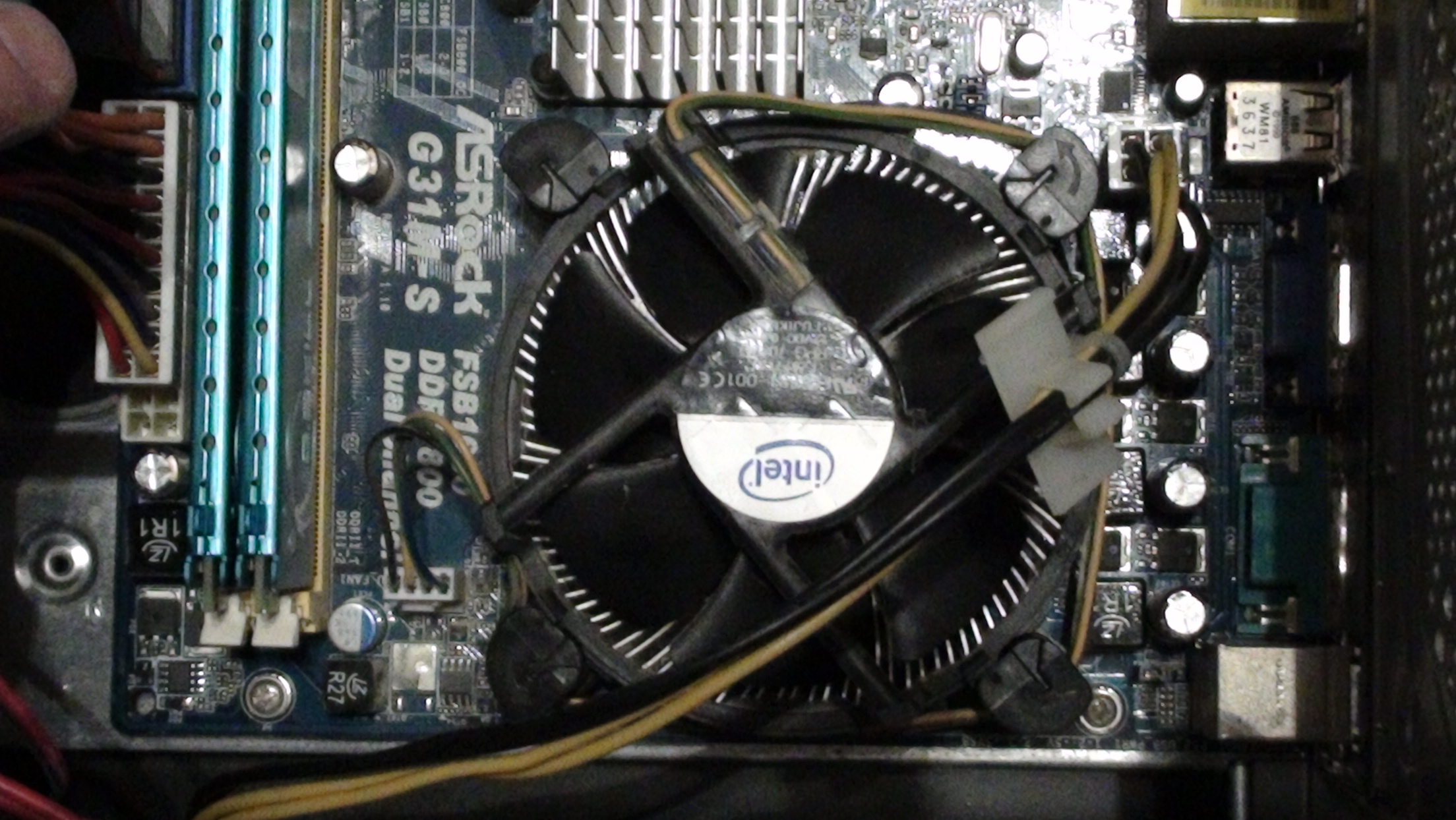

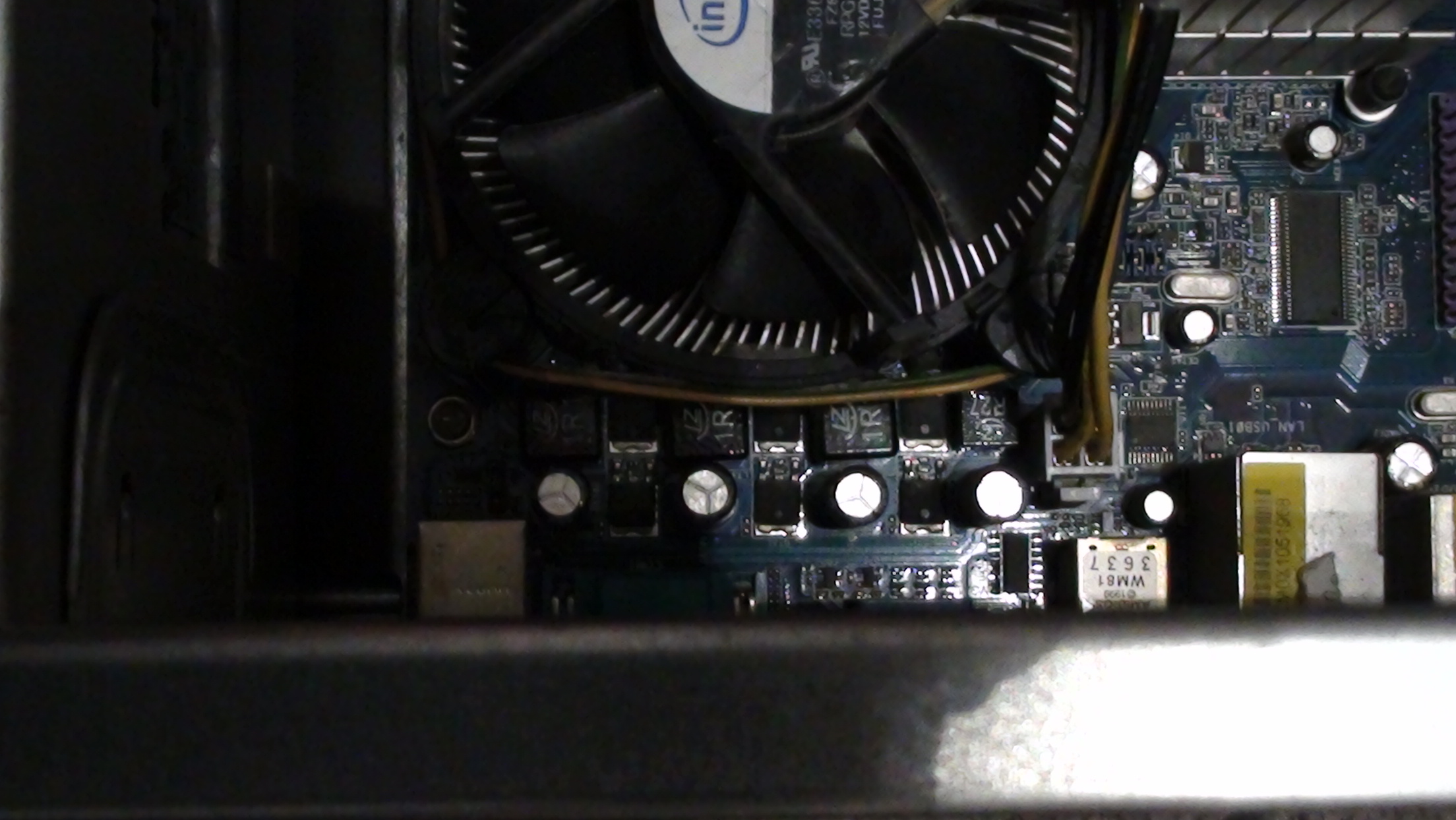

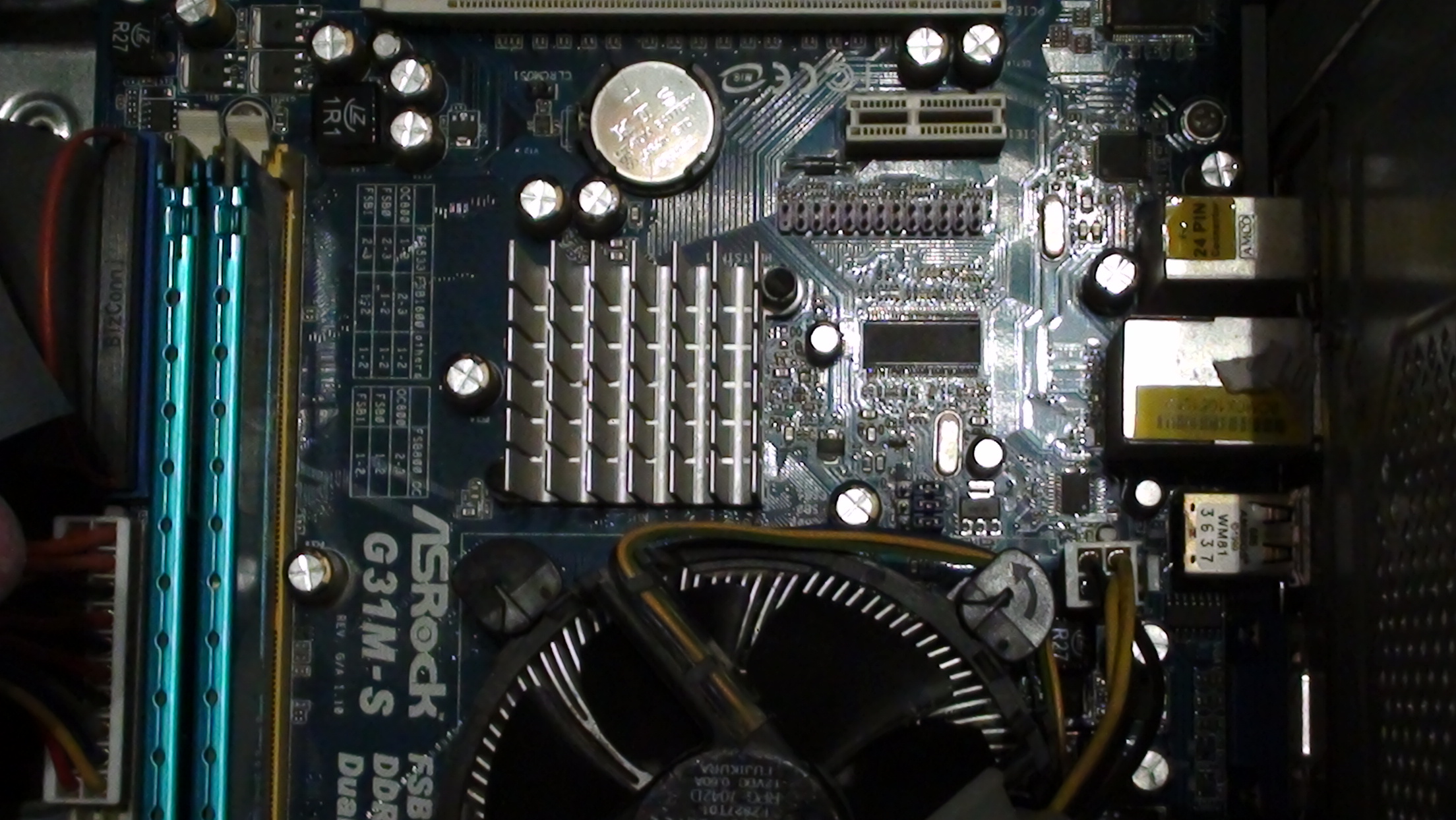

                                        #39

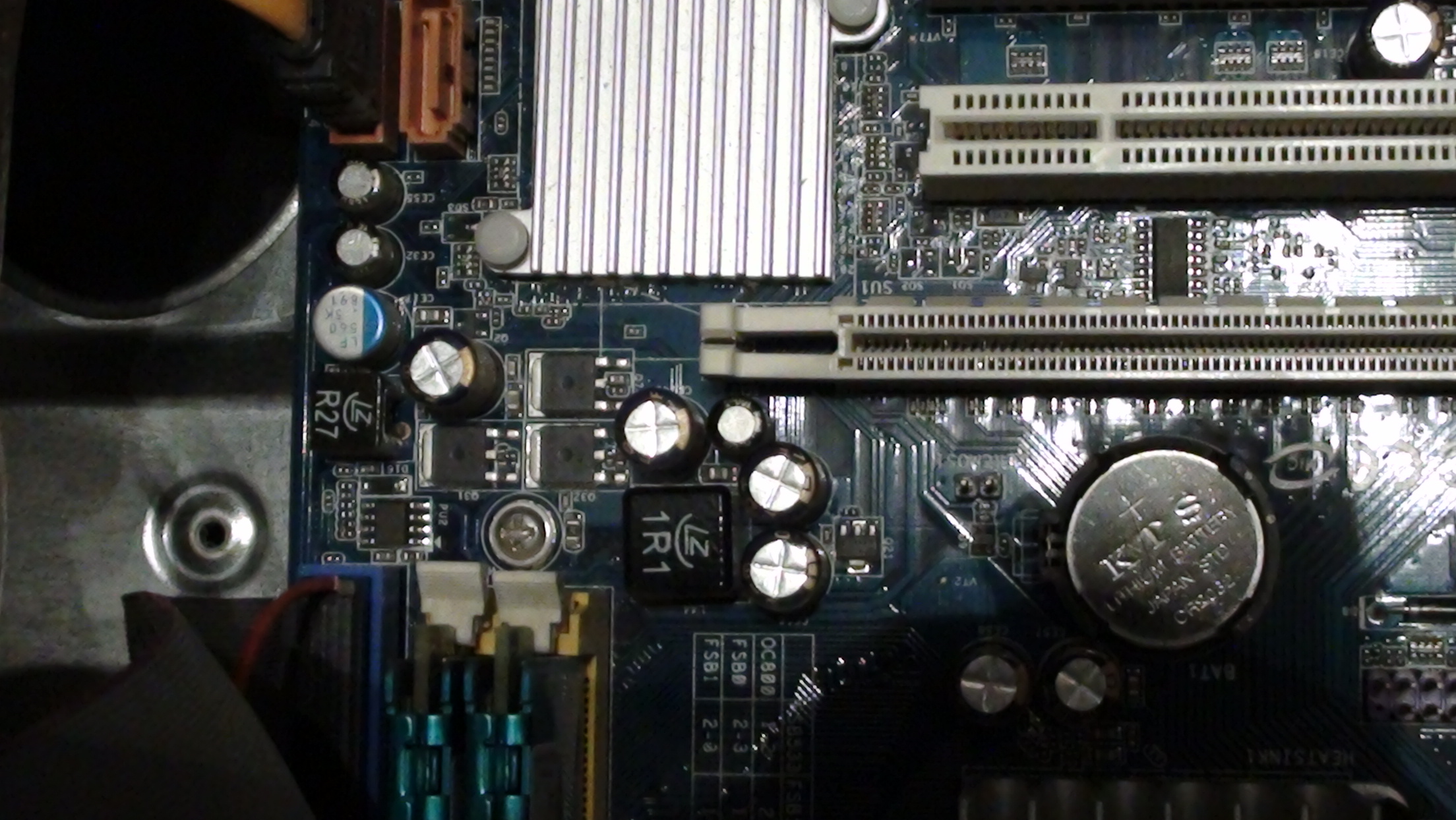

                                        These aren't the best pictures because the board is still in the case. When I get my iron, I will pull the board and post better pictures for you, unless you want me to take the board out now and take better pictures. These pics will at least show you how the caps are laid out. They're mostly (if not all of them) Evercon and look like the last pic posted (that's not from my board, I googled them).
                                        -- Law of Expanding Memory: Applications Will Also Expand Until RAM Is Full
                                          • 31204
                                          #40
                                          vcore comes from a switching psu on the mobo, it originates from the 12v from the psu.
                                          it should be stable, an unstable vcore = an unstable cpu.
                                          it looks the the 3phase switcher only has 3 caps - cheap bastards!
                                          can you make out the markings?
