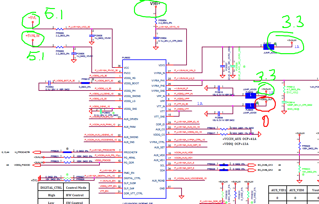

    Hello, this might be embarassing since I consider it a dumb question but keeps me kinda stuck sometimes in my journey.
    I want to know if there is any post in this forum which explains my questions. A) When, where and how do I know when X voltage line is input or output. Example:
    Click image for larger version  Name:	image.png Views:	0 Size:	151.9 KB ID:	3266119 Click image for larger version  Name:	image.png Views:	0 Size:	143.6 KB ID:	3266120
    I'm battling with this IC to understand it's voltages. It's from non-turning-on Lenovo Ideapad 3 15iil05 - NM-D461.
    I see some lines like +5VL / +5VALW / V9B+ / +3VALW being okay and some others like 1.8VALW / +0.6VS / +2.5V_DDR. I just know that some of them are bad or missing, but I don't know entirely which way they are going, if IN or OUT. Btw: +V9B has its 20v.
    B)Any methos to know where values going for sure? Besides logic...
    I bought a couple of these LV5116AGQW IC's time ago and I'm ready to replace but first I must be 100% sure.

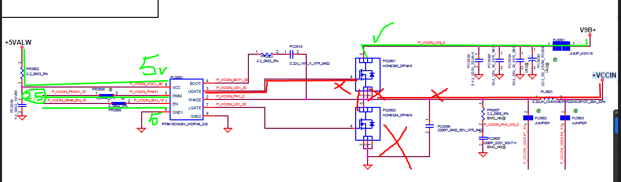

    I was following lines and realized that +VCCIN is missing right here:
    Click image for larger version  Name:	image.png Views:	0 Size:	68.0 KB ID:	3266121
    At this point I'm kinda stuck because since I'm rookie there's a bunch of voltages I don't know their usual value.
    This IC, which I think is responsible of sending some of these voltages to the mosfets has these 2 values.
    Click image for larger version  Name:	image.png Views:	0 Size:	93.5 KB ID:	3266122
    If there's posts already with the info I'm requiring feel free to just leave the links here to avoid taking other's valuable time.
    Thanks for any help and sry for still being noob hah Xd

    You can download the datasheet of IC,if available, to understand it better. +VCCIN will come much later , so not of concern yet.
    1.2V(ddr power supply)/2.5V both are associated with ram circuit. Unless you have 1.2V/2.5V/1.8V , cpu core power related supplies wont rise.
    So in short, focus on why you're missing 1.2/2.5/1.8V rails. Check the respective enables for these rails.
    IC will output these rails when
    01.All its inputs are present( means its powered)
    02.All its enables are present
    03.There is no short on output rails.
    Hope this helps you in focussing a bit more sharply.

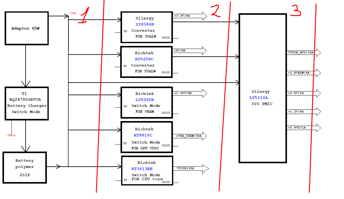

      I thought +VCCIN was supposed to come online early as after the +V9B... Jesus, I just have no idea. lol. Okay so I'm going again with PU9800 (LV5116AGQW) voltages and enables as you said.
      Thing was I also guided me from the power block and thought brackets meant to be in this order:
      Click image for larger version  Name:	image.png Views:	0 Size:	64.5 KB ID:	3266594
      So I thought it was first block 1, then block 2 and block 3 and, like that, supposedly +VCCIN was before 1.2V/2.5V/1.8V. Which is wrong then...
      Thanks so much for clarifying. Now I know better.

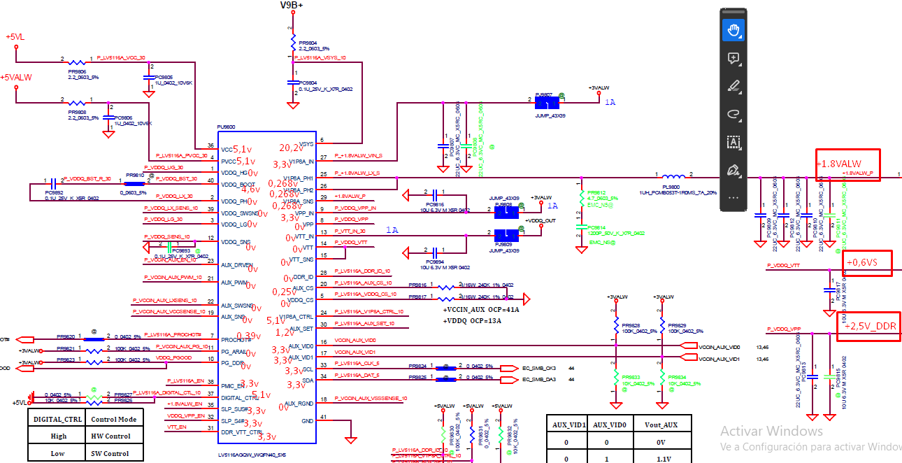

                    Btw, I managed to, carefully, measure every pin in the 40 pin LV5116AGQW. Any thoughts with these results?
                    Click image for larger version  Name:	LV5116AGQW 40 pin values.png Views:	0 Size:	187.2 KB ID:	3268083
                    VSYS - 20,2
                    VCC - 5,1v
                    PVCC - 5,1v
                    VDDQ_HG - 0v ----------------V1P8A_IN - 3,3v
                    VDDQ_BOOT - 4,6v ----------V1P8A_PH1 - 0,268v
                    VDDQ_PH - 0v -----------------V1P8A_PH2 - 0,268v
                    VDDQ_SWSNS - 0v -----------V1P8A_SNS - 0,268v
                    VDDQ_LG - 0v -------------------V1P8A_CTRL - 5,1v
                    VDDQ_SNS - 0v
                    VDDQ_CS - 0v
                    VPP_IN - 3,3v
                    VPP - 0v
                    VTT_IN - 0v
                    VTT - 0v
                    VTT_SNS - 0v -----------------------SCL - 3,3v
                    -------------------------------------------SDA - 3,3v
                    AUX_PWM - 0v ---------------------PROCHOT# - 0,39v
                    AUX_SWSNS - 0v ------------------PG_ARAIL - 0v
                    AUX_SNS - 0v -----------------------PG_DDR - 0v
                    AUX_VID0 - 3,3v --------------------DDR_ID - 0v
                    AUX_VID1 - 3,3v
                    AUX_CS - 0,25v ---------------------PMIC_EN - 3,3v
                    AUX_SET - 1,2v ---------------------DIGITAL_CTRL - 5,1v?
                    AUX_RGND - 0v --------------------SLP_SUS# - 3,3v
                    --------------------------------------------SLP_S4# - 3,3v
                    --------------------------------------------DDR_VTT_CTRL - 3,3v
                    (--- just to save space)

                        Remove all power. Meter in resistance mode.
                        Measure the resistance (not diode mode) of pin # 25 to ground. You can measure at the inductor / coil on the same pin. This is to check if this line is shorting to ground through some component that is defective or leaky. The concern here is that this rail should be supplying a +1v8 voltage rail but is not.
                        • gjgib
                          • Nov 2022
                          • 70
                          • Venezuela
                          Thanks for reply mon2. There's 3.4 +pin25 -GRD. And 3.8KΩ -pin25 +GRD. (+- probes).
                          Is that value enough to consider there's a leak in the +1v8?
                          • mon2
                            • Dec 2019
                            • 14758
                            For resistance mode tests, there is no polarity requirement with the meter probes.
                            For diode mode tests, the red meter probe must be to ground and black to the point to test.
                            At ~3k4 = 3,400 ohms to ground, this measured rail is not shorted.

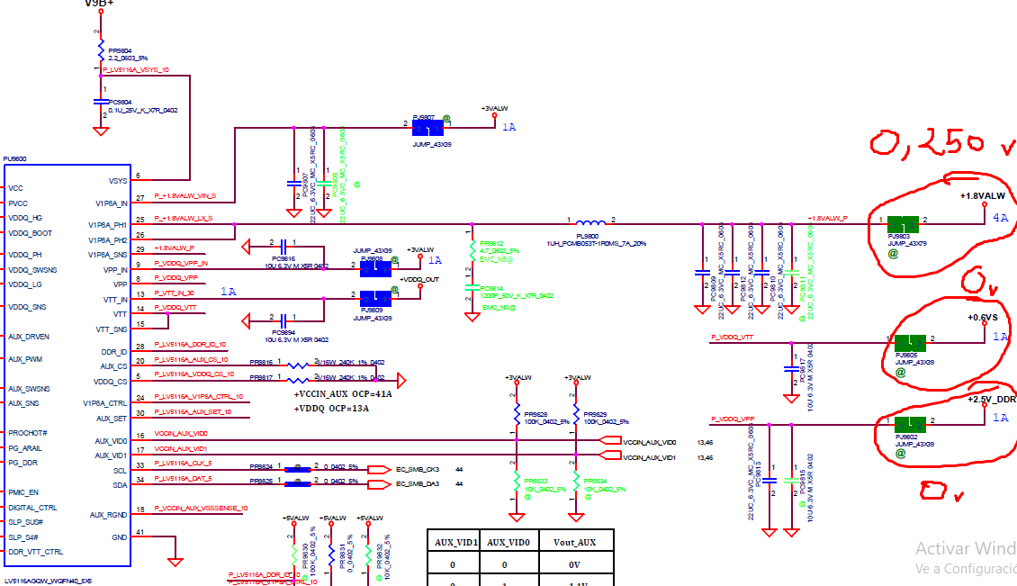

                              mon2 Thanks for insight. Is there a value treeshold for a line to be considered 'shorted to ground'? I know it depends on some other things, but I meant this the basic way.
                              Btw: Should I dig more into a possible fault on the IC inputs or do you think, considering the values, that is enough evidence for the IC to be considered as faulty? I know and understand that 100% of the responsability of this is on me but the rewards can be shared
                              • mon2
                                • Dec 2019
                                • 14758
                                In resistance mode - in my opinion, if the measurement if say 500 ohms or lower, it is of concern. Some engineers like to place a 100-120 ohms to ground resistor intentionally on the power rail and this part then acts like a bleed resistor. When the power is OFF, the resistor will impose a relative heavier load to cause the current to bleed off and discharge the capacitors to zero volts. In summary, when there is a load present, the voltage will dissipate from the capacitors that are holding the same. The capacitors will discharge and this makes it safer for the next power on cycle to start from zero.
                                Study the other package for this part to review how this part operates. If available, check if there is an enable pin for this power rail. Check if that enable signal is present. It does sound like this power rail is defective and the IC should be replaced. Before proceeding, check the rest of the output power rails on this component. If their voltage is not present, perform the same type of testing -> is the output shorted? If shorted, the short condition must be resolved before applying a replacement part.

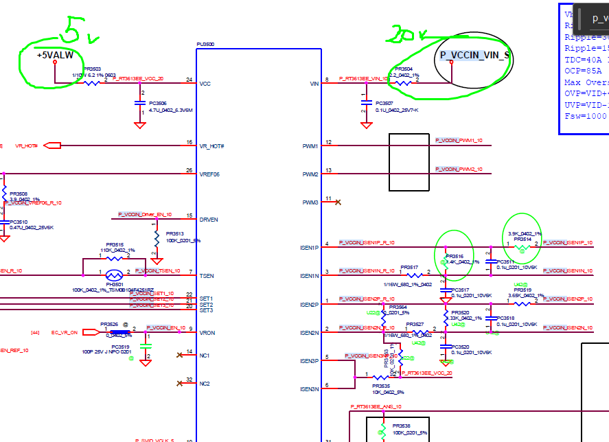

                                  I detected low impedance in the +VCCIN rail (68,6Ω). +VCCIN_AUX (174Ω). And +VDDQ_OUT (+1.2V)-(418Ω​) Started doing some tests. Would you consider this amount okay for core rails nowadays or somethings off?
                                  • mon2
                                    • Dec 2019
                                    • 14758
                                    +VCCIN rail (68,6Ω)
                                    Yes, this is considered to be a low resistance.
                                    Remove all power. Meter in resistance mode. Review the resistance across the mosfet pins for this power rail (+VCCIN).
                                    Check:
                                    source (1-2-3) & drain (5-6-7-8)
                                    source (1-2-3) & gate (4)
                                    gate (4) & drain (5-6-7-8)
                                    Perform the above checks for the high side (PQ3501) and then the low side (PQ3502) mosfets for this rail. Post all measurements. On a normal mosfet, the resistance should be high.​
                                    • piernov
                                      • Jan 2016
                                      • 4439
                                      • France
                                      68 ohms is fine for Ice Lake/Tiger Lake CPU main power rail.
                                      • gjgib
                                        • Nov 2022
                                        • 70
                                        • Venezuela
                                        mon2 Found something fishy. Might be the issue(?
                                        PQ3501 Impedance / S-D 0.6MΩ / S-G 2.8MΩ / G-D 12MΩ
                                        PQ3502
                                        Impedance / S-D 88Ω / S-G 2.4MΩ / G-D 5.4MΩ
                                        Alsoo... In Diode Mode:
                                        PQ3501 (SD 0.5V) (DS 2.4V) (GS 1.07V) (SG 0.14V) (GD 1.35V) (DG 2.5V)​
                                        PQ3502 (SD 0.18V) (DS 0.05V) (GS 1.17V) (SG 0.45V) (GD 1.25V) (DG 0.5V)
                                        Second one seems like missbehaving right? Should I remove it for testing outside board?
