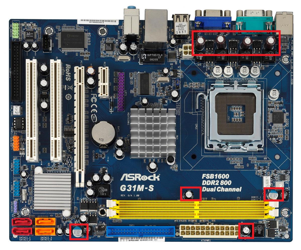

            #125
            Re: Changing voltages.
            I was thinking at least these....what do you think?
            Also, with the lower number of phases that this board has, I'm sure that'd affect the output voltage. Maybe that's why those voltages are bouncing a bit?
            For the 16v, 1000uF (the tall ones that make up the voltage regulator circuit), do you think United Chemi-Con is a good name? I was thinking maybe these guys: http://www.digikey.com/product-searc...=0&pageSize=25
            If they're the ones I'm thinking of, I think they're a real good brand name. Are they the same as Sanyo / Nippon? I saw a post on the Good Capacitor list where someone listed on the same line, Sanyo / Chemi-Con / Nippon. So I was thinking maybe they were the same and the company just changed names?

              #126
              the 4 at the top are the important ones, they supply the vrm regulator.
              maybe the monitoring chip has issues - try looking with the scope.

                  #128
                  Yeah, I learned those 4 at the top are also part of the VRM regulator. I just didn't have any replacements on hand so I had to order them.
                  I think the one next to the CPU fan connector might be for the actual fan, so I'll replace that as well. Then there's one by the RAM and one by the 24-pin ATX power connector. Is the one by the RAM for the RAM? The one by the 24-pin ATX connector, what's that for?
                  -- Law of Expanding Memory: Applications Will Also Expand Until RAM Is Full

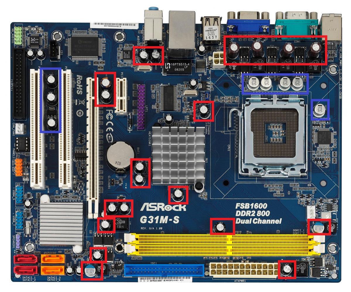

                      #130
                      The red boxes are the ones I'm replacing with polymers. The blue box are the ones I replaced with polymers. I know a lot of the red ones are probably going to be overkill.
                      I placed the order late last night. I really hope I didn't mess up and really need to half or a third the capacitance. I really hope using these polymers don't mess things up.
                      Also, if I'm not mistaken, there are two real polymers already on here. The one by the top right of the DIMM slots (next to the four pin CPU fan connector) and the one between the IDE connector and SATA connectors. I think they're high quality as well. I believe they're Nichicon's.
                      They say on them:
                      lf
                      560
                      j 5k
                      891
                      The j is the voltage code and means 6.3v. The 560 is the capacitance and the lf I think was the series. The 891 was a date / manufacturer code I believe.

                          #132
                          Just to clarify something a bit earlier.... those 680uF / 4V capacitors in the VRM output are not polymers. They are regular electrolytics, presumably by Suncon / Sanyo going by the font. They have the same K vent stamp as other Suncon capacitors do. They don't always bear a vent stamp because 8x8 680uF 4V liquid electrolytic capacitors don't contain enough "juice" to catastrophically explode when they fail, so they don't need the pressure relief vent necessarily (680uF 4V TMVs and TMJs by NCC don't have vent stamps either, although they do have their date and factory codes marked into the top of the can). The worst they will do is bulge, likely from the bottom but possibly the can as a whole.
                          They read high capacitance because their leakage current is high, which alludes to a faulty dielectric. Either the electrolyte has broken down and can no longer supply the dielectric with enough oxygen to correct defects in the oxide film and heal itself or the electrolyte doesn't contain enough oxidizers and corrosion inhibitors to control the aggressive water-base electrolyte so it's consuming the anodic dielectric more or less. And one of those capacitors looks like it's leaking.
                          The 15,000 hour - 20,000 hour polymers aren't a typo. Some wet electrolytics are rated for that as well, although they aren't really low ESR in comparison (they're designed for LEDs and electronic ballasts, IE very hot environments which mandate long life).

                                #135
                                The ones in the VRM circuit got replaced. Voltages still changing, RPM still changing. I started recapping the rest of the board. Because I didn't half the capacitance, once I get the RAM ones done, the one by the fan connector and the one by the chip with the heatsink (nb maybe?) I tested it. It posted and the fan and voltages were stable! It was a pain replacing them by myself. I waited till my wife got home and it took around 30 minutes or so, with her help, to recap the rest of the board. One of them turned out to be 470uF, 16v, not 1,000uF 6.3v. Wasn't exactly sure where it came from though because I stupidly assumed they were all the same. I had a good idea because only four of them I couldn't read. I decided it's the top one by the PCI-E slot. I contacted the company to make sure.
                                Out of the rest of the board, 9 of them were leaky!!! Once the 470uF 16v one comes, I'll put that in and hopefully it still posts!
