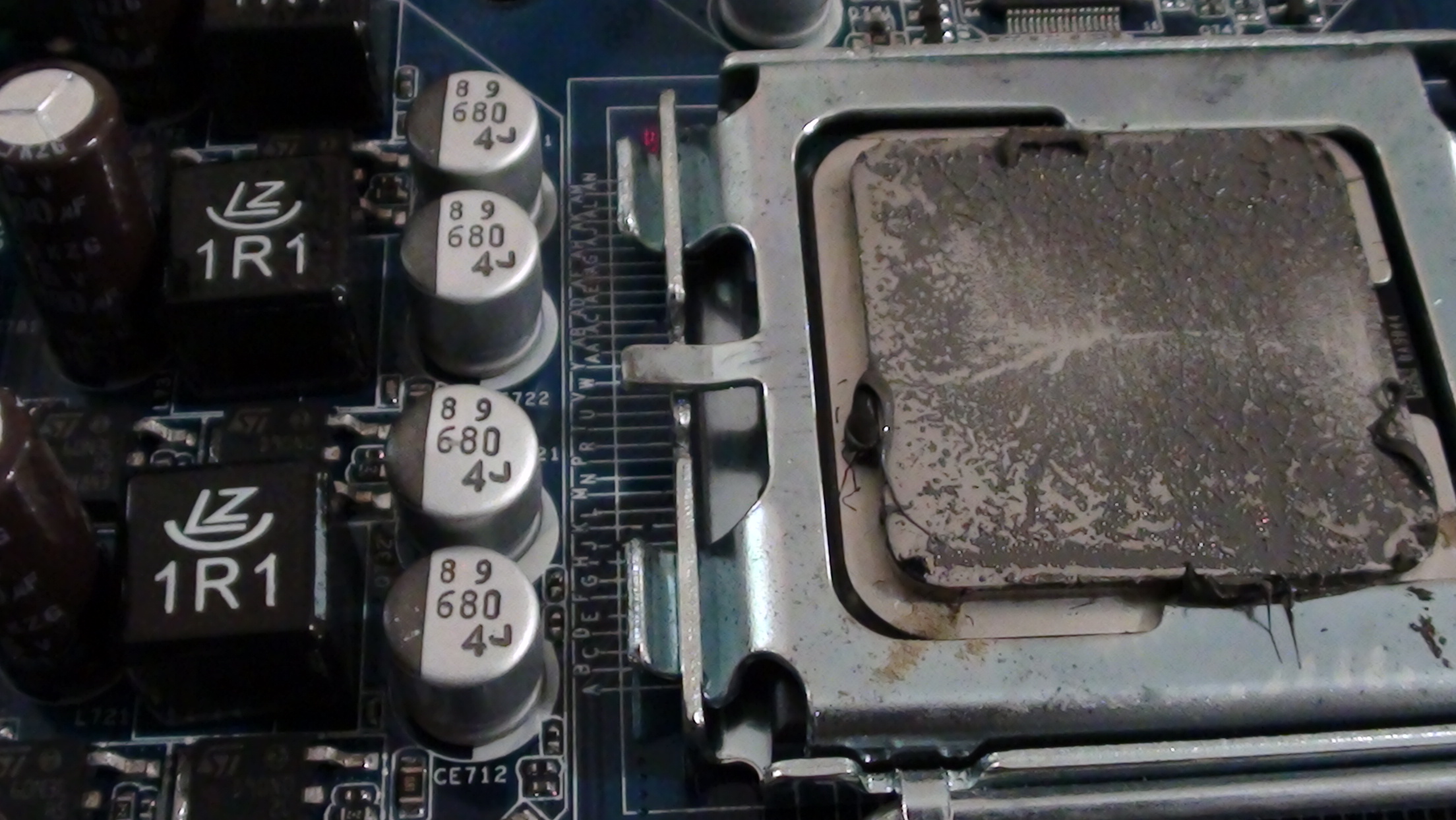

          I received the new power supply today. Vcore and 5.00v are jumping a lot. 3.30 jumps every so often. 12.00v jumps very seldom but does jump. Fan speed is still changing just about as fast as vCore. I'm going to start looking at the caps now because my new 120 watt iron came as well.

                Kinda. I've disconnected the hard drive but not the RAM. I don't really see how the PC can POST without the RAM. Unless, of course, you mean just leaving one stick in and trying it. I don't think it'll be necessary though.
                I just got back from my friends death gathering stuff. I pulled the heat sink off and found the little bigger! One of those polymer caps right next to the CPU. I believe this isn't the best design. The heat from the heatsink will probably fry the caps. There's five caps total, idental. But four of them are in a row, the fifth one is up off by itself. I'm going to replace all of them.
                -- Law of Expanding Memory: Applications Will Also Expand Until RAM Is Full

                  Re: Changing voltages.
                  I believe these are 4v but are the 68uF or 680uF? I'm going to pull a working one and check the capacitance. I do have some nicer 6.3v 680uF polymer caps floating around here somewheres. If the ones on the board are 680uF, I'll use the nicer ones I have. They're Nichicon RL80J681MDN1KX. Even though they have a bit higher voltage rating, I think that'd be fine. So long as the ones on the board are 680uF and not 68uF. These Nichicon ones say 681. If those cheaper caps follow the same naming convention, I'd think the ones on the board are 68uF.

                    hmm - cant ID them
                    http://capacitor.web.fc2.com/solidcapacitor.html
                    whatever they are, i'v never seen one like that before - tempted to ask to see one opened up - incase they arent poly's
                      Yeah, I couldn't find them either but I was looking at 680uF. The size is very hard to find at 4v 680uF. The only ones I could find that really matched the size (either roughly or exactly) where the Illinois Capacitor 687ULR4R0MFF.

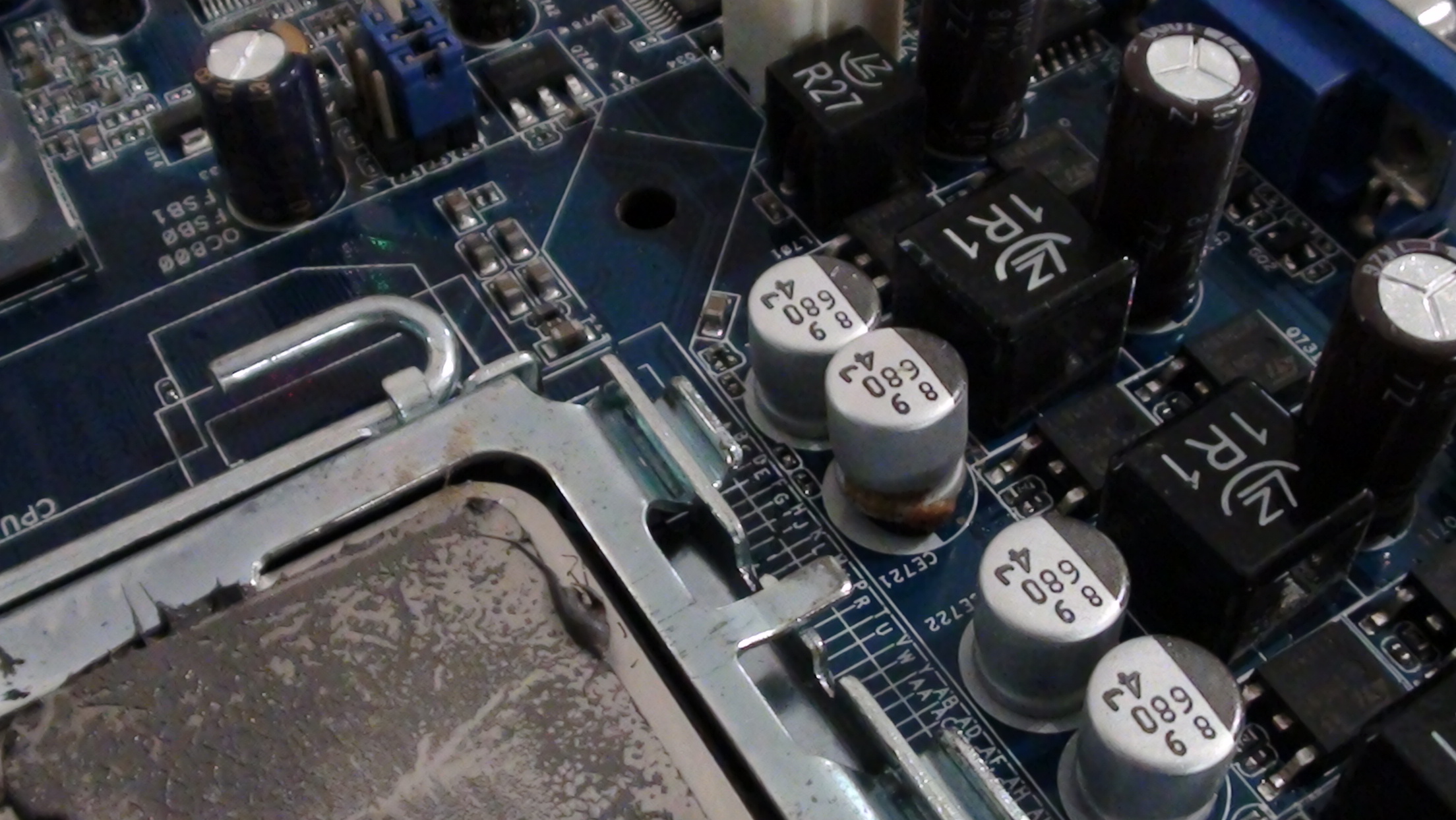

                          DIGITALTECH kinda fits, wrong colour though. The caps say:
                          89
                          680
                          4J.
                          I can try opening the bad one up tomorrow if you want. Just tell me the best way to do it. I'll pull a good one tomorrow and test it with my Peak Atlas ESR meter to figure out the capacitance for sure.
                          I figure they're probably real cheap.

                            well you didnt say the size
                            Whoops. Lead spacing (between the two terminals) is 3.5mm. The rest of the numbers might not be exact. I only have the one removed and it's bottom is blasted out a bit. Height (of just the metal can) seems to be 9mm, width seems to be 8mm. I think it's very hard to get 680uF, 4v in something that small. Makes me think that 680 is actually maybe 68uF. I thought for the VRM circuit though, these caps would be closer to 680uF. When I pull a good one tomorrow, I'll post the confirmed capacitance.
                              Okay, I pulled one real quick. I just couldn't wait. 0.02Ω ESR, 1380μF!!! That can't be right! 1380μF in this little package?? How can that be? If they're failing, could they actually register higher than what they're marked as? I can pull a couple others and test them if you'd like.
                                lol - if your meter could show it i bet leakage is huge!
                                  lol no way they are 68uF. that is too low capacitance for cpu vrm output use. they usually use 560-820uF polys for the output.
                                  also, i dont understand the part about the size being hard to find. there is an oscon sepc 560uF 4v 8x9mm part as well as lots of nichicon fpcaps available in the same size as well? were u thinking those were wet electrolytics caps on the vrm output? well, u need to watch those kzgs on the vrm input as well. those need to go as well!
                                    Thank you for explaining this. I wondered if the VRM circuit used caps around that range. I was looking around the net (over the years) and they always seemed to fall somewheres around there. I wasn't sure though for certain. I know the boards I have around here are around there for the VRM stuff.
                                    What I meant about the size being hard to find, I cannot find very many 680uF 4v capacitors that are around the same physical size. The Illinois ones seem to fit. I could find the 560uF just fine, however, I'd like to stick with the 680uF if that's what these are. I've read many posts how people were switching out 680uF for 560uF OS-CON SEPC's with success.
                                    I do have some 6.3v 680uF Nichicon's that I'll probably try using first. If I didn't have them, I'd probably give the 560uF OS-CON's a shot. I heard they're supposed to be really good caps.
                                    So, what do you think about my ESR meter showing such a high capacitance? I'll start pulling the other ones and checking their capacitance / ESR.
                                          i have seen caps where the uF value shoots up, it is acompanied by very high leakage.
