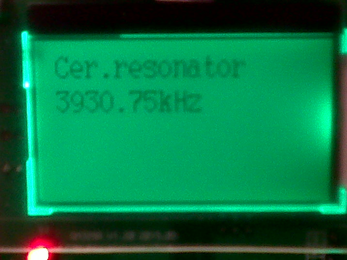

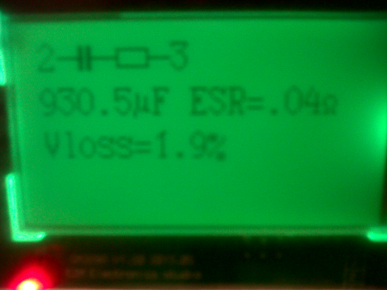

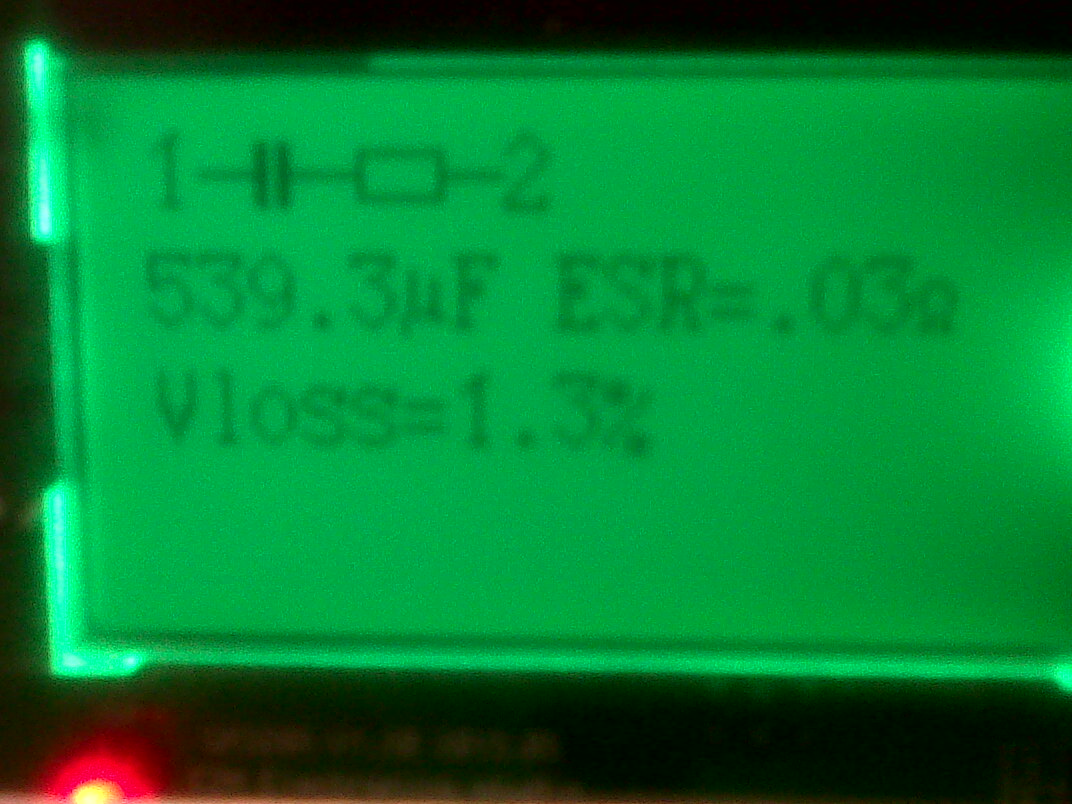

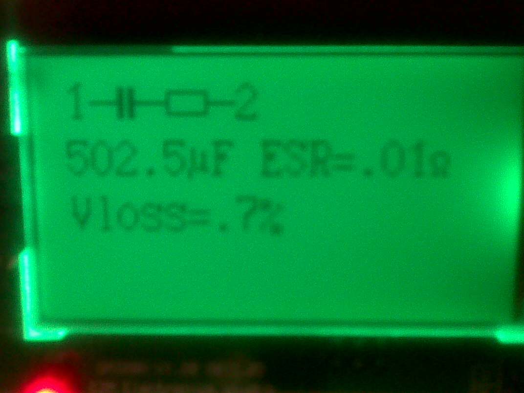

                • 31204
                #107
                Re: Changing voltages.
                hard to say, but as one blew, - i would replace them as a set.
                some pics i just took
                4MHz crystal - because i can
                4MHz 3pin resonator - because i can!
                1000uF 6.3v rubycon MBZ (used)
                510uF 4v sanyo OS-CON (used)
                560uF 4v ncc poly (from a motherboard vrm)

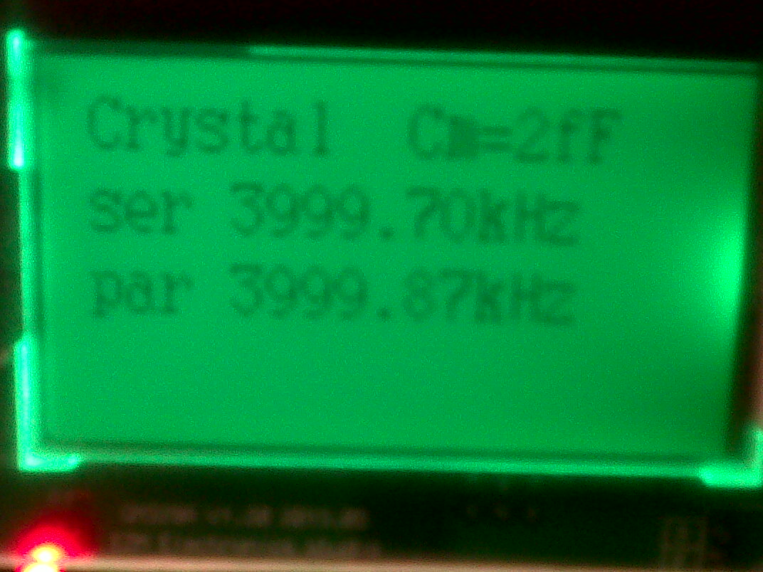

                  #108
                  For the crystal, what do those values mean? The first line says Crystal C<something> = 2ff...then there's ser and par...
                  That looks like a device you built yourself. What is it? Did you have any plans you followed off the net or anything?
                  -- Law of Expanding Memory: Applications Will Also Expand Until RAM Is Full
                  • Spork Schivago
                    • Mar 2012
                    • 4734
                    • United States of America
                    #109
                    Is it an M328 component tester?
                      • 31204
                      #110
                      it is a GM328A but the stock setup cant do crystals.
                      you have to replace the crystal and firmware.
                      the bit about <something> = 2fF i think is a spelling error that should be 2pF
                      it's the capacitance needed to get the crystal to resonate.
                      the ser / par is serial and parallel resonance.
                      you need to read up on crystals to get that bit.
                      when you buy them, there are 2 distinct types.

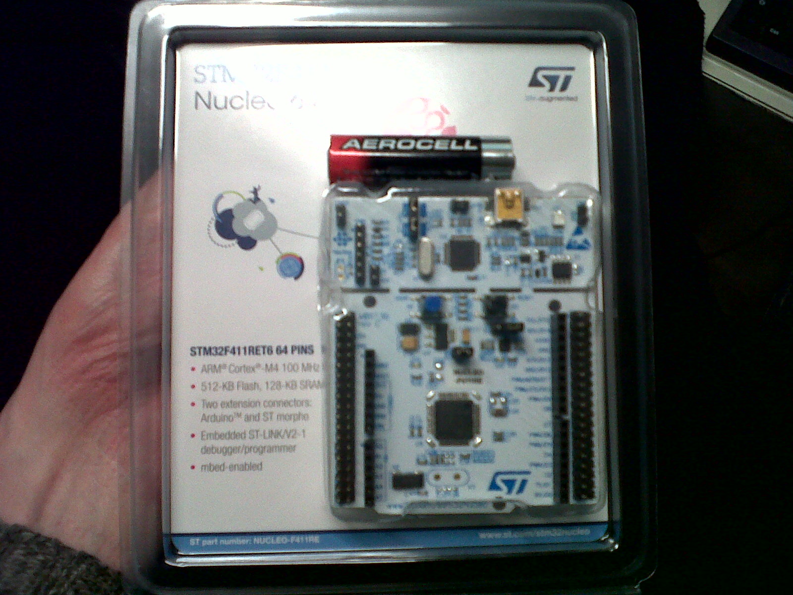

                            • 31204
                            #113
                            btw, i just picked up one of those Arduino-killer dev boards from ST for someone.
                            look at how compact it is (i put a AA battery on it for scale)
                            that's a $10 board complete with detachable usb programmer!!!
