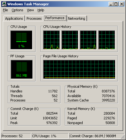

                              Re: My Proc-Mobo Combo Choice......
                              Download Core Temp, it displays the real thermistor reading from each core in your CPU
                              Mainboards frequently misrepresent the CPU temp
                              http://www.alcpu.com/CoreTemp/
                              Note that Windows will require a clean reinstall if you switch from a single core to a dual core CPU
                              You should see two processors in your task manager when they are recongized, here is a shot of my Quad Core CPU so you understand;

                                    @Per Hansson: Thanks for the heads up, and yes I do see two separate graphs in my CPU usage history. ;-)
