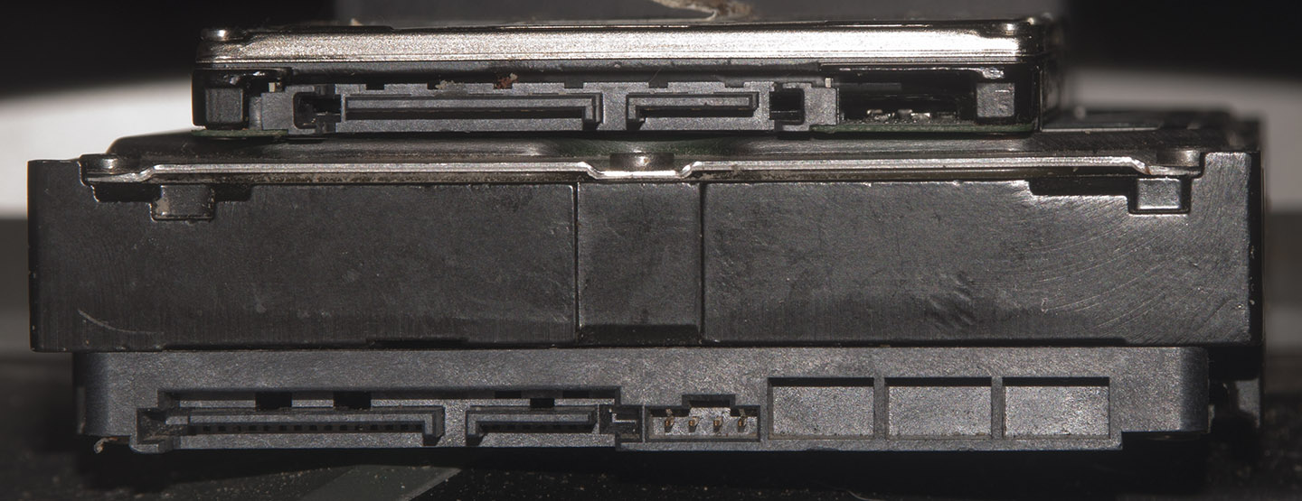

                  Originally posted by alessioblaupunkt
                  Thanks. I can buy the metal plates to adapt the 2.5" in the 3.5" slot.
                  Can you suggest a SATA pci card?
                  Yes and no. You'd need an offset adapter, however I've never actually seen one. One such would stick the drive to the left side of the adapter, probably screwing onto the bottom of the drive rather than sides.
                  As you can see here, when centered (like the adapters I've seen do) the SATA connectors don't line up, instead it has to be aligned all the way to the left.
