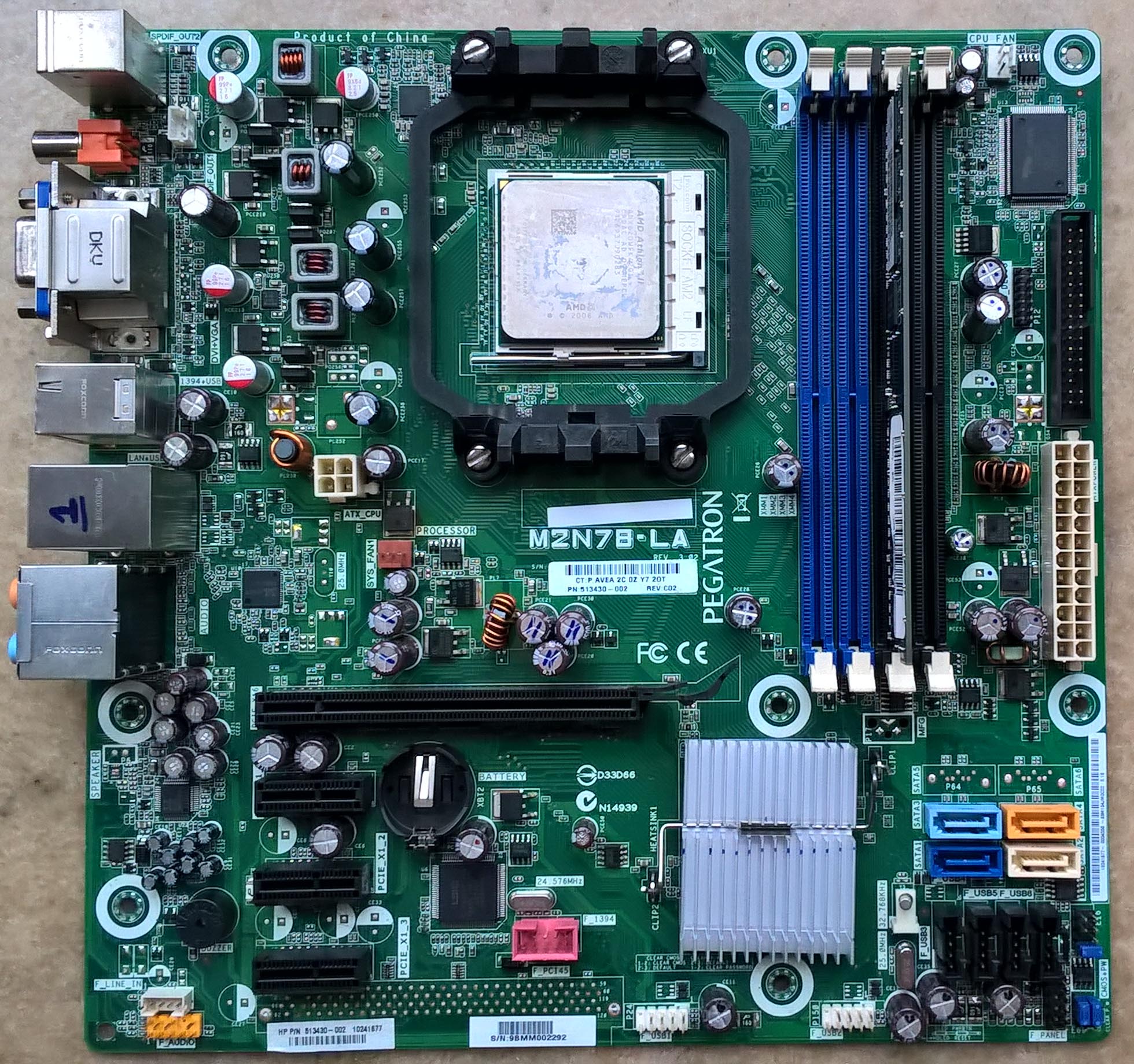

Pegatron M2N78-LA (rev. 3.02) freezes on POST with SATA drives attached
    master hoarder
    • May 2008
    • 12175
    • Bulgaria
    Like the title says, I have a Pegatron M2N78-LA (HP P/N: 513430-002) motherboard out of an HP Pavilion PC. The motherboard hard-locks during POST when it gets to the part of trying to detect the SATA devices *only* if there is a SATA device (be it HDD or optical drive) connected to any of the SATA ports. I cannot enter BIOS or do anything when this occurs. Pressing Ctrl+Alt+Del cannot restart the system either. In fact, the keyboard locks up too (Num Lock status LED cannot be toggled anymore.). However, if I disconnect everything from the motherboard's SATA ports, the motherboard can POST successfully and then goes on with the usual message that there is “No Boot Device Found” (which is true.) Also, when I have everything disconnected from the motherboard's SATA ports, I can go into BIOS without problems and change settings as I like. Actually, the first thing I tried was resetting CMOS settings (several times, too) and making sure everything is set correctly there.
    On that note, I've noticed that if I set the SATA device type to either IDE or RAID, the motherboard won't hard-lock during POST, but instead will just sit on the SATA device detection screen and never goes past it. Pressing Ctrl+Alt+Del can restart the system fine and keyboard doesn't lock up. Only when I have the SATA device type set to ACHI (which is the default value, BTW), the board hard-locks
    Unfortunately, the M2N78-LA doesn't have onboard IDE controller, so I can't test with an IDE HDD or optical drive. However, the board does have an FDD / floppy controller. Interestingly enough, that doesn't appear to work either - the motherboard never sees the floppy drive/device as connected. As such, inserting a bootable floppy does nothing (not even an attempt is made to spin it up.) Just to be sure, I did test with two known working FDDs and cables that I used recently, too. Now if I am not mistaken, FDD goes through the Super IO / LPC chip, which traditionally also provides PS/2, Serial, and Parallel port functions (and on this board, at least my test PS/2 keyboard was working fine.)

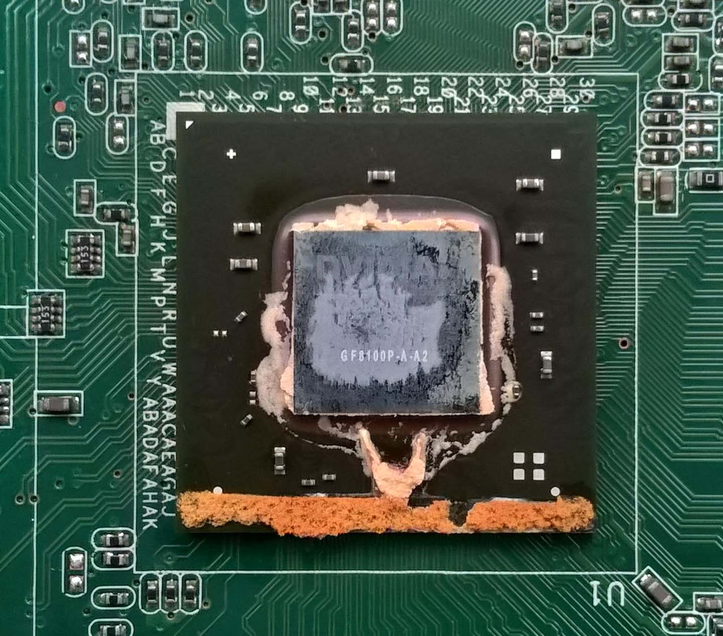

    With that said, probably first thing I should mention is that the M2N78-LA does use a GeForce chipset / MCP (and I suspect that may be the root of the problem.)

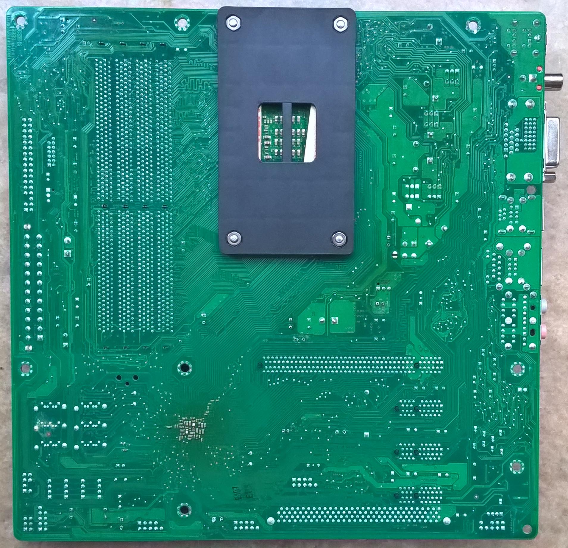

    In fact, there appears to be noticeable heat discoloration on the PCB around and under the chipset, along with a few other hot areas - though that is more or less something I regularly see on these GeForce chipsets, since manufacturers rarely bother to put adequate heatsinks on them (and these suckers run hot too.)
    https://www.badcaps.net/forum/attach...1&d=1606626406
    In terms of what I've tested with / so far…
    - I've tried with different HDDs and optical drives - one device or multiple devices at a time, and tested on all ports. Interesting note here: when an optical drive is connected to the SATA ports, the drive becomes locked and trying to eject the tray does nothing.
    - I've tried different and known-good sticks of RAM in different slots, one stick at a time.
    - I've tested with two known good PSUs – one of them being a fully recapped HiPro and the other a partially-recapped Delta.
    - I've tried resetting CMOS (in fact, I keep the motherboard without a CMOS battery, as I can't really use it for a PC build, obviously.)
    - I've tried different CPUs too - both the original Athlon II X4 that came with the HP Pavilion PC and also a known-good X2 5200+.
    - And finally, I did try a quick reflow/reheat of the nVidia chipset. But I only managed to heat it to ~180C, so perhaps it wasn't hot enough. Nothing changed in terms of function (or lack thereof) after this.
    - Oh, and regarding caps - I checked (out of circuit) all of the single ones that filter important rails and even replaced a few, just in case… but still no change in operation.
    So any ideas what else I could try?
    I think I pretty much exhausted most options. Maybe reflow GF MCP again? Otherwise, I was also thinking maybe I can get a PCI-E 1x SATA expansion card (though I feel like that may not be worth the investment, considering this is a GeForce chipset motherboard.) What's your take on that?
    As far as history of the board goes… well, I picked up this PC as scrap, along with 10-12 others, from a PC repair shop that was cleaning up storage. So unfortunately, I don't have any history of when the motherboard failed or how. All I can say is that about 2/3 of the other PCs from that place ended up working. Many just needed minor work, like new caps, working PSU, and/or good cleaning, along with parts (most lacked RAM, HDD, and etc.)
    Anyways, here is a picture of the motherboard, so you can see what I'm dealing with:

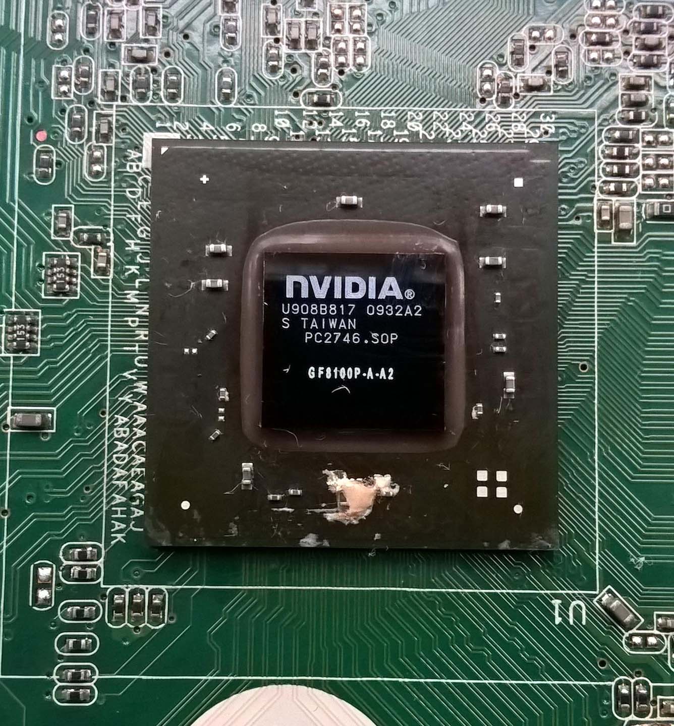

    Also, here are a few pictures of the chipset, from before the reflow (with gunk thermal compound still on there) and after the reflow (cleaned).
    The chipset is a GeForce GF8100P-A-A2. Are these affected by the bumpgate? And if so, would you say I'd be wasting time trying to reflow it again? I have a similar Pegatron motherboard from another HP PC from that repair shop. Not sure if it also is an M2N78-LA or not, but from what I could tell when I had it opened, it was the same board, but only with 2 RAM slots, and IIRC also a few other ports missing. It came out of a lower-end HP Pavilion, and thus only packed an Athlon II X2. That PC ended up working fine, though. I added a small 40 mm fan on the chipset / MCP heatsink, and it seems to run adequately cool. I don't remember if that board had the same kind of PCB burn / darkening as this one, though.
    Anyways, thanks for reading and cheers!

      This MCP shouldn't be affected by bumpgate, it's 2009 datecode and has white underfill. Well actually you can't call the underfill "white" anymore… so definitely it got a lot of heat and could still be damaged.
      First thing I'd try is to flash the BIOS though.
      Can you at least boot from USB?

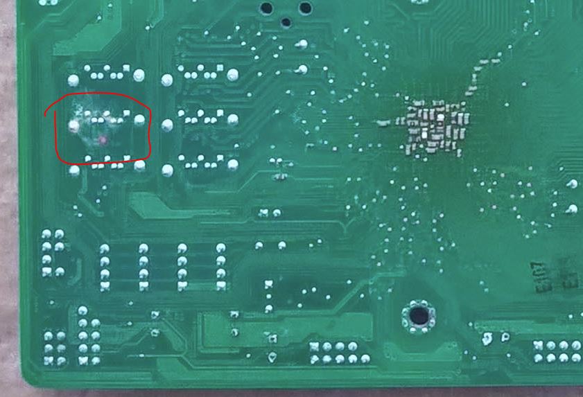

        Is that a corroded via or some sort of damage on the back of the board,opposite the SATA connector ?

          Re: Pegatron M2N78-LA (rev. 3.02) freezes on POST with SATA drives attached
          Cool, thanks for your input, piernov!
          I guess I should have asked before trying to reflow it, though I imagine I didn't hurt anything given the temperatures reached.
          This also gives me a bit more hope about this chipset if I do get the board fixed that I can use it for a more "worthy" PC and not worry that it will fail (though I do plan on installing a fan on the MCP heatsink if the board gets fixed.)

          I didn't try, since I don't have any bootable USB devices on hand (seems like I've put / backed up junk to most of my flash drives, so I have to check which one, if any, I can format to make bootable.)
          However, even though I posted this thread yesterday, I forgot I did actually order a PCI-E 1x to 2-port SATA card a few days ago (found it cheap on eBay.) Saw it in my mailbox this morning and tested the board again. With this card, I can get an HDD recognized in the system (and move past the POST routine), so I may be able to set up an OS for this motherboard to test it out and then flash BIOS too. Will try to do that in the next few days and report back.
          It was flux residue turned white (perhaps it wasn't fully washed off from manufacturing?) The above picture was taken before I had removed some of the caps to test them. After doing that, I cleaned the area around the caps I had soldered/desoldered with IPA. While at it, I also cleaned the residue under the SATA connector. So there's no more residue and I don't see any corrosion either. Vias look OK, too.

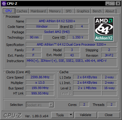

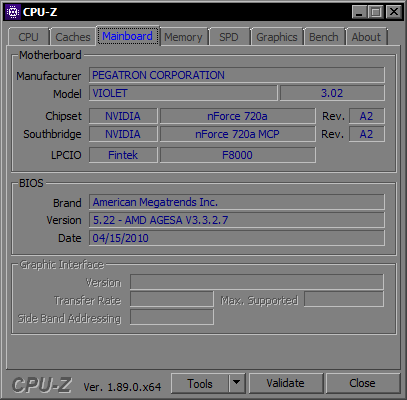

              Here is a CPU-Z info screenshot of the motherboard with new BIOS:
              You can see now it is showing v5.22 (whereas before updating, I think it was v3.xx - dang it, I should have taken a screenshot of that. )

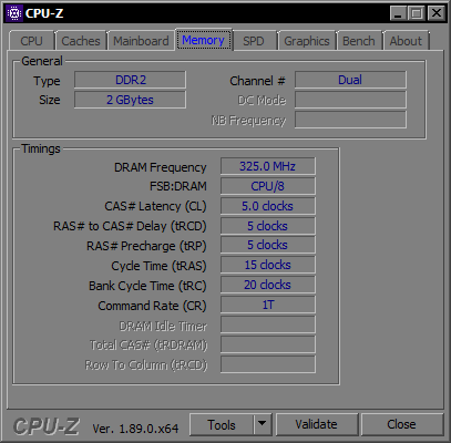

              And while at it, here are the memory config and CPU info screenshots in CPU-Z

              Perhaps there might have been a way to do the BIOS update without Windows and rather through a USB stick… but I figured the HP utility should work once I had the OS set up and all of the drivers properly installed, so that there would be no possibility of something making the system hang and the BIOS update utility crashing midway.
              On that note, the HP BIOS update utility does make the picture on the monitor, the mouse pointer, and even the keyboard (including Num Lock key) freeze / not respond while the BIOS is updating. There is no warning that this will happen when the package is launched, so one might think the motherboard is frozen/bricked. Luckily, I decided to be patient with it and just let it be. After 2-3 minutes of no response, finally a message popped up for maybe 3 seconds max, saying the system and screen might freeze during the update process (gee, HP, thanks for the warning after the fact ), followed by a prompt to restart the PC… so I did. The motherboard went through its usual boot-loop cycle that it does when the CMOS has been reset/erased. Thus, I had to go in BIOS and re-enter some of the settings that got erased. After this, I let Windows 7 start normally again through the PCI-E 1x to SATA card, just to verify that the system is stable with the new BIOS.
              To do this, I ran the system through the same tests again that I did after installing the OS and drivers - basically, I ran a bunch of YT videos (for varying load on the CPU), OCCT CPU tests, and even a GPU + CPU test. All passed the same as before. The only difference that I see with the new BIOS is that now the CPU fan and rear exhaust fan seem to run a little faster than before (maybe even too fast, I should say.) But the more annoying part is that the fans will spin up to high speed every 2-3 seconds for about 1 second, regardless of what the CPU temperature is. This did not happen with the old BIOS, which ran the fan slower, but still provided more than adequate cooling performance. Not only that, but now when I try to run SpeedFan (a software utility used for hardware monitoring), Windows crashes to a brown/gray/black (usually one of the three) -colored screen, whereas before, I had no problems running it. That’s not too big of a deal, though. Lastly, I also noticed the CPU seems to switch between different performance states (and V_core voltages) way too often - almost constantly, in fact. Perhaps the new v5.22 BIOS is optimized for the newer Athon II CPUs better and not so much for the older Athlon X2 5200+ (Windsor) CPU I have in the PC right now. In any case, the new BIOS did not seem to add any positive improvements in system performance.
              But let’s not forget why I did the BIOS update - to try to resolve the issue with the motherboard hanging when any SATA device is connected to its SATA ports. So after the above tests, I decided to take out the PCI-E 1x to SATA add-on card and plug in the HDD and optical drive back into the motherboard again, to see if the new BIOS fixed the issue.
              And............................................................ That was still a FAIL!
              The motherboard hung up exactly the same way as it did before. Again, I tried testing with HDD only, with optical drive only, and with both connected to the motherboard’s SATA ports. No combination of these would allow the motherboard to boot, unless I disconnected both again.
              So in short (after writing the above wall of text ) the v5.22 BIOS update did NOT resolve the issue.
