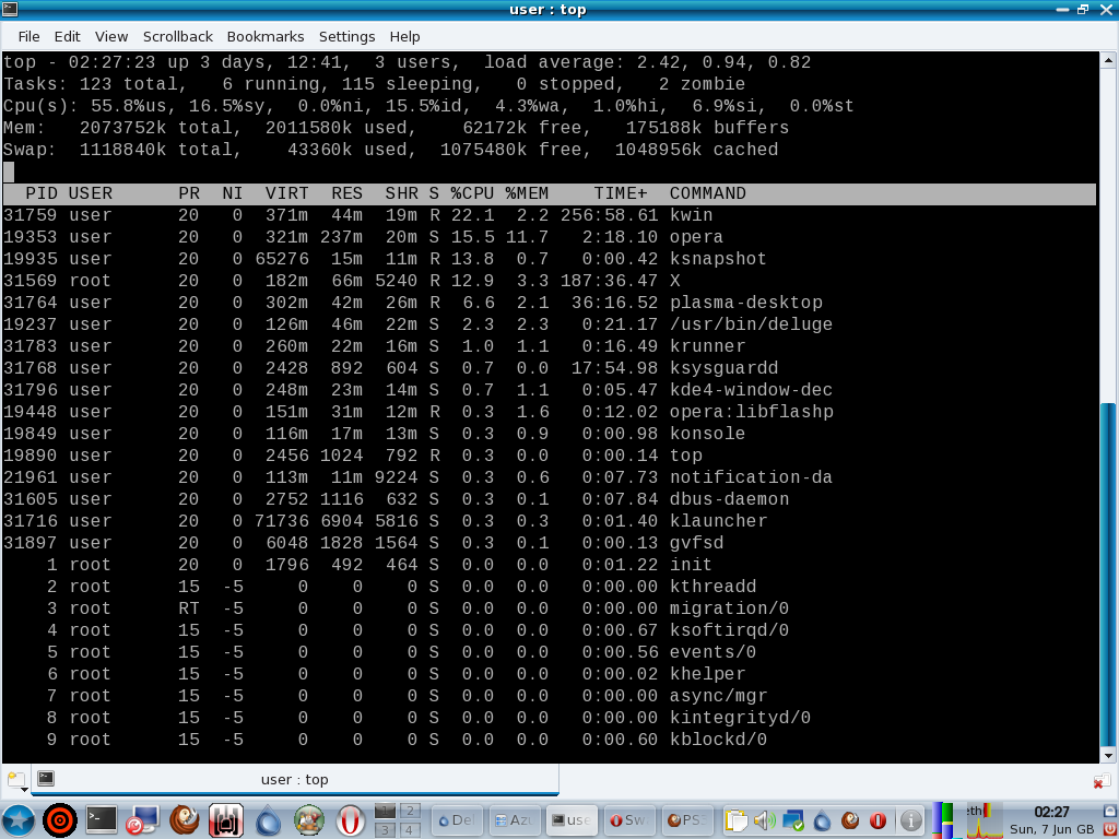

                                      search the web for a windows equiv of the linux "top" command.
                                      it looks like this.

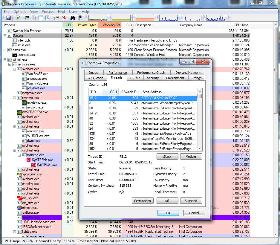

                                        Download process explorer and have a look at what is using allot of resources:
                                        https://technet.microsoft.com/en-us/.../bb896653.aspx
                                        I attached an example picture for a problem on my work computer, it's related to Symantec Endpoint protection using allot of "system" CPU time when the definition files are updated.
                                        But you can't find that out with Windows built in "task manager"
                                        But with process explorer I can open up the process "system" and see how much CPU time is used by it's parent processes...
