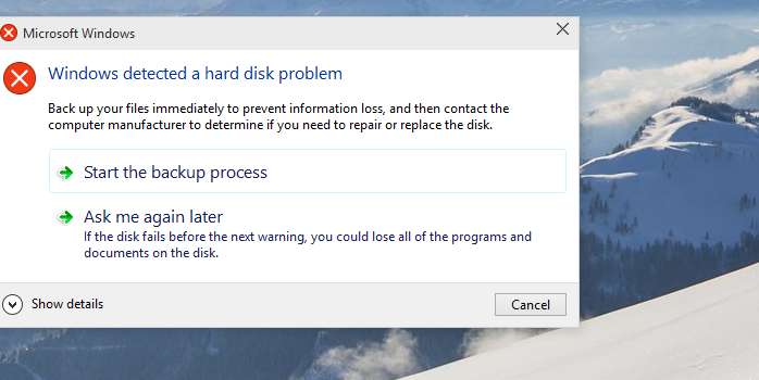

    Hi guys;i have this HDD error showing some times,see pic attach.
    it started in Win7 and also in Win 10 TP after i upgraded.besides that everything running good.i already checked HDD cmd, chkdsk /f
    and there is no errors showing.
    Also the error doesn't show in Ubuntu 14.04.

    Download the hard drive diagnostic software from the manufacturers website. Burn it to CD and boot.

      I don't know if Ubuntu includes Gnome-Disk-Utility anymore but that tool should also flag errors like this (probably a SMART condition that the hard disk is flagging to the OS).
      But you should heed that warning. Then again you should always backup the hard drive...

        heed that warning. take it from someone who has processed thousands of recycled drives, its going and for all you know its going fast.

          Hi guys; update on the HDD issue; well i change to another Sata HDD,installed Win 7 and then upgraded to win 10 TP and all good,
          i really don't like to deal with software or hardware Issues,too much to my head,i always like to go the easier route;
          on the other HDD that had the HDD Error failing, i installed Ubuntu14.04 and no error notifications,i keep it as spare,in case i'm not given a free Win 10 RTM.

              That happens because SMART has been tripped. I don't think Ubuntu monitors that, whereas windows does (which is why you didn't get the error in Ubuntu). You could download and run a Short Drive Self Test with Seatools on the drive, and it would probably fail.

                        To check S.M.A.R.T. numbers I use Crystal Disk Info for Win7,8 (free, but un-click the adware box during install). It will also log your numbers, email on troubles etc.
                        The Google paper on disk failures ("Failure Trends in a Large Disk Drive Population") found few S.M.A.R.T. parameters correlate with impending drive failure- first Scan Error, re-allocations, etc.
                        Drive temperature had no effect on lifetime. It's an interesting read but they wouldn't say which manufacturers are lousy.

                          Hi guys Update on HDD failure,i did the test in Ubuntu 14.04,although it doesn't show any signs of failure,running Ubuntu at this moment.
                          here the results.
                          For now i will run it in Ubuntu till it fails,besides in my opinion ,for me Ubuntu 14.04 better than win 7 or 10,i just stream and browse though ,
                          i'll keep the good HDD with Win10 Tp installed and will check it out when Win 10 RTM comes out , if MS requires money then screw it, i'll keep free Ubuntu 14.04 very happily.

                          Error 116 occurred at disk power-on lifetime: 14556 hours (606 days + 12 hours)
                          When the command that caused the error occurred, the device was active or idle.
                          After command completion occurred, registers were:
                          ER ST SC SN CL CH DH
                          40 51 02 ae f4 49 e0 Error: UNC at LBA = 0x0049f4ae = 4846766
                          Commands leading to the command that caused the error were:
                          CR FR SC SN CL CH DH DC Powered_Up_Time Command/Feature_Name
                          42 00 10 a0 f4 49 e0 00 04:32:36.061 READ VERIFY SECTOR(S) EXT
                          42 00 20 a0 f4 49 e0 00 04:32:36.060 READ VERIFY SECTOR(S) EXT
                          42 00 20 80 f4 49 e0 00 04:32:36.058 READ VERIFY SECTOR(S) EXT
                          42 00 40 80 f4 49 e0 00 04:32:39.878 READ VERIFY SECTOR(S) EXT
                          42 00 40 40 f4 49 e0 00 04:32:38.652 READ VERIFY SECTOR(S) EXT
                          SMART Self-test log structure revision number 1
                          Num Test_Description Status Remaining LifeTime(hours) LBA_of_first_error
                          # 1 Short captive Completed: unknown failure 90% 14546 16453020
                          # 2 Short offline Completed: unknown failure 90% 14546 325795665
                          # 3 Short offline Completed: unknown failure 90% 14546 171868828
                          # 4 Short offline Completed: unknown failure 90% 14388 33069049
                          # 5 Short captive Completed: unknown failure 90% 14388 16453020
                          # 6 Short offline Completed without error 00% 0 -
                          SMART Selective self-test log data structure revision number 1
                          SPAN MIN_LBA MAX_LBA CURRENT_TEST_STATUS
                          1 0 0 Not_testing
                          2 0 0 Not_testing
                          3 0 0 Not_testing
                          4 0 0 Not_testing
                          5 0 0 Not_testing
                          Selective self-test flags (0x0):
                          After scanning selected spans, do NOT read-scan remainder of disk.
                          If Selective self-test is pending on power-up, resume after 0 minute delay.
                          • goontron
                            5000!
                            • Dec 2011
                            • 4108
                            • US
                            Re: HDD error help
                            looks like the heads met the platter...

                              Re: HDD error help
                              thanks goontron; what will be be the signs when it it starts to fail?
                              • goontron
                                5000!
                                • Dec 2011
                                • 4108
                                • US
                                Re: HDD error help
                                this one will probably start dropping sectors, or just go right to the click o' death.
                                Follow the white rabbit.
                                • eccerr0r
                                  Solder Sloth
                                  • Nov 2012
                                  • 8701
                                  Re: HDD error help
                                  As far as the onboard diagnostics say, the drive has already failed: it ran out of spare sectors and data loss is imminent, if you haven't lost any already from the reallocations. Count your blessings and your backups now! And your money for a new drive...
                                  • goontron
                                    5000!
                                    • Dec 2011
                                    • 4108
                                    • US
                                    Re: HDD error help
                                    two votes for dropping sectors...

                                    • kc8adu
                                      • Nov 2003
                                      • 8832
                                      • U.S.A!
                                      Re: HDD error help
                                      and my vote for a backup then drop in scrap pile! huge amount of reallocates and some current pending.its a goner!
                                      • RJARRRPCGP
                                        • Jul 2004
                                        • 6304
                                        Re: HDD error help
                                        The CRC error section looks like possibly a bad board on the HDD.
                                        Maybe bad cache RAM?
