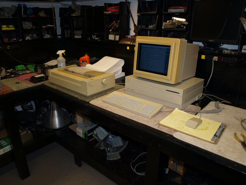

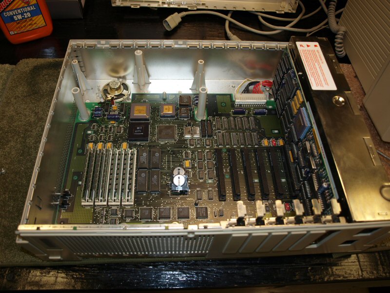

    Things were a little slow around the shop today, so I figured I'd tinker around with this Macintosh II that was given to me a couple weeks ago. It quit working (would no longer power up) in 1996, at which time they switched over to the PC platform. This old Mac has sat in the dank cold basement of a 100yr old storefront building for a local realtor's office ever since...so you can imagine what it was like down there....

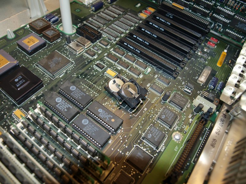

    I know nothing of Mac's other than the hundreds of G5 iMac and G4 eMac's I've recapped...... I plugged it in, pressed power, it wouldn't do anything....nothing. Common sense says to start in the power supply. Measured the PSU outputs, nothing, not even STBY. I removed it, took the cover off, blew out the almost 30yr old dust bunnies, and had a look... Starting in the primary, things were looking good. Fuses ok, rectifier diodes ok, no bloated/leaking caps, no red flags....so before I really start digging into it, I research the PSU model, which came up with a lot of obscure information on the entire Mac II system..... Apparently, these PSU's do not have standby voltage. When the power button is pressed, the initial powerup signal voltage is supplied by the CMOS battery, and once powered up, the +5v rail takes over and maintains the signal voltage....so I look at the motherboard and see 2x half AA size 3v batteries. One showed 3v, I was in shock that it was still good after all these years and stored in a cold place. The second one was dead as a mackerel... They were soldered to the board, so I cut them both off at the batt, leaving the leads in the board.
    I had nothing like that laying around....but being 3v, a couple CR2032's would do just fine, atleast temporarily... I robbed a couple bad SX270 boards of their batt holders and soldered them in place and stuck new batteries in them.
    ok, not the prettiest....but fine for testing purposes....

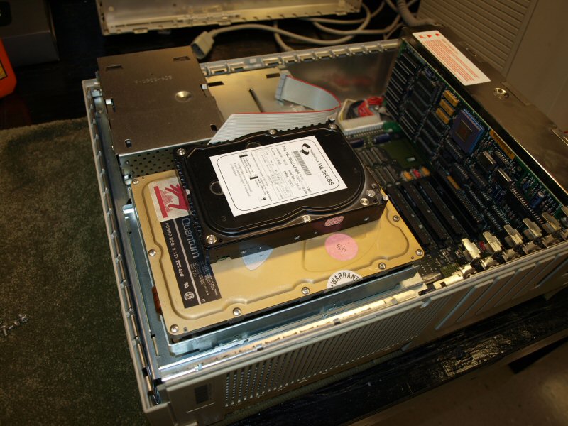

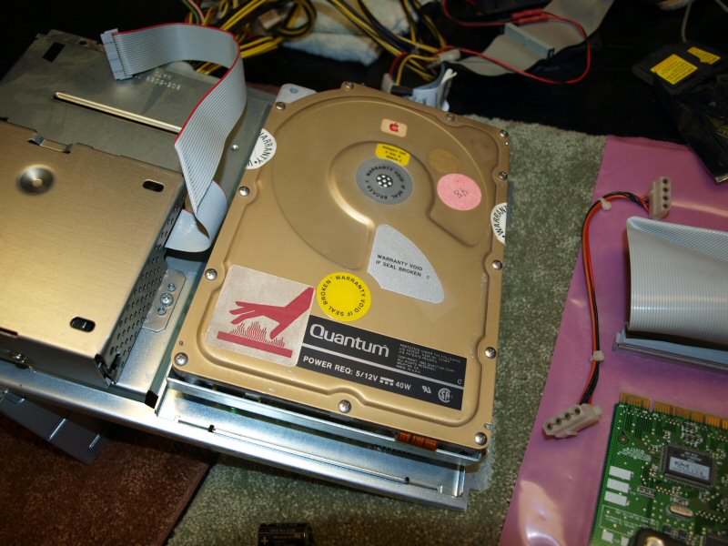

    Putting it back together.......the ultimate "bigfoot" HDD, eat your heart out Goontron!! A whopping 80mb SCSI.

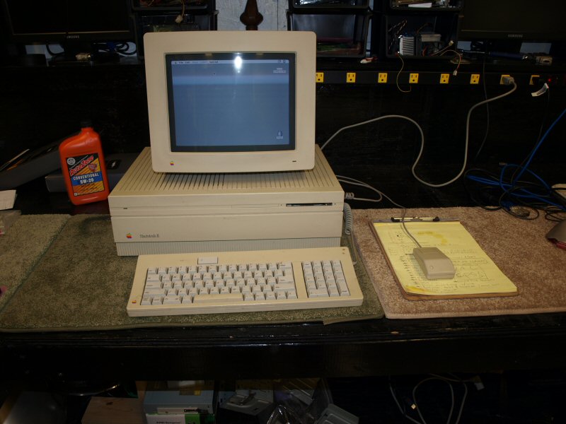

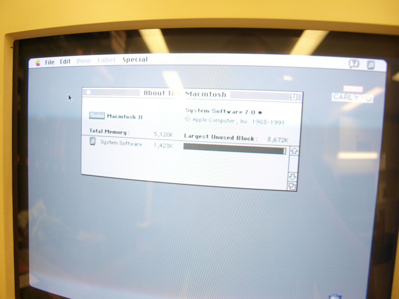

    Low & behold, ignition!! The monitor really grumbled and groaned the first few seconds......between the degauss and all those old caps reforming, it made some really cool frankenstein lab noises. It booted right up.
    There is no stripe in the display like the pic shows.... yay for low refresh rates and cameras.
    Whopping 5mb of RAM....
    That concludes today's lesson on how to waste an hour's time on a completely useless machine!!

    But you had a nice trip back in time to what was an expensive computer then! I found a Compaq win 95 laptop that fired right up and even had office on it but never had been on the internet and ran amazingly fast! TIME WARP!

      Just a heads up the rest of the motherboard probably will need a recap. Apple's capacitors of that time were utter crap and have a tendency to leak.
      I have a Mac Classic II and a Mac IIcx that both need recaps, just haven't had a chance to buy the caps to do it.

        most of the old mac's i'v seen are all tantalum.
          There are a few axial lytics, all nichicon. Don't remember the series, but were 470uF 16v. None appeared to be leaking, but we know how that goes around Badcaps.net....thanks for the heads-up compgeek. The caps in the PSU were all UCC.

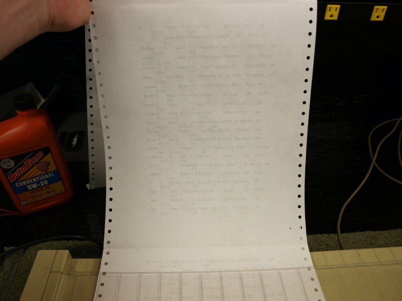

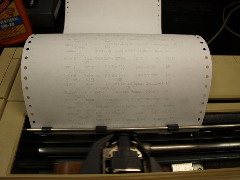

            While I was at it, I tried out the printer. The ribbon is dried out, print was very light. I doubt you can even get a replacement for it anymore....but it did print!!
            Some MS word doc that was on the system....
            Glare reducer cleaned up. This system must have been near a window when it was used, much of the plastic has the classic UV yellowing...the glare reducer was the worst.

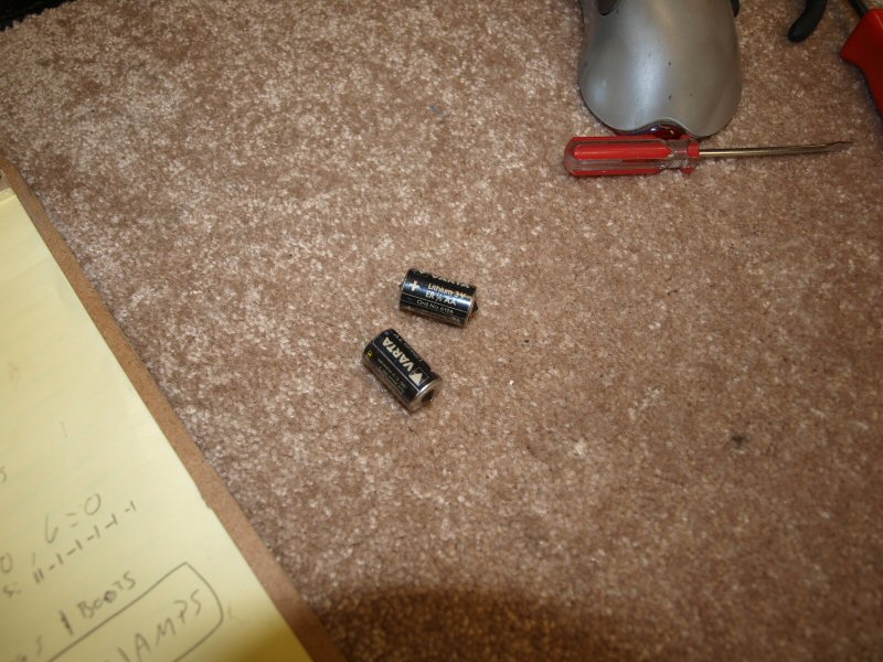

                            Sorry to resurrect this thread, but I have a Mac II showing similar symptoms. One of the two soldered batteries is showing 3V and the other nothing. When started up, I hear the "dead" sound. What would be the best solution to replace the batteries on the cheap?
                            I looked on eBay but not really sure if it worth what I found. Maybe there's better place to find replacements.
                              • 31161
                              Re: Macintosh II Ressurection
                              they are ½AA 3v lithiums i think - wire ended.
                              you can get them, but you can also get then without wires and buy a pair of holders.
                              probably cheaper that way.
                              there is no bodge for this, you need those big cells.
                              what's written on the old ones?

                                  I wonder if it could be possible to use this socket and CR2032 here? they are dirt cheap, and we can get 2032 cheaply on eBay too.
                                    • 31161
                                    2032 wont last as long though.
                                    if you do want to use 2032's you can salvage the sockets from some old motherboards.

                                      I have a bunch of 3.6V 1/2 AA batteries, sadly this bad guy it using 3.0V.
                                      Sockets for 1/2 AA are easy to find and cheap on eBay. The batteries is something else... They tend to be expensive...
                                        • 31161
                                        they are sold as camera batteries - so people take the piss with the price.
