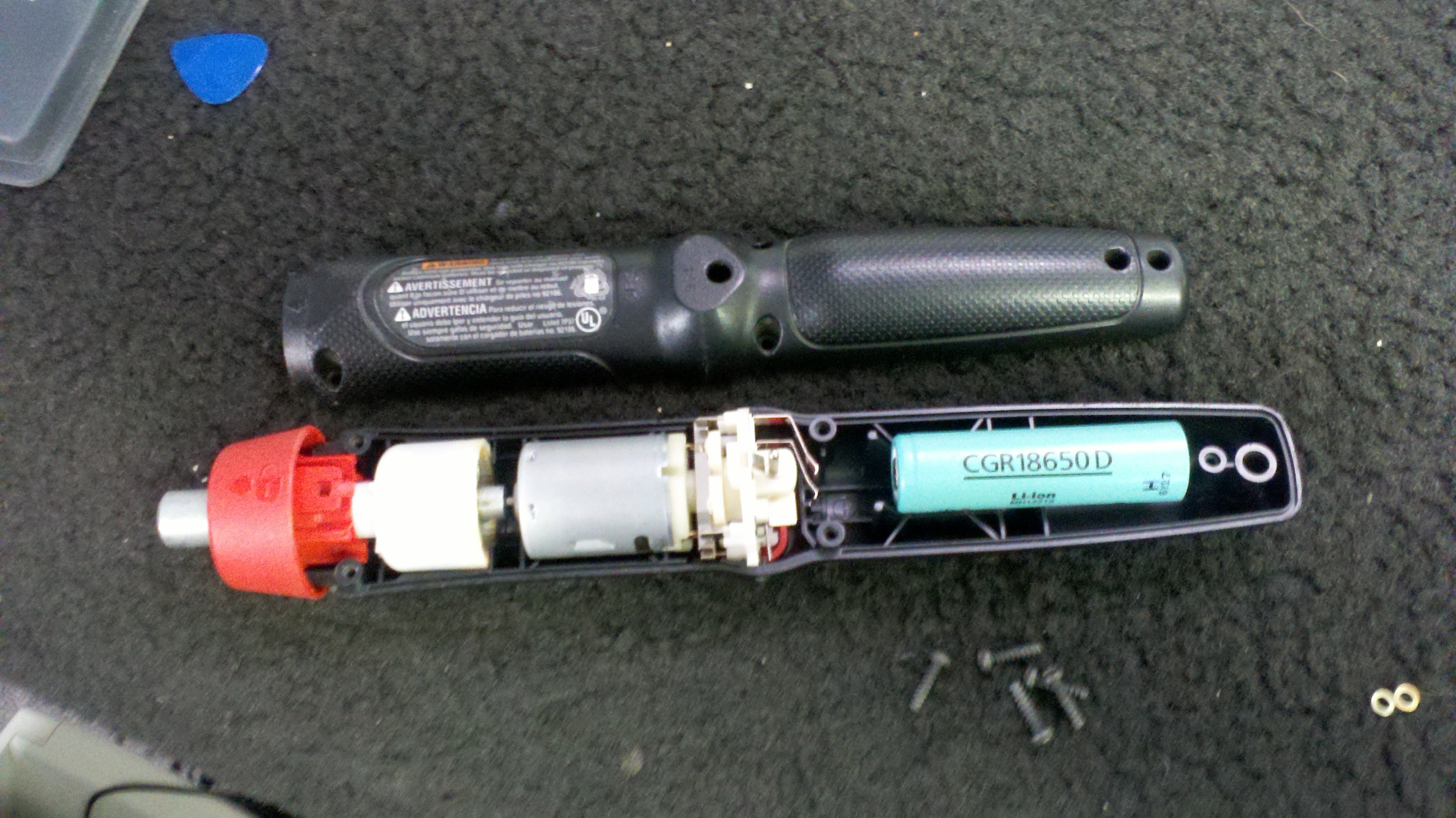

    i suspect many here have these power screwdrivers too.
    stand by for the full mod.will have usb charging too.

        Re: screwdriver mod.
        will be protected when complete.
        i got some good boards that can take the lra of the motor.
        even if i went direct it would be ok as long as i have good charger control.
        by the time it hits less than 3v under load its going to perform poorly anyway.
        and 18650 cells are essentially free here so i dont really care if i shave a few cycles here and there.real danger is overcharging and recharging after draining way too low.like 0v by leaving iy on.tool has momentary switch.

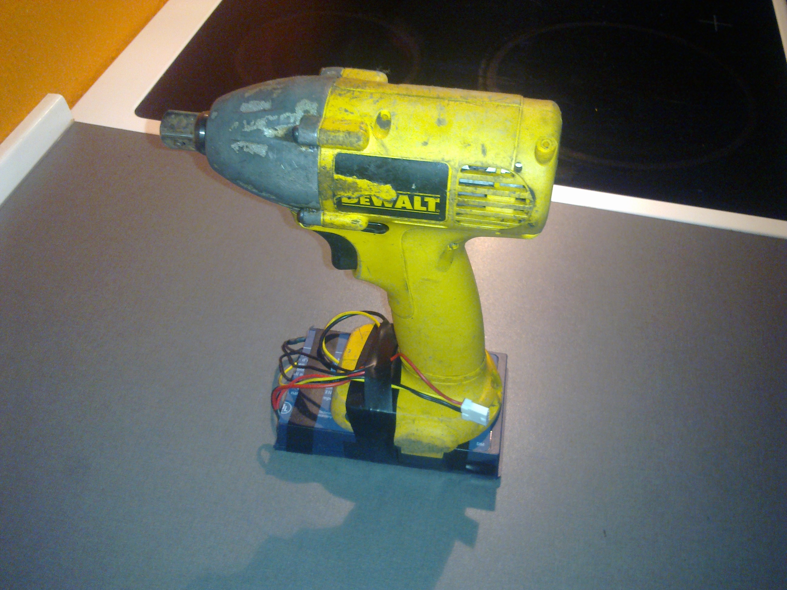

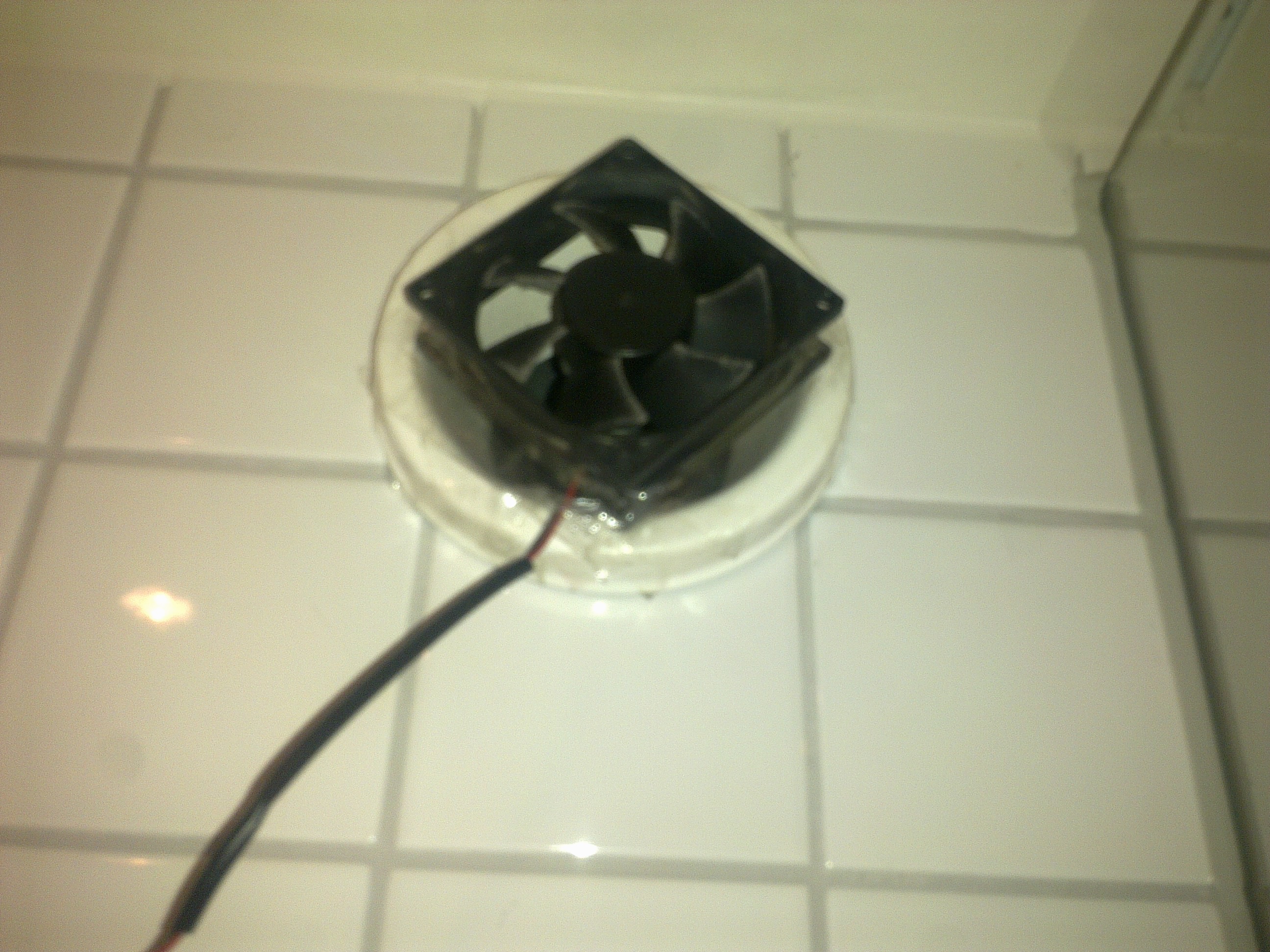

              I have 3 li-ion mods around me. Of course, all of them ghetto, all unprotected.
              1. ATX fan wired to small timer circuit on 6 li-ion cells that is forcing steam out of the bathroom. there was nofan before, just an ineffective ventilation line
              2. Bosch Cordless drill. Used to have ni-cd/mh (can't remember) pack, dont have it anymore, there are 3 flat laptop battery cells under it. Functions as a stand
              3. Dewalt impact wrench. Should have nicd/mh pack under it. Has 6 cell laptop batteries in a 2/3 of the 9 cell battery box (shape was better). Works as a stand as well.
              Always charging using a smart charger
              didn't bother to take a picture pf bosch. and yes i do use tape in ghetto mods. "It aint ghetto if you did not use any tape?"
