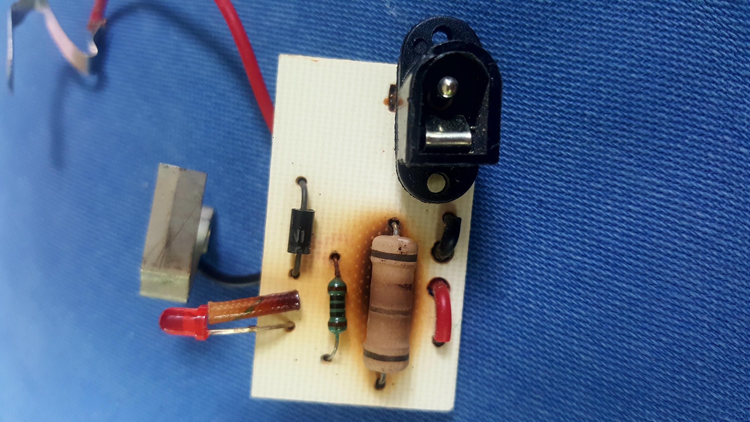

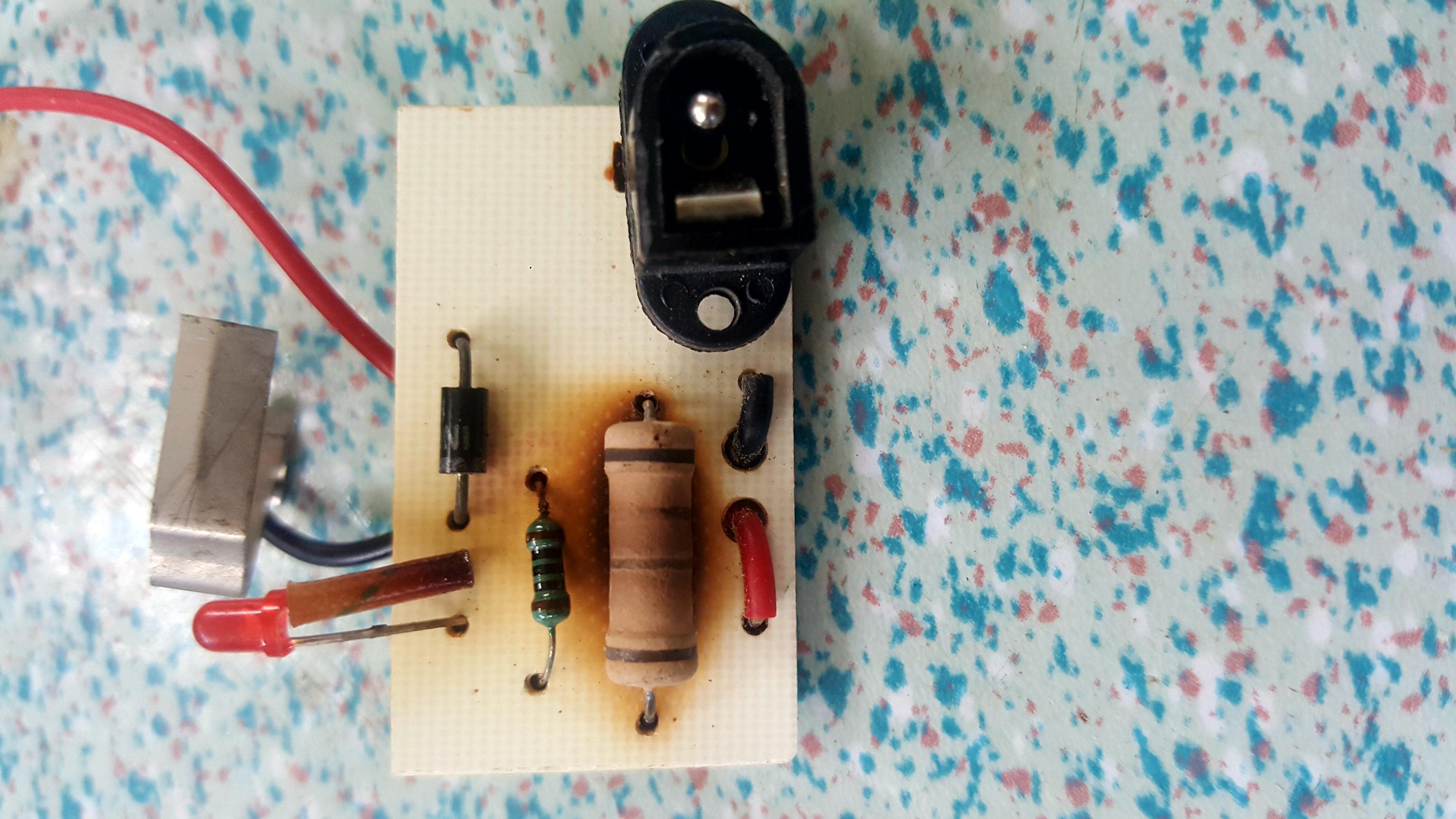

    I am looking for the two resistor values located on the small board inside the battery charging stand.
    Please help if you know

    Re: Ryobi cordless driver drill cbd-120vr
    Please post some pictures of this device
        please find attached relevant pictures for RYOBI CORDLESS DRIVER DRILL
          I personally would recommend modifying the charging current and not using a resistor to do it
          I would use a LM317 in the current mode and set it 500 to maybe 750 milliamperes at the most
          If you have the battery on charger all the time then I would recommend not going more than 300 milliamperes at the most probably be better 150 milliamperes would be better choice
          Or use a readymade current controller board and just remove the power jack and wire it to current controller board
          Ok one resistor is for the led and the fatter one is the current resistor for charging the battery
          One note you need to check the diode and make sure it still works correctly
          When I use to use nicad battery pack and had charging boards like this
          I would make a little board with a LM317 and set it up to 150 milliamperes and have more than one battery pack and
          I would be rocking and rolling again
          I would have a LED that would light when the battery was on the charger and basically when the battery was fully charged it barely be light or you would not see it light anymore
          How you set this to work correctly and let you know your battery is fully charged you put the LED light with resistor in series LED and put this in series with the regulator input pin and the output pin side or it is the adjust pin I do not remember which pin you have to use output/adjust pin which pin to use but it is easy to figure out which pin to use is when the battery is on the charger it should be lighting up the resistor should 1k ohm for the LED light bulb
          The current resistor for the output pin to adjustment pin there is a forum on the data sheet so you can figure out what value you need to use for a certain amount of current
            THANKS a lot for your interest, the diode tests ok.
            The fat resistor is reading 3.5 ohms.

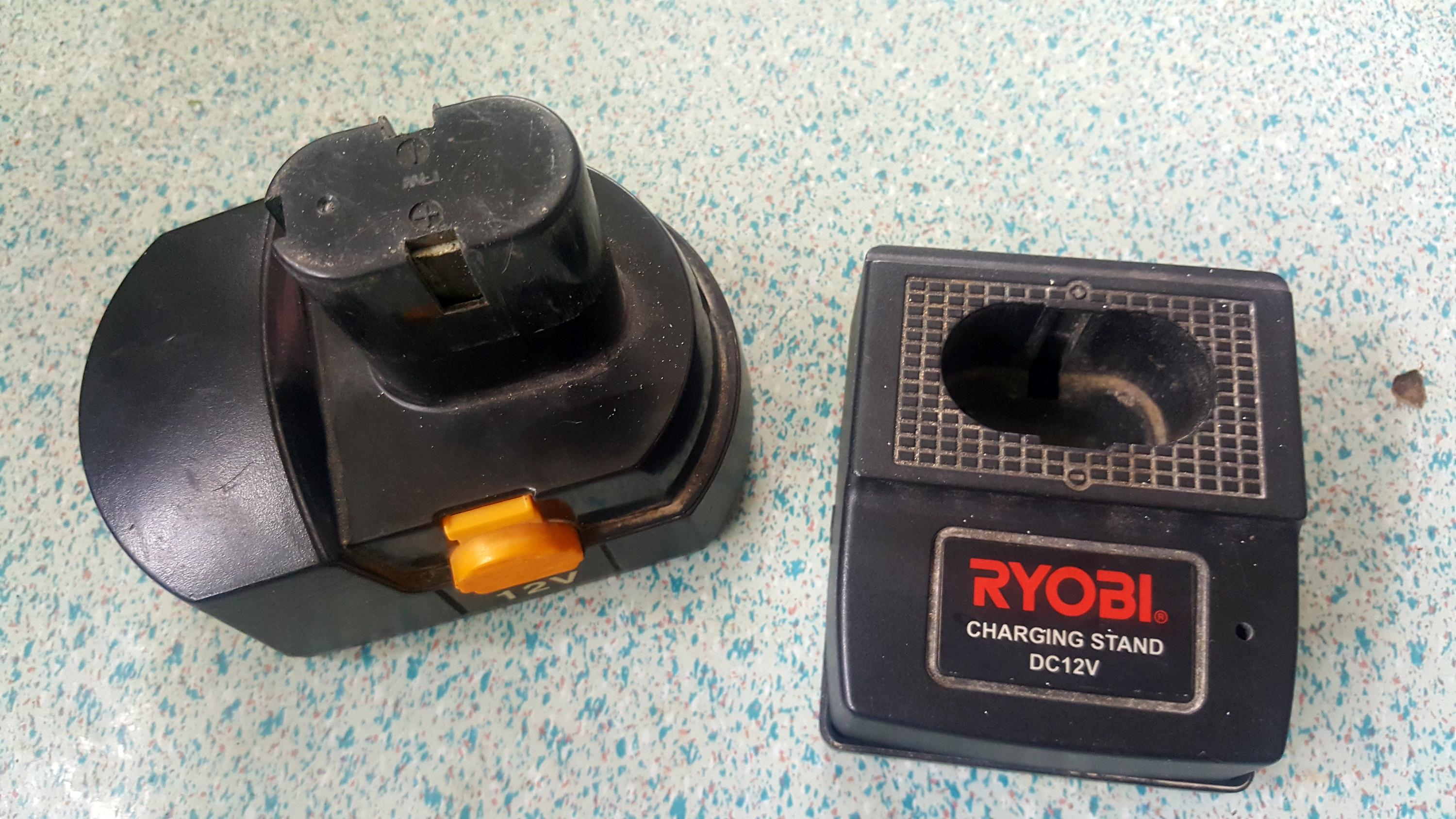

              that's terrible.
              what does the battery say on it?
              i'm thinking a proper charge circuit is needed.
              • GEARELECTRONICS
                • Apr 2019
                • 13
                • seychelles
                Battery says 12v
                  • 31201
                  nothing else?
                  i want to know the chemistry.
                  lithium, NiMH, NiCd etc.
                  different chemistry needs different charging circuits

                    It is a nicad battery pack I use to have there 9.6 volt battery pack way back when Sears way back when had this style as well
                    I would hope that no manufacturer in there right mind would use this method for charging lithium batteries of any kind you are just asking for problems that would be a big mistake if you do not at least have a protection board at a minimum
                      well i'd open the pack and count the cells - dont trust the label.
                      then go on ali and find an intelligent charging module.
                      it's worth opening the pack anyway to check they arent "flowered" all over the casing!
                      if it only has 8cells then you can get a nice charger module that runs from 5v
                      however, if the diode and fat resistor are o.k. then the battery or drill may be the problem.
                      or even the psu
