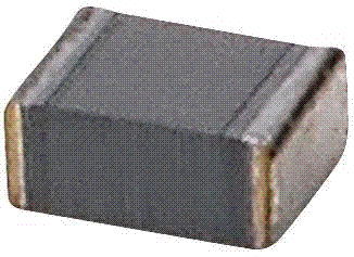

    Hello Everyone,
    I have a big problem with my ECS 661FX-M motherboard. It was working fine before my younger brother decided to get the handle of a screw driver and hit it against the board a few times. I picked the board off him only to find that he broke the solder joints off an SMT cap right under the SiS 661FX northbridge.
    The SMT cap fell off the board as a result. It looks fine to me but theres only one problem. I don't know which way the cap goes, there no markings, nothing. I think they are Bi- Directional, but I want to make sure before I blow my CPU or RAM chip. I will have to resolder it back onto the board soemhow.... maybe I have to use a needle point tip this time and also .3 mm solder wire.

    SMT caps are usually mylar or tantalum caps, and are non-polar. To double check, look at the silkscreen under the cap and see if there's any markings. If not, its not polarized.

      If there are absolute no markings, it is probably an MLCC, wich are non polarized.
      Tantalums are polarized, but usually they`r marked accordingly.

        I just had another search on the internet for this surface mount component and it is actually called a multilayer SMD ceramic chip capacitor. I have attached an image of a similar one which I found on the internet.

          Yup, MLCC.

            I have good news after soldering the SMT cap back onto the board.
            IT WORKS!!!!
            After I soldered it two weeks ago, I haven't had time to boot it up etc. until 10 minutes ago when I took a stick of 512MB DDR RAM out of my media center PC and a Celeron 2GHz CPU out of another PC.
            I was expecting an explosion or something similar to happen when I booted it up, but I was really happy to see the POST messages on the screen.
