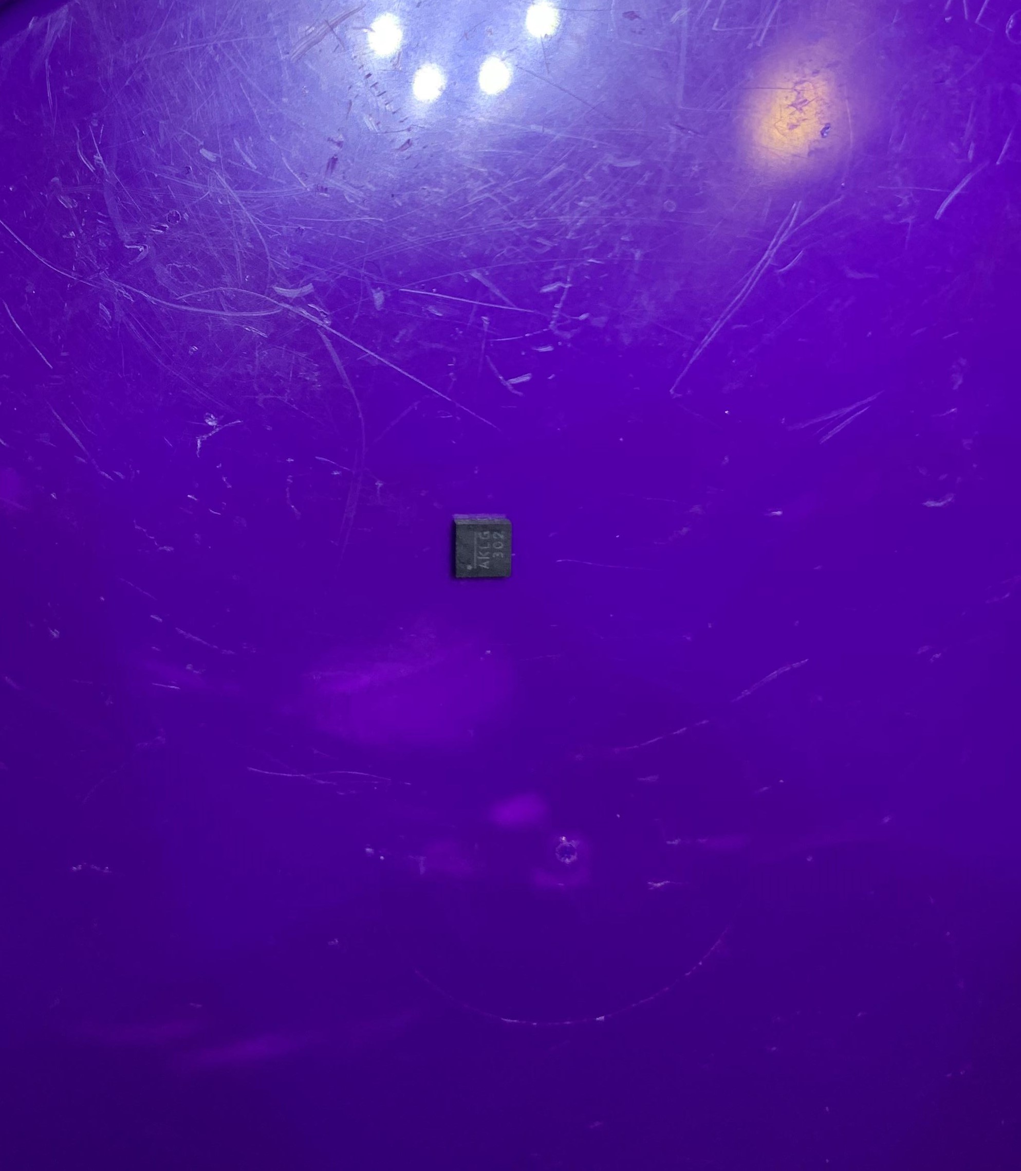

Hi i need somebody to help me identify this chip the markings is AKLG 302. It's on Hp Pavilion 14-am 245 G5 6050A2823301-MB-A02 motherboard
Help me identify this chip the markings is AKLG 302
Re: Help me identify this chip the markings is AKLG 302
https://www.badcaps.net/forum/showpo...85&postcount=3 AKL is the marking code,G is the date code.
See the attached pdf in that thread titled: Marking List April 2022.pdf ,search the pdf for AKL
