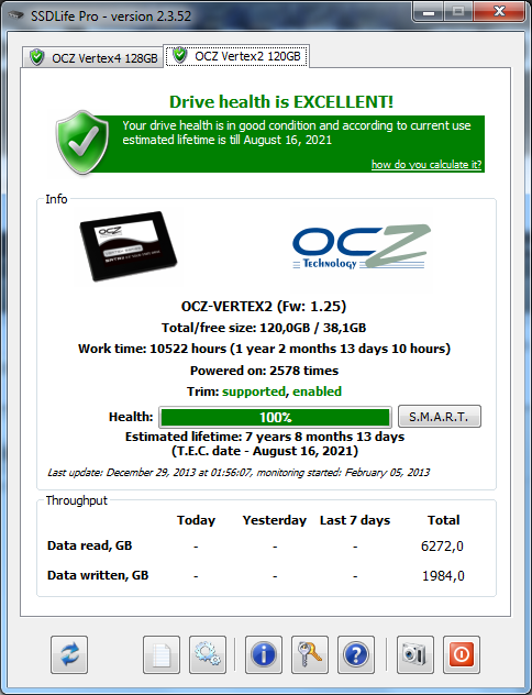

                  Guess I've been lucky thus far with this three year old OCZ Vertex 2.

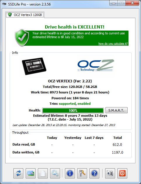

                        The Vertex 3 in my home PC is still running fine as well. I have way less data read from mine, though

                              Originally posted by dood
                              ... I have way less data read from mine, though
                              Yours has been kept running more continuously and has seen ~14 times less power ons.
