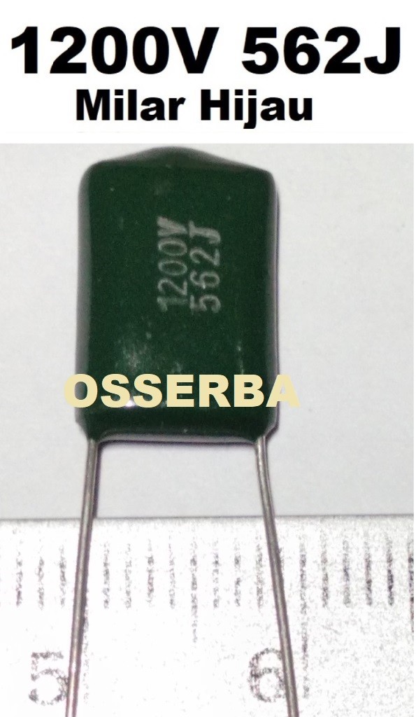

      Re: define a value of capacitor that writes 5n6j 1200volt ahas green color
      It is likely a 5.6 nf, = 0.0056µf 1200v Mylar capacitor, does it look similar to this
        exactly sir
        is this capacitor special;
        or can i use any capacitor in this value ;
          probably preheater cap, should use cap of similar characteristics imho, though not completely critical. These caps should be cheap.
