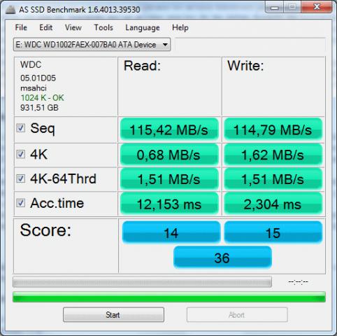

                Why defragging HDDs is a good idea
                Why defragging SSDs is a very bad idea

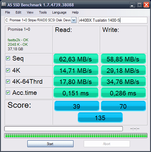

                                    One of the dinosaurs in my small museum of relics is a Pentium III 1400-S slocketed on an ancient 440BX mobo with just 768MB of RAM . Pale Moon's 3.6.32 profile is located at an on-the-fly variable-size ramdisk of up to 256MB. You can still browse today's bloated internet with reasonable decency on this relic.
                                    Not to be a prick, but why invest in an SSD for a machine old enough not to have that much RAM? Such a system probably doesn't have SATA III either, so the interface will be a bottleneck. Yeah, it will be faster... but you won't be getting your money's worth, at least in my opinion ...
                                    You're completely right, not worth the trouble for the vast majority of people.
                                    That said, if you happen to belong to the crazy beyond hope tinkering minority , you can plug the SSD on a PCI SATA controller and enjoy the 'warping speeds' .

                                          And yet there is method in our madness!
                                          Notice how even the Paleozoic PIII/SSD concoction just creams a fast modern spinner @ 4K :
