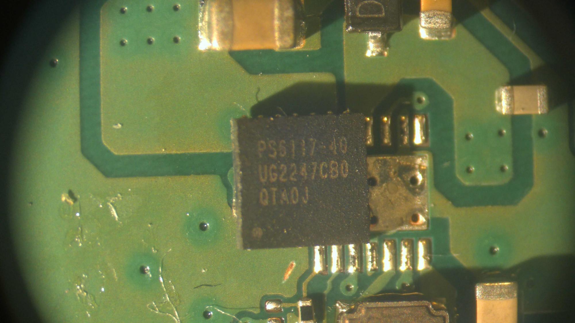

    Hi, everyone.
    I'm trying to fix this portable external SSD.
    It suddenly stopped working, according to the customer.
    After diagnosing it, I found this IC in the picture shorted on pin 5.
    It's a High Voltage Boost Converter (PS6117-40).
    I can't find any datasheet for this specific IC.
    I found a similar one, TPS61175-Q1, but the pins don't match.
    Can you guys help me find where I can buy it?
