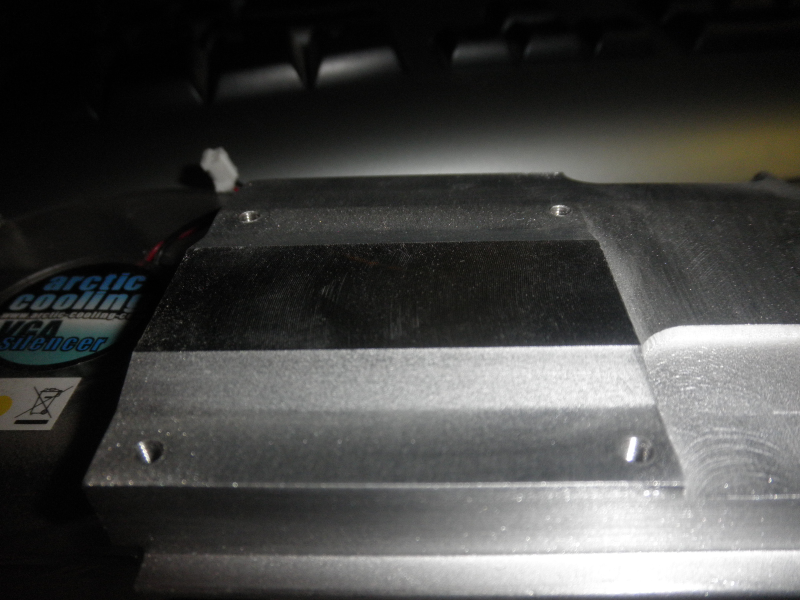

    ...this time on a HIS AGP card... It's the ATI Radeon HD4670 version.
    Issue:
    For a cooler designed and made by arctic cooling, I was surprised... that was very, very rough machining! The worst I've seen in a while, dare I say ever...
    I had the heatsink off to swap the stock compound for some AS5 (since I bought 12G of it recently)... not to mention it was a PITA getting the cooler back on, even for a GPU. they used plastic sleeve spacers on the screws... getting those on, and keeping them on, and still getting the GPU mounted in the process was w/o a factory jig was a challenge.
    Must be an aftermarket GPU thing... I had a similar issue with an EVGA Geforce 7600GT card... but with OEM cards, they usually get the machining nice and smooth.

    I remember getting a pair of socket 370 coolers from masscool I believe that the machining on the contact surface was so rough they were completely unusable. You can smooth them out a bit if you get some real fine sand paper or emery cloth and get a nice smooth finish. Remember though that is removing material so if it uses stand offs it may not tighten down onto the die as well as before.

      Yeah, it might be useful to have a small copper shim in there than to take the risk of not getting enough thermal contact!
      Also, make sure you clean it well after sanding/polishing, don't want any fine metal dust getting near the electrical stuff :boom:

        Yeah, I sanded it with some 60 grit emery paper ... that got it sufficiently smooth. I cleaned it up with some alcohol swabs when I was done.
        edit- Fanner tech (includes speeze and masscool) is crap. Rough machining, junky fans, thin wire. Junk, junk, junk.
