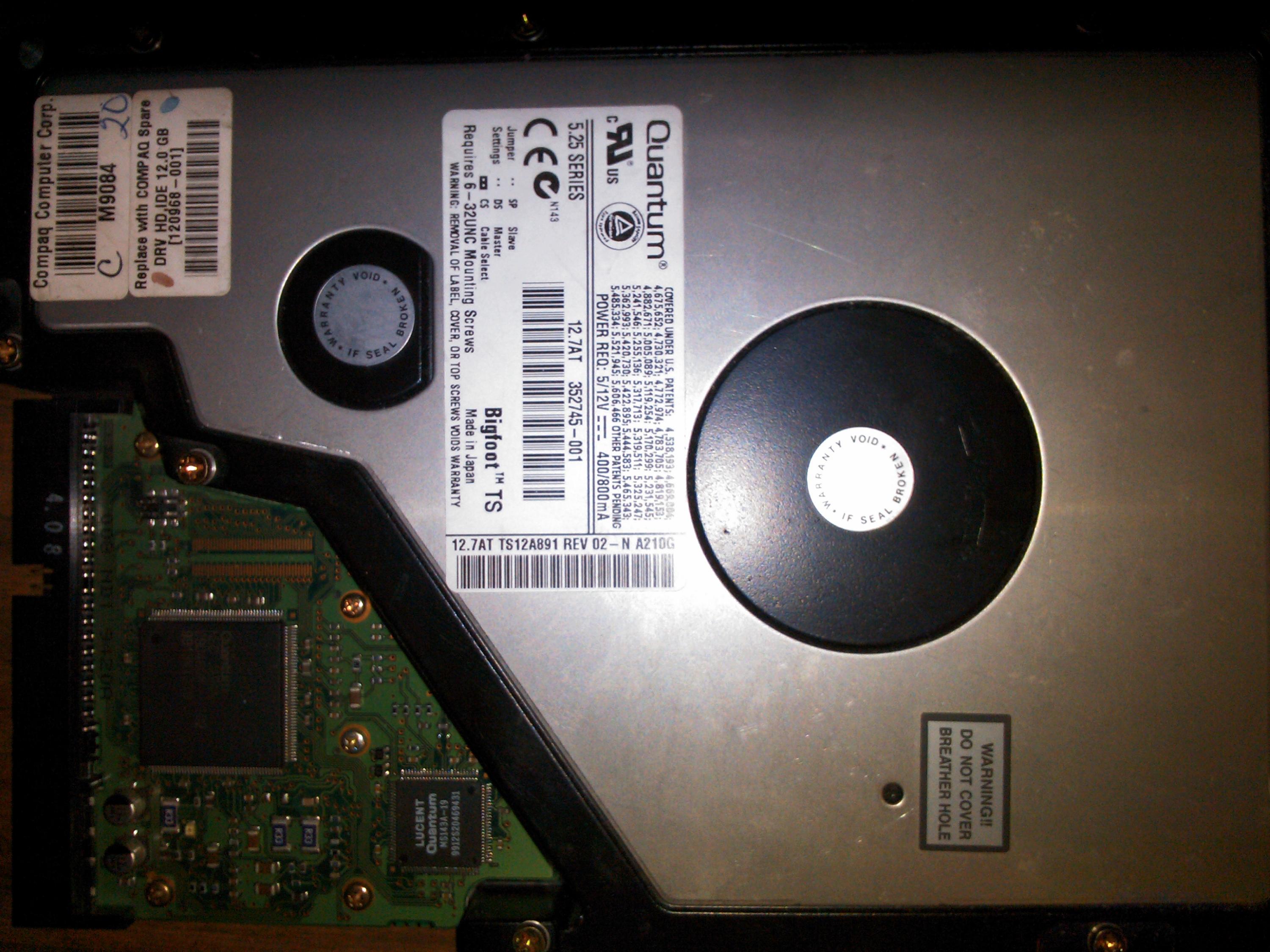

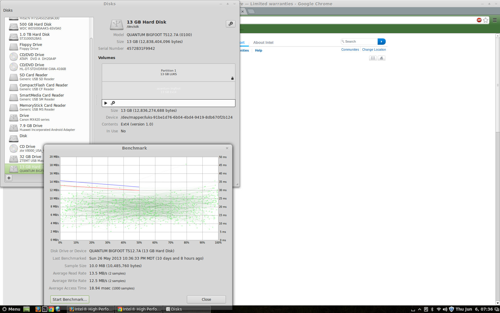

                Re: SSD's are awesome
                Originally posted by smason
                Yeah, I'm not worried about longevity, modern drives are fine, even older ones weren't as bad as some would have you believe.
                the technology still needs to evolve more, just till ssd's can write as many times as an hdd.
                for example i have a quantum bigfoot TS 12.7AT 5.25 series that still works and runs bodhi linux very well. see pics
                so when ssd are that reliable then there great drives!
