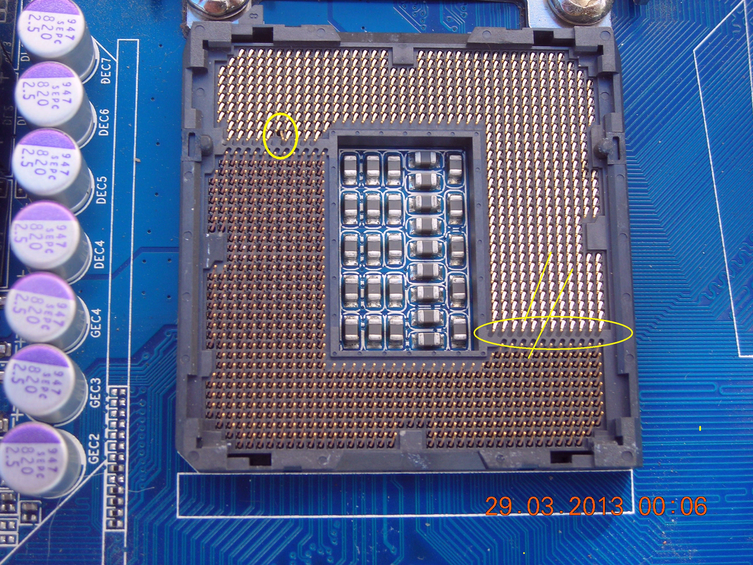

    Hi...I have attached photos of a Gigabyte GA H55M-S2H M/B 1156 socket..If there is somebody with socket expertise I would be grateful if they could study the photos and give an opinion....
    Without going into meaningless history ...to my eye the upper segment pins "especially" ones down the right had side have twisted slightly in alignment when compered to the lower segment....
    Now I can actually see two pins that could be touching and I have yet to address this...
    My main concern is this....are the upper pins twisted (although only marginally) out of alignment to a degree that the contact points would have trouble contacting "their" contact pad on the i7 CPU.....I do have a photo of a perfect socket that I could post ?? https://www.badcaps.net/forum/images...s/icon_mad.gif
    Thanks hk

    I don't see a problem here, but then again I'm not looking at the pins closely unless there is a problem.
    Perhaps you can post comparison photo since I don't have any 1156 on hand to look at.

      Same, I can't see a problem here. Is the board in question functioning?

        I see no problems either. The ones on the right look like they are maybe off by a few thousands of a inch compared to the rest, but that effect could be had if you are not looking perfectly, directly down on the socket.

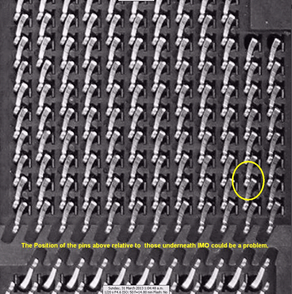

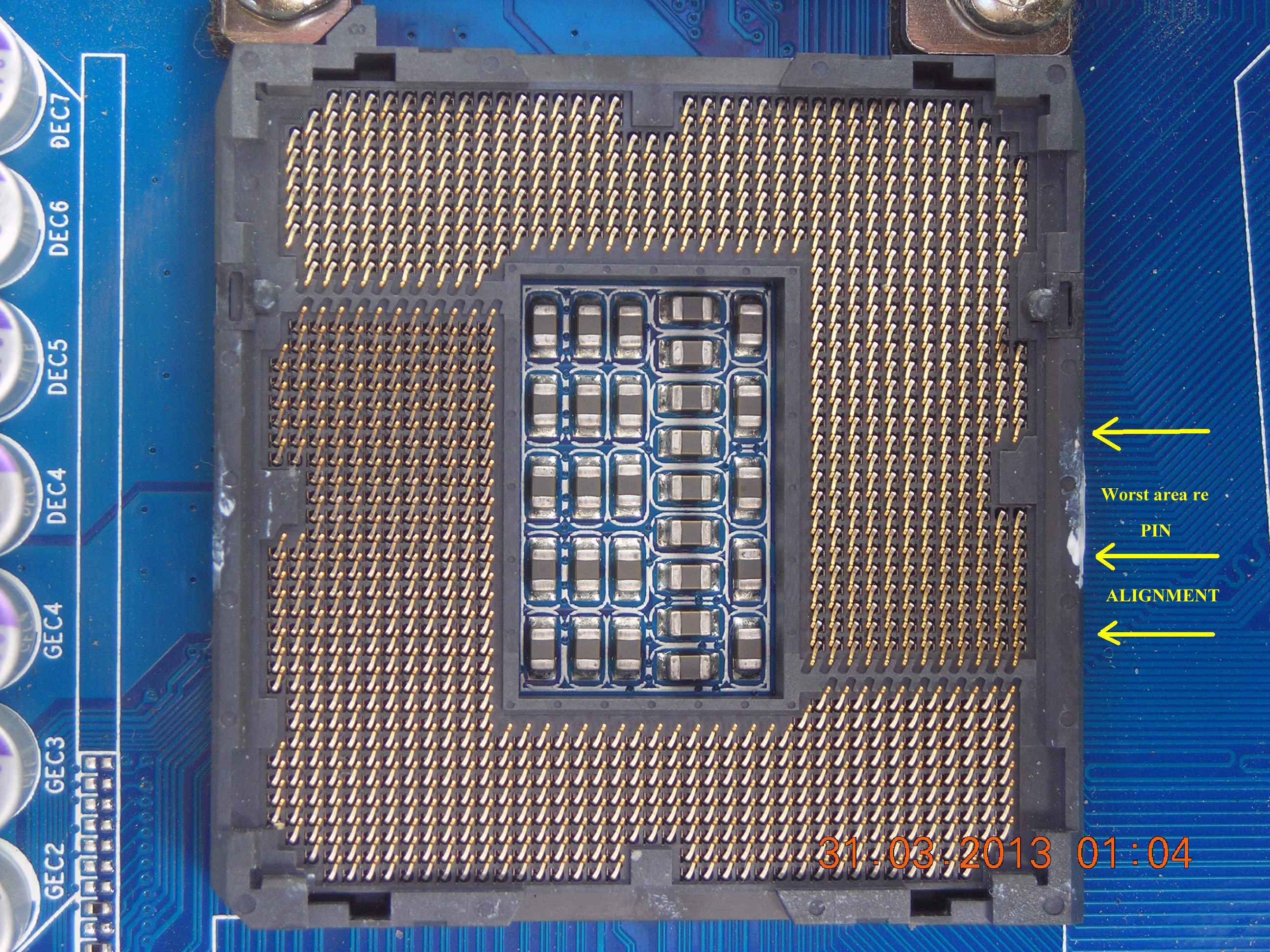

          Three replies ..this is great.....DSCN0836 is what I thought was the reason for the PC not posting IE the fan would go for up to 30 seconds,cut out and immediately power up again and keep repeating this sequence ..Then I found what I believe was a socket short...one can see the crossed over pin ..this was fixed..but the MB when re-installed did exactly the same...

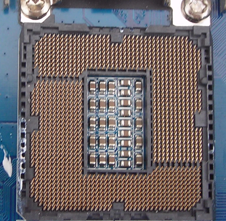

          DSCN0851 is a 1156 socket from another Gigabyte MB which works.....

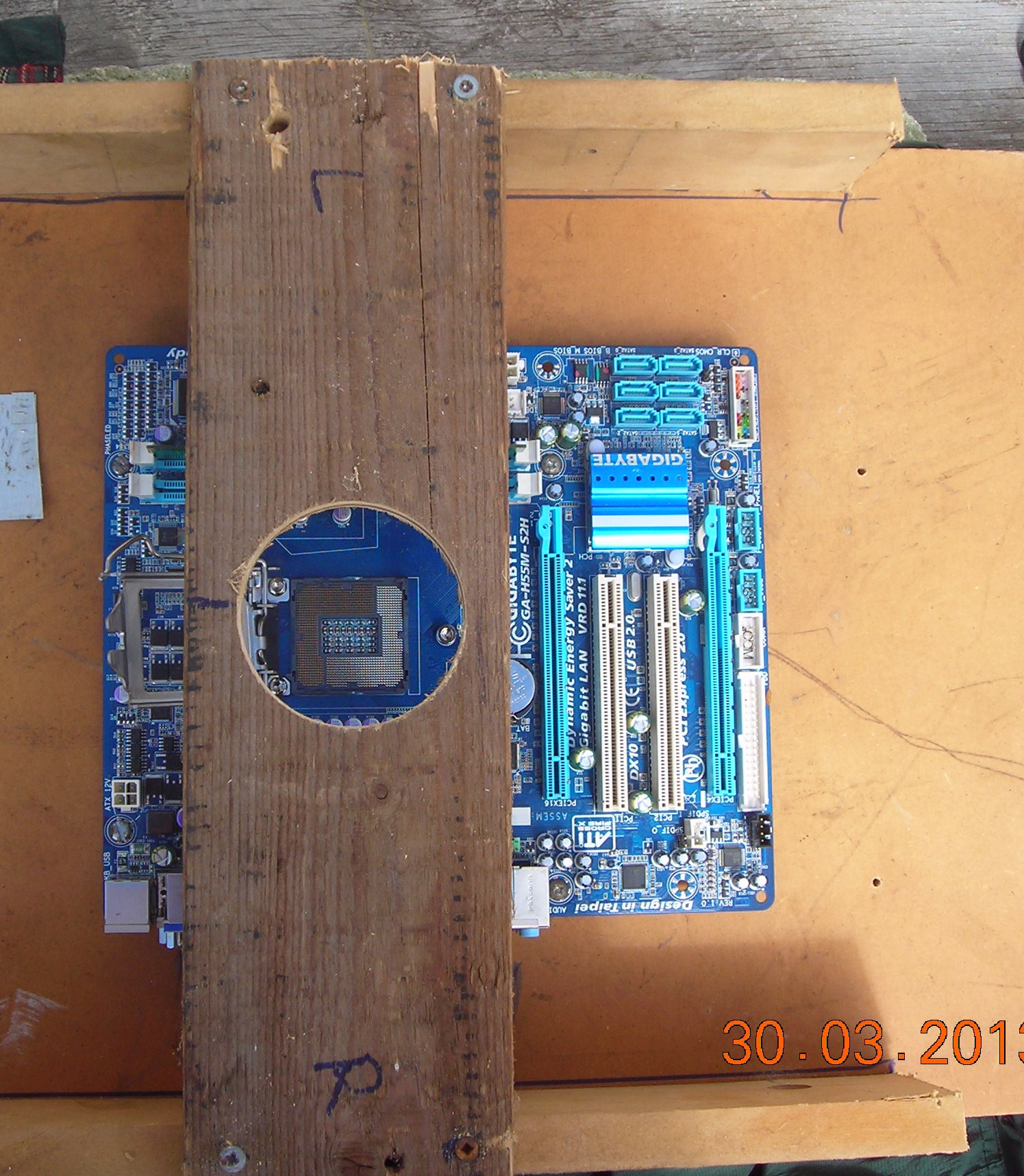

          Now just in case anybody thinks the picture was taken at an angle ..I covered this by using a poor mans peep hole to take the photo through. see DSCN0855 (.I used 2 tins of baked beans to get the camera in focus and my arms steady ???
          I am still convinced its a socket problem ...
          I did circle 2 pins in an earlier black and white enlarged photo ..I thought that its highly likely these pins touch especially with the CPU which compresses them down slightly when latched....Maybe its worth a try to move one slightly and put the board back in the unit and try again...

              My main concern at the moment is the MB ..I have blown those pins up even more in an image viewer and I still think the two pins I circled in my original post could be touching .....Now its easy to separate them? but I thought it best to get some expertise comment on the pins which are clearly out of alignment in the upper segment especially down the right side...
              It seems by the comments this is not an issue and everybody thinks the contact points will touch the CPU pads properly....
              I have read of a MB being revived after 5 trys of checking/rechecking socket pins ??
              I will move that one pin I have concern about a degree away from its next door neighbour and put everything back in the case and power it up...basicly thats all I can do....I have tryed to send the socket photograph to Gigabyte for comment but it failed to attach???
              Of course if I was an expert ..there is probably a test one can do on the board itself to find any short...and the problem could be something else on the M/B ...its just that the way the fan starts up and fails apparantly is typical of a socket pin short... thanks hk

                Hi..Moved pin and Just did a simple bench test ...MB/cpu with PSU and started with touching the F socket Power pins with a screwdriver.... I actually thought it was gong to keep going..but after 35-40 seconds it rebooted ....The length between reboots is a worry ..I thought a short was a lot quicker between boots ....any comment is welcome ?? It may not be the socket..Hk

                    the VERY bent pin is 10:AR - Memory lane shorting to 10:AP ECC Memory lane (unsued for your CPU) - I'm not sure this would damage the CPU, or ram
                    however the ones that are circled that don't look bent are in the power section of the grid, they're actually VCC and ground. I'm not sure this is enough to kill your CPU VRM, but perhaps the chip's power regulation of the die itself. The i7 may really be dead, you should check that out
                    here is a clarksdale (xeon) lga 1156 pinout. It is essentially the same but there are some unused contacts like ECC and the like for all non-xeon sandy bridges

                      Thanks for your reply...Of course at this stage its the MB I am trying to get going and I am using a perfectly good and tested i3 CPU.....and the MB will not go with it... Now I have taken photographs and enlarged them etc and MY concern is still what I see as the pin alignment on the right side of the socket ...the pins have been twisted anti clockwise ..Yes only by a small degree but when I look at a photo of the contact pads on a CPU ...there is no room for misalignment ....Hk

                        this is why I hate LGA. One of the many reasons anyways. That metal used in those pins is VERY stiff. I don't think I had one single fixed LGA socket in my life
