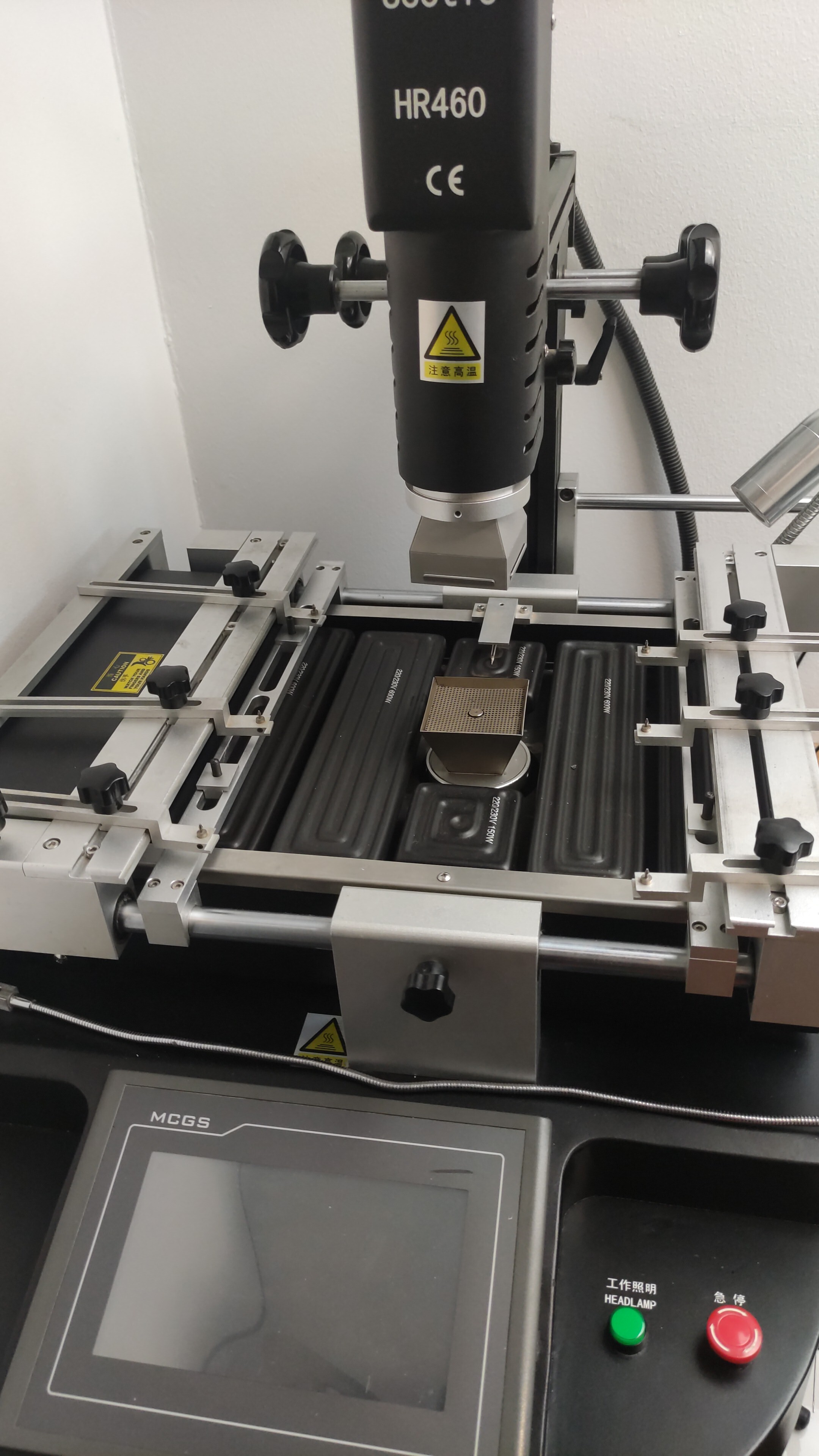

    I have recently purchased a Scotle HR460 BGA reball machine (it's a bit old and I think the company no longer exists either), but as far as I can tell it is a competent and unmolested machine that should be good enough for my needs.
    My biggest problem is that it came with no profiles, and I must re-create all of them from scratch, something that is very scary for someone that doesn't really know what they are doing.
    The simple stuff like a small memory module isn't a big deal because there are a few example profiles in the manual – but for more than that the manual is no help as it is very basic. Also, it does not contain any of the advanced features, so I have no idea if the fan speed that is programmed in is fast or slow or if it needs to change based on the application.
    Primarily I bought this style machine to do socket replacements on AM5 and LGA1700 boards, but after what looked like a promising start with a profile that worked well for desoldering, I am afraid I might have become overconfident and ruined a Strix Z690 board as the same profile was not OK for soldering a new socket back.
    This is the complete profile that I used:

    Does anyone have a similar machine and have you developed your own profile that you know works for various applications? Obviously, a socket soldering profile would be amazing but even a 50 x 50 GPU or large SMD profile I think would be immensely helpful in diving what sort of settings I need.
    I can set 6 stages for my machine and the temperature, rate of climb and hold time can be set independently for the top heater, bottom heater and additional IR heaters.

        Jasko_Jacker - my machine has a 800W top heater, a 1200W bottom heater and 2700W IR heating elements all around. Unfortunately it does not have any optical aliment, but i am hoping i can get around that with careful placement.

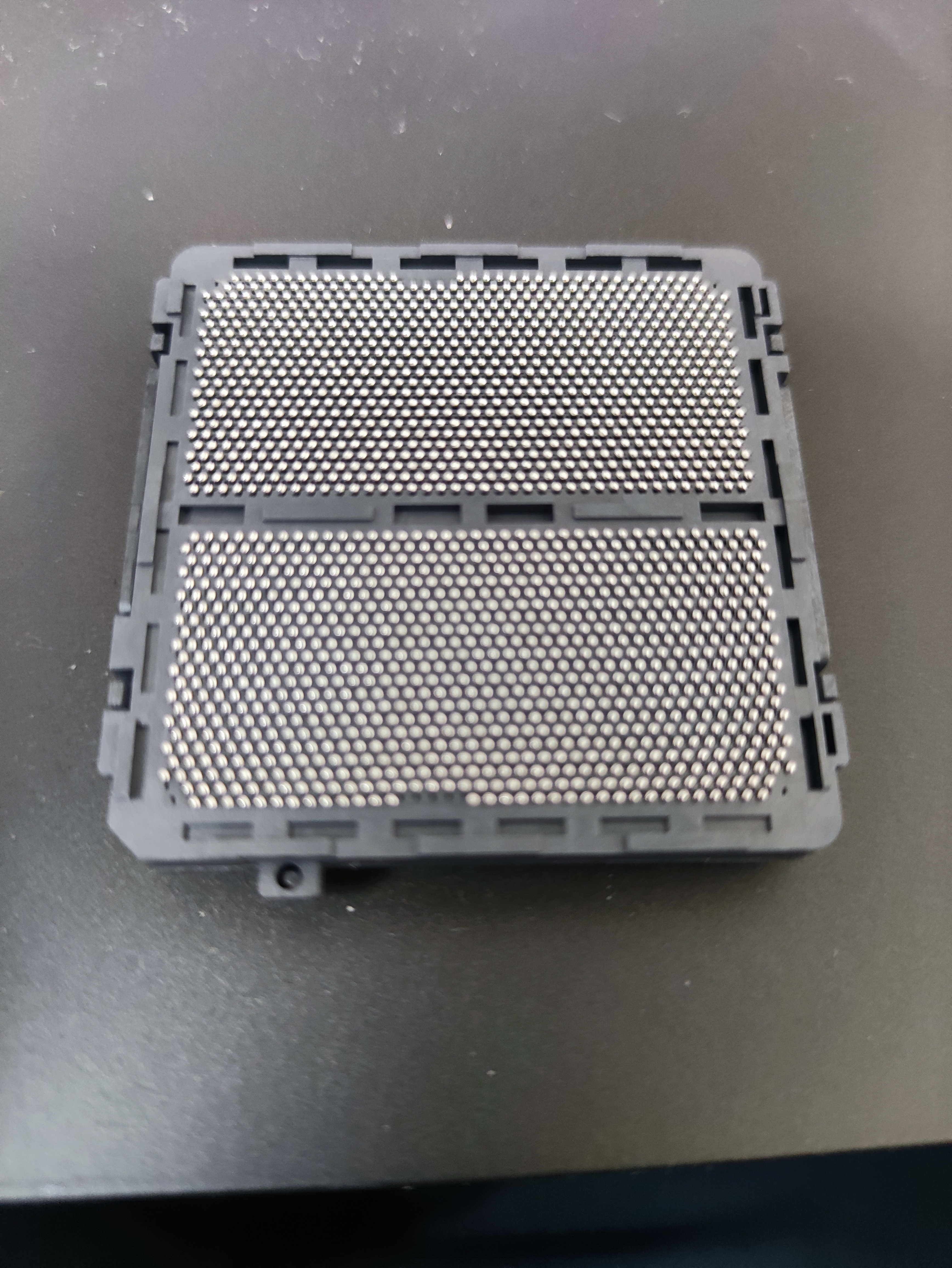

        The sockets I got look like this:
        Each pin is balled, but I did notice that the balls do look like to be barely sticking below the plastic ribs and was a bit worried they would not make contact - if i needed to bridge the gap with 0.5mm solder paste it would make a lot of sense 🤦‍♂️. I did a quick google search and found LGA 1700 stencils, but no AM5 ones.

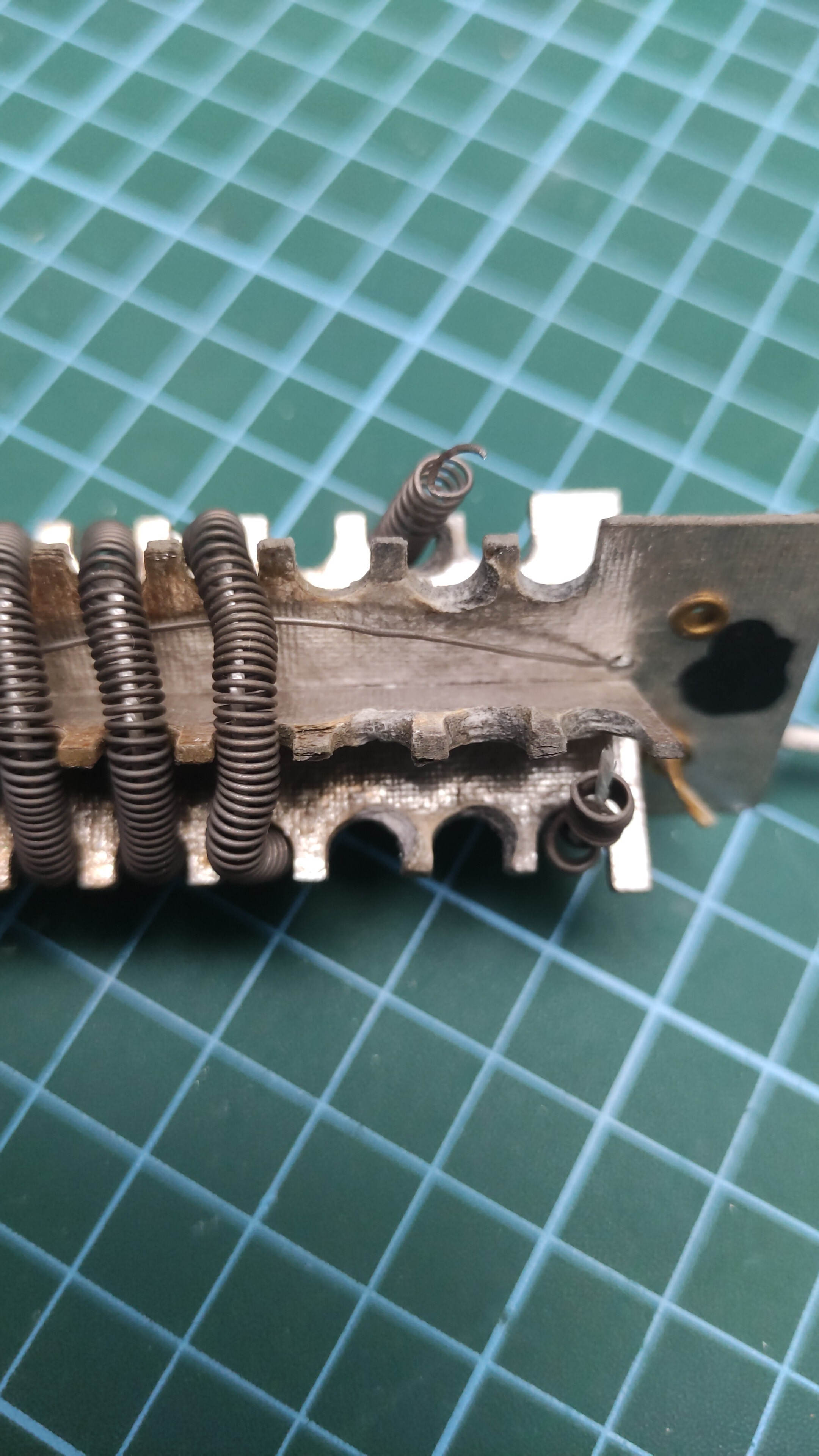

        At the moment i am on a technical break and can't experiment because while trying to tinker with a profile i set the rate of climb to 10C/s instead of 1C/s and this happened
        The bottom 1200W heater simply exploded (it was quite spectacular - large orange whoosh and sparks). I did manage to get it out of the machine after some ticnkering and ordered a (hopefully matching - at least the dimensions match so it shoudl fit + its the right wattage, but the coils look completely different which i am hoping does not matter as they have the same rating) replacement and now i am waiting for it to arrive from Aliexpress.

          No, don't use solder paste. You don't have the space.
          Watch this https://www.youtube.com/watch?v=Tal1Isw-HUQ
