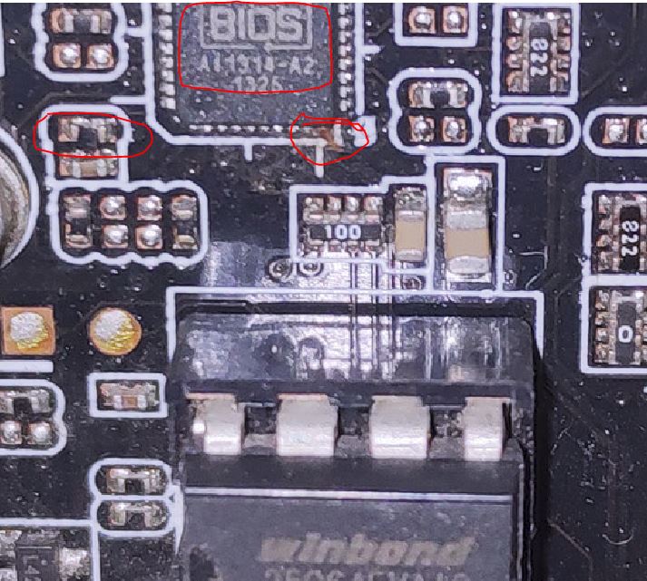

    So I decided to go deeper and try to find the problem to try to solve.
    I take apart the bios chip (is not soldered, but it is inserted in a socket thanks God) and with the multimeter try to discover something. But the chip seems healty.
    Then I reseat the bios chip on the socket and changed the battery with a new one. No improvements.
    Then I put a wire from the positive of the battery to the BIOS 8th pin VCC to try to supply it without passing through the motherboard, assuming it has some broken track.
    When I tested the VCC pin with a multimeter I can see that the voltage slowly decrease. Like the battery can mantain the correct power supply voltage.
    Then I take out the bios from the motherboard socket and in that situation the VCC pin is exactly at the same voltage of the battery (around 2,95v.).
    So, when I put the bios chip inside the socket, it's like that something goes wrong and that situation make the voltage fall down.
    Now I put photos of the chip and the motherboard, I really hope someone can help me to solve.
    I am worried that it's nothing to solve anyway, I think the motherboard socket of the bios is shorted, or some component is broke.
    I really hope someone of you here can give me an idea.

                          Theres another chip above the winbond bios , BIOS AI1314-A2 .Thats for bios flashback , you can flash a bios from USB without a CPU installed.

                              Re: ASUS Sabertooth 990FX REV.2 bios chip problems, probably socket shorted?
                              Do you think problems are that red circle you made?
                              Miss a resistance and a pin shorted?
                                I forgot to ask last night when i posted.Is the resistor damaged ? What is that brown thing thats circled
                                  I don't think so.
                                  I just made other photos after cleaning with a cotton.
                                  Take a look.
