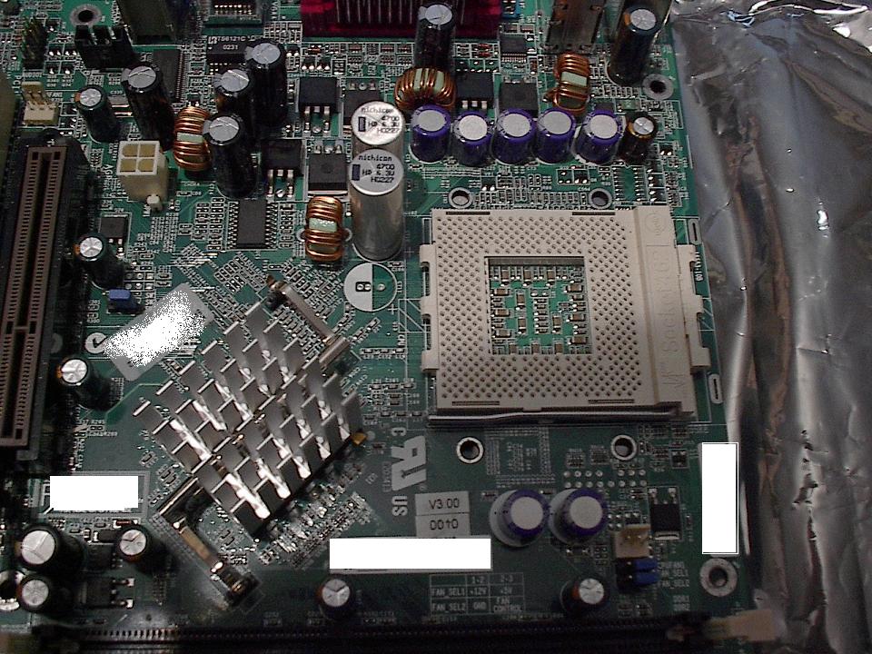

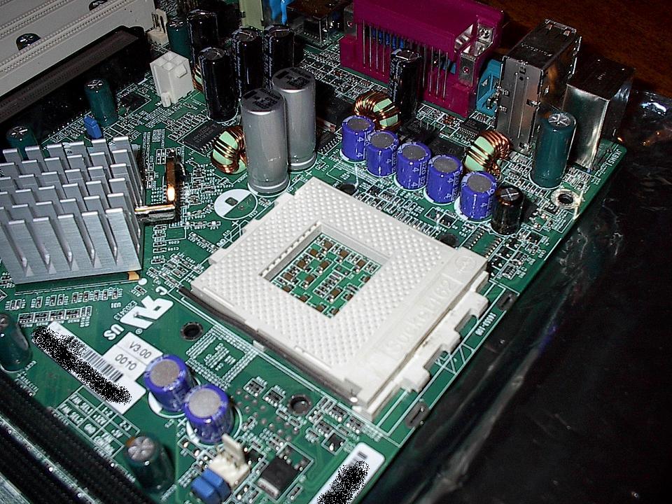

This board is an OEM model, for a major brand PC manufacturer, for what should be a common pc.
The board has a 3 phase VRM, with some excellent quality caps, that looks more like a server board VRM than a desktop one..
All in all.
VRM input (12V input) 5X 820uF Rubycon ZL 25V
VRM output (Vcore) 7X 820uF Sanyo Oscon SP, 4.0V
2X 4700uF Nichicon HD, 6.3V
Other caps of note:
2X 1000uF Rubycon MBZ 10V
1X 1500uF Panasonic FJ 6.3V
The balance of the caps on the board are Teapo and OST.
So, anybody care to guess what OEM this is, and what type of system it goes in??
