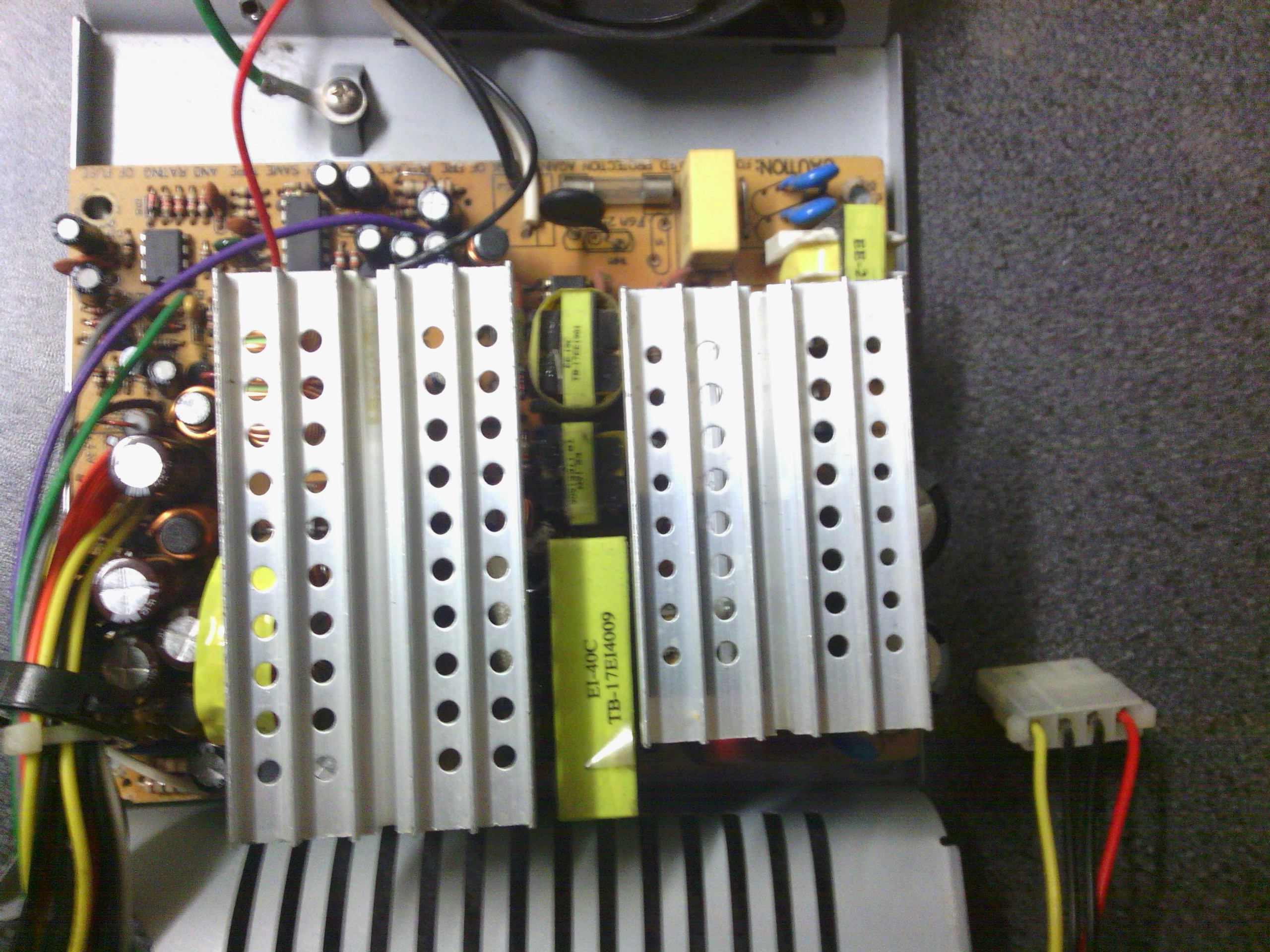

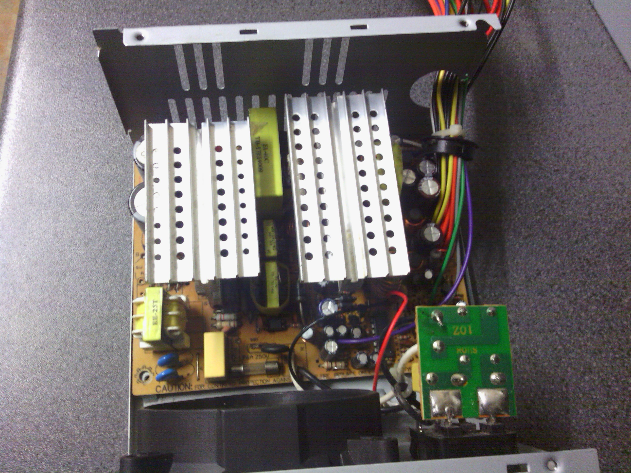

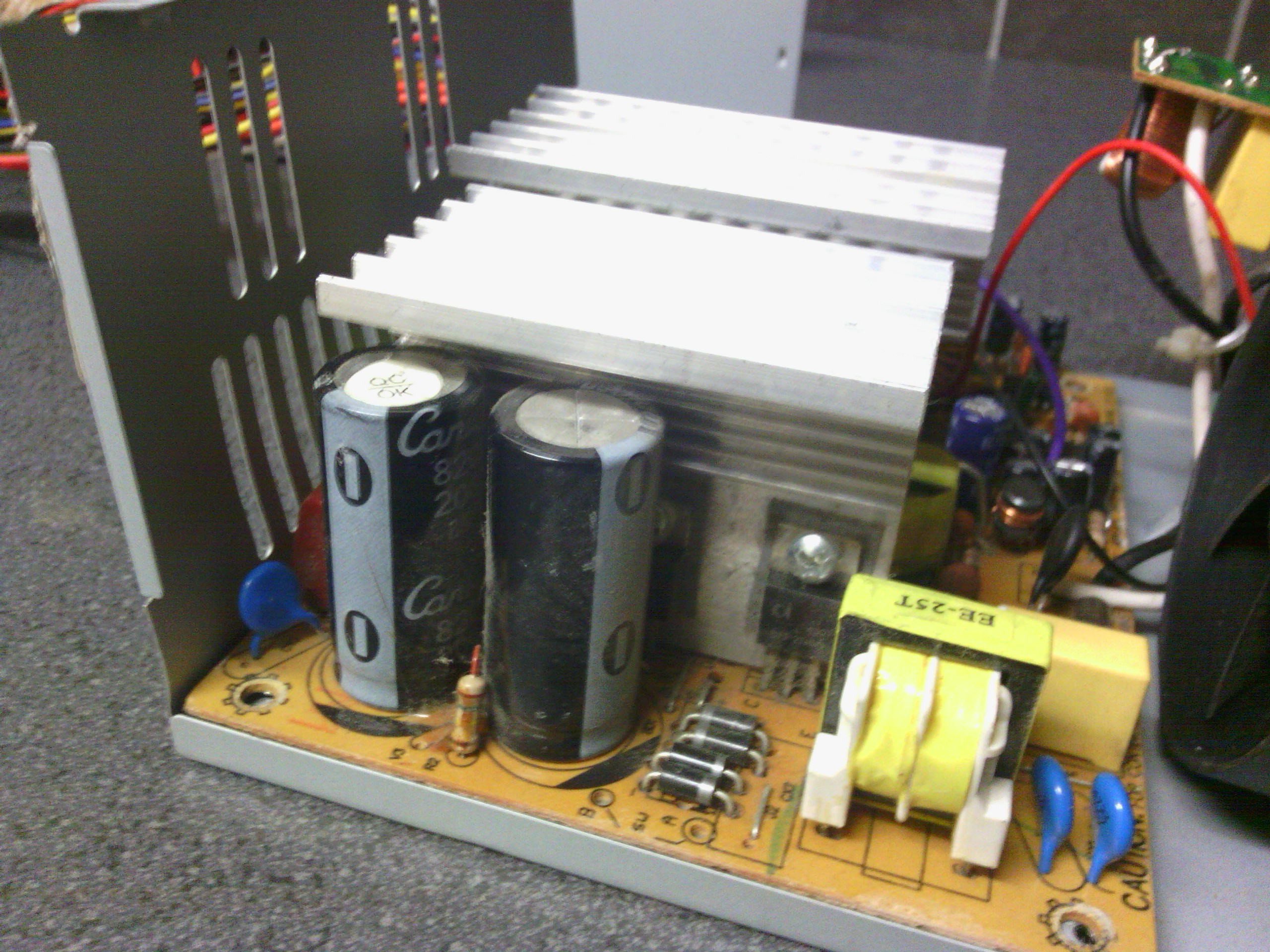

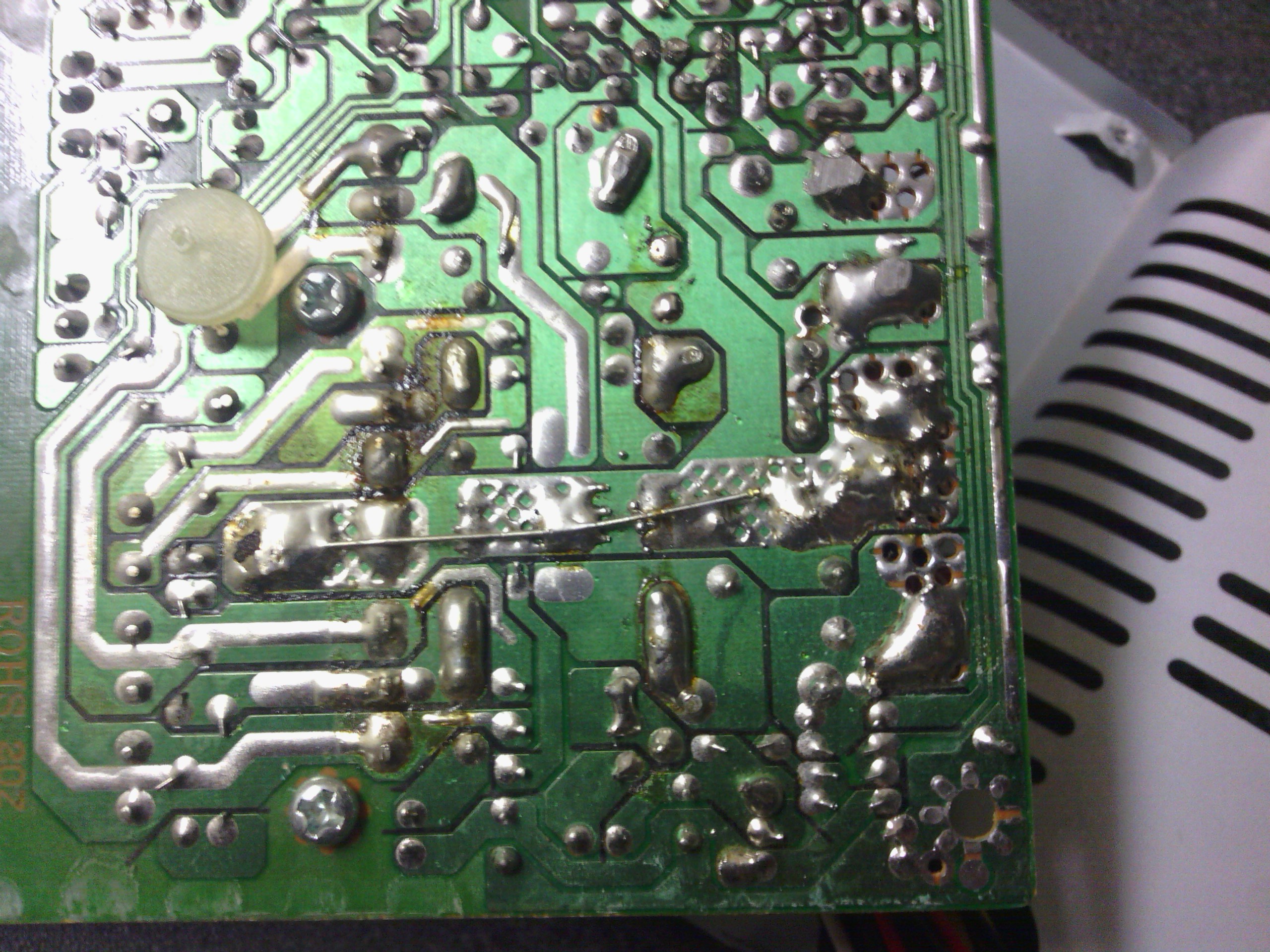

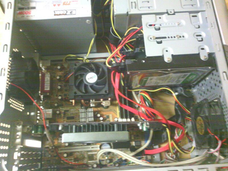

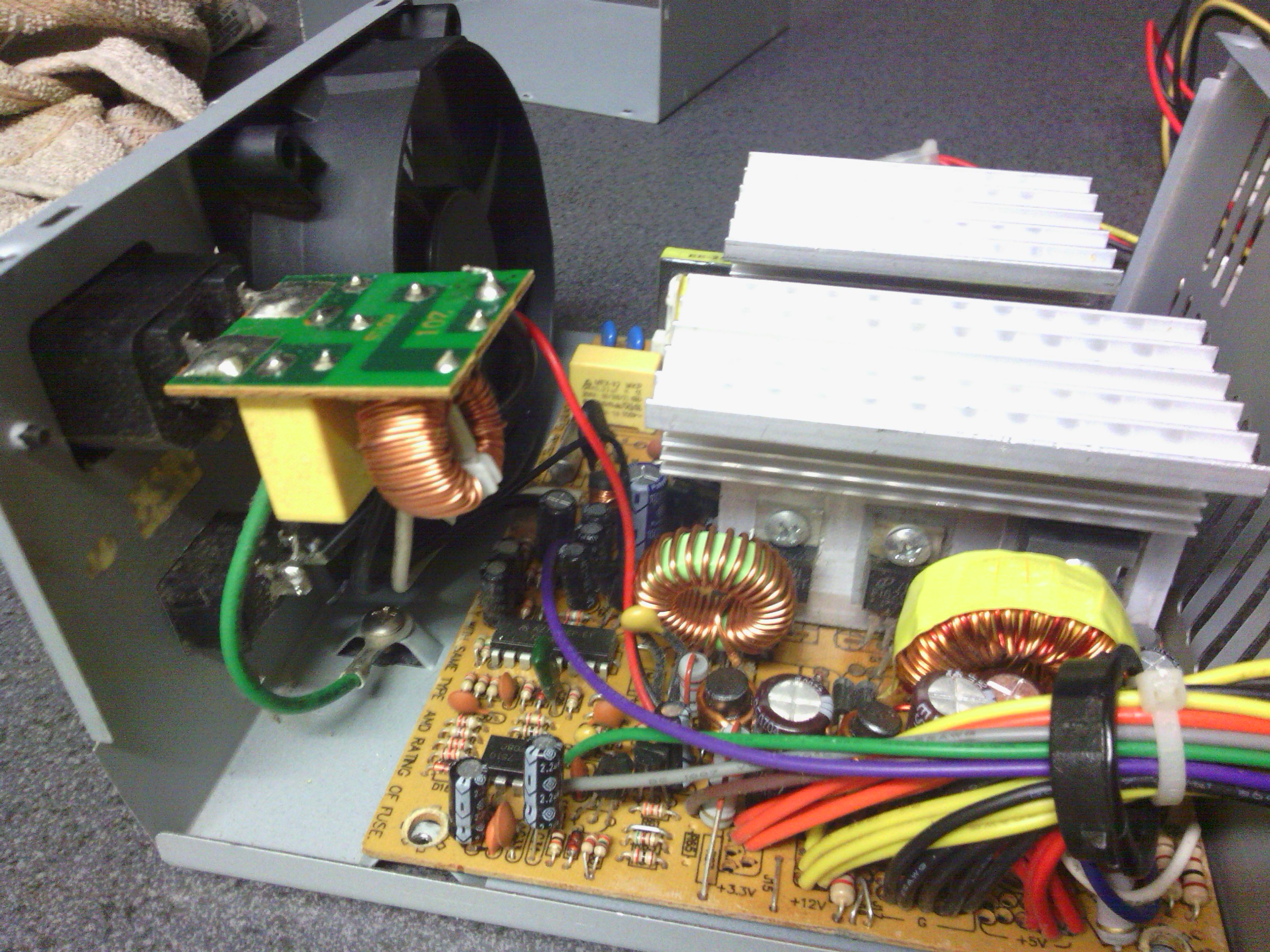

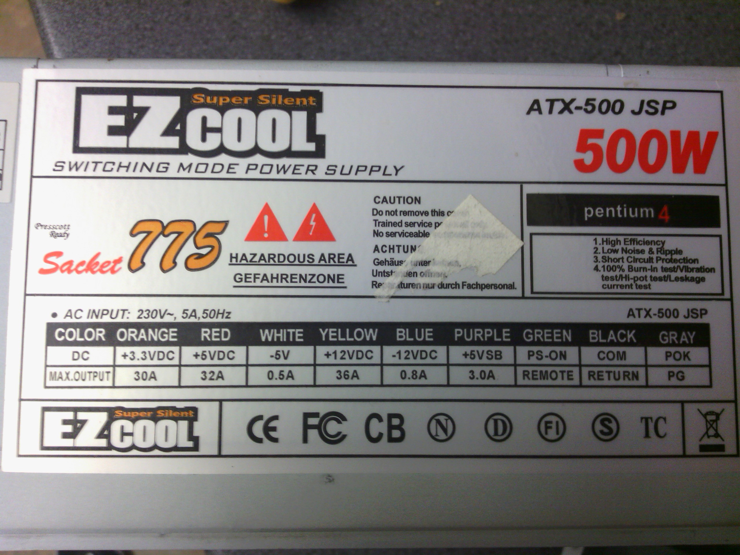

            I am so sorry, started this thread when drunk and completely forgot about it.
            Anyway, I was playing dead island yesterday and got the same smell.
            My pc went pop and turned off, the psu gave up on me. , took some pics for you to look at. Sorry they are 2/3 months late.
            The psu looks crap inside, I now have a 300w psu in my pc and its fine, no funny smells when playing dead island.
            Also included pic of inside pc, The front intake is on a switch, i only use it when playing a game.
            Please dont shoot me.
            I must add that I had also just put a little OC on it, only to 3.2ghz.

              Re: Furmark and prime, same time, burning smell.
              It's a Sun Pro. No wonder it died. I REALLY would have replaced it before it failed, as it could have killed your PC. I've killed several Sun Pros on my load tester before. They usually go kaboom at around 300W.
                Are you sure they are SunPro? Just to be sure.
                Here these PSUs with almost the same label have been made as Eurocase (Partis is the company selling it here). I have one similar and to be honest, it is really much beefier, also has 14cm fan. I have also beefed the capacitance everywhere by great margin. Using it as spare/testing PSU, over years it handled up to aproximatelly 400 W load.
                The thing is, this Partis company seems to be recycling it's PSU series every several years. So as long as this model has been tough to get in last 2 years, it is poping again on market. Want to get them on ym bench too

                    • c_hegge
                      • Sep 2009
                      • 5219
                      #30
                      Yes. Definitely Sun Pro. TB-______ markings on the 2nd line of the transformer are a giveaway.

                        Originally posted by gilly1984
                        Please use dremel or wire cutting pliers to ged rid of those disastrous fan-strangling grills , the one behind the exhaust case fan at the least.

                          #32
                          Sun Pro has worse, that's for sure. Tiny diodes though...

                            #33
                            At 240V, those diodes are good enough for a power supply that blows up at 300W.
                            I see that the it is "sacket" 775 ready.

                              #34
                                  Glad I'm the only one that noticed that

                                    #37
                                    Never noticed that one until now.
                                    I tested a PSU from CoodMax (no, I didn't mean Coolmax) recently. It's label said not to ermove the cover

                                      #38
                                      I noticed that too, but i never write in joined up writing so just thought that was normal ha ha. Well spotted.

                                        #39
                                        No dremel or tin cutter
                                        I will hack it to death, will never be seen anyway.
