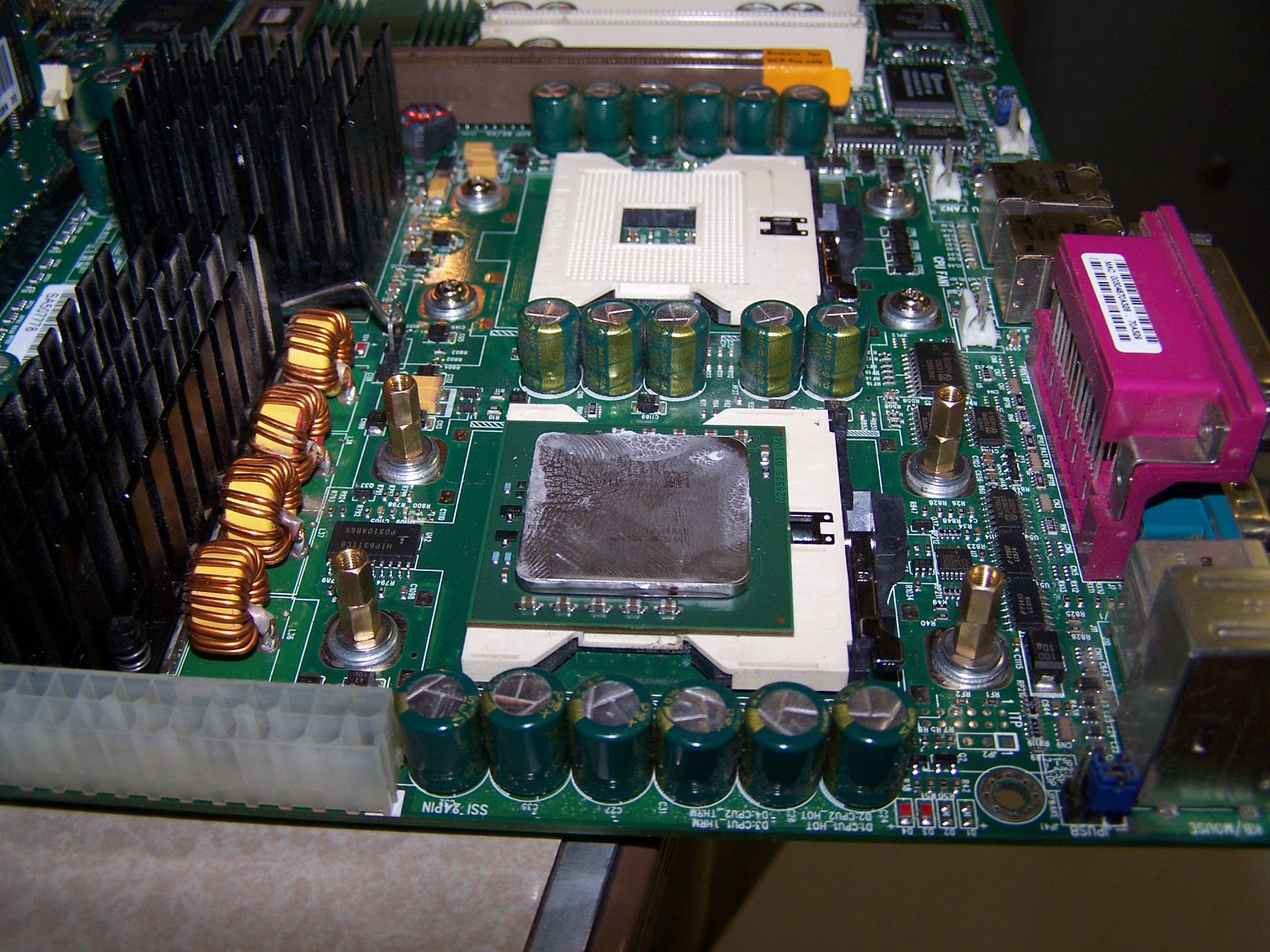

              Originally posted by momaka
              Are there supporting backplates behind the CPUs on the board? Are they thick and sturdy?
              - If not, your heatsink bolt mod can seriously warp the board over time. At the place I work, we get Xbox 360s all the time, and when people usually apply a similar heatsink bolt mod, the damage is usually worse than from the original X-clamps.
              Then again, the Xbox 360s also run a bit hotter than your CPUs, so that contributes to the damage a lot more.
              The system still runs but I think you might be right... come to think of it, the board came out warped when I gutted the system for the dremel mod...
              The only fix I can think of is to install the original clips and pay $60-$80 for some standard mount coolers. Thats IMHO out of budget... maybe I could cut some spacers of the correct thickness to go between the board and the heatsink?
              sigpic
              (Insert witty quote here)
              • ratdude747
                Black Sheep
                • Nov 2008
                • 17136
                #87
                Re: Ratdude's Main rig V2

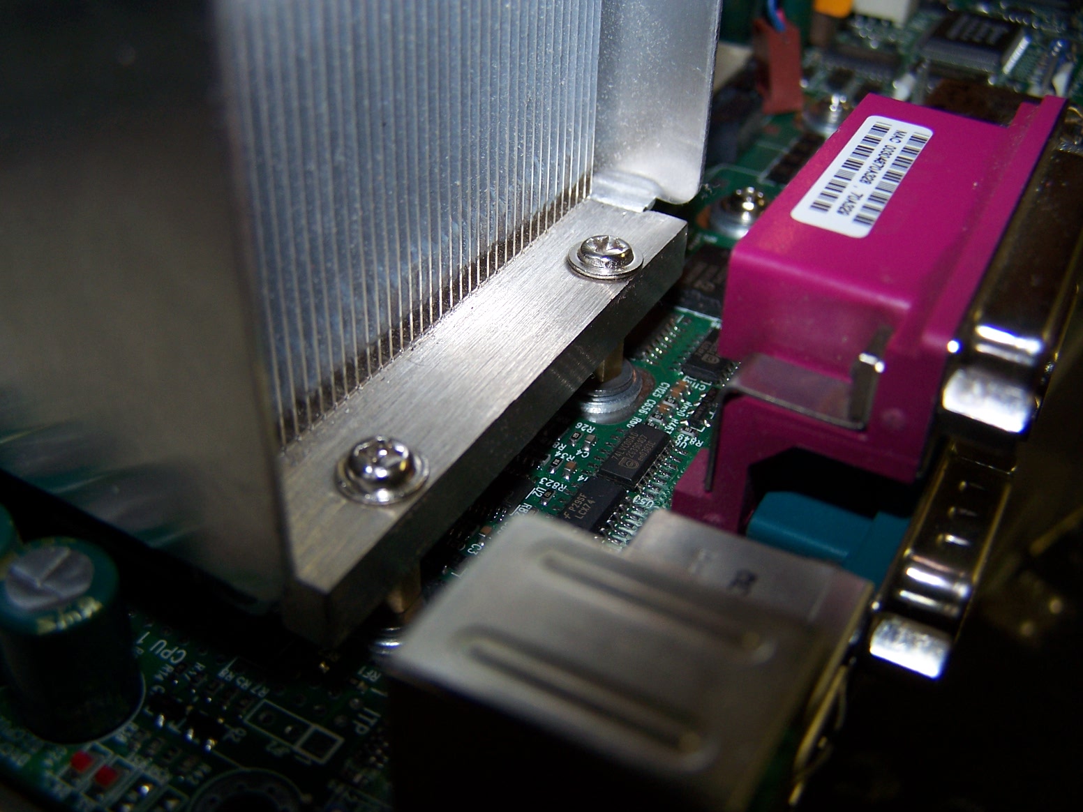

                I had a "Eureka!" moment and found a solution:
                I took 8 of the obscure M3 standoffs in a raidmax screw kit and stacked them by 2 and threaded them into the screw plate. Since the screw plate's threaded studs stick out of the board, I took the #6 washers from the old setup and placed those on the exposed studs. In order to get the height right, I also had to add a #4 washer. These standoffs fit nicely into the oversized holes in the the heatsinks:
                The tops of the standoffs are ever so slightly recessed, so the screws can actually provide the pressure needed for a good fit:
                I only had enough standoffs and #4 washers for one CPU, so I removed the other CPU and as shown in the first pic, used the top screws to hold down the screw plate and #6 washers. I did that so I can install the second set of hardware w/o removing the mobo (you remove and replace the screws one at a time).
                I personally think this is a pretty elegant solution. My only beef is that I had to stack the standoffs; if they made M3 standoffs in that height it might have looked prettier.
                Fry's has the standoffs and I'll be in indy this weekend; I'll pick up another screw kit and more washers and get CPU #2 back on line. I'll also swap the washers for non-stainless ones (I borrowed these from my dad's stainless washer stash) and maybe even use some blue thread locker on the standoffs.
                Comments?

                    Originally posted by rilski
                    Wow that is a nice fit for that CPU cooler!
                    Noob question! Why are the metal washers in use for? I see two of them in each 4 sockets.. hehehe
                    The lower ones are larger and they are there to cover the exposed studs protruding from the backplate. This is done to keep the backpate firmly clamped to the board (this reduces Board flex).
                    The upper washers are smaller and are used to raise the standoffs to the correct height. In this design, the height is extremely critical to preventing board flex.
                      Good measurement on placing those washers. Board flexing reminds me of the Xbox 360 with the 3RL/X-Clamp fixes.
                        Are the backplates metal? If so, then your board may be fine even with the original bolt mod you did. Your new "stud-mod" looks pretty legit too, though (maybe even better).
                        • ratdude747
                          Black Sheep
                          • Nov 2008
                          • 17136
                          #92
                          they were metal but not very stiff metal. . there was observable board flex when the board was removed.

                            #93
                            In that case, your new stud-mod should help a bit. The board may still flex a little, but that's inevitable. A thick back plate is the only way to go.
                            But don't worry - those BGA sockets will usually take a lot of board warp before they loose contact with the board.
                            • ratdude747
                              Black Sheep
                              • Nov 2008
                              • 17136
                              #94
                              My thoughts exactly. It's pure physics.
