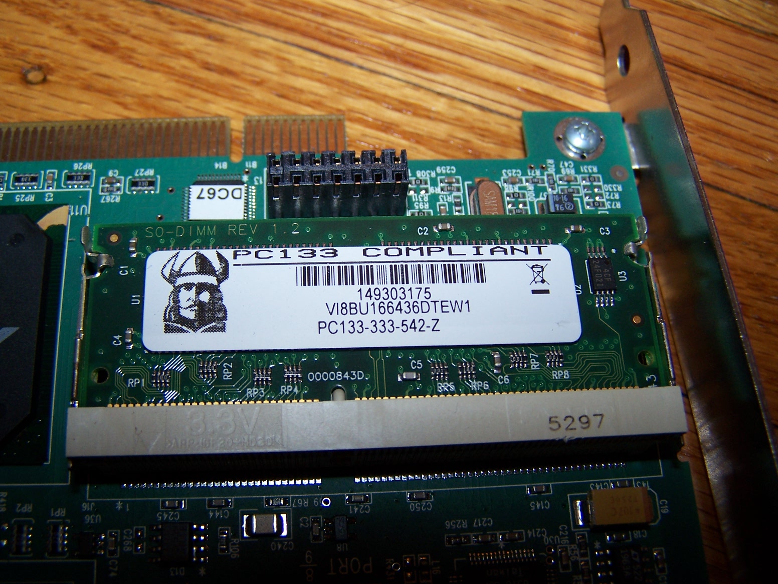

                                    The card came in... and It appears to have had the crap kicked out of it:
                                    (BBU removed)
                                    At least one of the 3 main activity LEDs is intact. I wish th upper one was intact but, it ain't
                                    Also, I'm dubious of the RAM module:
                                    Supposedly it's an 128mb like the one from the old card... just to be safe, I swapped the modules.
                                    Somehow the dumbass got the Card bracket on wrong... so when I went to install it, it didn't line up. How one could do that and not notice is beyond me.
                                    I haven't had a chance to test since my keyboard is on the rag (shouldn't have cleaned it, now it complains about a stuck key) and I had to grab lunch and head back to class.

                                      Ouch. I hate it when sellers don't treat the stuff they are selling well. I suggest you inspect all SMD components on the board carefully. Hopefully, none got chipped.
                                      • ratdude747
                                        Black Sheep
                                        • Nov 2008
                                        • 17136
                                        #199
                                        Re: Ratdude's Main rig V2
                                        I looked hard... and no other damage other than the pins (the board is 100% SMD, even the pin headers).
                                        Booted the existing HDD just fine, so I finally retired the 320gb from this system and moved it to it's new home in my supersized HTPC.
                                        I'm Currently running a battery test (not 100% accurate, I didn't get the battery fully charged).
