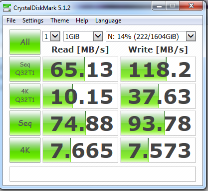

    Re: Ratdude's Main rig V2
    Been up to no good again:
    Getting there was a PITA. First, the CMOS battery took a shit and made the thing unbootable. After 30 minutes of dicking with it, I found the issue and a fresh battery with new BIOS settings fixed it.
    Then getting drivers was another pain. Ended up using vista 32 drivers; in order to get proset to install (needed to team), I had to manually update the drivers first, as the default win 7 MS ones cased to think no intel adapters were installed . After that, no problem.
    Attached is a benchmark of my NAS drive over this... although I only saw activity from one NIC, so teaming may not have done me anything.

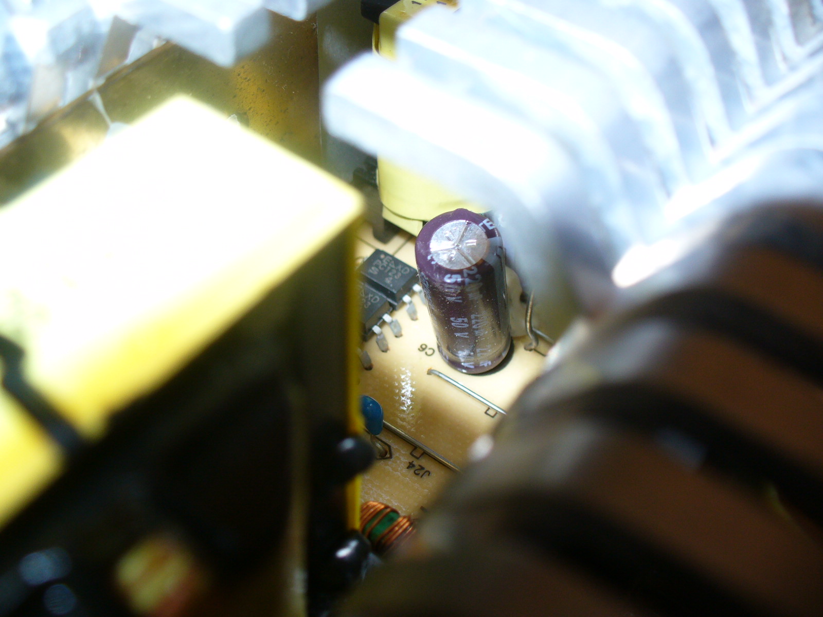

                              Spoke to Topcat, who suggested I look at the PSU. I checked, yup, I did recap it already, minus a 220uf 50V teapo between the primary and secondary heatsinks. It has come loose from the glue, so maybe that bloated on me and caused the issue?
                              Either way, I'll replace that cap at some point. Would that be the 5VSB cap? I've had 5VSB issues cause RAID controller headaches before (Main rig 3.5) so this could be the culprit?

                                #295
                                Pics of the cap in question:
                                Not sure if I knocked it loose last time I was in here, or if the bung bloated and caused this.
                                Also, I don't have any 50V 220's in stock, so no instant fixes (unless it is a 5VSB cap, in which case I do have 220's in lower voltages handy).
                                FYI, the recap I did last time was a mix of Sanyo WG and Samxon GD.

                                • Topcat
                                  The Boss Stooge
                                  • Oct 2003
                                  • 16959
                                  #296
                                  The ESR on Sanyo WG and Samxon GD might be a little too low for PSU use....but a questionable Teapo would be more suspect.

                                  • ratdude747
                                    Black Sheep
                                    • Nov 2008
                                    • 17136
                                    #297
                                    This was recapped with whatever I had in the stash years ago... maybe I need to redo it the right way?

                                    • ratdude747
                                      Black Sheep
                                      • Nov 2008
                                      • 17136
                                      #298
                                      3300uf 6.3v 10mm x4 (Sanyo WG)
                                      2200uf 16v 10mm x3 (Samxon GD)
                                      470uf 16v 8mm x1 (Nichicon HM)
                                      And the factory teapo mentioned above (220uf 50V 10mm)... which it appears I desoldered and resoldered, which would explain the cap sitting funny.
                                      Maybe the PSU isn't the issue? Either way I probably should recap it again, this time using things that are better suited for PSUs?
                                      I do still have the Ultra 600W from post #1... If I dare try that.

                                      • ratdude747
                                        Black Sheep
                                        • Nov 2008
                                        • 17136
                                        #299
                                        Finally did a proper full PSU recap using Nichicon HE's... and she's back and stable. Posting from her now.
                                        FYI, there's two 470uf 16V caps, not 1
