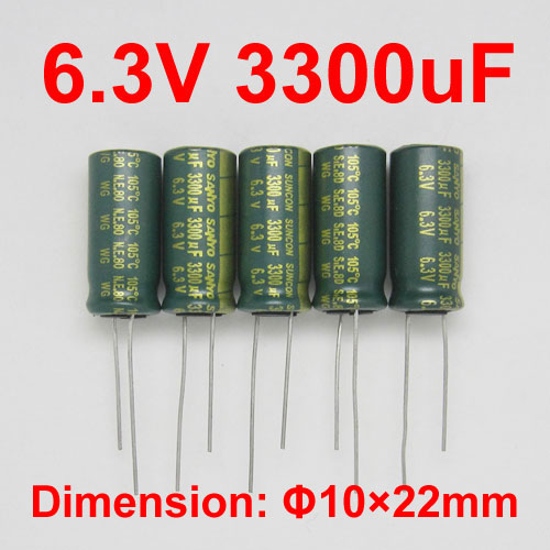

    Who makes those fake eBay-Sanyos?
    Pretty revealing picture on eBay:
    http://cgi.ebay.com/6-3V-3300uF-Radi...item3f01328f4e
    ? - Sanyo - Suncon (uups, who put that one in there? ) - ? - Sanyo

      Re: Who makes those fake eBay-Sanyos?
      wouldn't trust that seller.
      sells Nichicons with H3058 datecode (1930? 2030? week 58?!?) and some without a series marking..
      also sells the infamous "Rudoycon" caps..

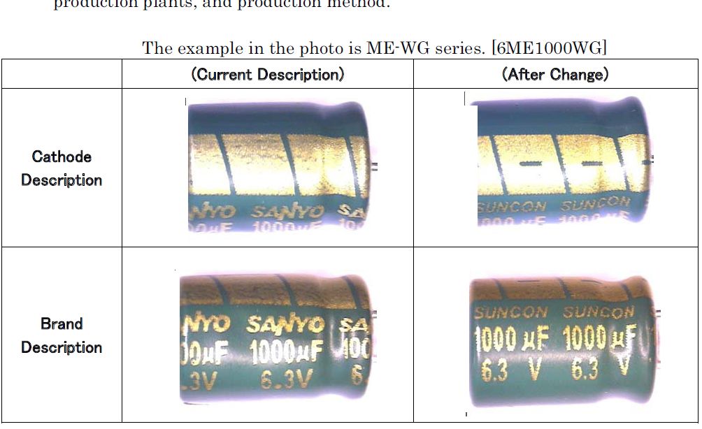

          Originally posted by brethin
          Don't think they are fake, but I could be wrong.
          Change Notice?
          It doesn't even match the description in the notice. Notice the extra dash on the cathode marking on the Suncon-description, the capital of the v (voltage). The two Sanyo-marked we see, isn't identical either. See the space between 6.3 and V.
            Suncon are not fake Sanyo caps they ARE Sanyo caps.
            Suncon is the subsidiary[branch] of Sanyo that has always been the actual manufacturer of Sanyo caps since 1958.
            In other words Sanyo lytic caps -ARE- Suncon caps.
            Always were. You just didn't know it.
            Maybe a year ago,,, Sanyo decided to get out of the lytics business and go all solid polymer. They offered the subsidiary for sale.
            The investors in the subsidiary 'bought themselves' from Sanyo and re-branded the product with their own name.
            Suncon are legit Japanese 'good caps'.
            Now as to that specific auction being legit Suncon...
            I can't say.
              You can [or could] find the same PDF notice on Sanyos site if you look.
              It's legit.
                On legit Sanyo caps space between 6.3 and V is sometimes there and sometimes not so the space doesn't indicate anything.
                What to look for it the height of the numbers compared to the height of the V.
                On legit Sanyo the height is the same.
                As Suncon is no longer part of Sanyo I guess they can mark their caps how they want.
                http://www.sunelec.co.jp/eng/history.html
                http://www.sunelec.co.jp/eng/product/product_02.html
                -see- no more lytics.
                http://www.edc.sanyo.com/english/pro...tor/index.html
                Look at bottom of last page

                • sofTest
                  • Aug 2008
                  • 361
                  I do remember reading about Sanyos exit from lytics business, reading about it here on the forum, but I didn't remember it was Suncon to continue it. Yes, Suncon can mark their caps as they like, but the marking on the one Suncon doesn't match their own change note linked to by brethin in post two.
                  I don't know if the caps are genuine or fake, but I've never seen a mixed lot like these, where (at least) three of the caps are different. But, for all I know, the seller might have got hold of a mixed lot of rejects from the factory, or a surplus from a manufacturer. I, for sure, do not intend to find out.
                          Not that I trust that vendor, but, I'm not seeing this 'not matching' you speak of.
                          I really doubt a counterfeiter is going to suffer the cost of making both Suncon and Sanyo versions.
                          A mix of old and new stock legit caps makes more sense.
                          On the other hand a couple years ago I go two sizes of Sanyo from one vendor in one order and one size was legit while the other size wasn't.
