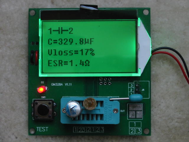

    So here it goes. First, this is how one of these bad Sacon FZ caps (in this case, rated for 16V and 470 uF) measured on my GM328 tester: no capacitance, infinite ESR… just completely open-circuit as far as the GM328 was concerned.
    But then, after adding a drop of water… ta-da!
    It’s not open-circuit any more!
    Is this magic or what?!
    Sure it still has a super-lousy ESR of 1.4 Ohms and a whopping V_loss of 17%... but it’s not open! As far as the capacity goes, it’s almost in spec… for the next lower capacitance size (330 uF) . Well, better than nothing.

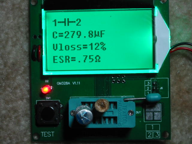

    And for more giggles, I also connected the cap backwards on my voltage supply for a few moments, just to see what would happen. Strangely enough, almost nothing changed – the cap roll still oozed bubbles / gas, if ever so slightly more. I then connected the supply back the normal way and left it there for a few moments. After this, I tested the cap once again to see if I did any damage:
    Well, looks like I didn’t change anything much with the voltage charging/discharging and reversing. The capacitance did decrease a little… as did the V_loss (leakage.) The ESR, on the other hand, was still sitting at a steady (and lousy) 1.4 Ohms.

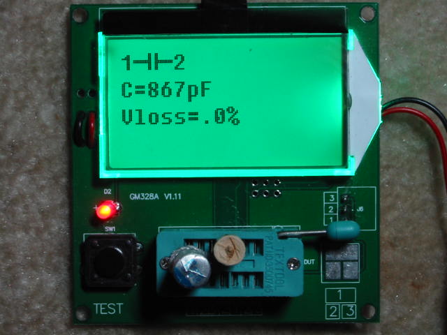

    And that was meant to be all I did with this experiment back then. But now come time to post it, I figured why not dig out that particular cap and see how it’s doing. After roughly half a year stored without a bung, this was it:
    So it didn’t go completely open-circuit this time, but lost nearly all of its capacitance again. Seems like V_loss goes with the capacitance hand-in-hand, though, as that has gone down too.

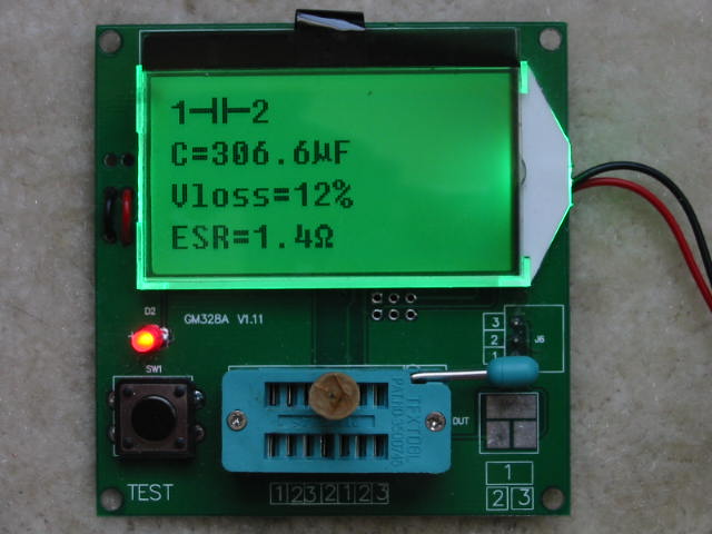

    I then proceeded to add a drop of (hot) water again, and once more this Sacon FZ rose from its grave.
    As you can see, the capacitance was almost back to what it was 6 months ago (just slightly lower), while the V_loss was in the teens %. On the other hand, look what the warm/hot water did for the ESR: 560 mOhms now. -WOW, almost worthy of being general purpose! /sarcansm

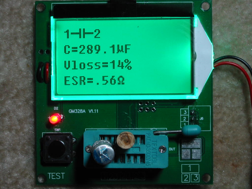

    Since I forgot to measure the current draw last time while the cap was connected to a voltage source, I did remember to do it now. With a 9V battery, the leakage current of the cap peaked at around 12-14 mA and then steadily decreased and stayed at 8 mA. After noting down the measurements of the leakage current (~2-3 minutes with the cap connected to the battery), I then checked the cap once again on the GM328.
    It seems like we have fairly repeatable results here… or at least with this particular cap. Both capacitance and V_loss decreased again, like last time. ESR did increase slightly, but that’s probably due to the warm water cooling off. All in all, though, it seems water can revive Sacon FZ caps for a short amount of time. I actually remember now I tried this many years ago, again with Sacon FZ. But I didn’t have an ESR meter back then, so I couldn’t report any results. All I remember is I had a Sacon FZ connected as a coupling capacitor on an audio circuit, and it wouldn’t do anything (which I expected.) Then I added a drop of water and… sound sprung out of the circuit!

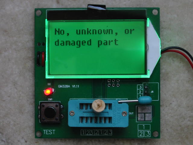

                  Dang... I was sticking stuff from my bag of cat piss into my avrtransistortester (dang i thought i had a gm328a, guess not, dont have any model printed on mine it seems) and a bunch of them made it go bonkers... hmm hope it didn't go bad or break transistortester. Some made my screen go wonky. Weird.
                  Anyway a lot of them end up being "No, unknown, or damaged part" surprisingly enough. Capacitors were so bad...
                  At least going back to my known or assumed good cap pile things went back to normal.
