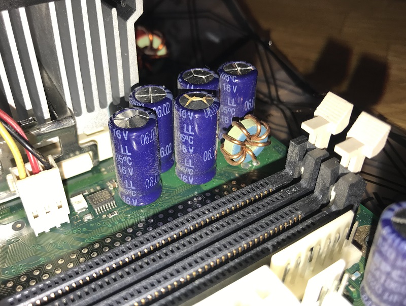

      uhm.. i found Siemens/EPCOS caps on a lot of older (early 00's) Fujitsu-Siemens made Mainboards. (for example the D1184)
      all of them had jamicon-like vents and most had the cheapo circular rubber bungs, but some had a Sanyo-like bung..
      they were still OK when i pulled them (no instabilities at least) from my own D1184 but you never know..
      all of them (EPCOS or Siemens) were called "LL" as the series (?)..
      apart from the changing rubber bungs, all of them looked exactly the same.. (same vent, same label)
      ^- those came out of my FSC D1184 i recapped 2 days ago and were used in the CPU VRM area.

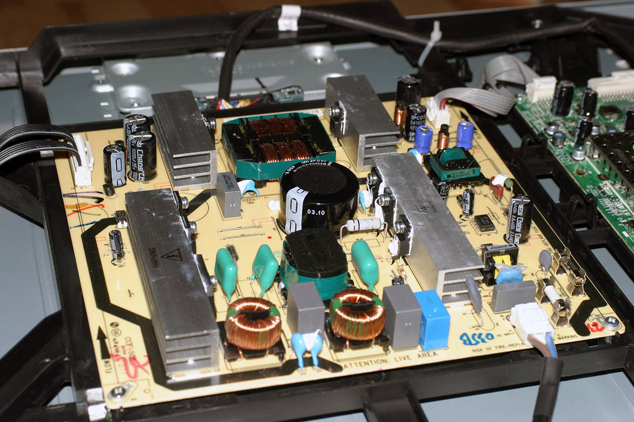

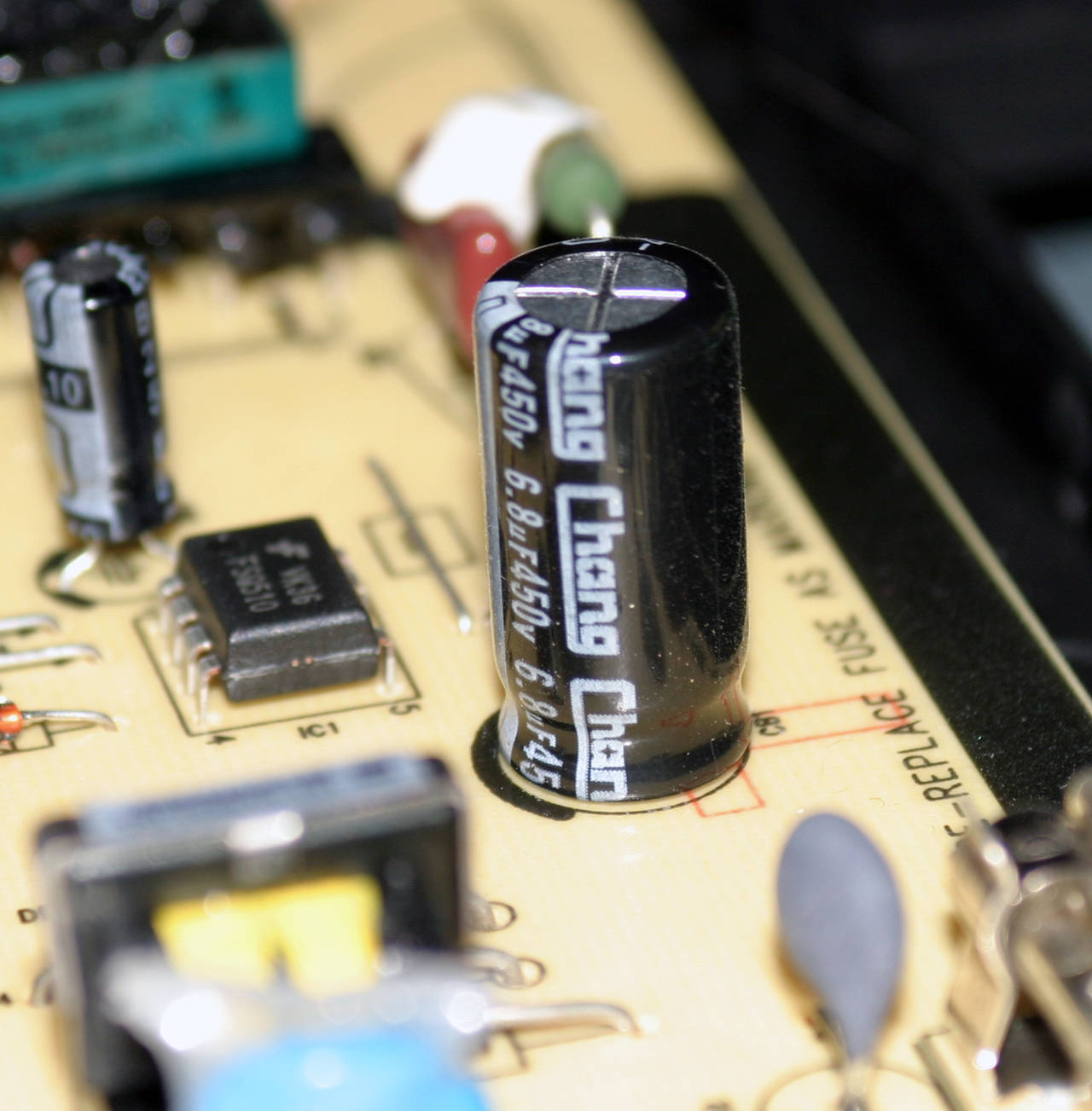

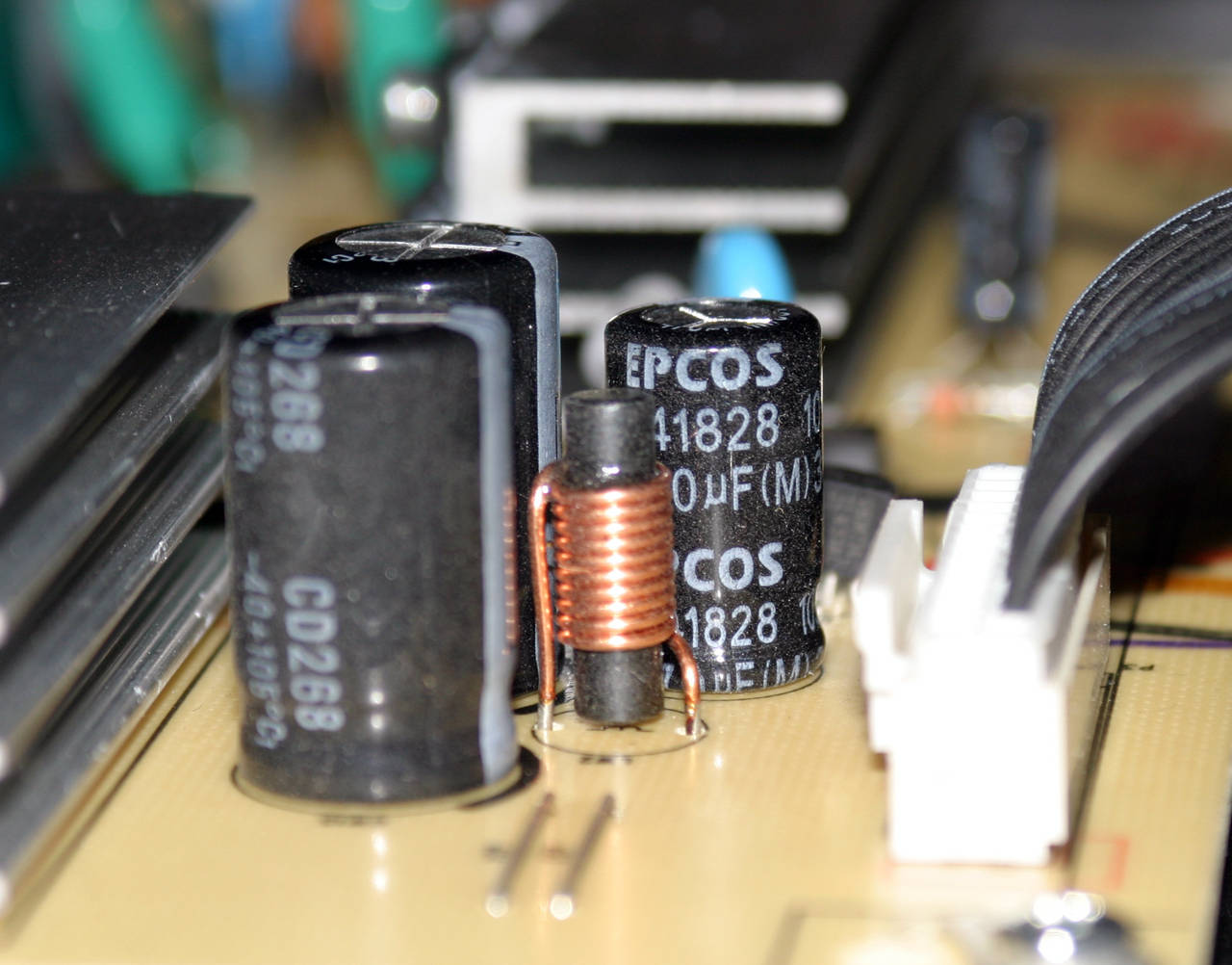

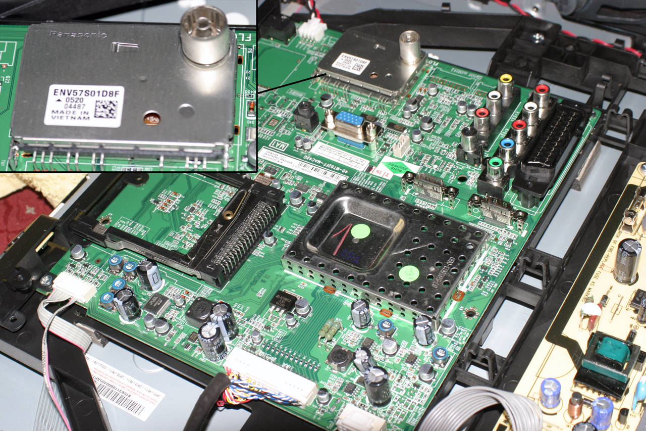

                Sorry about resurrection, but found these inside my TV: Chang and the unfamous Epcos. Should I change EPCOS ones too or only the Changs?

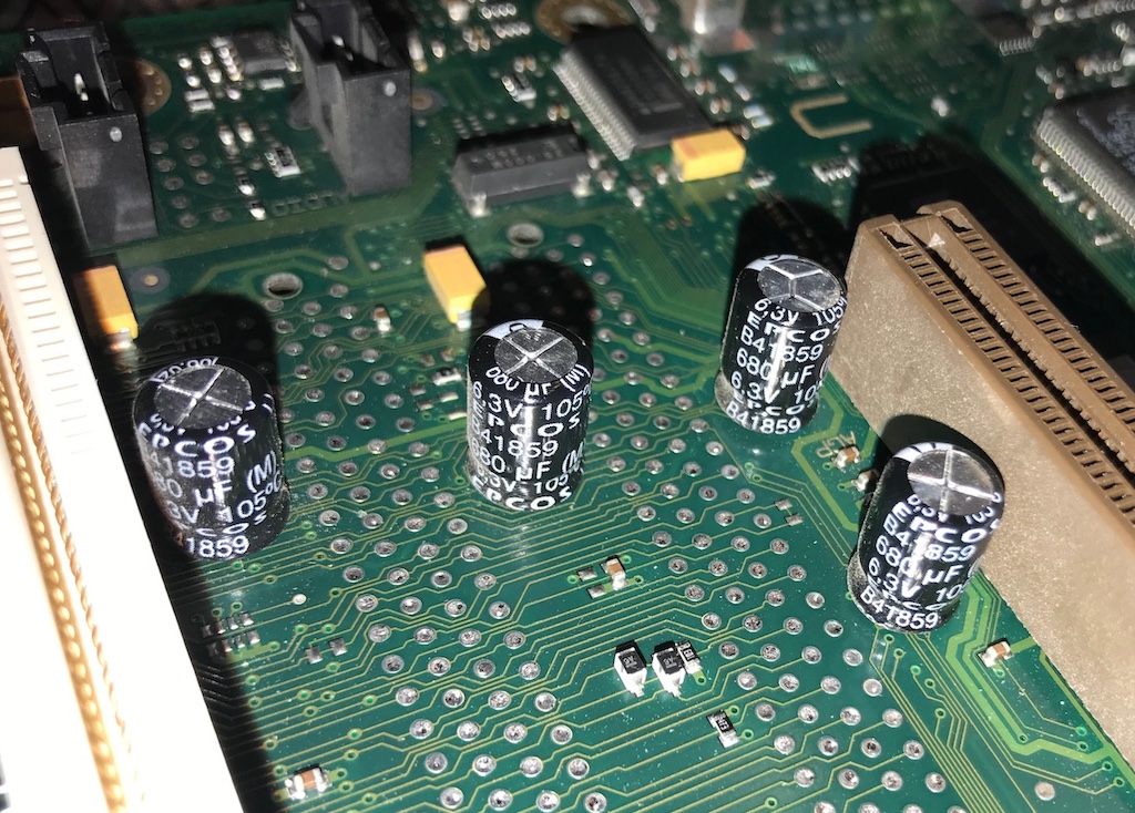

                      I know it's an old thread, but these are Epcos LL, on a Fujitsu Siemens D1215 motherboard (Socket 370).
                      Specs:
                      820 uF, 16V, 105 degrees.
                      The capacitance was way off on all of them, ranging from ~600 to over 2000uF (one of the leaky ones).
                      https://www.digchip.com/datasheets/p...B41859-pdf.php
                      According to the datasheet, they are "very low ESR".

                        Two different vent styles?

                            That's strange. I didn't notice it when taking the picture. Only the ones with an >-< pattern have leaked.
                            Could they be fake?
                            All the markings are the same, and the smaller caps have different vents as well. The board had no signs of previous repairs.

                              ^ Maybe.
                              I've seen EPCOS high-voltage electrolytic caps used in some appliances and electronics, but never in low-voltage applications, especially one in high-frequency switching and/or low-ESR applications. Yes, it could be that those are fake. Or it could also be that EPCOS is re-badging low-voltage capacitors from a different company for their smaller caps, as they might not be making any themselves.
                              To be on the safe side, probably best to replace all EPCOS.
                              Would be even better if you have a cap ESR meter and can check these to see what they read. Maybe even autopsy a few of the caps with different vents to see if they look different inside?
                              And if you feel optimistic, maybe contact EPCOS and see what they have to say? If any of these are fakes, I imaging EPCOS would be interested to know more. If not, then they might just try to shove you away or ignore you.

                                EPCOS B41859 (Siemens style series name) series is supposedly "Very Low Impedance" and "Very Low ESR", supposedly suited for power supply use. Why anyone would counterfeit an semi-obscure brand eludes me, so I suspect EPCOS is buying from multiple sources and having them sleeved with EPCOS shrink sleeving.
                                So I'd replace them with Nichicon PW or HE series, or NCC/UCC LXZ or KY series.
