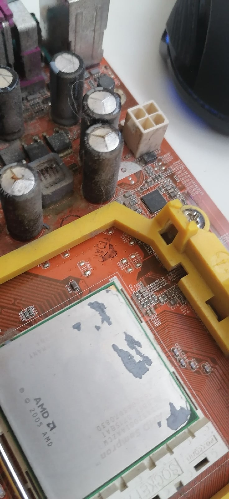

    I got an old AM2 board with 3300uf 6.3v badcaps(all). So I want to change them with poly ones. Can you give me advice which capacity should I use ? I saw on one russian forum(rom.by) that capacity of poly should be around third of current leaky caps, but I'm not sure.

      well, i got Foxconn WinFast MCP61SM2MA-RS2HV board, it's using 5x3300uf 6.3v caps atm, but board has space for 3 more caps. Also on rom.by forum I saw reference to this forum where it's said that there was a thread which shown that some gpu vendor changed 1000uf caps to 330uf poly ones. I think high capacity used for higher ripple current and lower ESR, so as poly caps arrived, all vendors started cutting unneeded capacity.

          Re: 3300uf 6.3V Poly recpaing
          so what makes you think the caps have under 2v running through them?
          can you find or take a high res pcb foto?
            ...because typically 3300uF caps were on the vcore output, and on an AM2 that will be under 2v...but yea, some pics would be good.
            As a rule when polymodding, half the capacitance of the lytic to be replaced is a good standard to go by, been doing it for ages. I have never had a problem with it in well over 10 years. As a matter of fact, this post was created from a dual Socket-A that had all it's 3300uF caps replaced with 1800uF 6.3v Nichicon LG polymers. Its 100% solid.

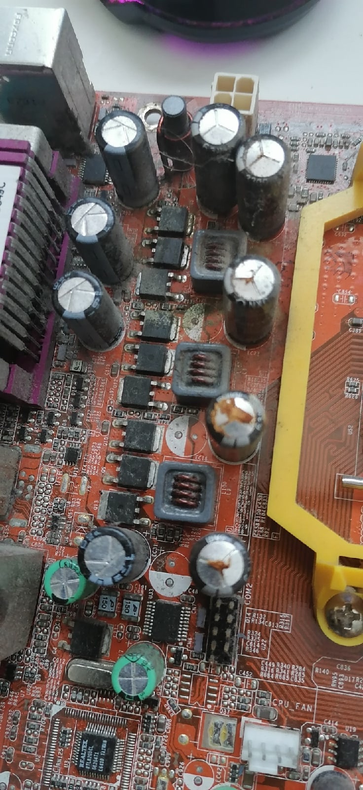

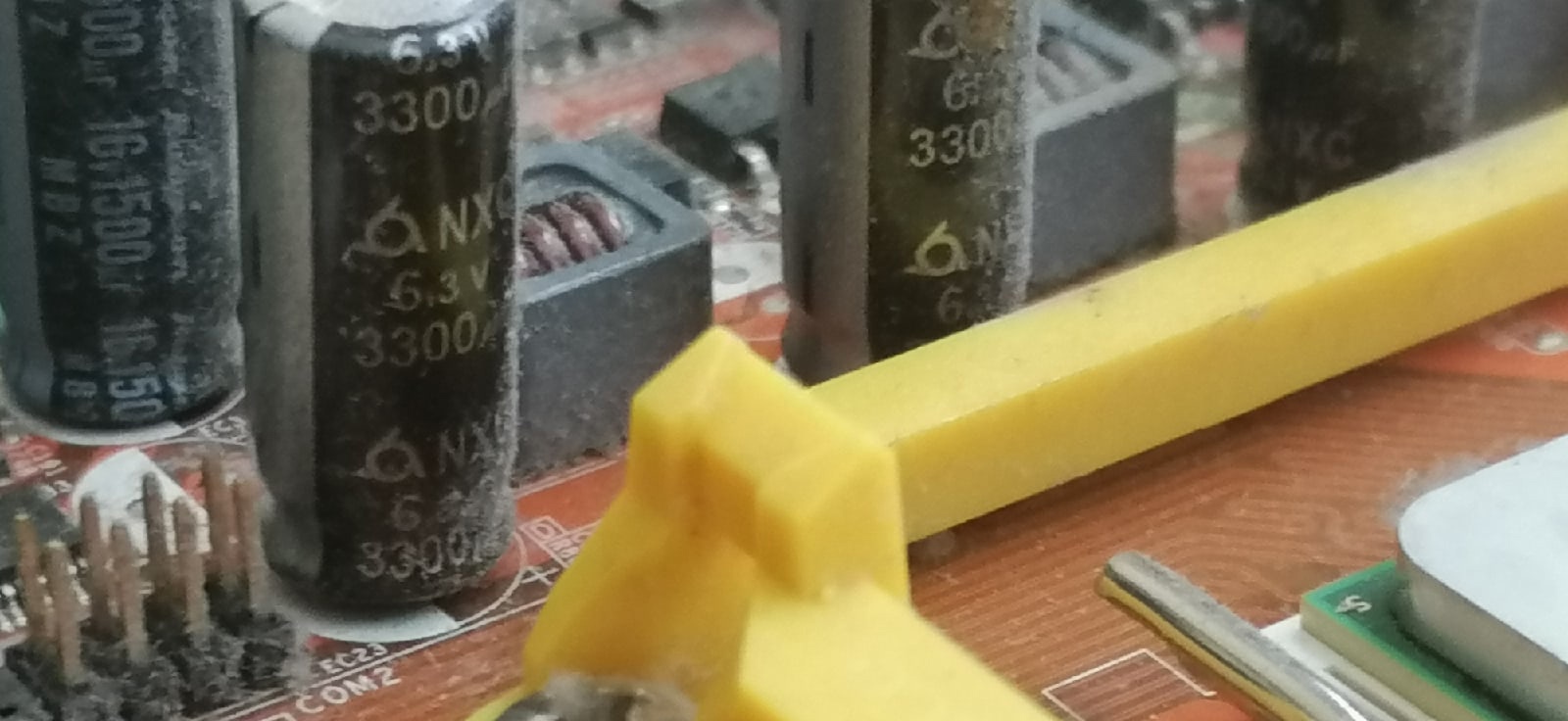

              Here is photos, forgot to mention current caps are Sam Young NXC caps xD
              PC with this board was staying for a lot time and had better times...
                              Rebadged KZG or KZJ?
